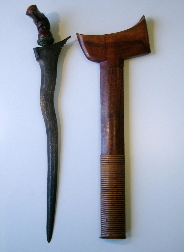

I have just posted another Keris at my gallery at KampungNet.
http://www.kampungnet.com.sg/modules...view_album.php
I would appreciate feedback from those of you who know about Dapur and Pamor if I am correct on my description?
Also, considering this is a forum for Keris lovers, I suggest that the other members also post when they update their collection pages?
Michael
Old 25th August 2006, 01:14 PM   #2
Alam Shah
Alam Shah's Avatar
Join Date: Jan 2005
Location: Singapore
Posts: 1,248
Michael,
It is indeed Dapur Tilam Upih. The profile of the blade curve is known as "Medhang Suduk" with ganja "Sebit Rontal" and Tikel Alis "Cekak". The tip of the blade or Pucuk Bilah is in the "Ngudhup" style.
As for the pamor Kembang Lampes(?), I need to check... I only know pamor Sekar Lampes, and this is not it.

Thanks!
I found the reference on the Pamor in Solyom.
Michael
Old 25th August 2006, 03:26 PM   #4
Alam Shah
Alam Shah's Avatar
Join Date: Jan 2005
Location: Singapore
Posts: 1,248
Default Confirmed pamor pattern...
Pamor Kembang Lampes it is, then. (Ref: Solyom pg.15, 18-19.)

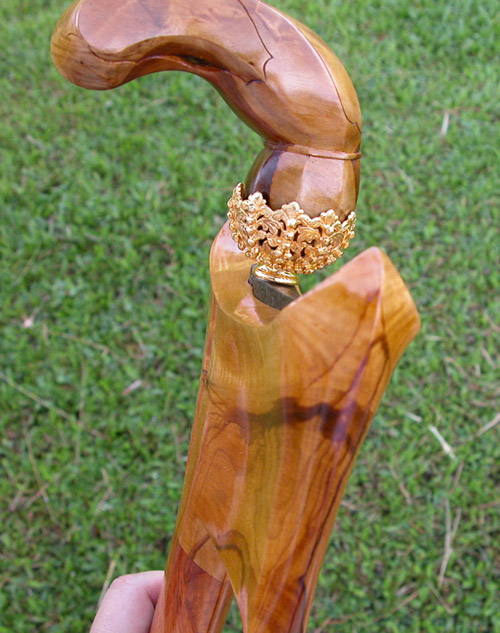

Here's one for viewing pleasure. Blade acquired from Scobey, Montana and fittings (with the exception of the pendokok) carved by Nik Rashidee Nik Hussein of Kelantan, Malaysia.
And more pictures here:
http://www.kampungnet.com.sg/modules...bum.php&page=1

Thumbs up A beauty...
John,
Overall, a beautiful blade with beautiful fittings.
Hmmm... now waiting for mine...
Old 2nd September 2006, 03:34 PM   #7
Posts: 7,284
Gorgeous pamor and a beautiful job of re-dressing. I realize it is not necessarily the tradition with this type of blade, but i might be tempted give it a staining to really pop that pattern out.
Nik did a great job.
Old 2nd September 2006, 04:35 PM   #8
Posts: 6,414
Thumbs up Wonderful !
A beautiful piece of workmanship John !
There is a real sense of harmony in all the aspects of this keris .
Old 2nd September 2006, 04:44 PM   #9
BluErf
BluErf's Avatar
Location: Singapore
Posts: 1,180
Ahhhh..... droooool.... John, you really do attract top quality Bugis blades. And the dress is befitting of the fantastic blade.

Default Thanks.
Thanks to all for the encouraging/kind comments. Indeed it's gratifying to see a job well done.
Shahrial, I believe yours would be ready in no time. Do please post some pictures. In the meantime, I'm holding my breath...
Kai Wee, let it be known many of your outstanding pieces have been my benchmarks. Another project with Nik will come and the fittings will base on a picture you once sent upon my request.
Nik Dee opined the blade as Riau Bugis and helped made the selection of sampir and hulu after discussions. The choice of pendokok and butut (after seeing how good it looks on a Kai Wee piece) were mine.
John is offline   Reply With Quote

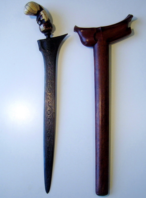

Hi all,
Just posted a Keris I found in Copenhagen last week at
I like the 3D pamor and it's interesting because it has a Ganja Iras with a drawn line.
Also I would appreciate all feedback on the descriptions, especially what kind of material the hilt is made of?
Michael
Old 10th September 2006, 11:55 AM   #15
Alam Shah
Alam Shah's Avatar
Join Date: Jan 2005
Location: Singapore
Posts: 1,248
Hi Michael,
A pretty Palembang piece. I do love ganja iras blades. Sorry I could not contribute. Most of the features about your keris, you already know. As for the hilt, perhaps someone would know better.
About ganja iras, does anyone knows why it is made this way?
I'm sure there is a purpose. One of my ganja iras blade.
http://www.kampungnet.com.sg/modules...view_photo.php
Old 10th September 2006, 03:13 PM   #16
VVV
VVV's Avatar
Location: Sweden
Posts: 1,637
Thanks Shahrial,
I unfortunately don't know the answer to your Ganja Iras question.
Nice blade you've got by the way.
Is the Ganja separate or is it a drawn line like mine?
I found some time today to also post another of my Bugis Keris at
This is a heavy fighter, still sharp edges, with an interesting Dapur.
Michael

Thumbs up Good Bugis piece
Originally Posted by VVV
... Nice blade you've got by the way. Is the Ganja separate or is it a drawn line like mine?
It's Ganja Iras, drawn like yours.
Btw, love your Luk 3, Bugis keris. The type of blade that I like. However, personally, I don't like rattan binding to the lower side of the sheath.
Your Bugis pieces seems to have pamor Batu Lapak (or Tapak Gajah in Malay) at the base of the blade.
Last edited by Alam Shah; 10th September 2006 at 03:54 PM. Reason: added more info...
Old 10th September 2006, 03:56 PM   #18
Posts: 7,284
Really like this last one Michael....and your gonjo iras blade as well (yours too Shahrial ). I will make the suggestion that if we keep adding new, yet unrelated keris to this thread we will move on to the next blade before we discuss the early questions at hand. Please feel free Michael to start new threads for new and unrelated acquisitions. I think it might give the discussion greater focus.
Back to the gonjo iras question and that keris. I have tried to asked the question of why make an gonjo iras blade before and the only answers i have received that seemed sustainable was that it was a cost cutting measure. This may be the case, but frankly it is an answer which has left me still questioning. I doubt that yours was made that way to protect the owner from the metaphysical powers of his own keris as you suggest on the website, but it does seem to me that there would be some other reason besides cost cutting.
As for your pamor descriptions, i have never heard pamor wengkon described that way. My understanding is that it is a protective pamor and will often be found on the keris of those who officiate over a group of people whose protection and care is in his hands. Of course, these pamor meanings can get pretty subjective at time and can mean different things to different people. I agree with you that the pamor is typical of Bugis blades, but i would say the dapur of this keris is far more Javanese influenced.
I am not all that good at recognizing ivories, but is there some reason this couldn't just be elephant ivory that has cracked with age. Why do you think it is molar material or possibly Hippo?
Old 10th September 2006, 05:28 PM   #19
VVV
VVV's Avatar
Location: Sweden
Posts: 1,637
Thanks Shahrial and David for your comments,
Shahrial, you are correct about the Batu Lapak.
I will change it in the description.
Maybe it was to early in the morning when I checked the Pamor
David, cost cutting sounds like a probable reason. But several of the ganja iras blades I have seen doesn't look over all as if the owner was out of funds.
I guess that there may be some mystical, symbolic meaning meaning why to do it. Just as you also seem to do.
I hope we will find the answer from some of the other forumites?
On the Pamor, as well as Dapur, descriptions I usually use Tammens.
And sometimes Ensiklopedi Keris.
On the Javanese influence I have used a Javanese Dapur description.
But most of the Keris I have seen with this form has been Minangkabau Keris.
The reason why I suspect it's not "usual" elephant ivory is because it doesn't look like the material in any of my other ivory hilts. And when I checked in some of the reference works I found hilts of partly resembling material described as molar or hippopotamus.
Earlier this year I had one of the senior European collectors visiting me and he also told me that several of my Sumatran hilts that I thought was made from elephant ivory actually were made from other kind of ivory.
Michael

Michael, that are really gorgeous keris!
Please post close-ups from different angles of the ivory? hulu - thanks!
Old 11th September 2006, 05:47 AM   #23
VVV
VVV's Avatar
Location: Sweden
Posts: 1,637
Thanks Kai,
If you click on the link you will find additional pictures of the hilt.
Michael
Old 11th September 2006, 09:29 PM   #24
Hello Michael,
Thanks for getting me up to speed - that was a little too late at night...
I can't positively identify the hulu material from the nice pics - I'm pretty sure though that it's neither recent/fossil elephant molar (I can see no hints on the pics which would suggest this) nor hippo/walrus/dugong. If forced to, I'd probably bet at elephant ivory but only close examination under magnification will help to verify this. (I think the many microcracks (age?) kinda mask the regular ivory appearance you're more used to.)
Great piece and I also like the other one as much!
Old 11th September 2006, 10:30 PM   #25
VVV
VVV's Avatar
Location: Sweden
Posts: 1,637
Thanks Kai,
You have convinced me that I have to find a magnifying glass as well as learn some more on how to identify different kind of ivory.
Michael
