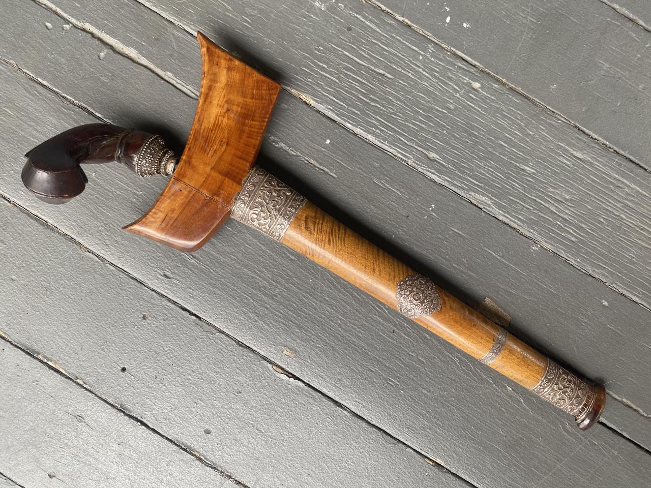

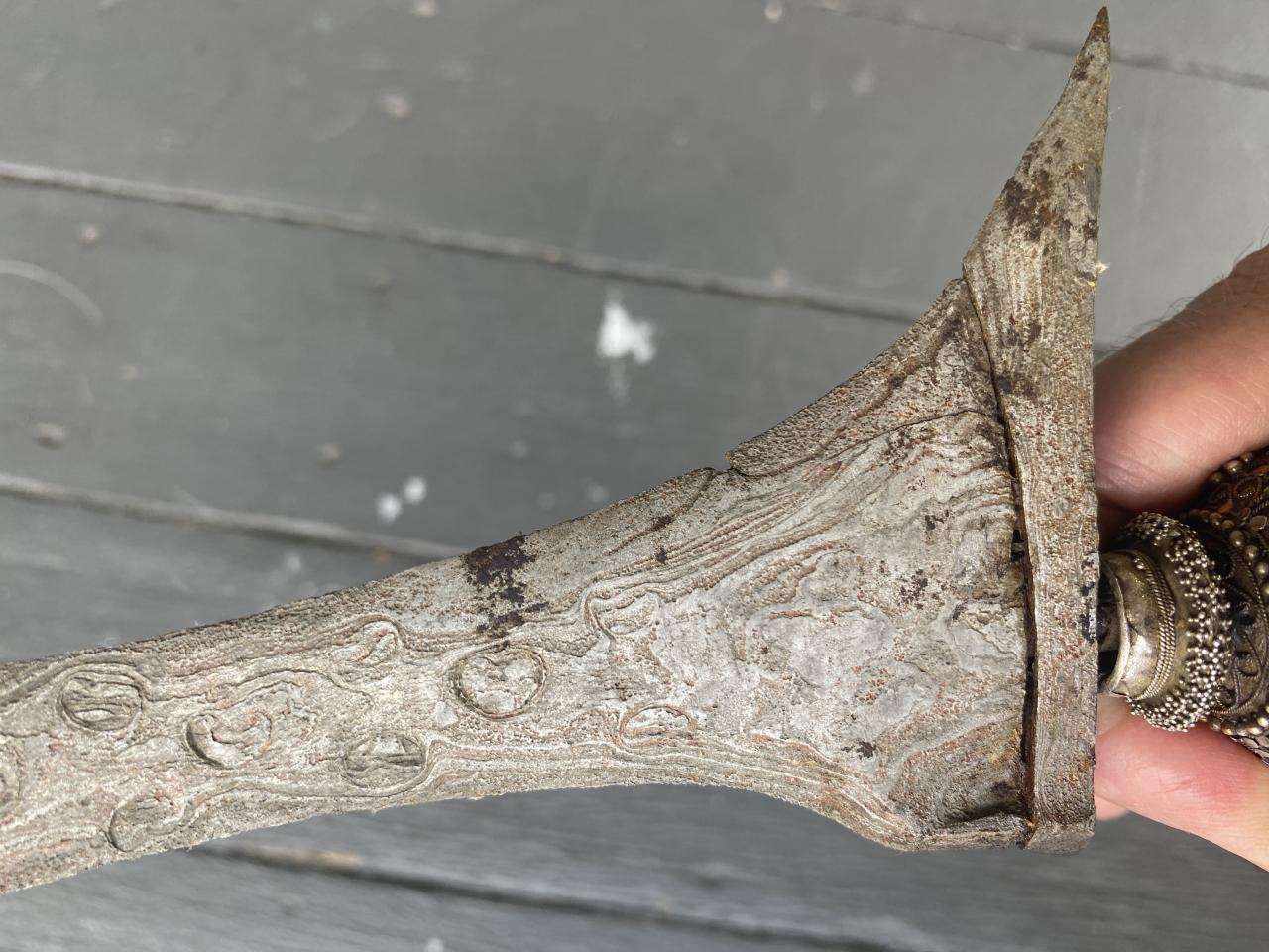

Several weeks ago I picked up this keris (sapukala) in Makassar, but it came with no biographical information and I've very limited knowledge of keris at this stage, so I'm keen for the forum members' insights on it.

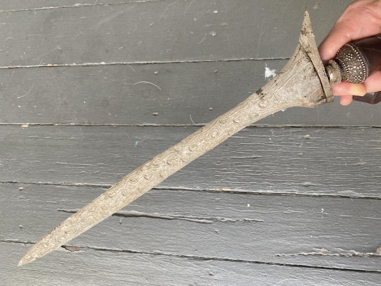

To my inexperienced eye the keris blade looks rather "old", but some of my Bugis-Makasar friends differ in their views on its origin; some are adamant that it is of Javanese make, although a particularly knowledgeable person tells me it is indeed a Bugis production. The blade is quite thin in section, whereas my (poor) understanding is that Bugis keris blades tend to be rather thick.
The dress (including hulu) does seem to be Bugis.
Any insight/opinions much appreciated. Thank you!

There is really no room for doubt about this keris blade, not so much for what it is, but rather for what it is not.
Stylistically it is definitely not Bugis.
No experienced student of the keris would accept that this blade is stylistically Bugis.

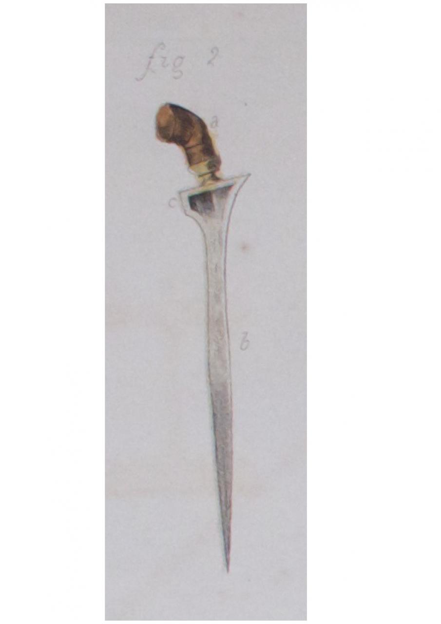

For what it is worth, this blade does seem rather similar in form - at least to my eye - to a Bugis keris illustrated in Matthes' 1874 Ethnographic Atlas of the Bugis, which I have attached to this post.
However, my Bugis-Makasar friends did tell me that owing to a very longstanding process of cultural syncretisation it is quite difficult in some cases to distinguish between Javanese and Bugis blades on stylistic grounds alone.
In any case, I understand that generally speaking it's not possible to say too much about the antiquity of this blade from photos on a computer screen, but do you think it is, indeed, "old" (i.e., pre-WWII)?

The illustration you have shown is of no use at all in providing sufficient grounds to form an opinion on what that illustration shows. In fact, even the very best photograph, taken by an expert photographer, can only provide very limited information that might be useful in determination of the classification of a keris blade. One cannot feel the weight, balance nor texture of a blade from a photo, & that's just for a start.

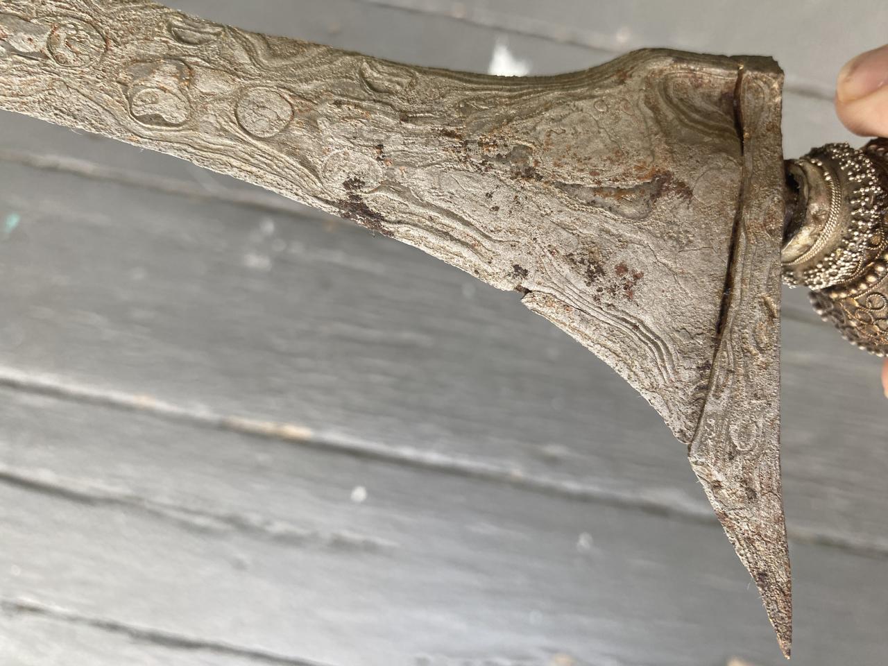

There are indicators that might cause some people to classify this blade as Tuban-Pajajaran, but we do not really expect to find a pamor like udan mas in a keris of this classification.
I'm inclined to think it has some age, I think pre-WWII would be a safe bet & probably from West Jawa, made in an earlier style.
As always my comments are not set in stone, I'd need the blade in my hand before I'd be prepared to form an opinion, if that were even possible.
