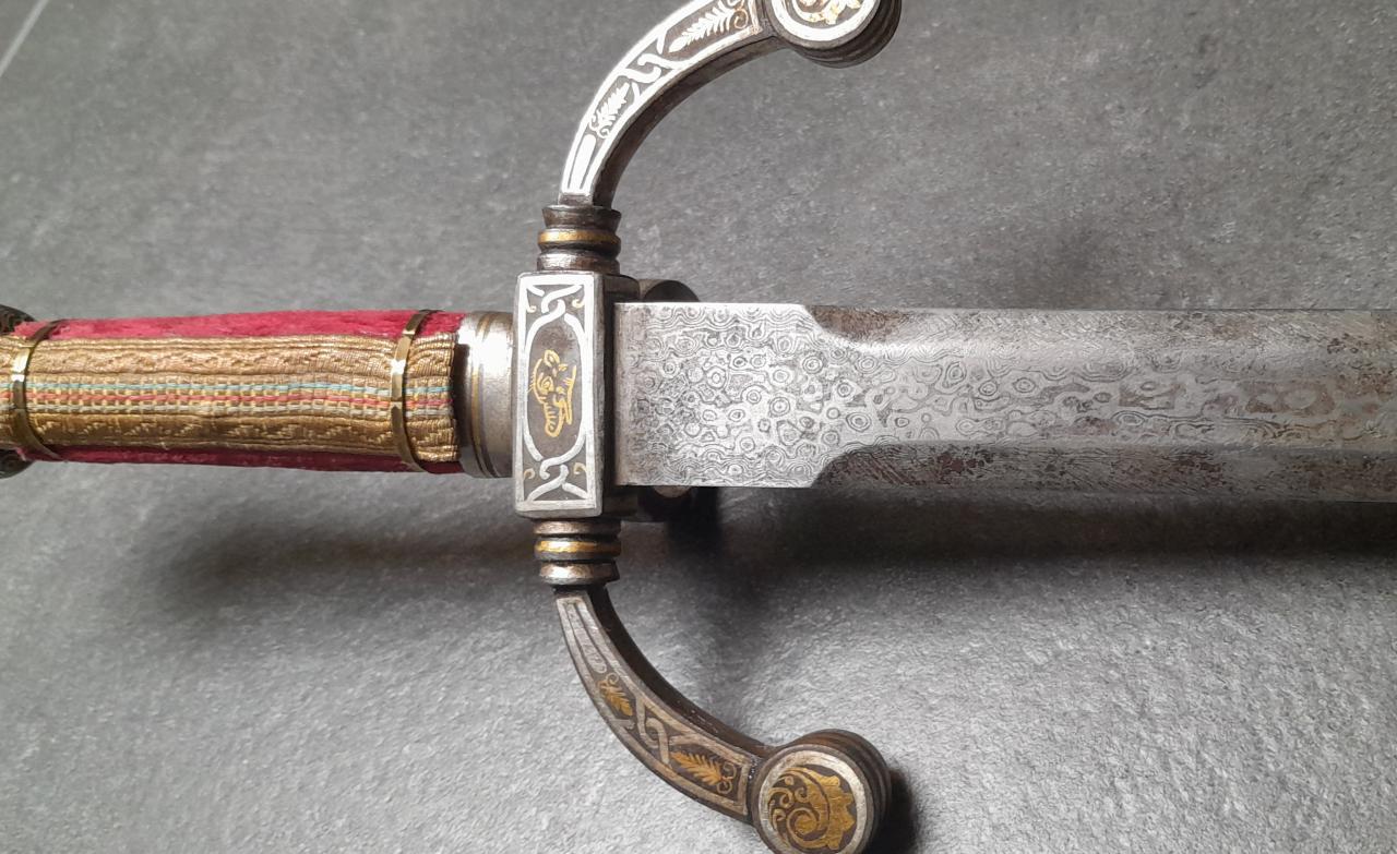

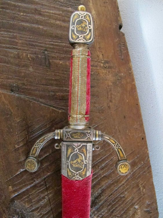

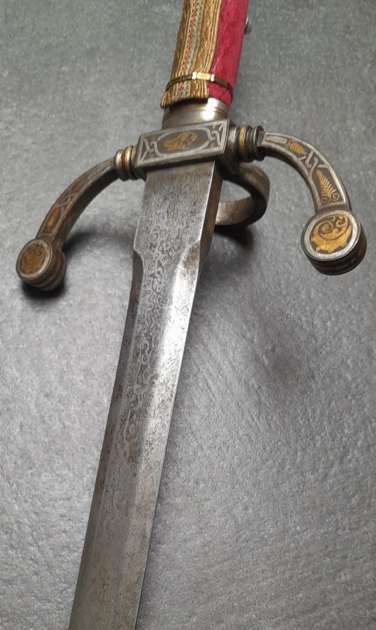

Good day gentlemen,
Can this dagger be something good ??
It seems well done but the velvet is too much
and the damas blade seems weird on this kind of dagger.
Can it be spanish ??
Indian recent fake damas blade ??
do indians 'fake 'bladesmith'' make these models in recent reproductions ?
I didn't find any line this one.

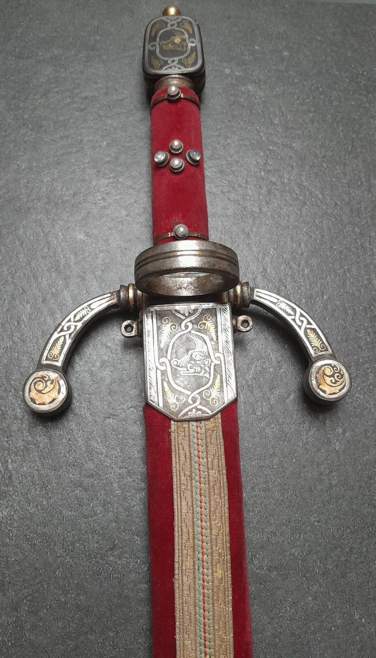

Caveat emptor...

For me,
Bad late 20th indian reproduction

Maybe the blade yes
But guard and pommel are really well made and seems not recent.
Any other thoughts ??

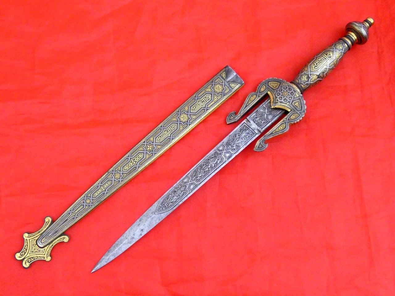

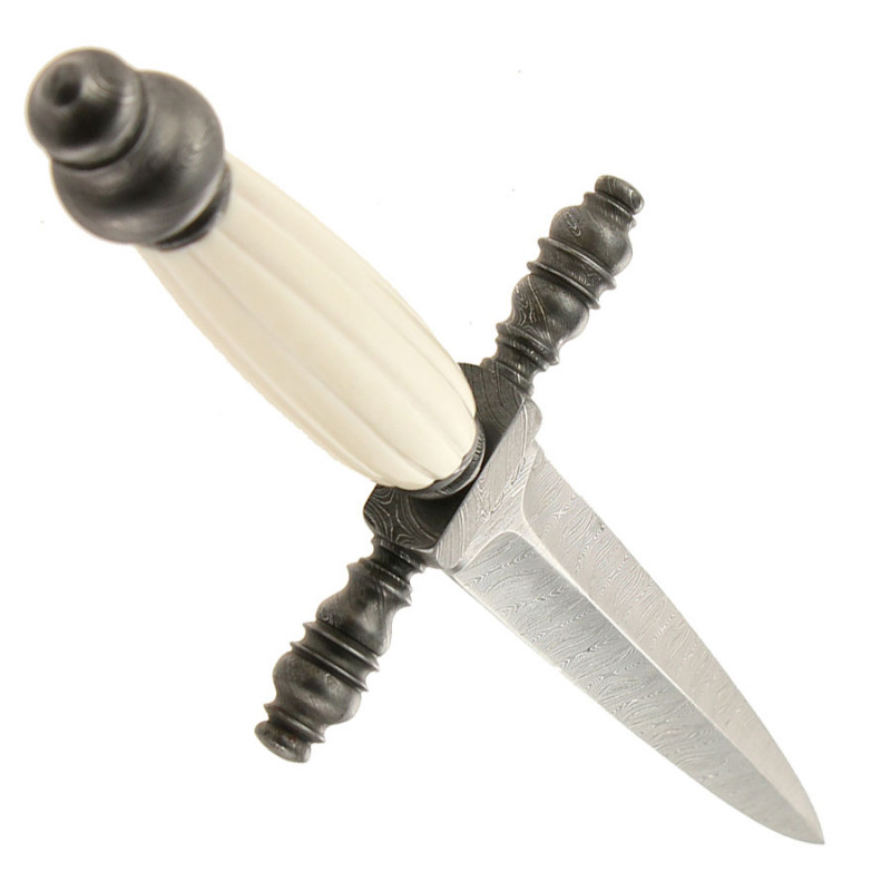

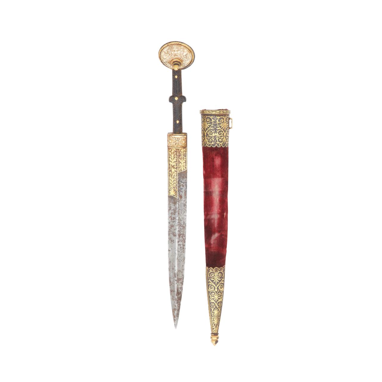

I know next to nothing about European blades but could it be a 19th century Toledo dagger?
Attached is an example I found on the net.

Thank's a lot Sajen,
That's the kind of steel damascening I was thinking about when I suggested Spanish dagger origin
I will try to remove the ( too ) fancy velvet/chape in scabbard and hilt if I can,
See how it is made under...

Hello Marius,
Yes, the velvet looks like it could be a later addition, keep us updated!

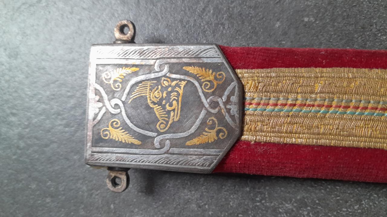

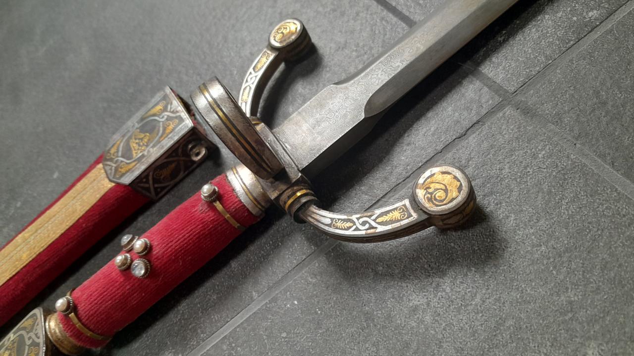

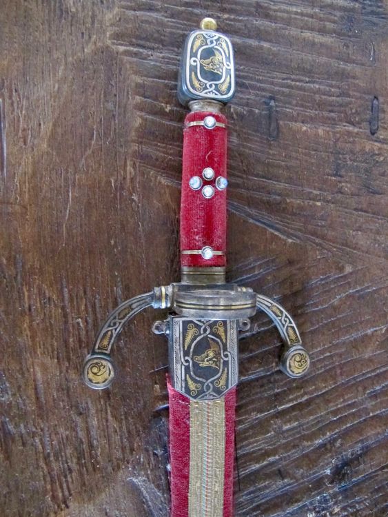

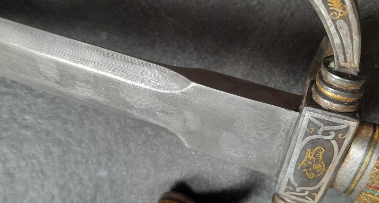

Hello Sajen,

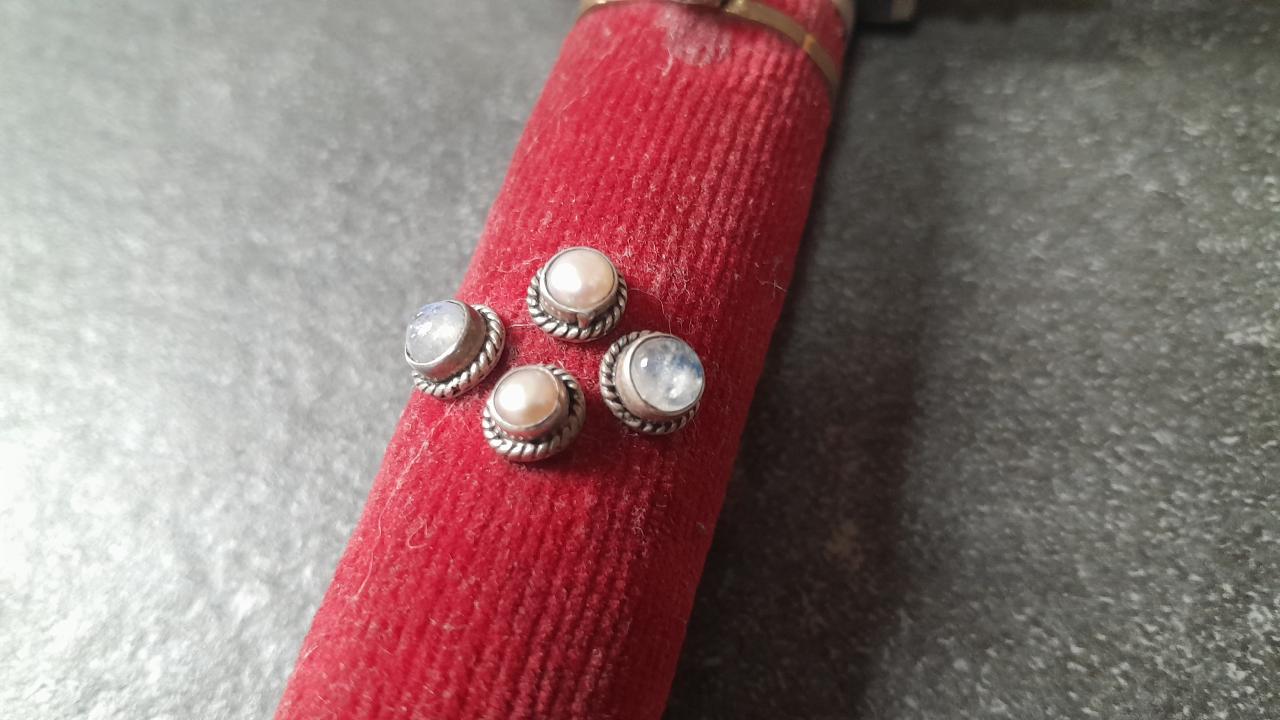

I have removed the first mount and the inner scabbard is made of wood
Idem, in the hilt, under the velvet there is a wooden piece.
The small stones and pearls are well setted/made
Idem, I find the gold and silver damascenining quality made and show some age,
Just the pommel and the tip of the scabbard had been cleaned too much.
I have sanded and polished the blade, it was covered with some kind of wax to avoid rust so it looked too recent shiny and fake.
So it is a real damas blade don't know about the age but it is a real weapon ...
Fernando, can't we.put it.again in the european weapons forum ??
I saw 19th damas blade on french and german hunting daggers
Marius66 is offline   Reply With Quote

I like.the wild boar head,
Don't think it is a coat of arms / family crest.
a deco for a '' royal'' main gauche hunting dagger 😅

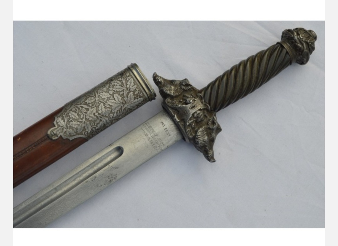

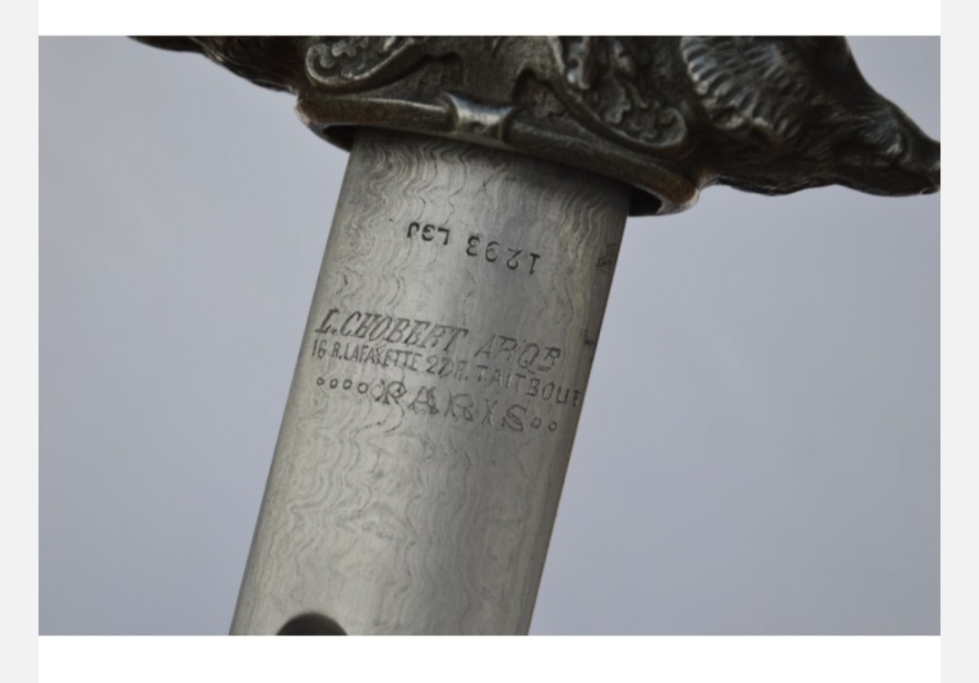

Thank you very much Fernando !!

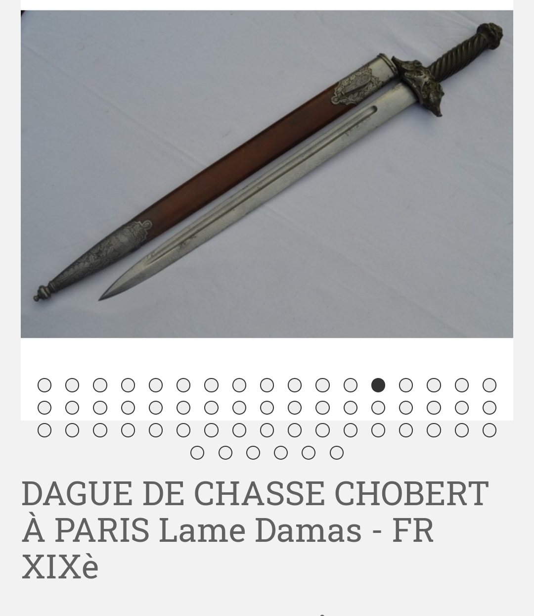

I found a mix of similar parts but nothing exactly look like...

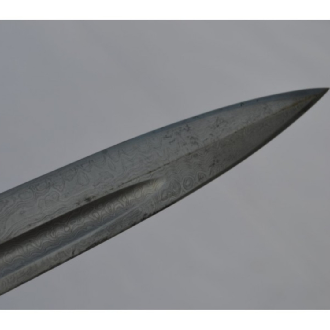

Here a french hunting dagger with boars and damas blade

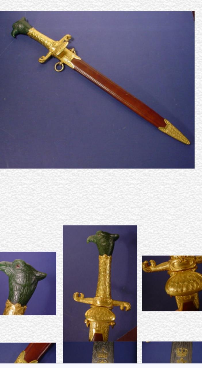

Old 17th May 2024, 11:25 AM   #15
Marius66
Join Date: Jun 2019
Posts: 131

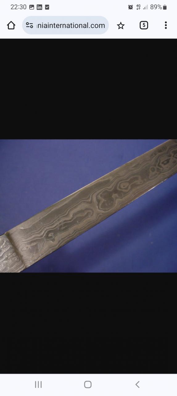

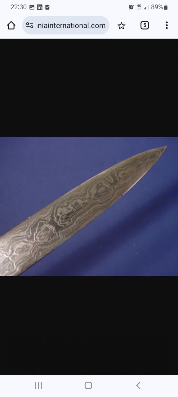

Here the ''same'' kind of damascened steel
And old velvet covered parade swords or dagger
Some models with xxl historic importance...

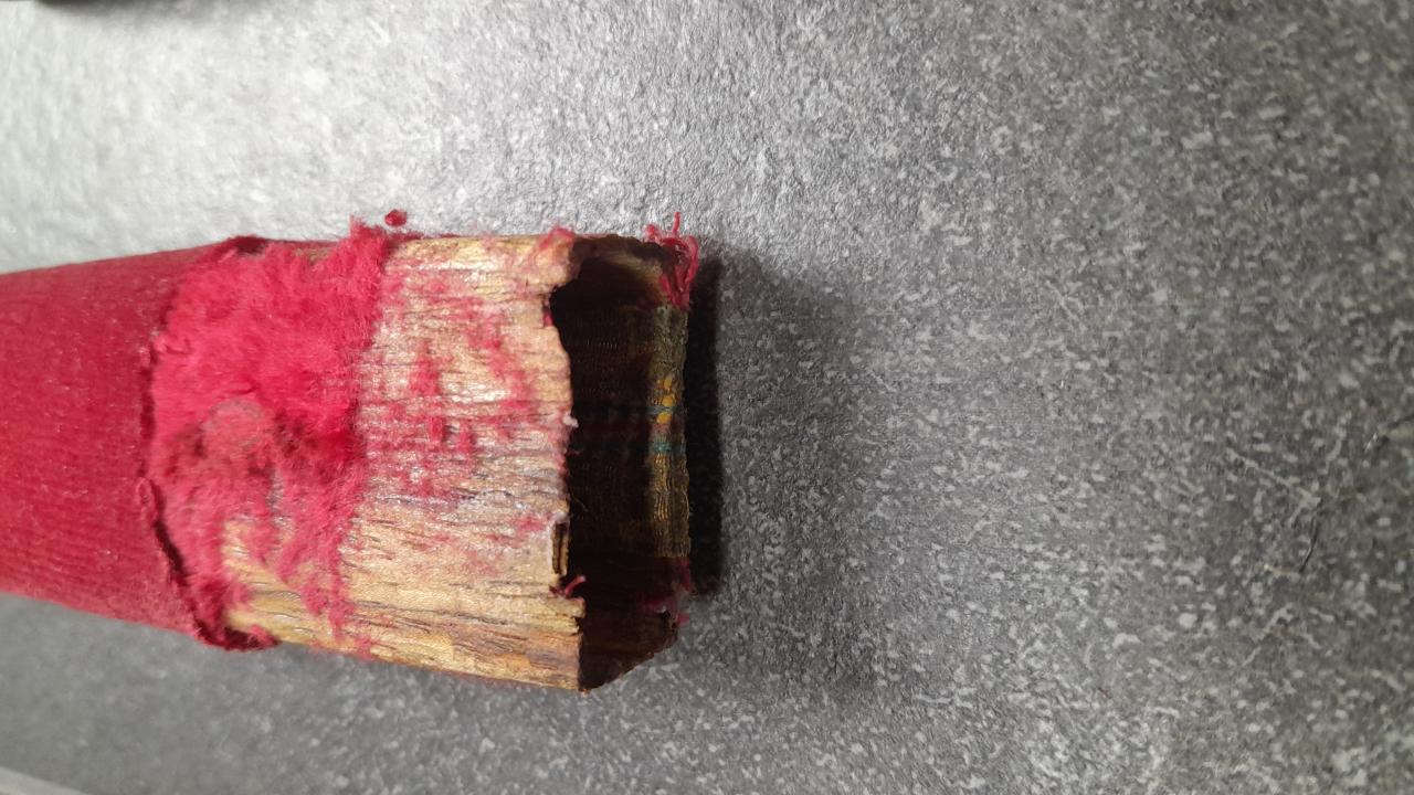

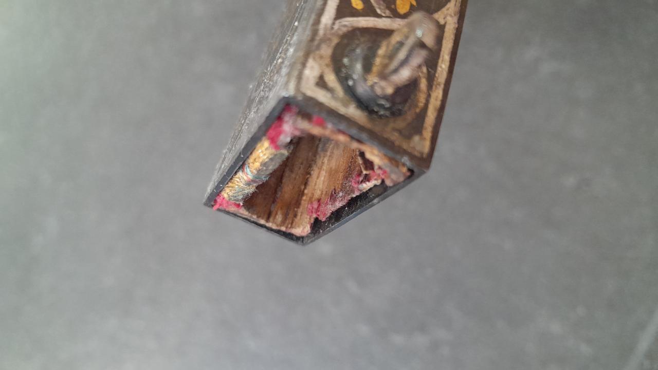

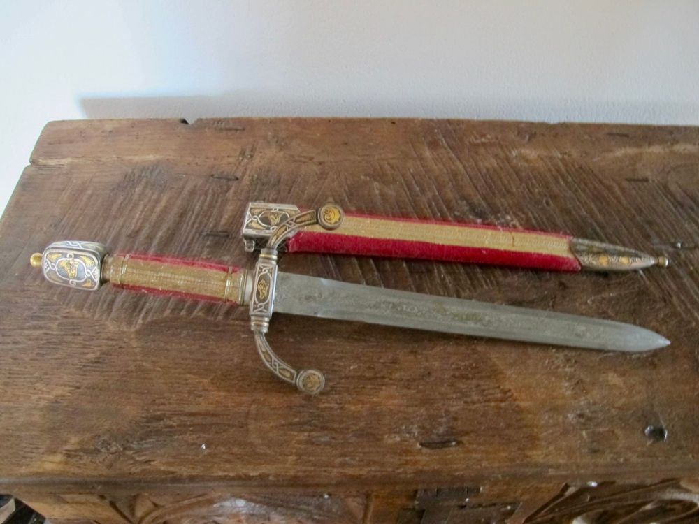

I just want to add this picture,
The blade moves a little in the scabbard and the velvet is used/missing inside so I don't think all dagger and scabbard are so recent.

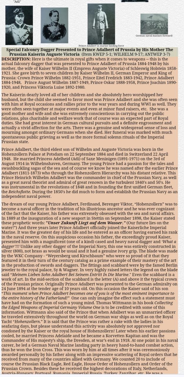

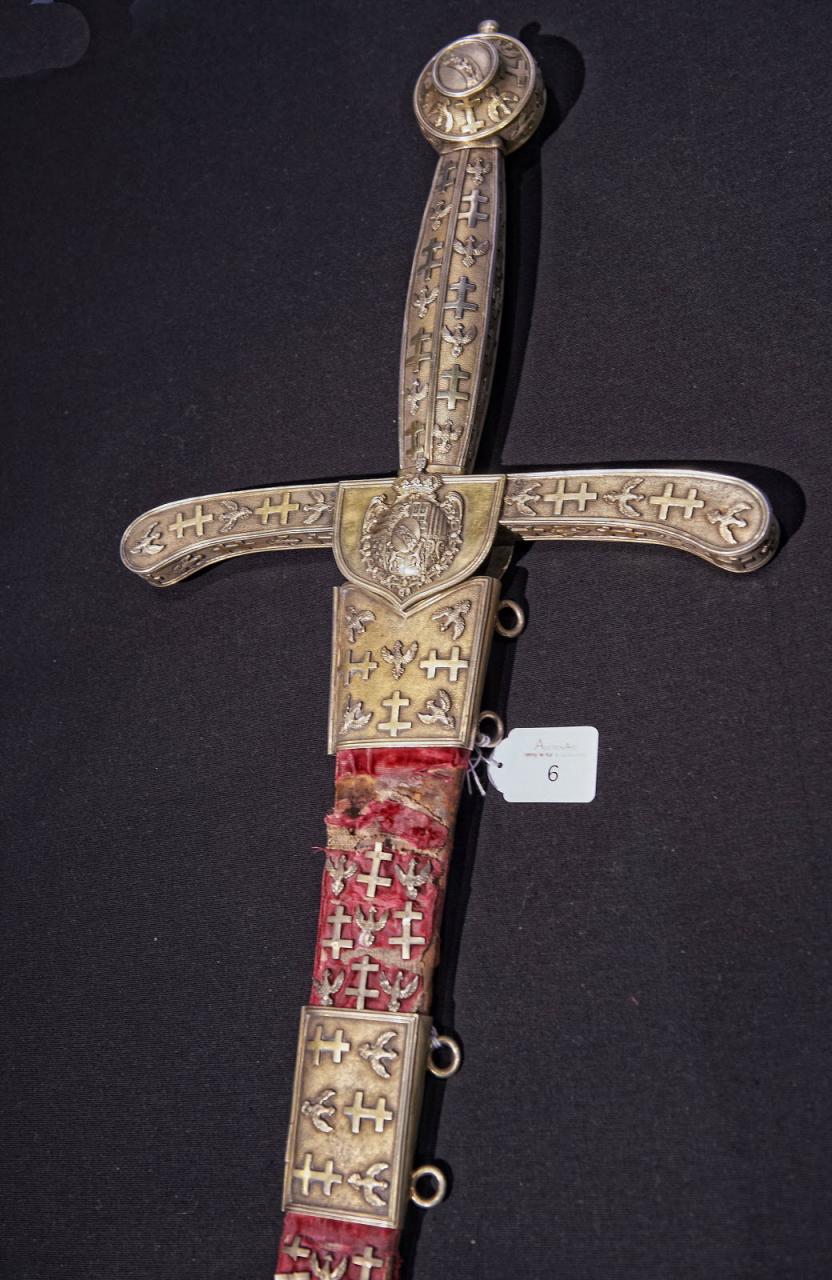

Looking for my monogramms and Kaiser Willhelm II,
I found this german royal gift dagger with damas blade.
If it hadn't such an amazing history,
we could think it is just a recent reproduction

I sharpened the edges and age the blade with a special trick ,
I find it looks older/ authentic now

This is a LATE 20th century ('60-'80) INDIAN reproduction.
The pattern welded damascus is of quite typical Indian type (low quality and mass produced) and so are the decorations. And NO, the fact that it has a pattern welded damascus blade does not make it a "real weapon" unless you consider wallhangers and letter openers "real weapons."
Now, you can believe what you want but this is my opinion.
