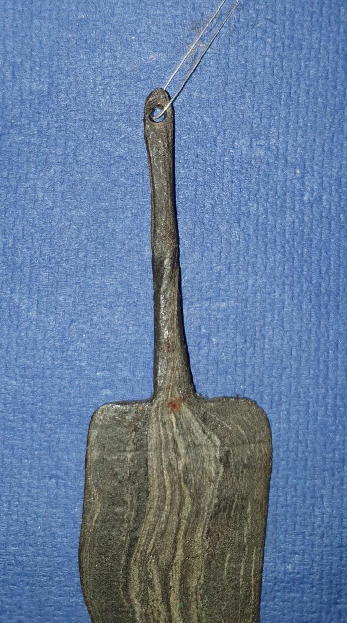

Default First Post - Identification Assistance Much Appreciated
Hi,
Really happy to be part of this group. I haven't the slightest clue about krises and the family collection has been handed down to me.
Appreciate all the wisdom, knowledge, comments etc.
Thanks.
Omar

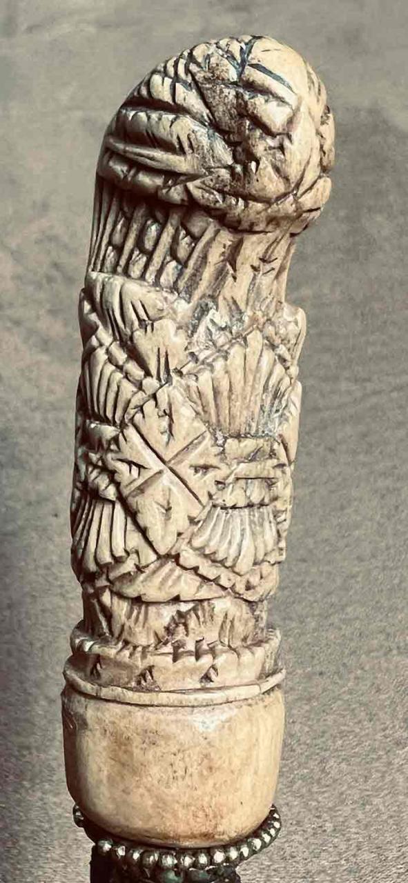

Welcome to the forum Omar,
Looks like a keris picit or pejetan to my eyes. Scabbard is a recent replacement like the handle also. Blade seems to be old but pictures can deceive.
Old 26th April 2024, 02:30 AM   #3
Posts: 7,260
It might be a Sombro.
try removing the hilt, it is likely to be only a pressure fit, the tang wound with thread or cloth, if it is tight & difficult to remove, leave it . But if you can remove the hilt, & the end of the tang has an eye-hole in it, either broken or unbroken, then we can call it a Sombro.

Hi Alan,
Beside the eye hole in the end of the tang what are the other characteristics for Sombro style Keris? Ganja iras or not?
Thank you
JustYS is offline   Reply With Quote
Old 26th April 2024, 11:50 AM   #5
All Sombro I've seen had a ganja iras.
Here my example.

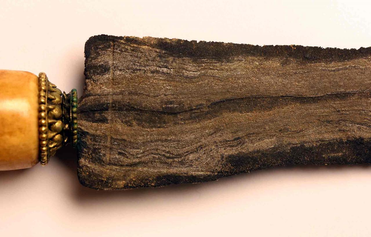

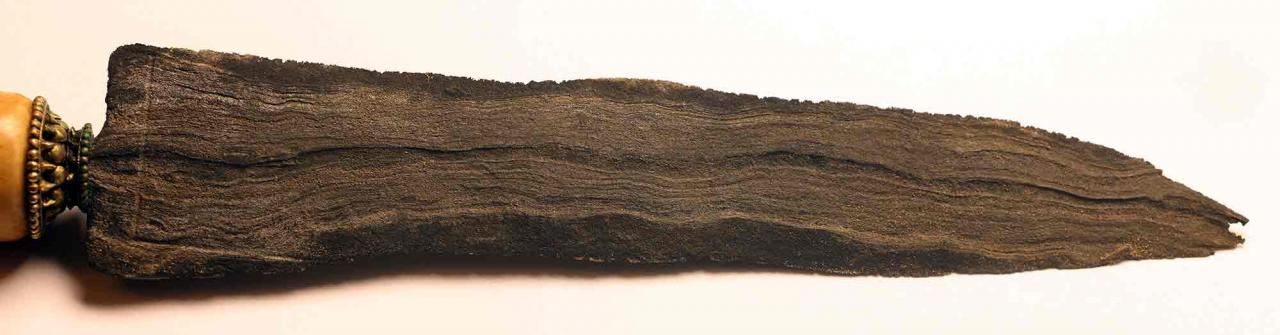

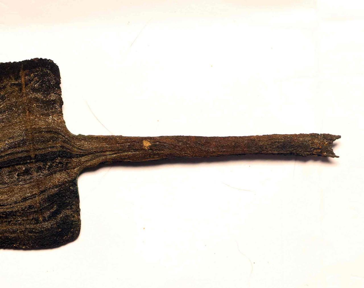

Thank you very much. I hv had to look up for most of the terms used in the replies to even understand things.
I hv attached a few more pics of the blade.
As for removing the hilt, am worried that I can't put it together again.:
Cheers.

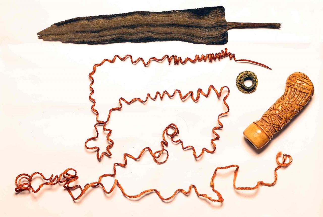

Welcome to the forum Omar.
It does indeed look to be a Keris Sombro, but a hole in the end of the pesi (tang) would be a defining trademark. These are so called after a legendary female Empu (keris smith) who used to thread these blades to carry them around and if you wanted one in the middle of the bunch the eye in the pesi was usually broken as she pulled it off the string.
As Alan explained, a keris hilt is usually pressure fit into the hilt, This is done by wrapping fabric or thread around the pesi (tang) any sort of screwing the pesi up into the hole in the hilt. I can understand if you choose not to mess with it, but reattaching a hilt in this manner is not very difficult. It is pretty much a "skill" that all keris collectors learn pretty early on. If you are really worried about this then leave it as is, but then you really can't be sure if it is indeed a Sombro keris. If the hilt hasn't been fixed with an adhesive you should be able to turn the hilt back and forth. Wiggling it gently while pulling the back on the hilt should allow it to come off. Once the hilt is off it will be pretty obvious what needs to be done to put it back in place.

Thank you very much Sajen and Alan for your guidance to remove the hilt. It was a pressure fit feeling. I have enclosed 2 more images for you to see.
Were these types of keris more weapons or amulets? For the average common guy?
How would I best summarise this weapon in point form: Origin, blade, dapor etc
Cheers.

Yes, this is a Sombro.
We do not apply tangguh indicators to this form of keris, Keris Sombro is sufficient.
Within Javanese culture & society these keris are considered to be amulets, people seem to have varying ideas about what their talismanic qualities are except that these are invariably positive, however, it does seem to be universally recognised that they will assist in childbirth.

The handle looks in your new pictures much better. The mendak (the ring) is a little bit damaged but I would still use it until you find a better one.
Old 29th April 2024, 02:29 AM   #12
Posts: 7,303
I agree with all here. Hilt may not be "new", but contemporary. As for origin, Jawa, hilt might be East Jawa.

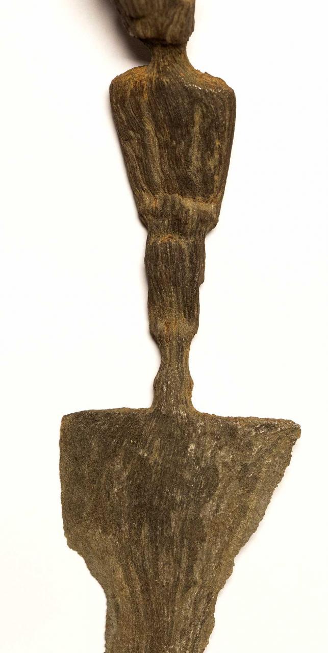

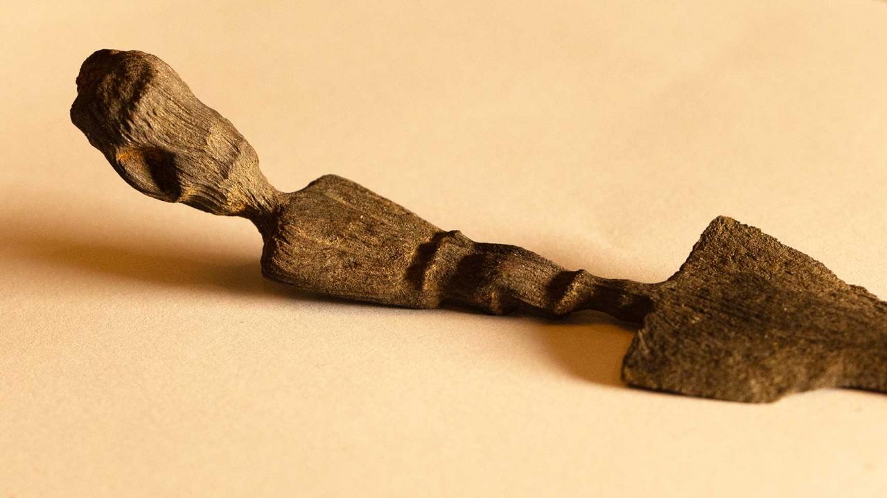

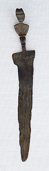

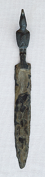

What do you think of this Keris Sajen / Majapahit. Old?
Another question - in terms of timeline, would it be sombro first or Sajen first?
Cheers.

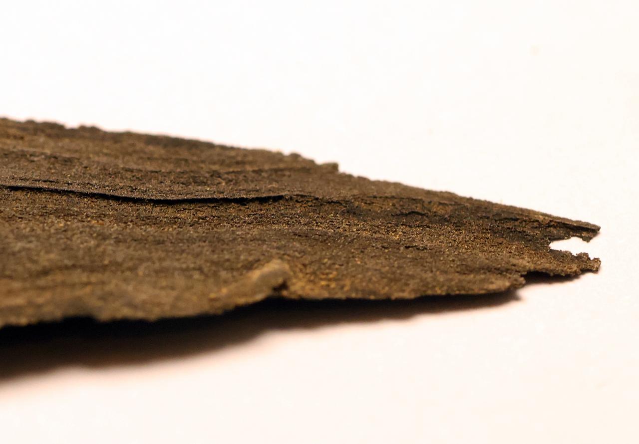

Yes, this does appear to be a legitimately old keris sajen, but i don't really find it possible to get too exacting with ages on these since the form does not change much over the centuries. When more modern features are added to a sajen keris it becomes easier to classify it as a later variety, but the basic forms were also still be made later on.
I believe Empu Sombro was supposed to have lived during the middle Pajajaran in the 13th century. The date generally given for the beginning of the Mojopahit period is 1293, the very end of the 13th century. Keris Sajen are often called Keris Majapahit due to the belief that they came about during the Mojopahit era, but some seem to believe the form may have developed earlier. So that would make them somewhat contemporary to each other. That said, i have also see accounts that place Empu Sombro in the 10th century. So i'm not sure how much accuracy in these datings there actually is. Let's just say that both these forms seem to have come about in the early years of keris development.
Old 7th May 2024, 02:28 AM   #21
Posts: 7,260
Yes, a sajen, no trace of Sombro in it.
Yes, old, but after the common use & understanding of the waved keris as a societal icon, so after the spread into general society of the waved keris, & that means after Islam as societal influence, possibly after Islamic dominance of Javanese society.
Ball park guess, after 1600.

I am of the opinion that the keris sajen came into being at a time when esoteric attributes were already well established as a characteristic of the keris.
If we go to the old literature it seems clear that initially the keris was purely a weapon, this weapon has altered in both form & function over the last 1000 years or so, & these alterations reflect societal needs & beliefs.
The esoterica that surrounds the keris seems to come into being after the keris as we know it now became iconic of Javanese society, & this did not happen until after the rise of Islam.
The name "Keris Majapahit" for this form of keris seems to have come from outside Jawa, I think it was originally coined by one of the early European researchers or Javanologists.
The name "Keris Majapahit" for these little sajens is one I never heard in Solo in the 1970's. When a Javanese person talks about a "Keris Mojopahit" he is talking about a keris of tangguh Mojopahit, not a Keris Sajen.
I have never done much research on the keris sajen, the hilt figures seem to vary in accordance with the type of people who were regarded as figures of power when the sajen was made, so you get Turkish style hats, Euro style hats & so on that serve to identify the figure.
I built a good representative collection of sajens, and had them in my site photo gallery, but I passed that collection to a new owner, probably ten or fifteen years ago.
I think that we are all aware of the distinction between keris knowledge & keris belief, but very often the keris belief does become keris knowledge, at which time it becomes knowledge of a belief system. Somewhat the same as the knowledge of any other belief system.
