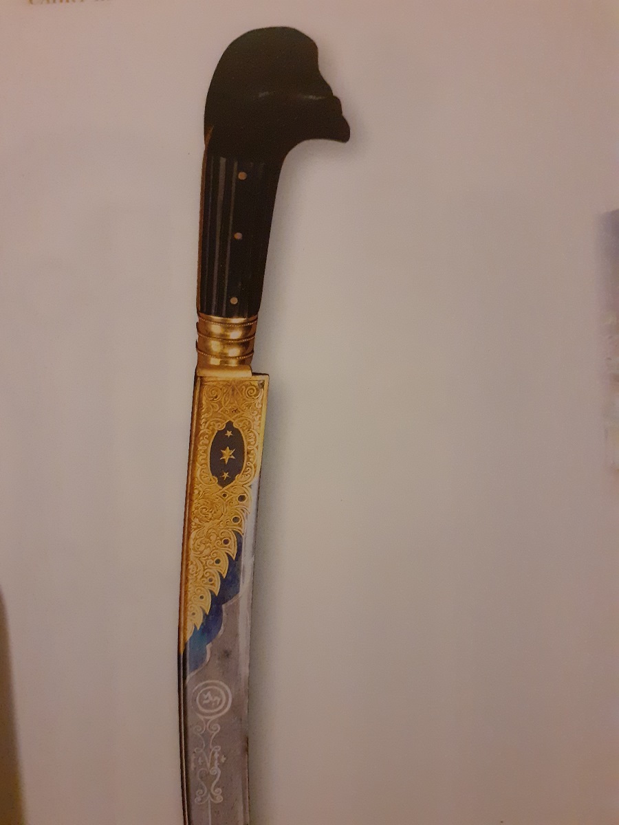

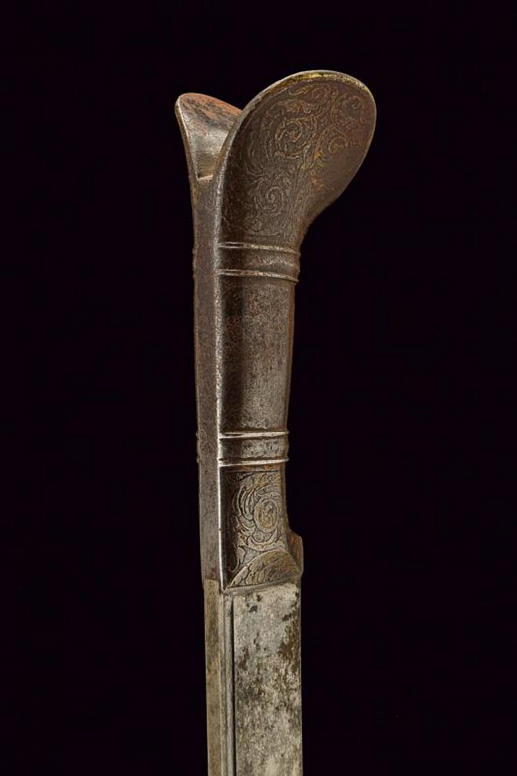

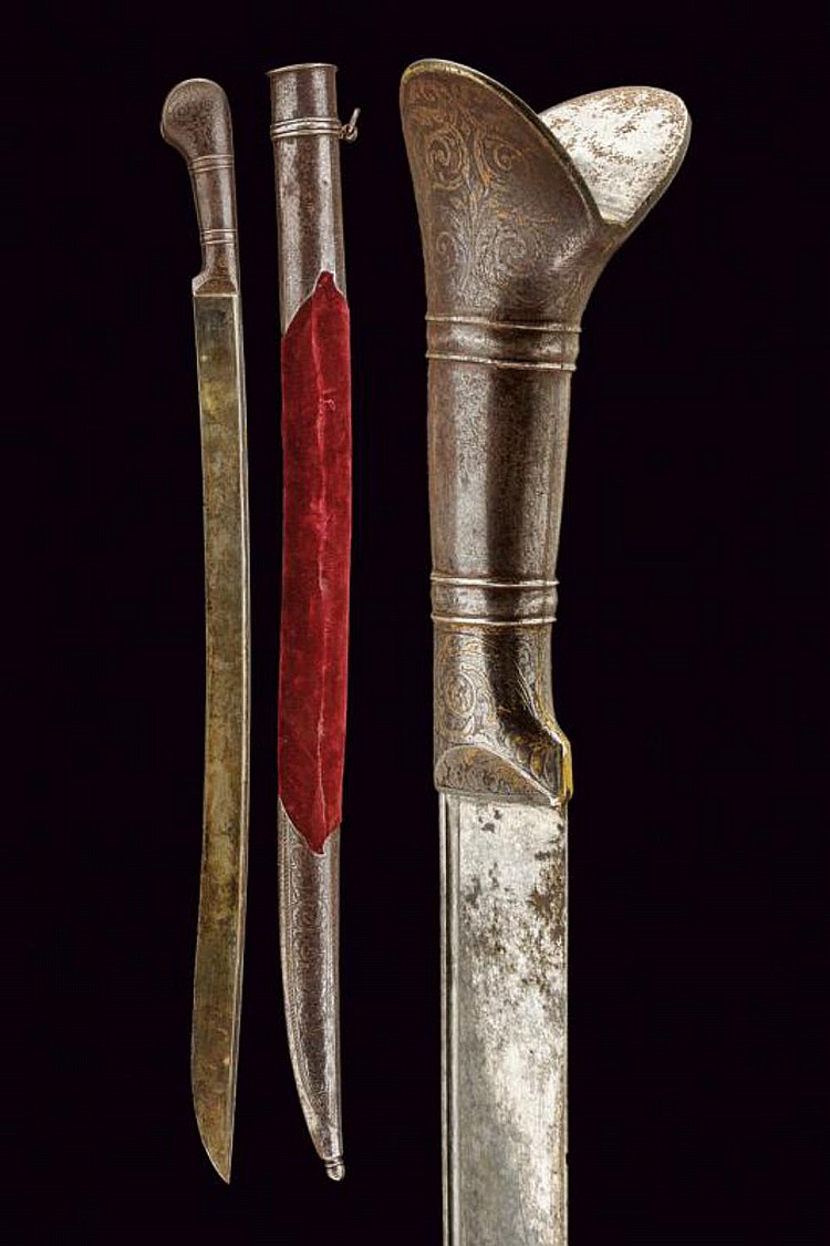

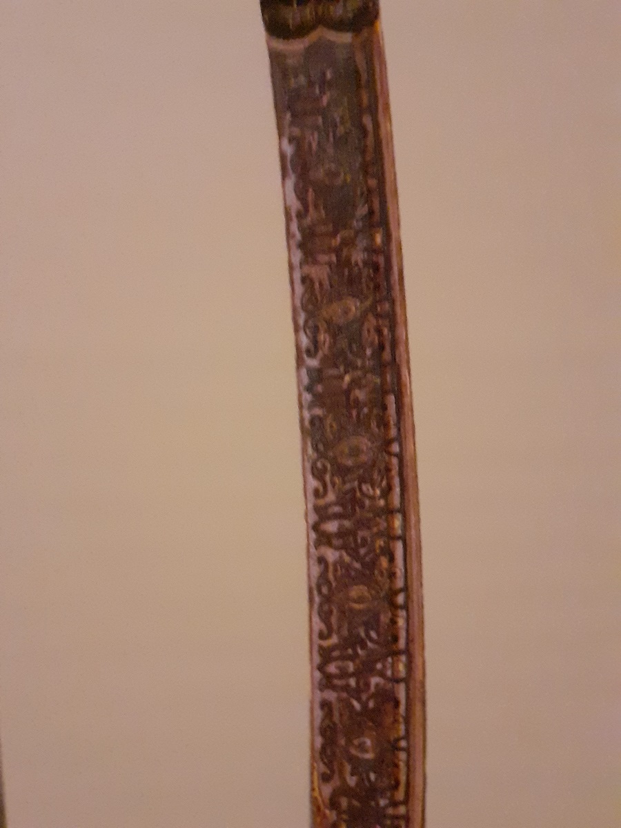

Would any of you know if there is documentation or literature on yataghans produced by Zlatoust ?
If positive, kindly requested to provide details, even if they are written in cyrillic Russian
What I could find, and little do I know , was that quite some were dated back to the Crimean conflict between the Ottoman and Russian empires.
The first 2 pictures are no yataghan but a nice shaska, the others are yataghans.
Thanks a lot for any input, most highly appreciated!

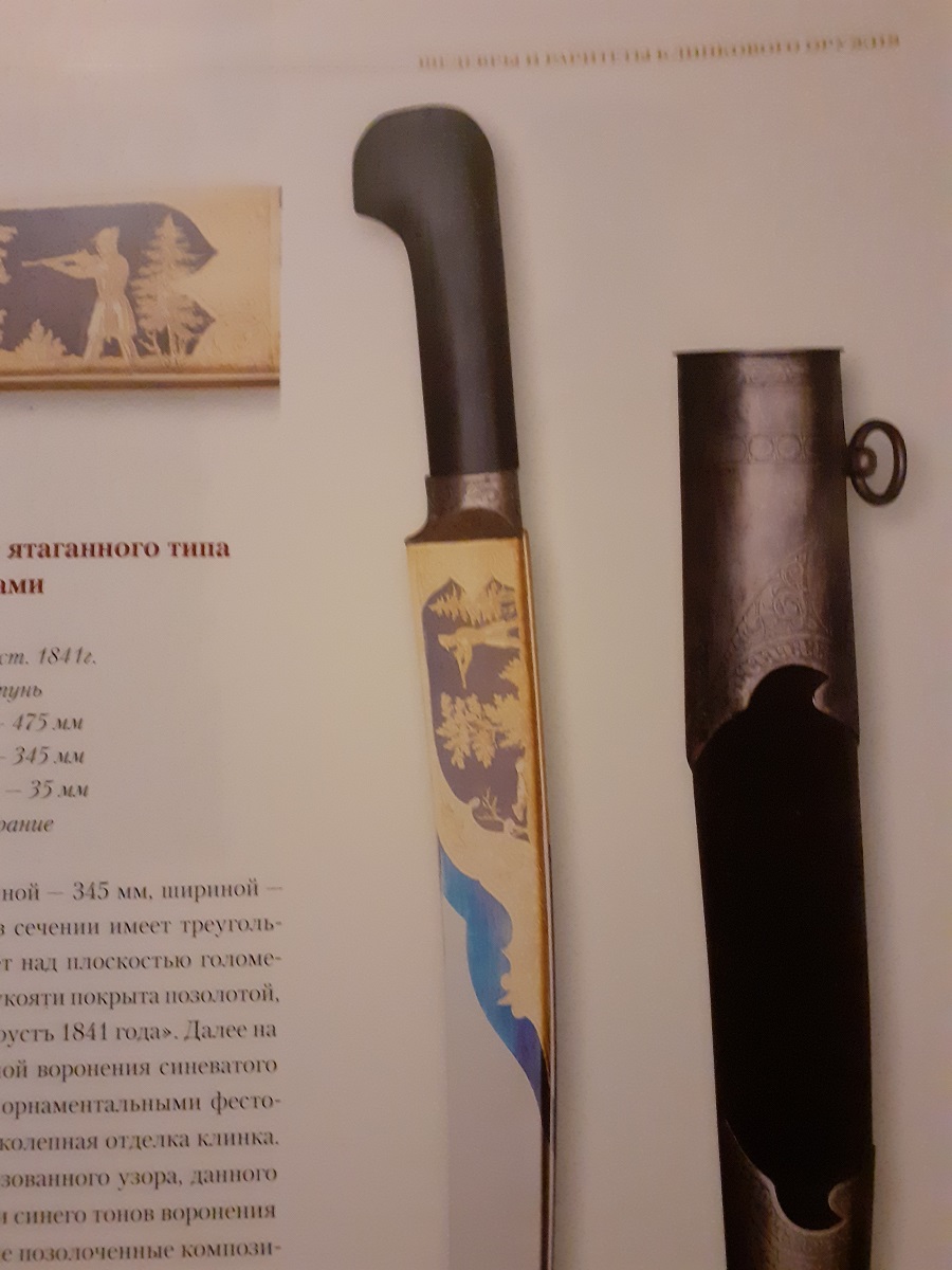

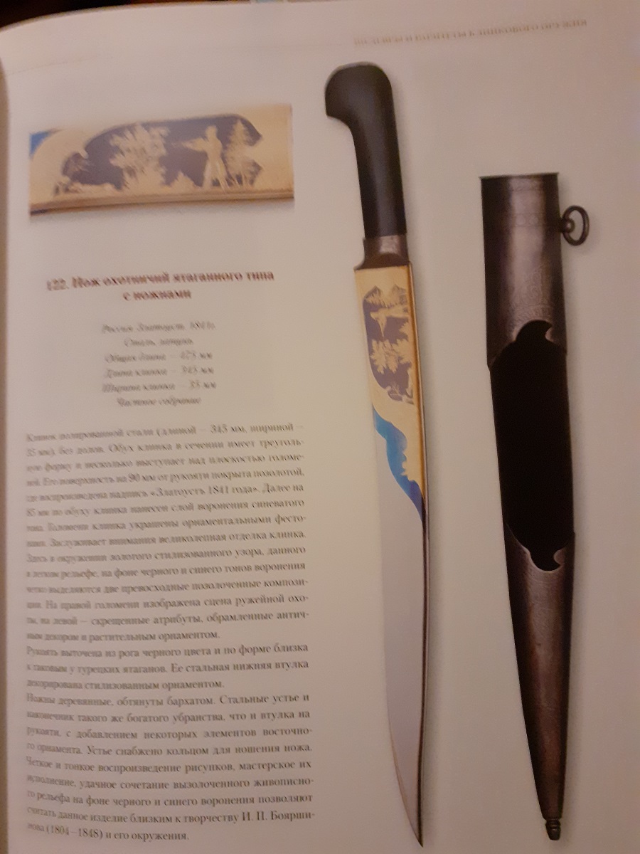

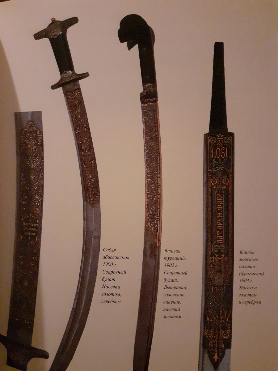

Hello gp
My friend from Russia sent me these photos and a link.
He asked me to tell you that the checker that you posted in the topic is a modern fake that has nothing to do with Chrysostom. The last scimitar also has nothing to do with Chrysostom.
My friend said that as far as he knows in Zlatoust, scimitars were made individually in different years. They were usually made as gifts or curiosities.
https://www.hermitagemuseum.org/wps/...c+armor/666282
https://www.hermitagemuseum.org/wps/...c+armor/666269
https://www.hermitagemuseum.org/wps/...c+armor/666294

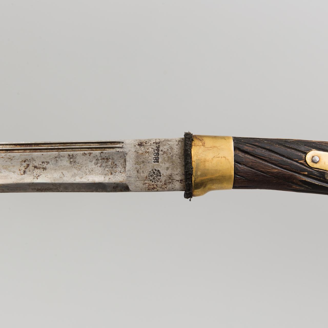

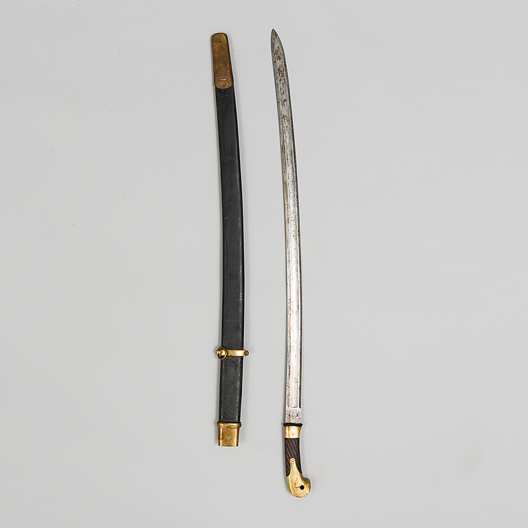

thnx a lot again !
a nice pic, not of a yataghan but from the Zlatoust collection
and 2 links as well

Thanks for the links and photos. These are excellent examples of modern work from Zlatoust.

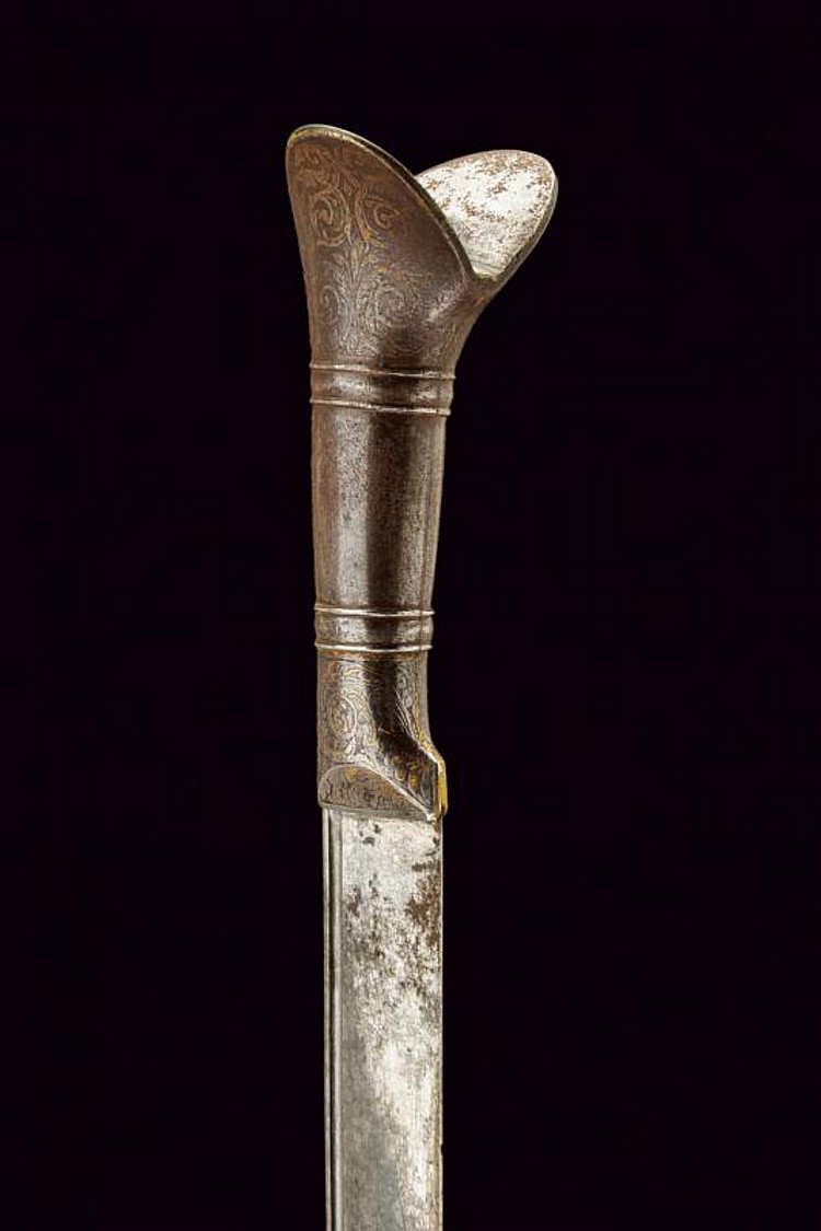

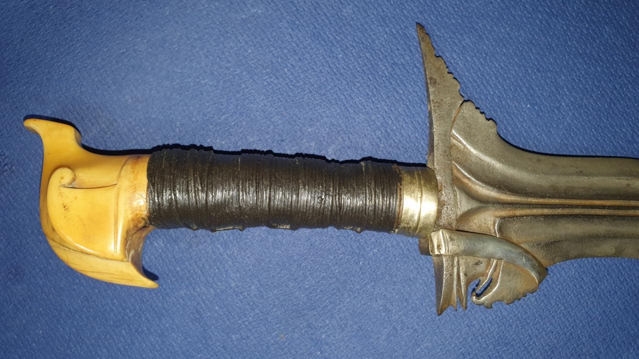

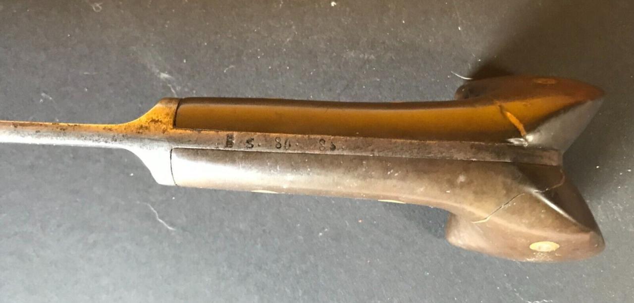

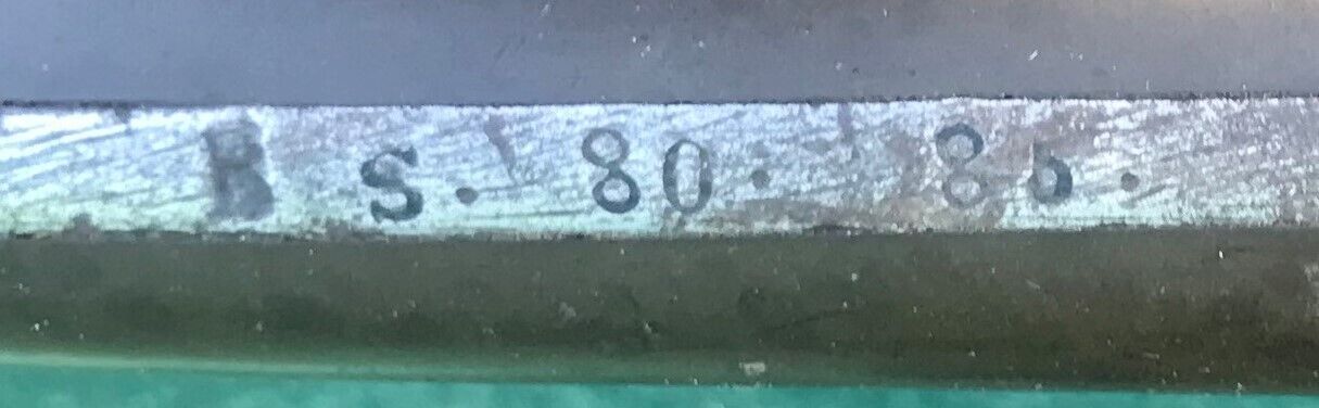

The yatagan shown has nothing to do with the Russian Empire and the weapons factory in Zlatoust It was produced in Austria-Hungary for Dalmation Landwehr M1869
https://jatagani.hismus.hr/webe/hld/...i/b000168h.htm
.....I would like to see a factory-made weapon from the Tula and Zlatoust military factories for the Ottomans
the first russian military shashka you show is a chinese made fake made in longquan in the last 10-15 years by the way
thank you very much for the update!
Would you have a picture of the original one ?

Last yatagan isnt russian but austrian, it is called dalmatian yatagan made for dalmatians in austrian employment in dalmatia, 19 century.
Crude blade marked, and black horn or bakelite handle.
