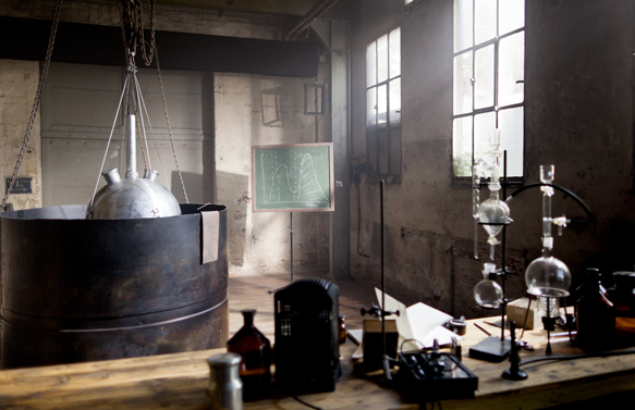

Apparently German scientists were busy using uranium dioxide as well for their efforts to achieve nuclear fission, resulting in a dramatic accident and fire lasting two days, near Leipzig in 1942 (this was preparation 38).
In other cases the Curies in Poland were experimenting with radioactive minerals to create radium and polonium in 1890s-1900s, the radium used to illuminate watch faces Madame Curie died of radiation poisoning.
While it sounds as if the cases for radioactive contamination varies depending on the elemental content of the minerals involved, case in point, uranite which is noted as highly radioactive and capable of this.
The use of these uranium compounds commercially, as well as in the controversial processes of nuclear power or fission seem to suggest that the processes and reactions from radioactive emissions which existed would vary but certainly existed dynamically rather than being inert basically.
Image Leipzig, 1942
