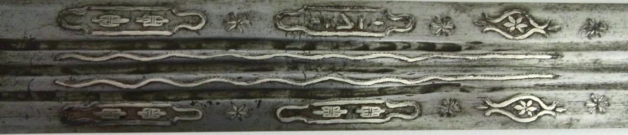

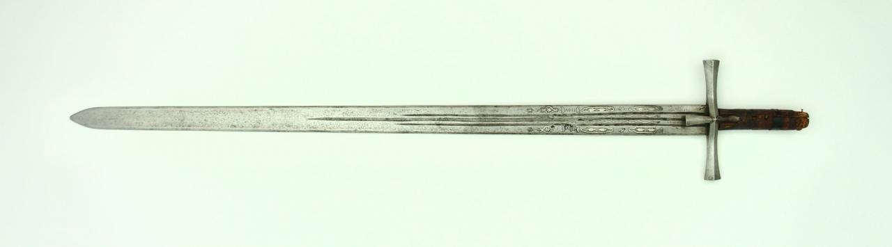

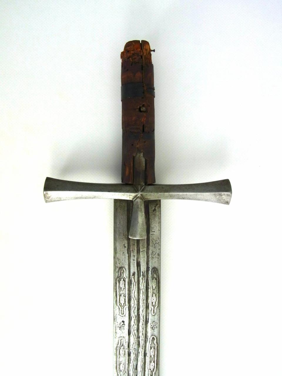

A kaskara with a very peculiar characteristic. The handle is quite worned and the pommel and the leather covering is missing. The most interesting part is the blade that has a triple fuller and close to the forte has silver inserts in the form of flower/stars and geometric decoration. It also has two incription. In one side inside the cartouche is written “I > I”.In the other side there is a date in arab numbers of 1108 that, translated in gregorian calendar would correspond to 1696. It would, to my knowledge, the older blade in a kaskara. It is 100 cm long. Unfortunately no scabbard.

It would be tempting to conclude that this kaskara dates back to the 17th century, but it might also be incorrect to do so. There are instances of Islamic arms dated with an early date but with blade styles that are typical of much later periods - some yataghans for example. This could be a similar situation, where an earlier date was applied to a 19th century blade. I am not suggesting that this was done in modern times - given how the date and the dukari markings are situated within the silver inlay decorations this was certainly done in the past, when the blade was decorated somewhere in the Sudan.
The blade itself looks like a fairly typical trade blade with the 3 narrow fuller pattern. These were mostly exported to Sudan and the Sahel in great quantities during the 19th century. Sure, the pattern was based on earlier European broadswords, but in the absence of additional marks it is hard to date the blade with an absolute degree of certainty. The guard is also of a type that is found on 19th and even early 20th century swords - Ali Dinar's swords come to mind.
Looking at the sword as a whole, I see an attractive, most likely 19th century piece. There are takoubas with early, 17th century blades and even earlier ones, and I would be excited if I am wrong and this sword can be convincingly dated to the 17th century, but outside of the date, which could have been engraved at any point in time, there is not nothing else to support such a dating.

obviously the date could have been applied in later time. However, may be it is because of my limited knowledge, but do you have evidence in other kaskaras with these these decorations? Is there any silver inserts in the Sudanese or Egyptian swords of the XVII-XIX century? You sure have more experience than me. On the other hand also the guarda and the forniture could have been remounted on an older blade. Surely not easy to solve the problems. We add information after informationand may be in the future we shall be able to solve the problem

The silver blade inlays on a kaskara are new to me, impressive. That doesn't negate that an owner wanted to add them. Silver does have protective qualities. although usually added to the grip. The wavy lines may be to indicate snakes which were a protective talisman. The other inlays are likely symbolic as well. The central fullers don't look as sharp as would likely be in an imported trade blade. This could just be the lighting on the foto. Is the blade tapered in thickness? In the late 19th C. some Solingen blades were made with a blade mill, a small adjustable rolling mill that would quickly thin a red hot billet into a sword blade without anvil forging. In that case the blade would likely be the same thickness lengthwise. Local blades always had a forged distal taper. The blade tang appears to be penned to the wood grip piece. That would indicate a tang hole. I'm not sure if Sudanese made blades had that feature.
I agree the date was added later where a flower was removed and the blade smoothed. Have no idea for the meaning.
The cross guard is good quality likely forged in the early 20th c.
Ed
Last edited by Edster; 27th April 2023 at 01:54 AM. Reason: Added about protective silver

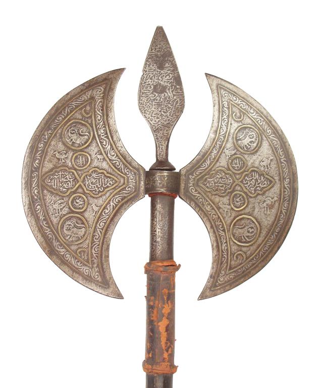

Brass and silver inlay is found on axes from Sudan. Here is an image of one, I believe the source is Auctions Imperial and hopefully Oliver would not mind me posting it here:

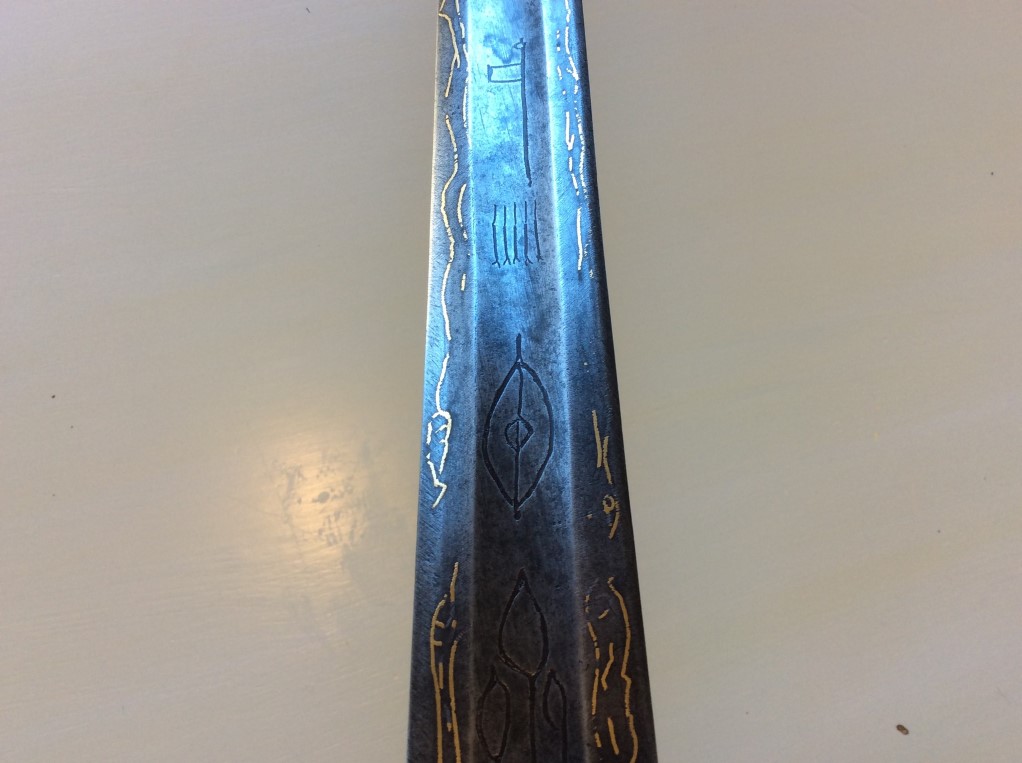

JIm, regarding the two kaskara hilts shown in the above post by you; a question, has anyone come up with a meaning or origin of the mark on the right hand blade? Does this mark signify european or local manufacture?
The Kaskara that I own has this same mark, and maybe my memory is failing me but I can't remember whether it was identified.

Rick, you and I are likely on same memory issues, but this strange mark as far as I know has never been identified. I recall we termed it the 'enigma' and there were notions that it might be related to some of the unusual marks seen in Briggs (1965). I recall even thinking it might have been related to some Sudanese cattle brands, which had a moment of promise but no further support.
It seems you and I have the only examples of this mark (that I can recall), but these discussions were 14 or more years ago, and I think I've had the sword for about 20 years or so.
The mark does not indicate European source for the blade, but it may be a copy of one.
Really hoped we'd find some solution, but there are many 'enigmas' with these weapons.......shaver cool man!

The foto of the grip shows what looks like the top of a pen in the wood for a whole in the tang.
With blades known to have been made in Kassala, it's difficult to tell the difference between a locally forged blade and a munitions grade import. The Kassala smiths make/made blades daily for years and know their work very well. Of course some have a better touch than others. Maybe a smith of lesser talent (either in Germany or Sudan ??) made one set of fullers and another more accomplished smith produced the other side. Its the same way with cross guard specialists although since about 1945, most cross guards in Kassala were made in the folded one-piece style.
Ed

I also have a kaskara with the 'fly' mark variant on the blade, discussed at https://www.vikingsword.com/vb/showt...hlight=kaskara, it is also under the languet as well as further down the blade
