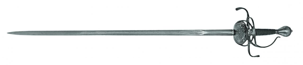

For example, in shayde78's recent wonderful thread on pappenheimer he posted the following image of his own sword
(http://www.vikingsword.com/vb/showthread.php?t=25744)
Originally Posted by shayde78 View Post
He follows this by saying he is about 6'4.

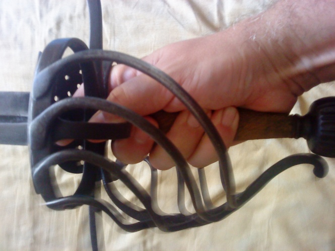

Meanwhile my hand (I'm 6'3) seems to be dwarfed by the hilt on my own pappenheimer.
So my question is what is the reason for such a disparity in hilt sizes? I feel like if the purpose was for better sword balance then why not just change the pommel size? Or was this just to boost someone's ego by having the "bigger sword".

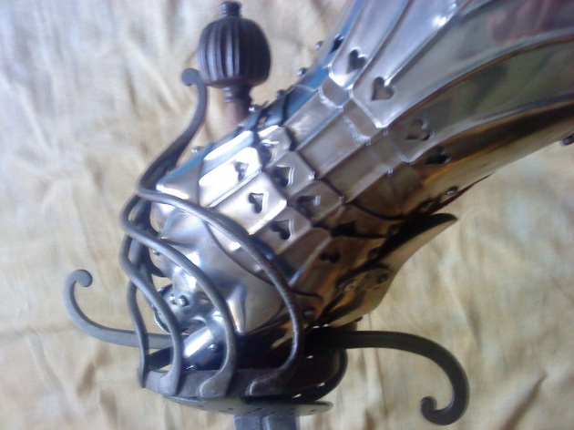

I suspect that there are just variations, but possibly also driven by what you will be wearing on your hand. The C17th infantry swords I have (some hangers and a proto-mortuary sword) have small guards because I think the users would have bare hands or simple leather gloves. The cavalry weapons have bigger guards because I think they'd (ideally) be wearing thicker gauntlets or plate gauntlets if cuirassiers.

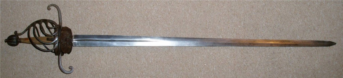

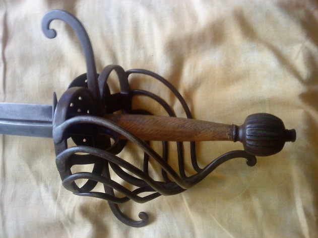

I have this thing which I suspect it could be a Swedish haudegen from the time of Lützen.
Measurements are something like 117cm total length, 93cm blade and 1495gr total weight. There is a thumb ring. The handle shows wire marks. The front edge seems to have been sharpened more often than the back.
In spite of the huge size and weight, it handles nicely, specially with a gauntlet.
It could be a Victorian monstruosity as well.

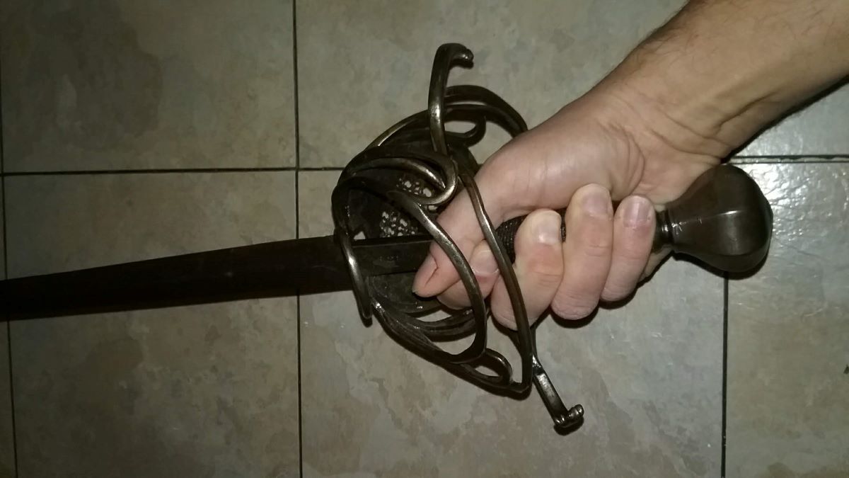

My hand (not very big) in my Pappenheimer. This has a rapier blade, so may have been for civilian use.

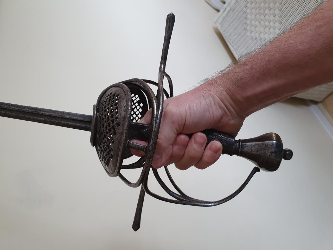

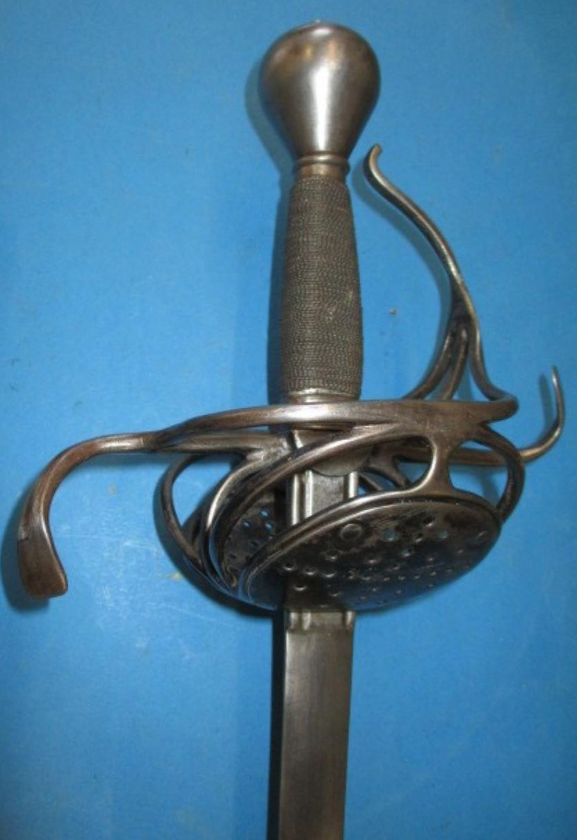

I acquired this recently purely because it intrigued me and it was very cheap.
It was made by Pillin and Co. for a member of the Knights of Malta which were an off-shoot of the Knights of St John... apparently (see labels).
The blade is from Thurkle with a T slug.
Anyway, the point is this: the hilt is 8&1/4 inches top to bottom and the same from quillon tip to quillon tip. The pommel is huge and very heavy.
On this 31 inch blade is is decidedly unbalanced.
Pillin must have referenced a traditional example, copied the hilt but decided against a longer blade.
