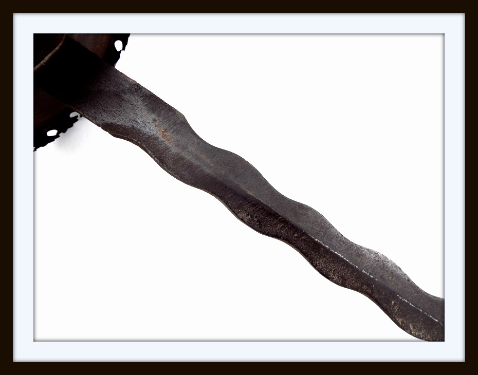

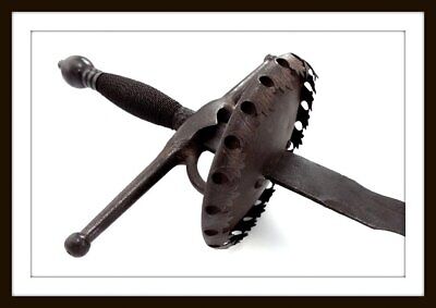

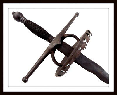

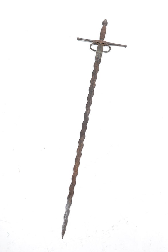

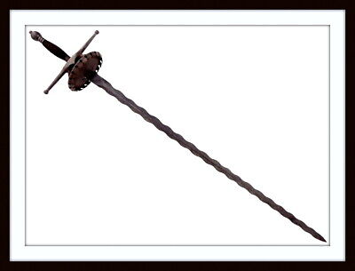

Hi everyone!
It has been awhile since I have posted anything, but I'm hoping you can indulge my idle curiosity.
The item pictured below just closed at auction. It looks identical to an item that has for years been listed as "sold" on the Fagan Arms site.
I have this item's twin in my collection, but mine is missing the very unique guard. On the Fagan site, the photos made the guard look like cheap sheet metal and purely theatrical. However, these recent auction photos make the guard look like a much more substantive piece of iron that has been skillfully wrought.
I still feel the uniformity of the quillion and pommel suggest Victorian, but wanted to get everyone's opinion.
As always, thank you for sharing your knowledge

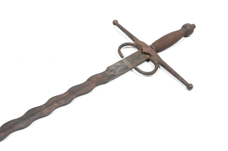

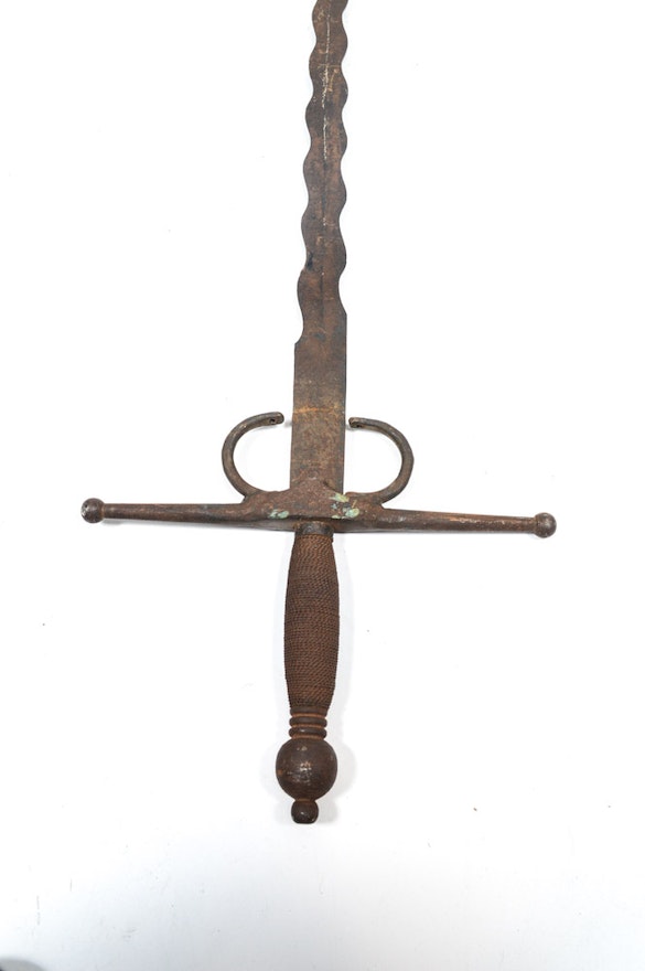

Old 18th March 2023, 01:11 PM   #2
shayde78
shayde78's Avatar
Join Date: Mar 2017
Posts: 445
And, for comparison, here is the piece in my collection. I bought this as a Victorian replica, and have wondered what the missing guard would look like. I'm still leaning towards that time frame, but wouldn't be disappointed if it were older

At the Madrid Royal Armoury there is dish hilt rapier with a flamberge blade that belonged ro Felipe IV. Toledo Factory made replicas in the last third of XIXth century of this and other rapiers and these can be quite deceiving and not always marked. Page from c1910 catalogue. They were produced for so long that variations are common. I have seen later wall hangers modeled on the factory copy, too, without the dish in the example at the bottom.

This is an interesting topic and swords, and while I cant add much to these shown (I try to avoid comment on Fagan), the sword replica shown (not the suggested Fagan example) is interesting in its own merits as often these Victorian examples are remarkably well done. Indeed those, especially by Schmitt of Munich were so much so that many resided in museum such as the Higgins for many years thought to be original. For purposes of arms history, these of course defeat the inherent purpose of study. However for those who have deep interest in style and form, more artistically oriented, they serve that purpose. .
I wanted to note the term 'flamberge' has an interesting history/etymology of its own. Actually the reference to these undulating blades is correctly 'flammard' in the European sense, from what I have understood.
The term flamberge seems to come into arms vernacular from Egerton Castle ("Schools and Masters of Fence" 1885) most likely from Moliniere, and the use of the phrase 'mettre flamberge au vent' in the disdainful reference in France toward flamboyant (another term for undulating blades) swords.
This had to do with someone drawing a small sword with great flourish as if it were a 'great sword' of the paladins in the Chanson de Geste, medieval narratives.
I always had the impression the undulating blades were allegorically the Biblical flaming swords much as in many traditional legends in many cultures. I think mostly comes to mind with these kinds of blades were the zweihanders of the landsknechts of Germany and Switzerland. There is no particular advantage pragmatically for this type of blade, but certainly they carried this kind of allegorical character.
The term flamberge according to Oakeshott is more familiarly applied to dish hilt rapiers and light transitional types of rapier to distinguish from the more orthodox forms ("European Weapons and Armpr", 1980, p.165).

Thank you midelburgo, jim, and fernando!
This partly why I had never posted this item before, but the recent auction made me question (hope?) my original assessment was wrong
As always, thank you for the honest feedback.
