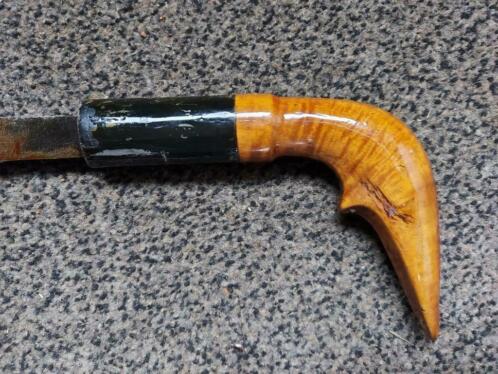

Originally Posted by werecow View Post
Alright, thanks for the pointers!
You're welcome! BTW, it's a nice Kabeala, nice grain to the wooden handle. Attached is my own, similar example.
Ah, that is almost identical! Do you have any more information on it by any chance (age, etc)?
Kabealas are still in use on Sumba so you can find quiet recent/vintage examples in nearly identical appearance. I get my one from a friend in GB, judging by the wear and patination I guess around WWII or short before.
It was shown before in this thread: http://www.vikingsword.com/vb/showth...hlight=kabeala

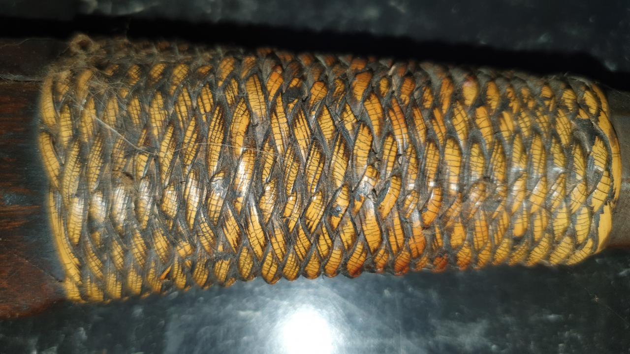

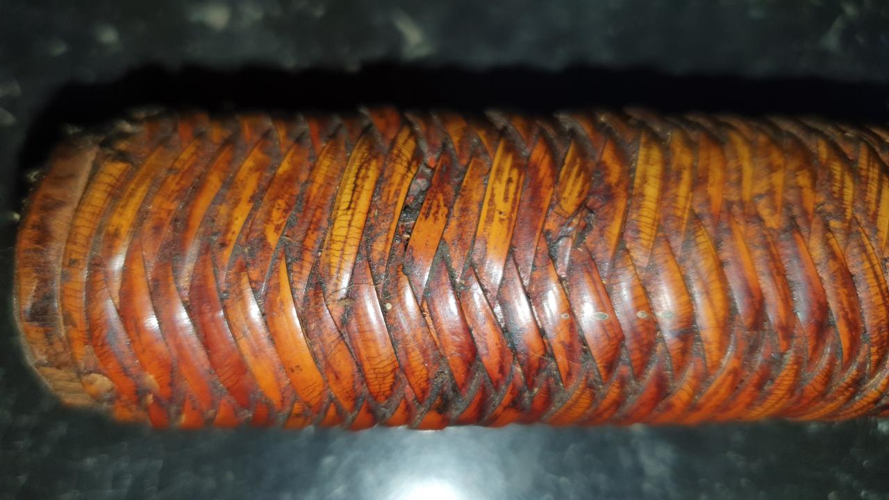

A very good indicator of good age are always the small cracks in rotan bindings,
see the attached pictures from some of my items, just use a good magnifying glass!
Interesting. Would varnish protect against such cracks, or do they still form regardless?
FWIW I don't expect my kabeala to be particularly old. Does the presence of varnish itself say anything about the likely (minimum) age range, or people still do that today?

I think that those cracks are already present when someone will coat an item. They come from age and handling.
I would place your example carefully as mid. to end 20th century, judging by the color of the wood but keep in mind that light/flash can cozen.
