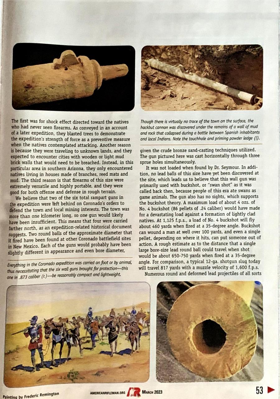

The latest issue of American Rifleman (March 2023) had an article, perhaps of interest here, regarding an archeological find from the American Southwest. (My apologies for the quality of the scans, from my phone - the individual pages are attached due to file size restriction.)
I am particularly intrigued by the suggestion that the piece may be of New World manufacture.

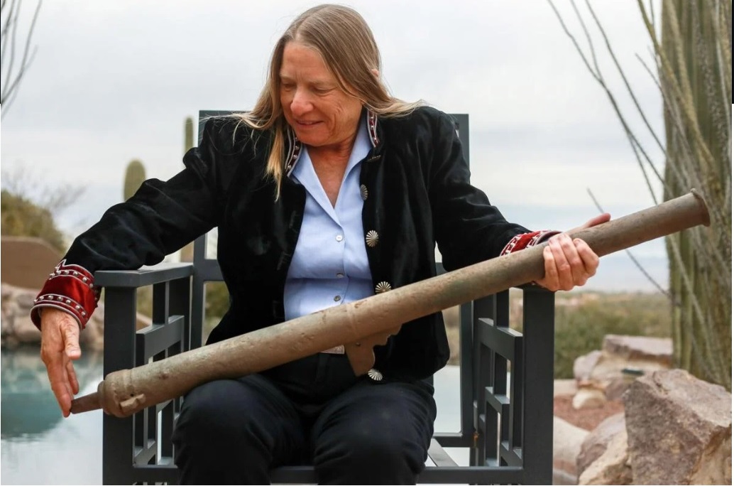

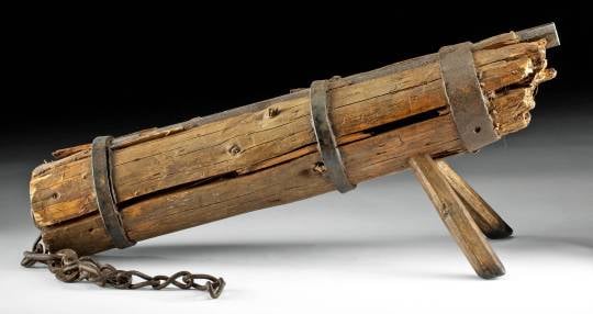

Just for the fun, see attached a picture extrated from a Spanish military history blog, labeled as primitive XV century Arcabus de Gancho (literaly haquebut) designed to use in walls. And a brighter picture of the Coronado gun, in the hands of its finder (Courtesy Tucson.com)

I cast doubt on the copper tube being a weapon in usable condition, and got more info in Bill’s reply here, so their claims seem more credible now.
“By the way, I wrote the article. There were no uderlugs on the barrel for the attachment of a half, or full-length stock. There was likewise no tang. Check out the drawing in the article from Maximillian 's arsenal inventory in 1501 that shows them with tillers and no locks. The gunner is shooting it with a handheld match. Yes, some hackbuts had stocks, but they had underlugs and/or tangs to secure the barrel to the wood. We had the foremost crime lab firearms expert examine the piece for toolmarks, as well as the expert who was in charge of the relics recovered from the Custer battlefield, and both said that the marks on the gun, including the dings on the muzzle, were from transporting it over 1500 miles on the back of a mule. It was banging on saddle nails, iron buckles, picket pins, etc,. which is shown from repetitive dings in the same spot. The photo of the muzzle is deceptive, because the gun was/is still imminently shootable. I have been shooting muzzleloaders for over 50 years and tried to talk the archaeologist into letting me shoot it, with no luck. Ha!! I could also shoot it without the tiller with no problem whatsoever, given the weight of the piece, especially if the powder charge was reduced a bit. It could also have even been transported much further than 1500 miles if it was originally cast for the Cortez expedition some 20 years earlier. Hence more dings. We know he cast many guns of all sizes in Mexico, and I read somewhere that a gun foundry was firmly established in 1526. Finally, the bore was full of dirt when recovered, and we analyzed that dirt in sections. There were flakes of carbon in the breech from having been fired previously.
Take care,
Bill Mapoles”
