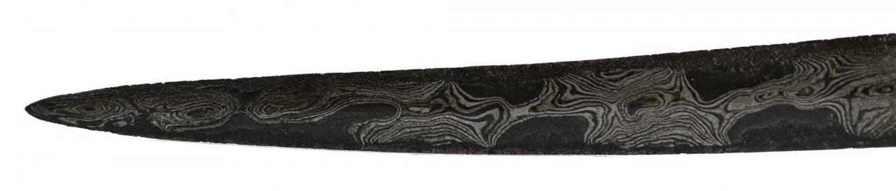

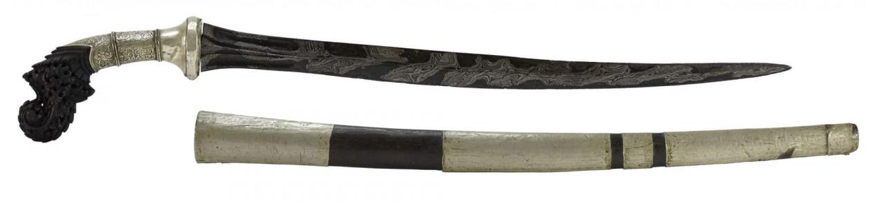

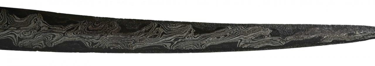

I am going to get this item. And I got questions to ask out of curiosity.
1: Is the sword modified from an existing keris bilah?
2: This is lombok type of keris sword?
3: Is the bilah a former keris?

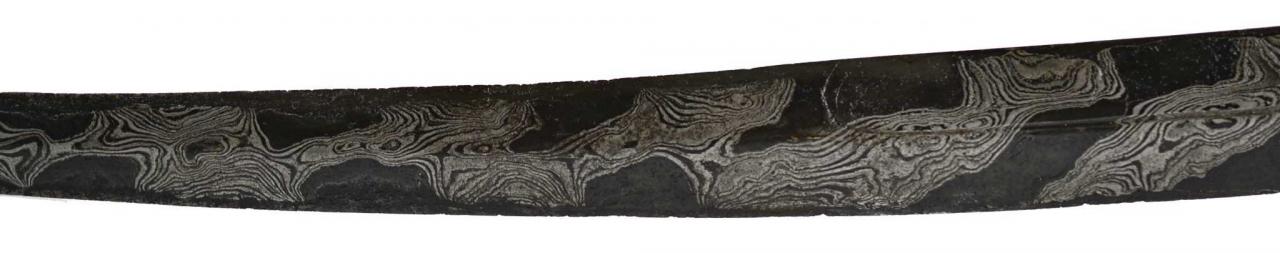

No Anthony, based upon what I believe I can see in the photo, this blade has been made to incorporate characteristics that are usually found in a keris, but in my opinion it is not a keris blade that has been altered.
However, if microscopic examination of the blade edges of the curve show distortion and/or cracking, then alteration might need to be considered.
Yes, it is Lombok, where it would be called a klewang.

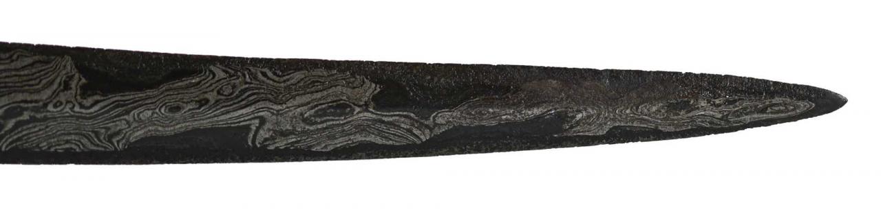

Hi Alan,
Thanks for the valuable advice/info.
I also attached more photos with edge pictures.
Anthony G. is offline   Reply With Quote

forgive my ignorance, but is is this not a Javanese Pedang Lurus ?
We see a fair amount of such blades in there Netherlands.
If this is what I think it is the blade is not a repurposed kris blade but a specially made blade, slightly curved and the only similarity is the pamor (which is not unique to krises)
http://atkinson-swords.com/collectio.../pedang-lurus/
nope, it is not

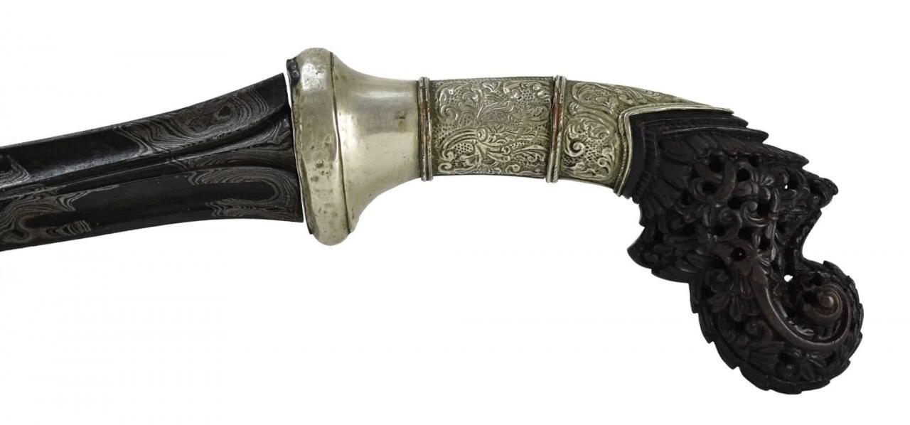

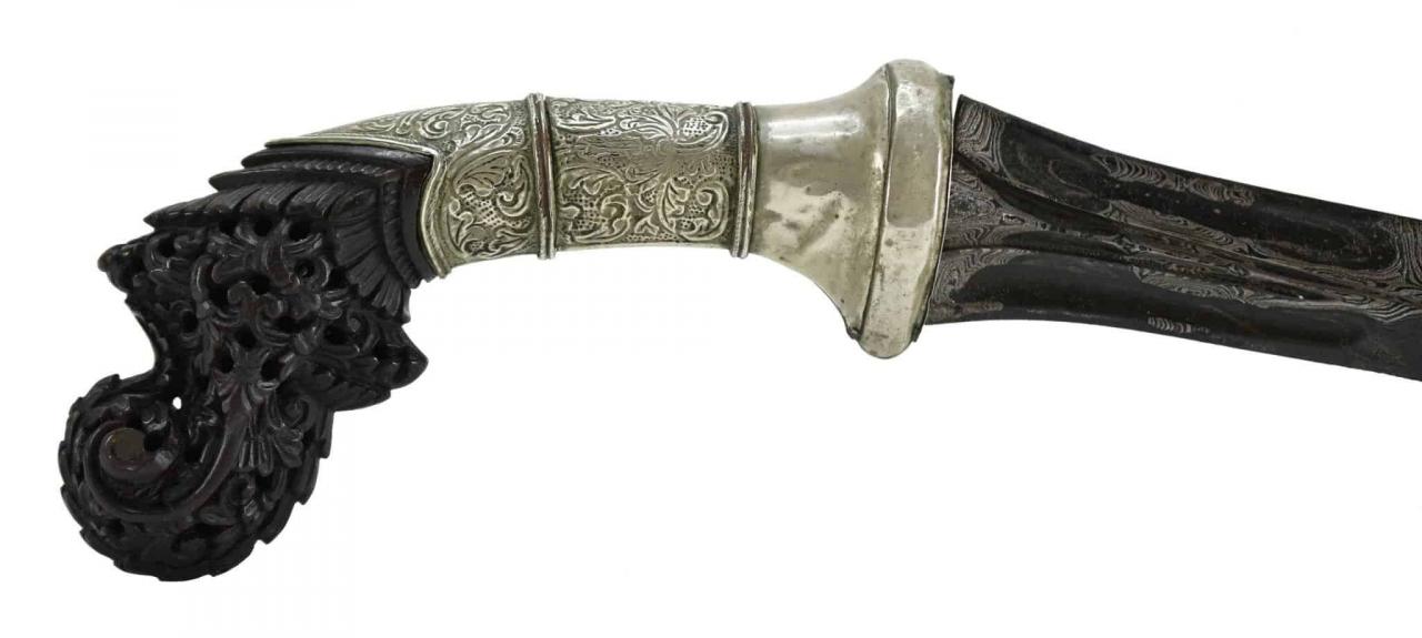

the dress is clearly Lombok, and the hilt is of Garuda Mungkur type, though heavily stylized to obscure the "animal shape" and to look more floral
and pedang lurus is truly odd name, as it was literally means "straight sword"
we did not use the terms "pedang lurus" here ... I think it was a mistranslation somewhere when Indonesian sword terminology got there

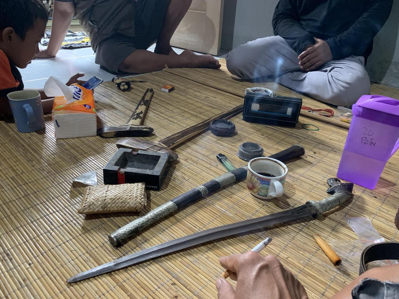

1. nope, it is originally made like that
2. yes
3. no
though the dress type is commonly found in Kelewang, I disagree that this was a kelewang
the existence of sogokan is the proof that this one is a variant of Sundrik
not the commonly seen, but not kelewang in my opinion
see the comparison specimen on the photo - belonged to a friend in Mataram

Thanks for sharing, it was interesting.

"Pedang Lurus" is descriptive, it is not a proper name, but it is a generic term for any pedang with a straight blade, this klewang has a curved blade, it is not a pedang lurus.
Just as "pedang lurus" is a descriptive name not a proper name, so are the names "pedang sabet" and "pedang suduk/tusuk" descriptive names, pedang sabet is generic name used for slashing swords, "pedang suduk" is generic name used for thrusting swords.
There are many types of thrusting pedangs, and many types of slashing pedangs, all with different names.
suduk means stab, sabet means whip, in krama inggil sabet simply means "pedang".
A curved blade is used to slash.
A sundrik/cundrik is by definition a thrusting weapon.
This item under discussion is dressed as a klewang, thus it is a klewang, however, the blade has not been made in the typical form of a klewang.
It is usual that when any blade is in a particular form of dress the entire object takes the name of the dress, when the blade is removed from the scabbard further classification can be applied to the blade if necessary, however, in this case that further classification cannot be as a sundrik, because here we have a weapon designed to slash, not a weapon designed to thrust.
Sogokan can be found in various types of pedang, I have had several Javanese pedangs with sogokan & also kembang kacang. These features are not common in pedangs, but they do occur.
