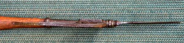

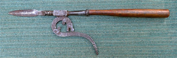

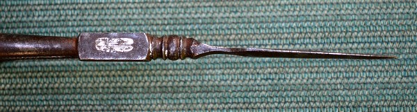

This is what I believe to be an Indian Elephant Goad, even though I guess it could be Indonesian; maybe the crocodile is a hint to its origin.
It looks like something may have broken off the front at some time?

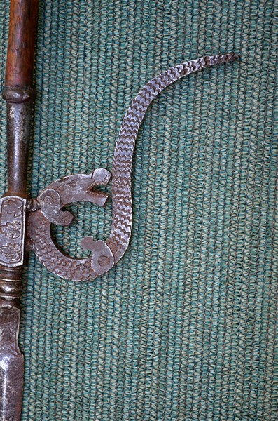

Makara?

Indian ones usually have a steel haft with a spike that is scrwed inside. Also elephant motif.---bbjw

I think interested party is spot on. It must be some form of trishula used in religious festivals, shame it is broken.

Ankus for sure. I don't see anything Indian, but there are some Buddhist art features of Southeast Asia.

Posts: 6,012
Just does not look strong enough.
Let's talk more boldly - it looks somewhat souvenir. Too flimsy for an item to be used to control an elephant.

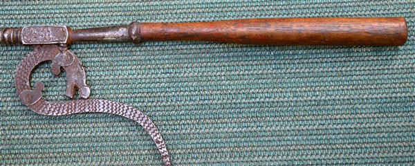

It may be a souvenir item, probably 19th century, but flimsy it is not. It looks as if this has been repaired & reinforced afterward, indicating that this was a working item.

Hello back. Yes, I am aware of how the goad is used; if you look closely you can see that the tip has been broken(probably from misuse). As I am sure that you are also aware, often the Elephant and the rider have a bond, and a mere nudge or prod from the ankus is enough to direct the animal, much as spurs to a horse.
I also acknowledge that my goad(if that is what it is), may have been ceremonial and not for everyday use.

The pangolin attribution is a good one, however, for me, the bulbous nose doesn't quite fit the animal's profile which has a more tapered nose. Let me clarify; the bulbous nose of my creature as opposed to that of the pangolin.

The form and the proportions of that gizmo are those of a garden variety ankus. Nothing else.
Any discussions of a pangolin , whether it was or is a sacred animal in India miss the point. Nobody rides a pangolin.
Similarly, the question whether it is big enough to inflict some pain to an elephant is mistaken: trained elephant responds to the slightest cues from the mahout and pain is carefully avoided, otherwise it will only provoke the creature. In Thailand we had elephant ride near Chiang Mai, I spoke with the mahout and he showed me how he guided the creature with very slight touches. The spear at the end is for killing the elephant if it goes berserk for some reason: a stab just below ( or more precisely, caudally) the skull transsects the spinal cord and causes immediate paralysis. My mahout knew it theoretically, but he never heard of such occurences.
The size of this ankus in question may ( not will !) provide some ideas about the origin. African elephant is the biggest , at ~10 feet tall at the shoulders, Asian ( Indian), ~9 feet tall, Borneo ~8 feet , and the smallest Sumatran one between 7-8 feet tall. There used to be pygmy elephants on smaller islans ( Malta, Crete etc.) and the most recent one on Flores island (<6 feet, and Flores humans <5 feet tall) but they are all extinct. This is a very well known to any educated biologist phenomenon of “island dwarfism” due to restricted habitat and limited food resources.
One can scour the internet and check sizes of ankuses in India and compare them with the current one : if the latter is obviously smaller , one can have a point for its Indonesian origin. I am not very optimistic about this approach: the size of the ankus likely depends more on the size of the mahout:-), but this ankus is so simple and village-made, that there are no ethnic cues as to its origin.
Just an ankus, recent or contemporary

Just for my own edification what do consider recent vintage;5 years, 50 years,100 years old? Also, how did you determine that it is contemporary; have you seen other similar examples around?
The wear, repairs, and pitting would indicate some age to me. The workmanship as well; an example is that the legs are pinned on and not simply brazed, which would have been much easier.
Is it a stunning work of art, no, however it was probably produced by a small village blacksmith, who certainly had a degree of skill.
As an afterthought, it is 18" tall & 5 " at its widest.

Whether this animal is a makara, a pangolin, or a crocodile is debatable and maybe it was left ambiguous by the artist.
