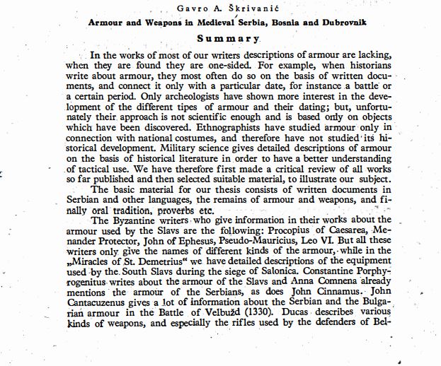

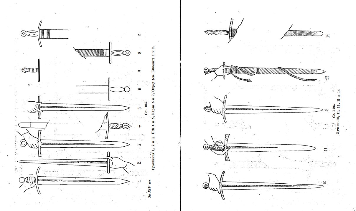

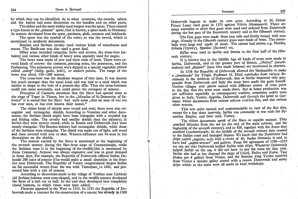

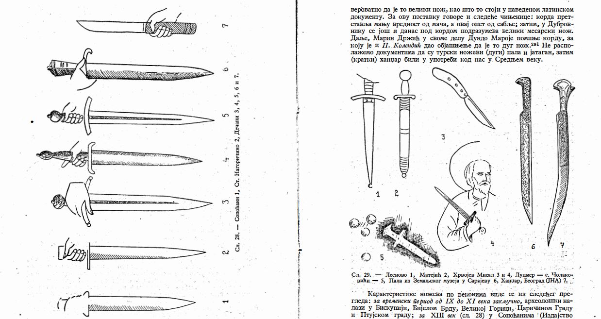

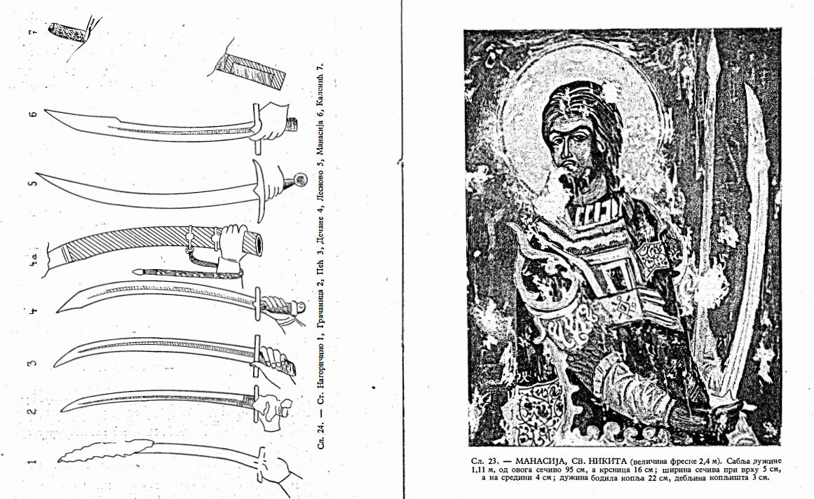

Some information on the topic in an English summary. The complete book can legally be downloaded from the internet.
Although written in Cyrillic, the pictures and drawings are most interesting as you can learn from the 4 (out of many in the book) I have added as an example.

Thanks for sharing this useful document.
I am somewhat surprised not to find, in the illustrations of swords, the flatted square pommels with central bosses, characteristic of the late-medieval spada schiavonesca of Dalmatia, which later evolved into the familiar cat's head pommel seen on the basket hilted schiavona used by Dalmatians and Venetians from the 1580s onward.
