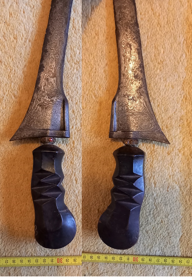

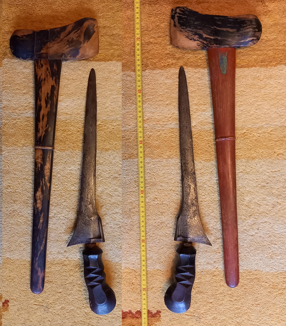

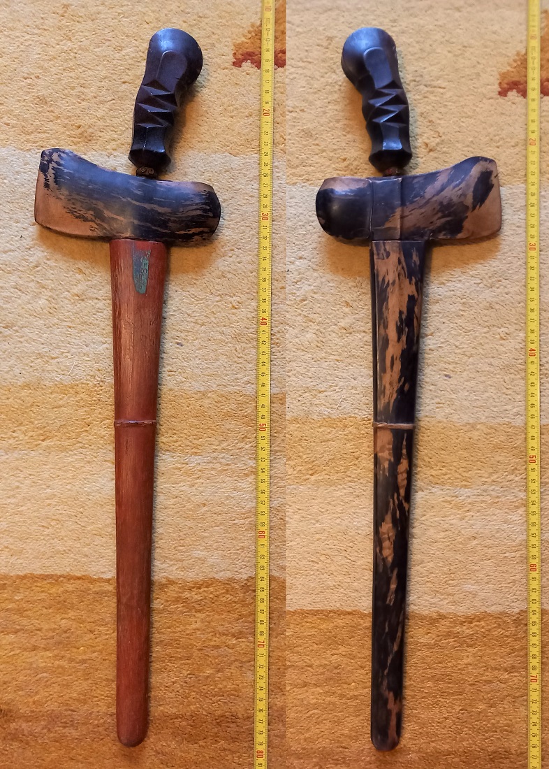

Here is one of the 3 Keris from Bali that I bought in a big batch (the same as the pendok). I'll show you the other two Balinese Keris later.
This lot comes from the great-grandfather of a 50-year-old woman. This great-grandfather was an importer of Indonesian art in France (Bordeaux).
I estimated the period of activity between 1925 and 1970.
The handle is held by hair wrapped around the pesi.

This blade displays indicators that would seem to place it as North Coast Jawa, specifically Tuban Pajajaran.
My guess is it was probably a trade blade and into North Bali.

What you describe about erosion towards the point is the normal reaction to heat treatment of the blade.
Very often keris blades are hardened for only the first few inches and it is almost unheard of that hardening will ever move into the sorsoran. The hardened steel erodes much more easily than unhardened steel and iron. Keris blades were never drawn, only hardened, the laminated plates of pamor comprised of iron & nickelous material provided protection against breakage. The softer unhardened section of blade acted as a "shock absorber" and permitted a blade to bend without breaking.

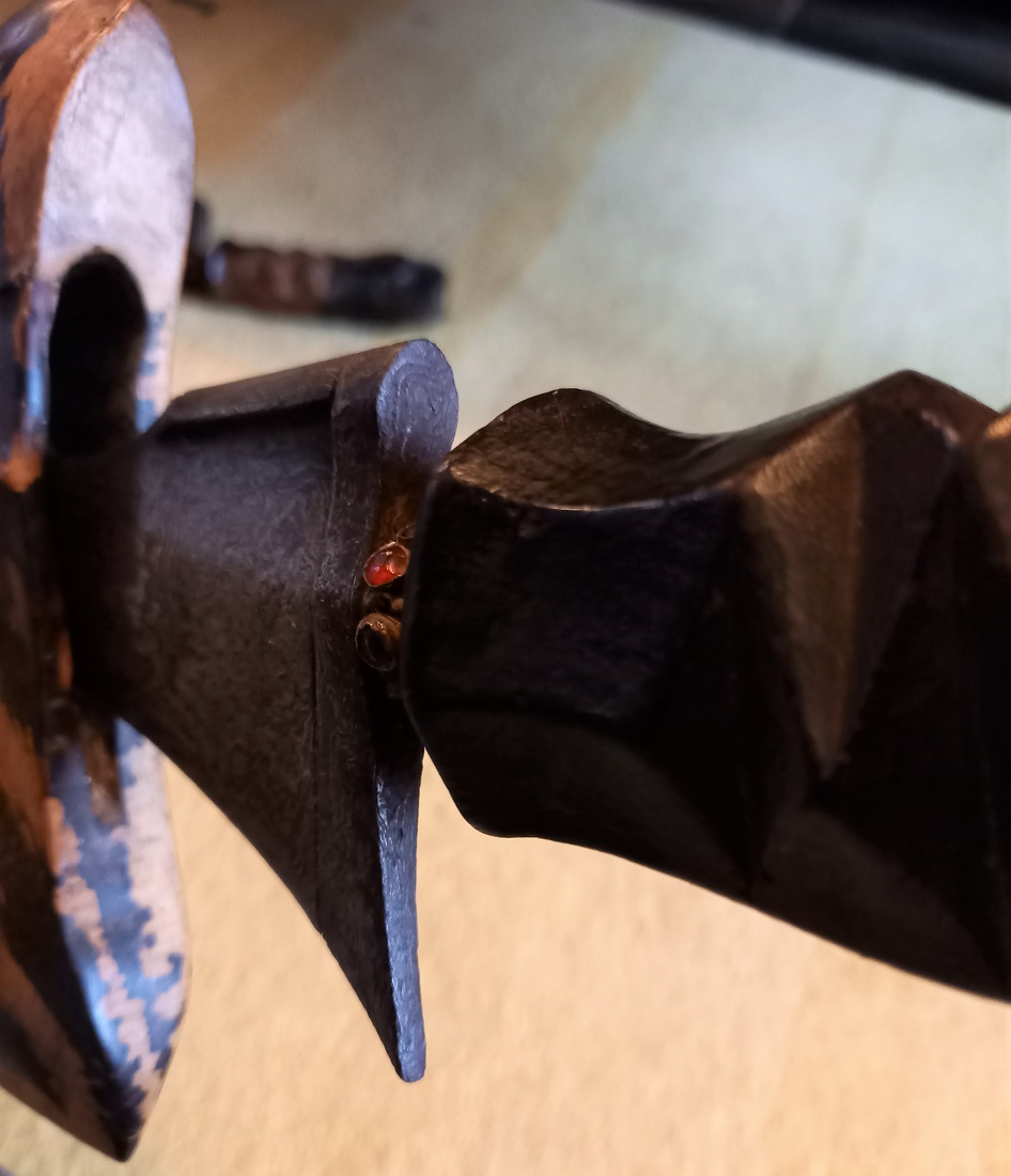

Thanks for the pic of the gonjo top. Definitely a North Coast Jawa blade, definitely classifiable as Tuban Pajajaran.
This is an old blade, so it is entirely possible that it has lost some of its length.
It is not at all unusual to find Jawa blades in Balinese dress, and this is especially the case with Balinese keris that are regarded as family pusakas.
