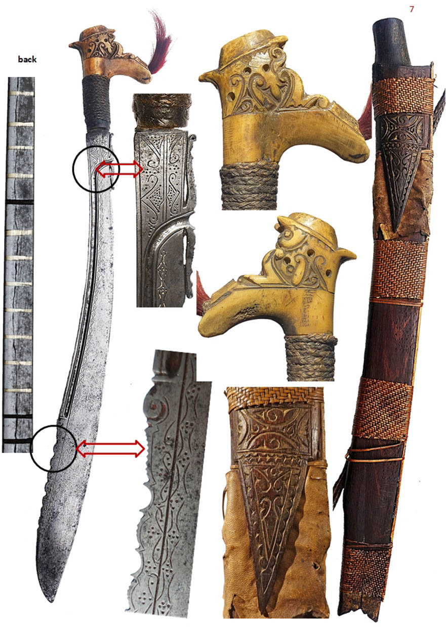

Does anyone know what kind of mandau this is?
Could it be a "Tilang Kamarau"? the back of this sword is the same as the front. The sword comes from Brunei. The motifs on the sword, handle and sheath seem floral to me.

I think some folks might call this a Tilang Kamarau, but it is a little outside my collecting area to be too sure of myself. But i will say that AFAIK a Tilang Kamarau is not a type of Mandau. A mandau, or Parang Ilang, is a specific form, even if it does share the same basic hilt form as this sword does.

Yes, I'm with you on this one, Godfried:
If both sides of the blade are (convex) rather than )concave+convex) and it's stylistically Iban rather than a few ethnic groups limited to Sabah and northern Kalimantan Timur, this label seems suitable...
Is it known from where in Brunei this piece hailed?
Very detailed work on this blade! Backside of the blade as well as scabbard?
Thanks Kai.
Unfortunately it is not known where exactly it comes from Brunei.
Hello David
You are absolutely right, but the word Mandau is often used as an umbrella name for various dayak swords. That is why used in my question the word Mandau.

Again, this i not my concentration of collection. I own just one mandau and have had only one other in the past, but it seems rather inaccurate to use mandau as a an umbrella term for various Dayak swords when these other swords all have their own characteristics and specific names. That is why i questioned your use of the word mandau.
