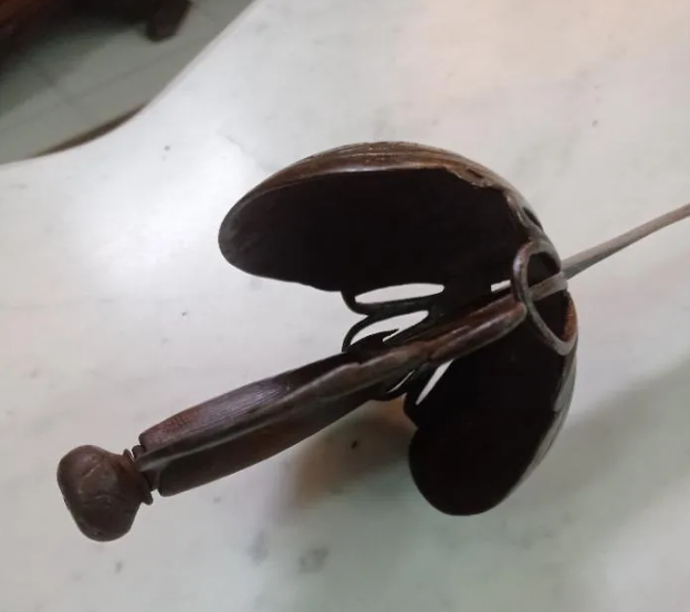

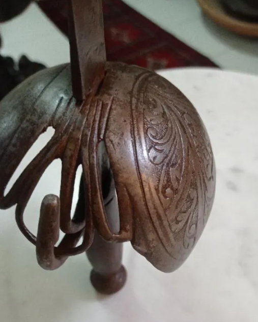

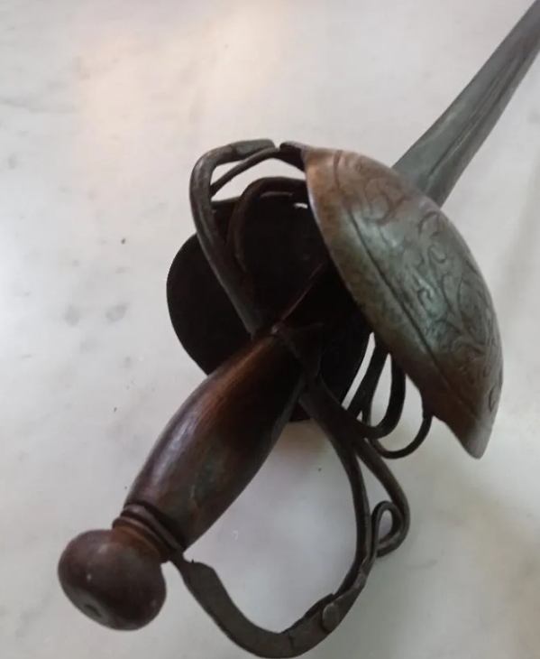

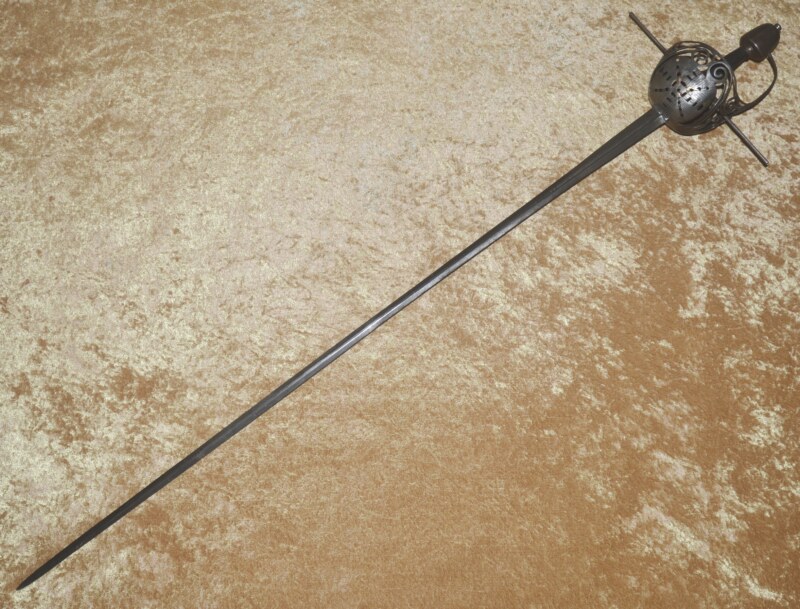

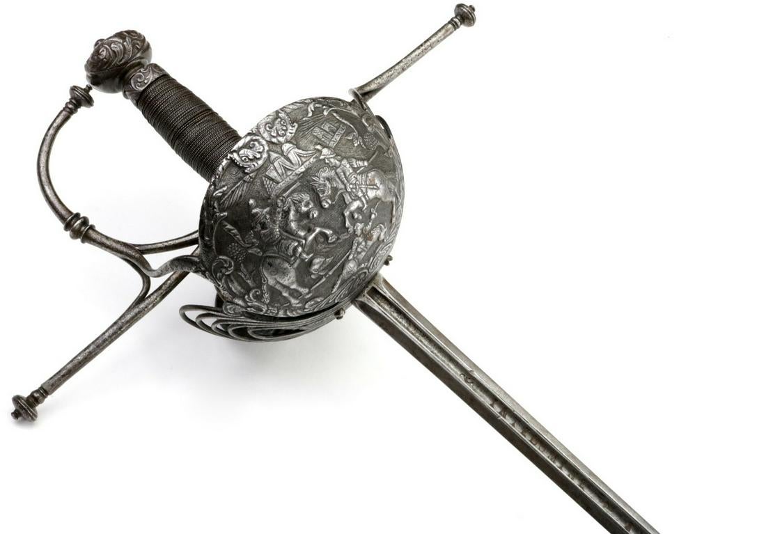

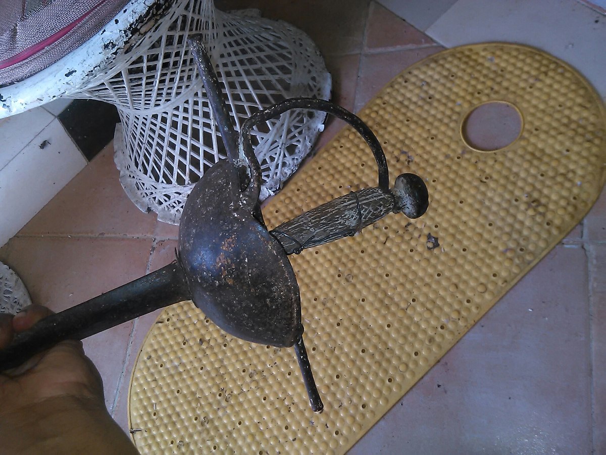

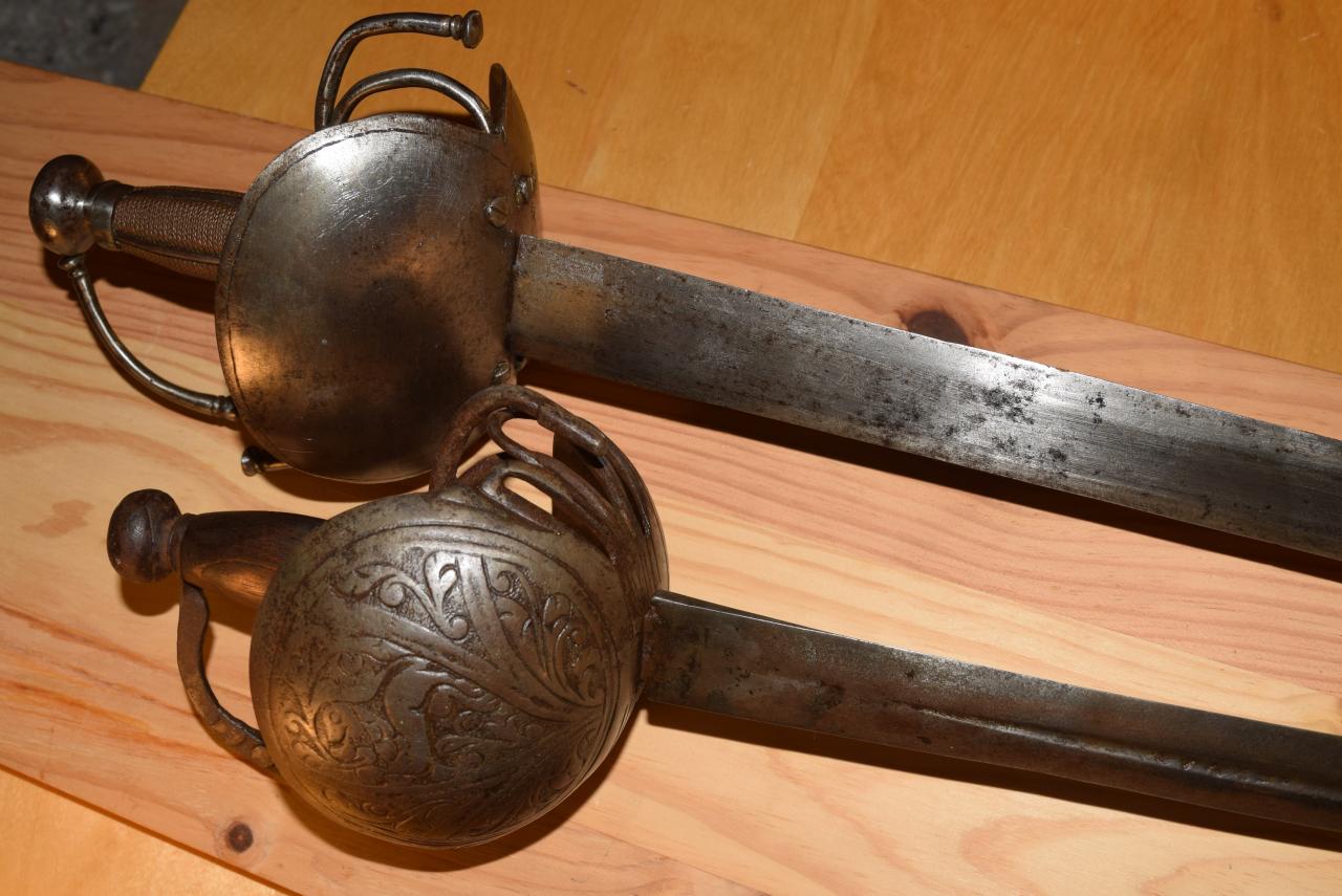

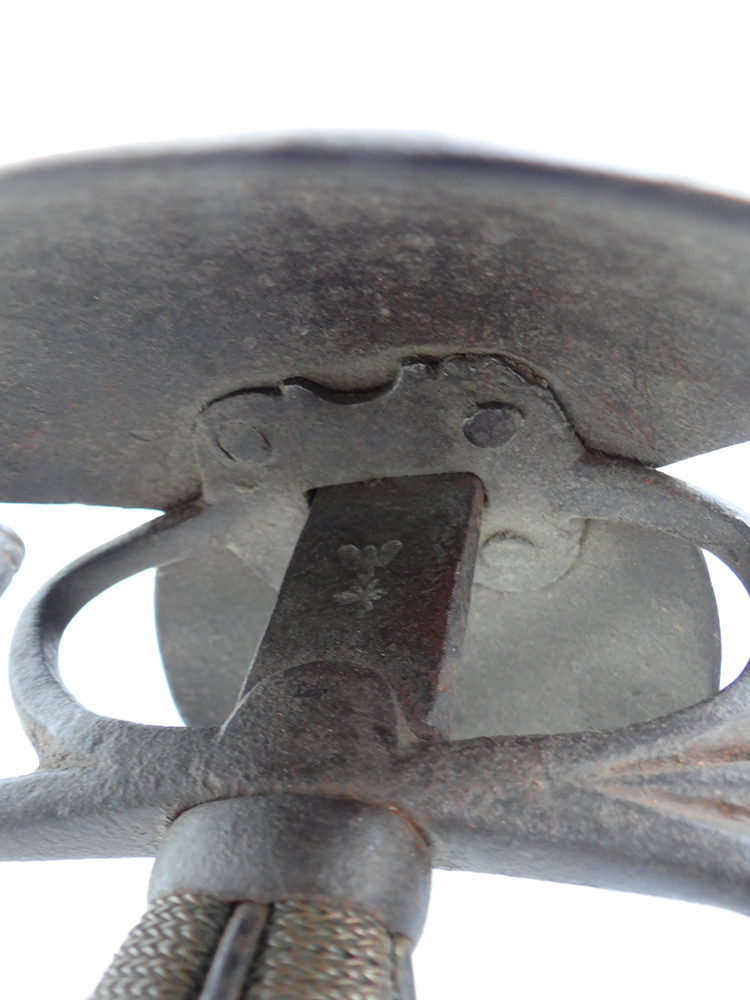

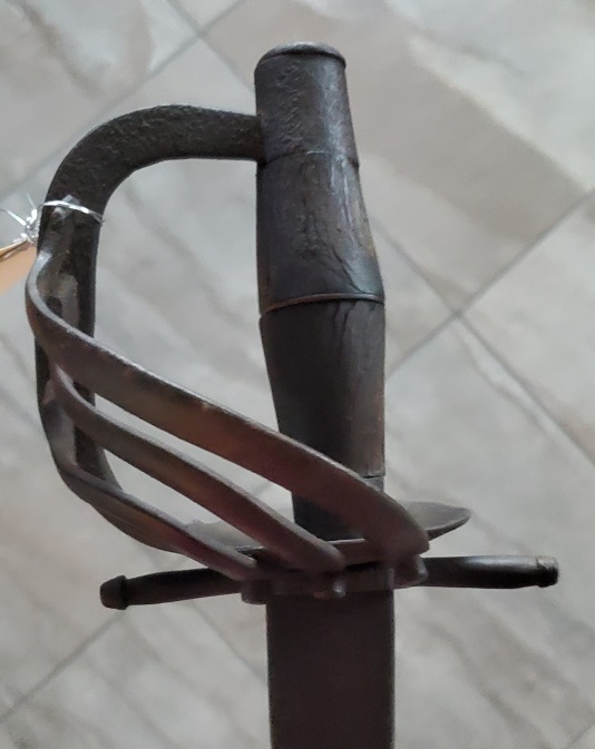

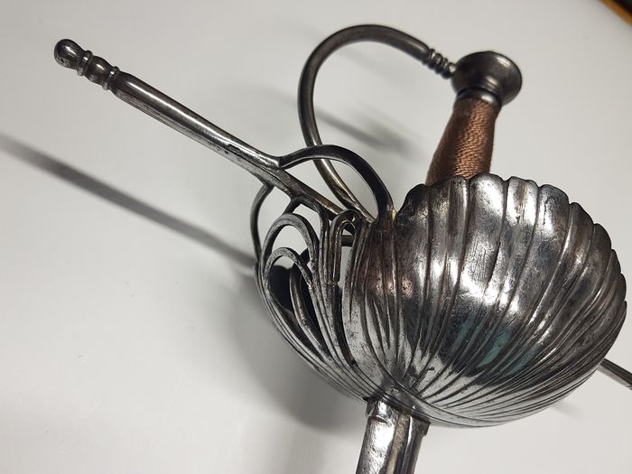

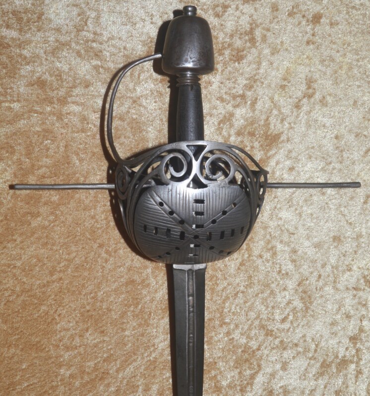

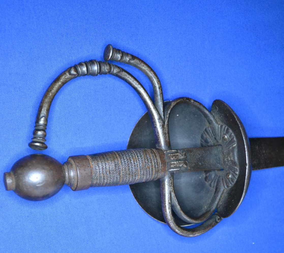

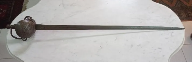

This sword is driving me nuts. I found it a month ago in the Canary Islands. Because it is a dangerous pointy object, it cannot travel by plane. So it had to be embarked. Then, the seller stopped communications for two weeks. Today, she reappeared, confirming me the sword is on a boat, and that she went missing because she had to attend business in La Palma due to the volcano.
Pictures are hers. I do not even know at this point if the blade has an inscription.
I would call this a Brescian hilt with a cavalry military blade. Probably from around 1680. I believe Brescian hilts evolved from German shell swords, and these started as a sort of Pappenheimers that were influenced by Swedish cavalry swords, also with two shells (like the one Gustav Adolf was carrying at Lützen).
The Brescian hilts in Spain come in two flavours, both have characteristic decorations in one of the shells. There are delicate rapiers and massive cavalry swords. Usually they have long quillons, but in this example they have been cut down and twisted upside and down, just as those from 1728 Spanish cavalry models (boca-de-caballo), probably because they interfered with fencing from horseback.
There is another field reparation at the knuclebow. Probably this sword saw 30 or more years of battle use. First against the armies of Louis XIV and then fighting alongside them, or maybe with the Habsburg pretender, in the War of the Spanish Succession.

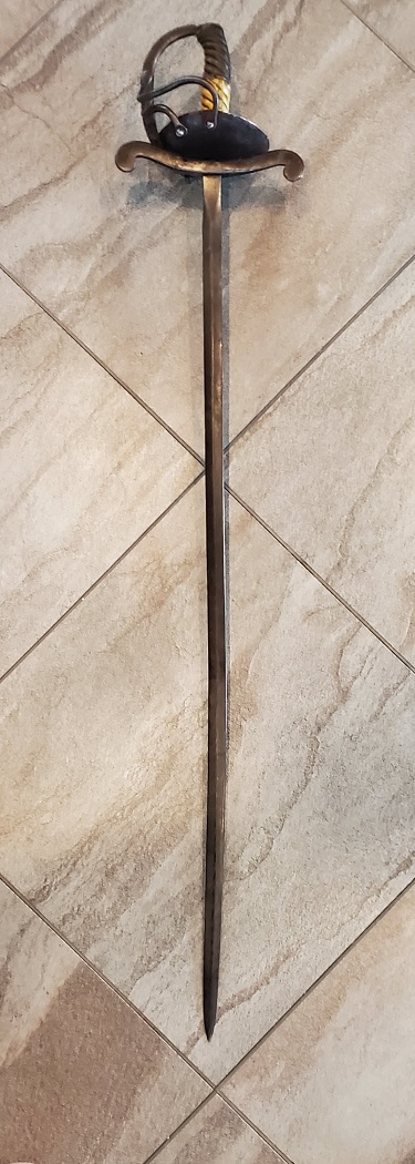

Very nice piece! Not an expert, but I think this would be classified as a 'Spanish colonial' broadsword of provincial manufacture. Very similar to the Spanish colonial Caribbean rapiers and bilbos (sorry, we know this isn't the correct term, but has become so mainstream, it's easier just to use it!) coming out of the Americas. I base this on the the undecorated state of the blade and guard, the relative primativeness of the decoration, the mushroom-shaped plain pommel and most importantly, the shape/assemblage of the knucklebow and quillon, so similar to Central American/Caribbean espadas. Note the snake shaped downward quillon on this espada and the D-shaped flat-sided knuckle bow on this provincial bilbo...

I believe it is second half of the 18thc spanish bilbo sword for the cavalry.

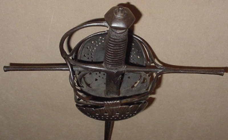

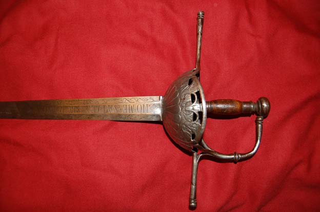

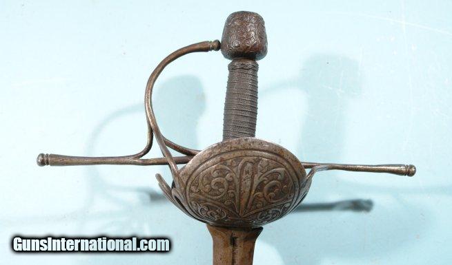

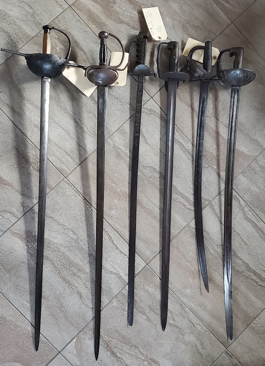

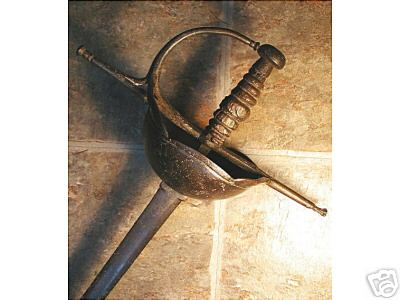

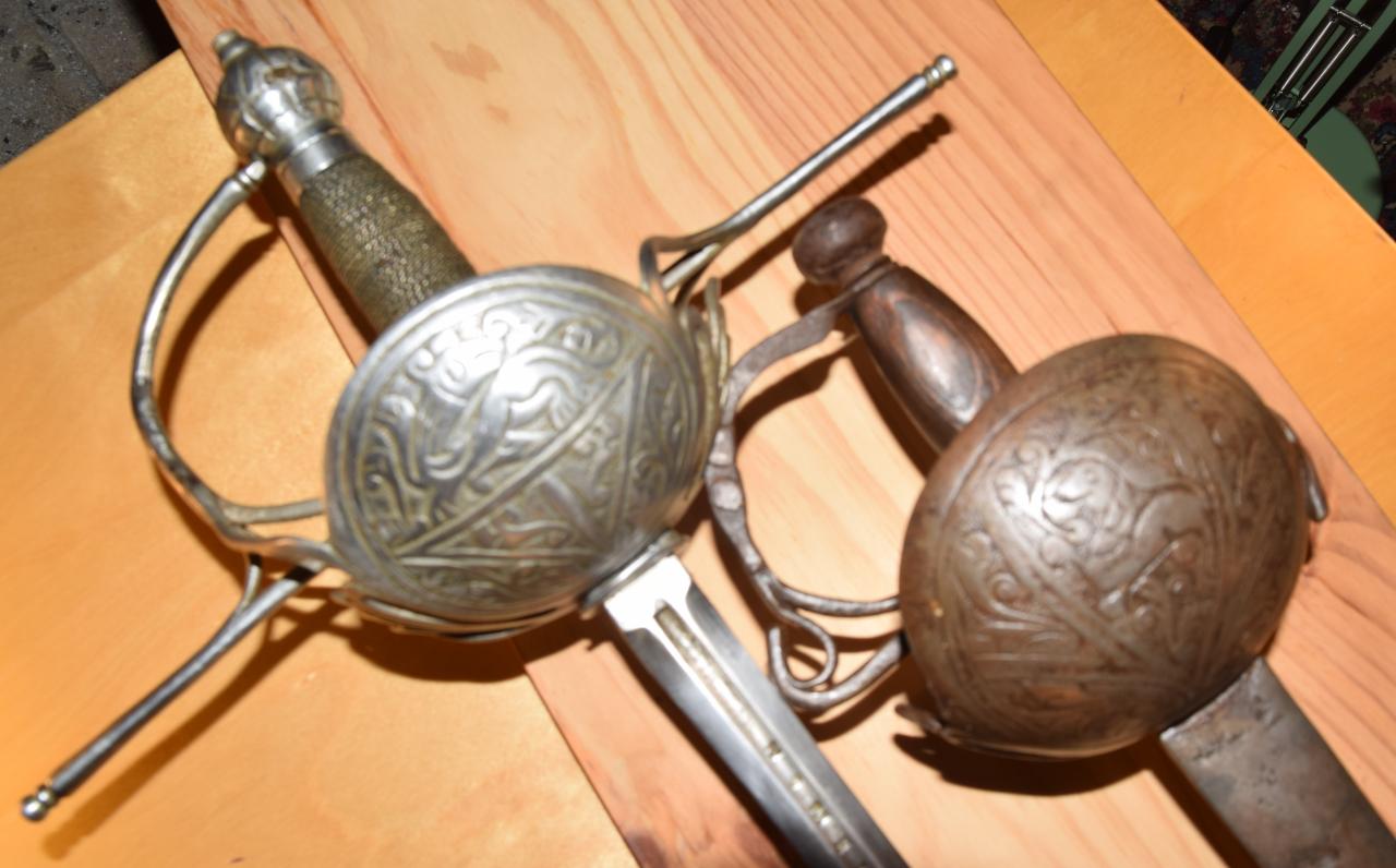

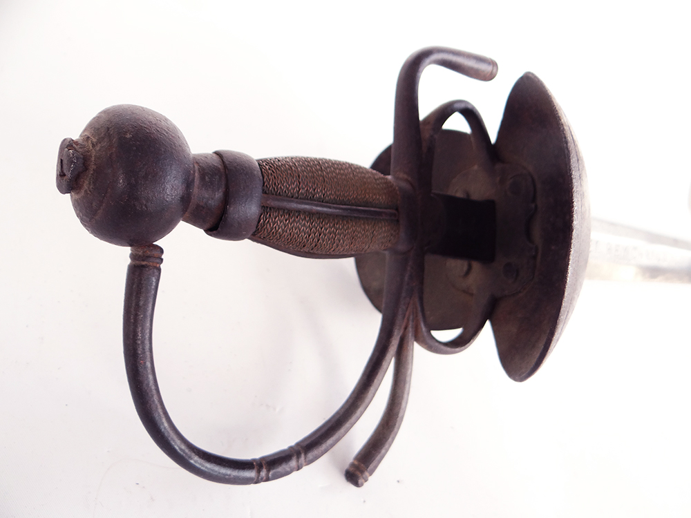

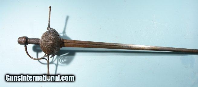

These are Brescian rapiers from the second half of the XVIIth century. Civilian weapons very common in Spanish museums. Spaecially those eith the dog/lion decoration.

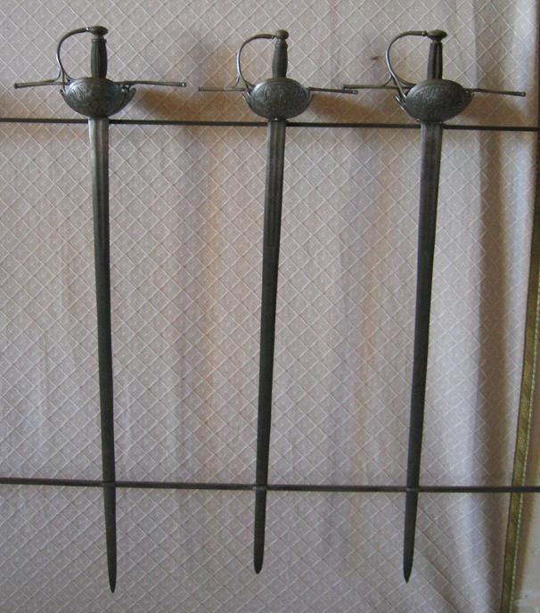

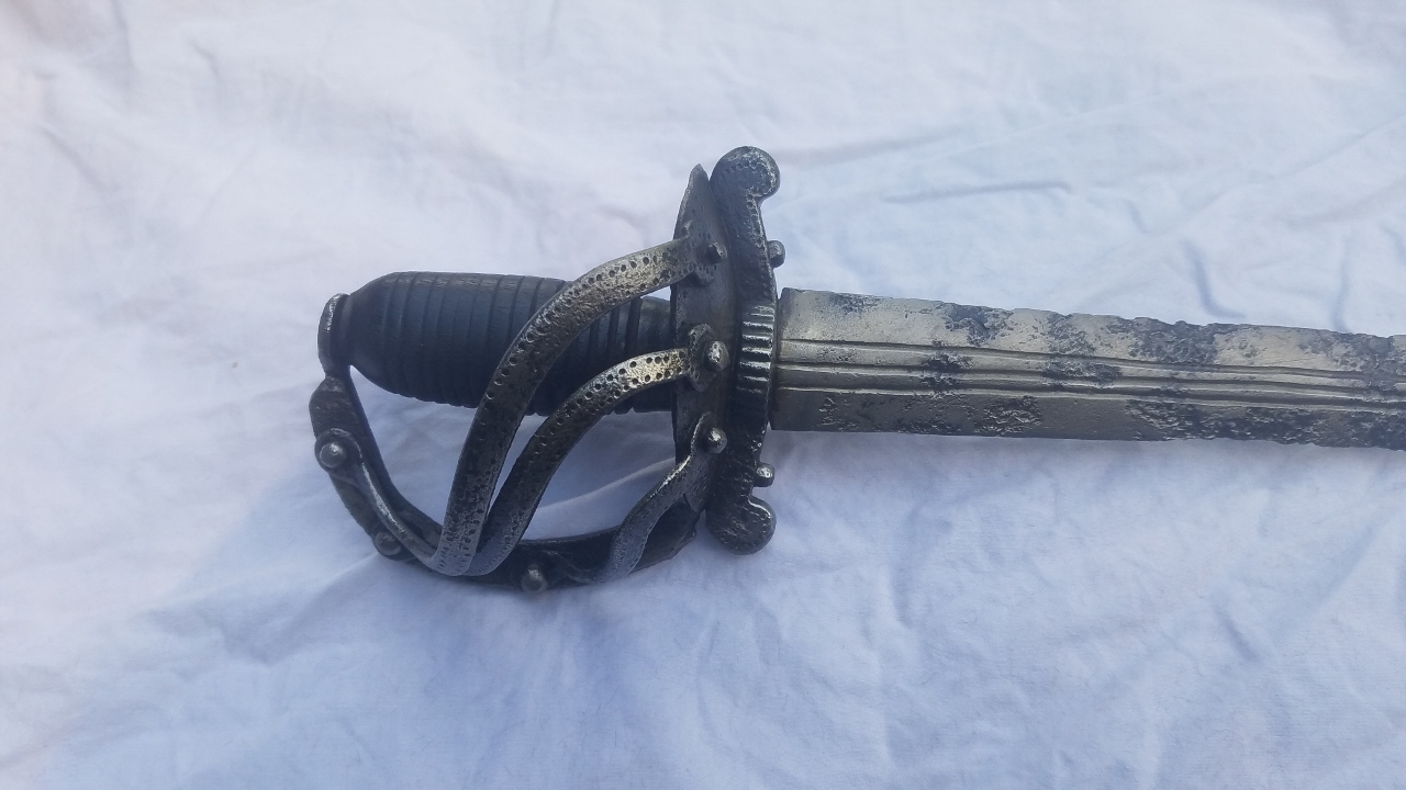

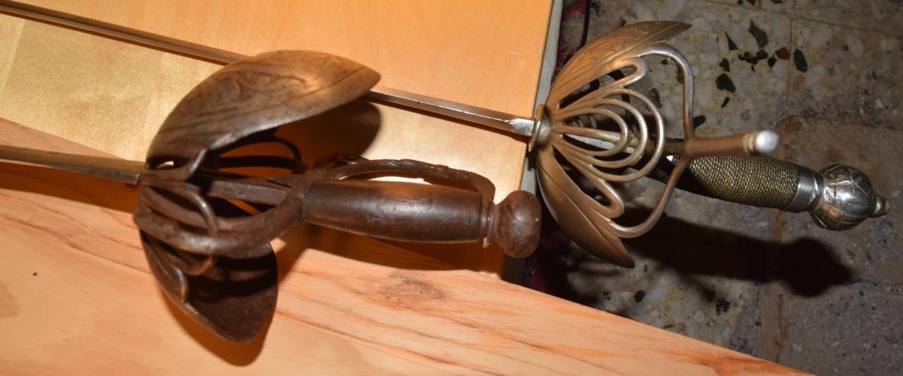

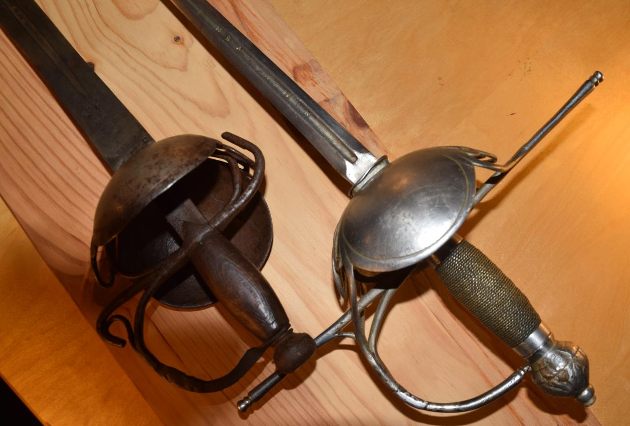

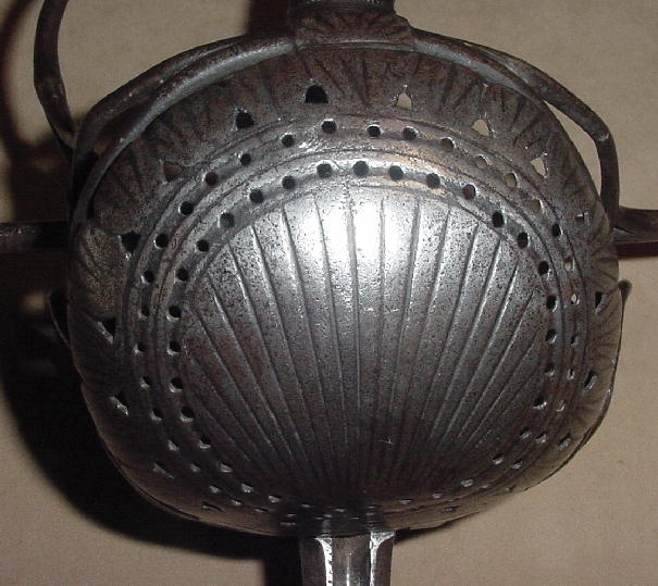

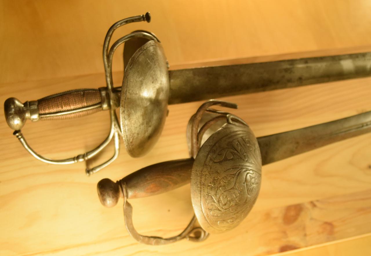

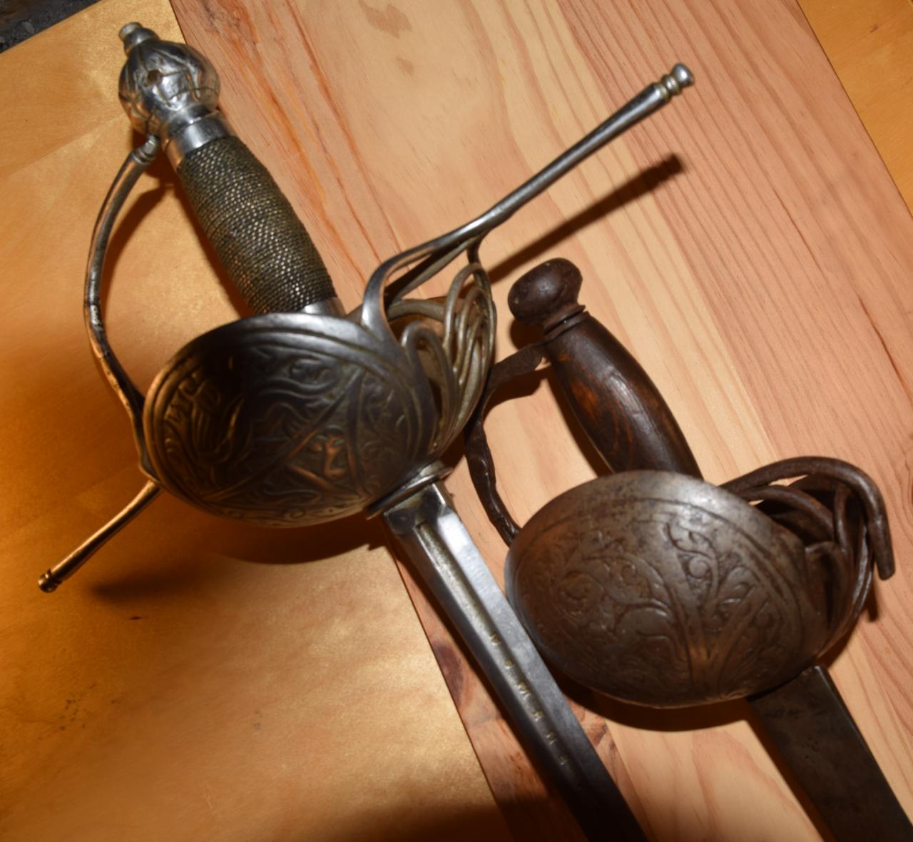

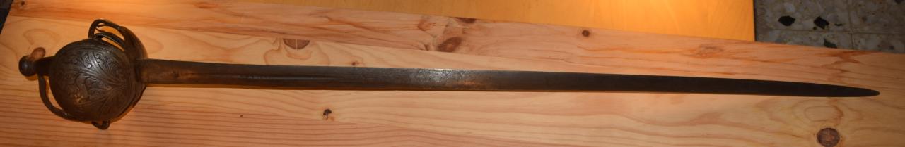

And these are military cavalry swords with Brescian hilts from the second half of XVIIth century. The one with the motto has been rehilted with a blade of about 1775. The group of three is from Segovia Alcazar.

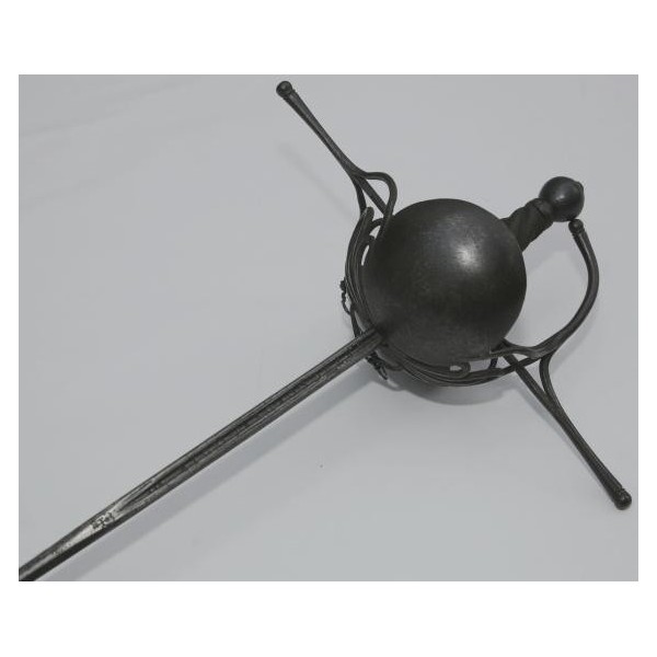

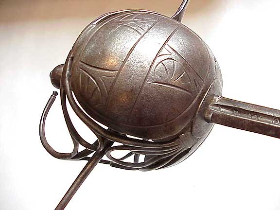

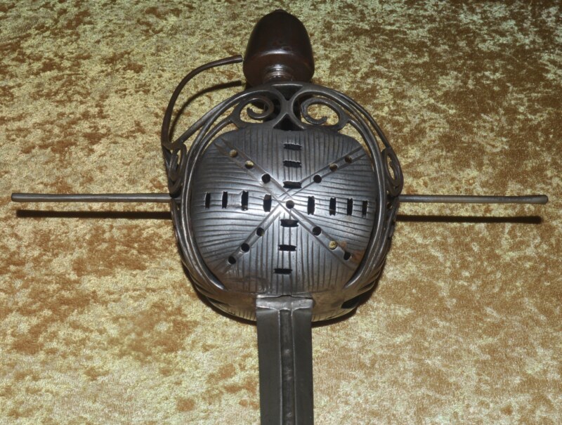

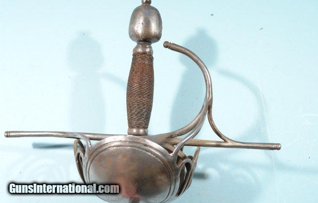

And this is a sort of German sword from where I believe the Brescian hilt evolved. Possibly c1630.
I believe next one is an early Brescia from 1640-1650.

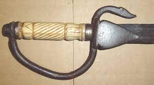

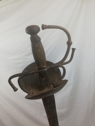

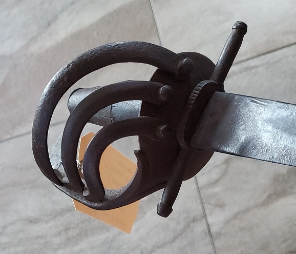

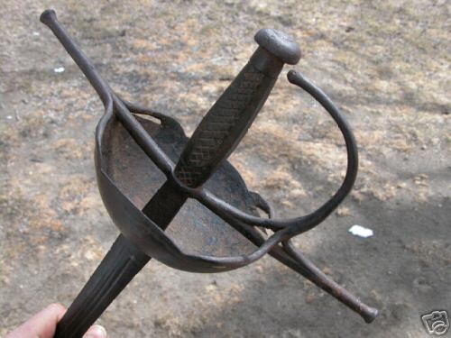

And these are munition swords imitating the Brescian style. Possibly used in the navy and now known as colonial swords. They are usually short, for combat on foot. Cheap blades. Probably early to middle XVIIIth century.

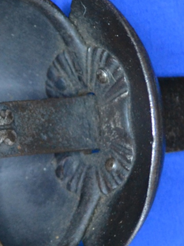

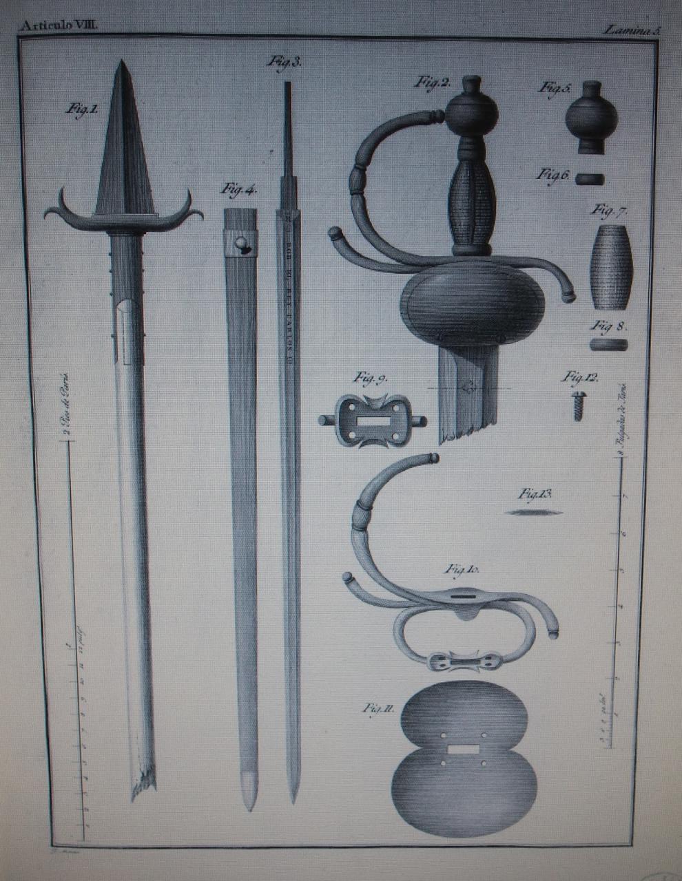

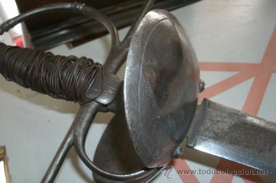

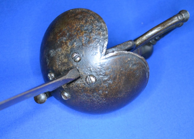

Boca-de-caballo swords (known often as bilboes) are easier to build. Instead of a single forged piece, something difficult to make and that rarely you see in replicas even today, they have two pieces bound by screws.

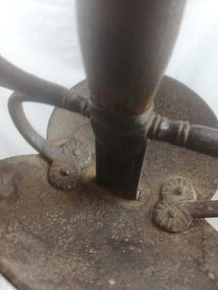

Originally two screws, with the result of many hilts broken at the weakened union of the two shells. They were around before the 1728 model was defined. Later 4 screws.
Then from 1761 on the pieces with the four screws were made as a frame, much stronger. The 1728 model became completely standardized by a new ordonance that year, about the same time Toledo factory started working
Quillons are usually twisted because seated on horseback were easy to entangle in the horse furniture. Many swords have had their quillons straightened in later years by collectors.
So my Canary sword precedes the 1728 model, and it is an interesting step in its evolution. Spain lost most of its Italian territories, including Milan in 1706. Possibly Brescia weapons stopped being delivered then.

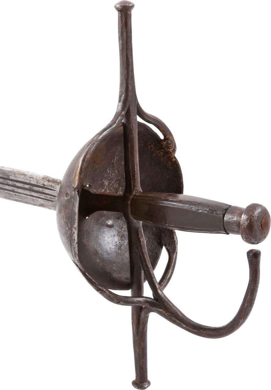

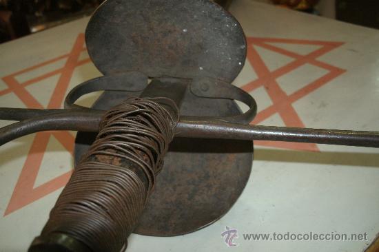

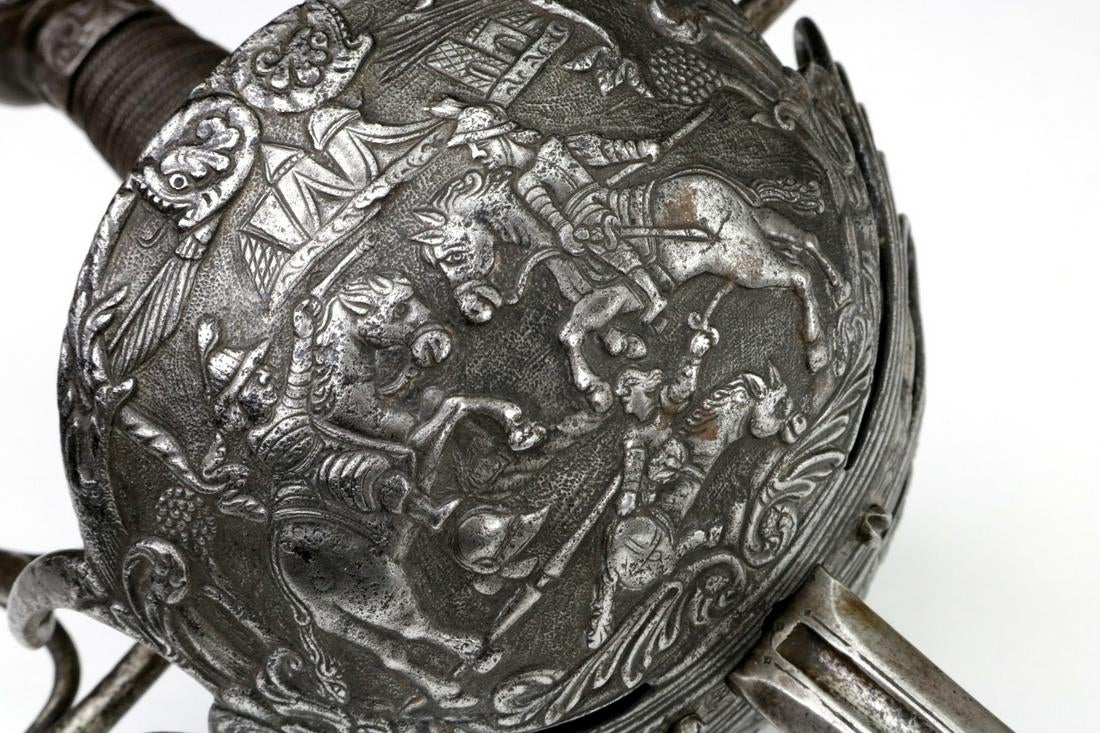

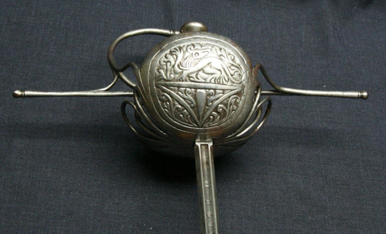

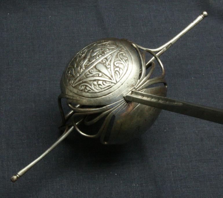

here is another example of a Spanish 18th century cavalry bilbo, with a lion motif on the hemispherical cup. I think the rapier of post 1 has been modified a bit during its working life, guillons shortened and knuckleguard linked to the pommel.
best,
Hello Cornelistromp.
Those hilts were typical of XVIIth century rapiers, that became obsolete in Spain after Felipe V enthroning in 1701.
The sword you show is from last third of the XVIIth century. It will not fit the Spanish 1728 military regulations, not any other after that. The 1762 engraving corresponds to the model 1728 in the last two pictures of my previous post. Notice that quillons are twisted as design.

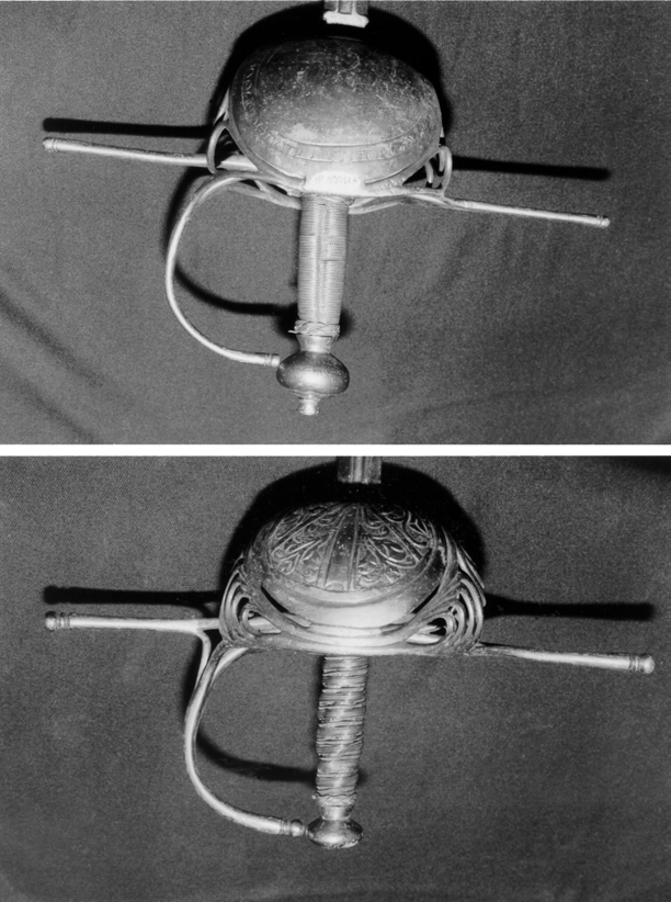

The two swords I posted were for reference to the figural quillon downfacing from the hilt and of a form found in espadas and colonial broadswords. I made no definite conclusion to this, just a possible clue. Likewise, the second posting shows a cuphilt (albeit later period) with a flattened knucklebow EXACTLY like the one on the specimen being presented. Again, I'm no expert, but wanted tp point out this interesting characterization. The knucklebow near the hilt also bears some evidence of repair, as noted by others here. This type of repair often seen here in the Americas, but of course not exclusive. Most of the examples shown have the long straight quillons of classic Spanish cuphilts, while this example is, as noted, similar to the m1728. I guess what we get into here (and have before) is how to tell a beat-up, field repaired classic Spanish cavalry type with one that was assembled from different parts in provincial/colonial settings? The example shown has a replacement grip of plain wood core? The pommel, unlike almost all of the other examples presented, is devoid of all decoration, The quillons, once again, are like the classic bilbo, but lack grace, so replacements? Repairs?
So.....if this is a European fellow, it has definitely seen some hard times
Yes, you pointed to the knuclebow reparation, but your examples could end being used for something else. What I get from this is that there are not so many ways of making a functional field reparation of the knuclebow. In XVIIth, XVIIIth, or XIXth centuries. In Europe or the Americas. I do not have the sword here, but what I see from the picture, the top end of the grip wood was cut, and a ring inserted and this piece was riveted to the remnants of knuclebow.
No brass welding here. It could have being made to continue the military use of the sword, or in XIXth century by a collector. This sort of afterworks have an antique and primitive look, but that can be deceiving.
The funny thing is that XVIIIth century bilboes are often mistaken for XVIIth century swords, because of the ricasso and the holding hand posture, with two fingers on the cross. But that these real XVIIth century swords become mistaken for XVIIIth century ones is new to me. The fact is that Spain abandoned the use of rapiers shortly after 1700, with the new Borbon dinasty, and therefore rapiers and their hilts shall be older than that.

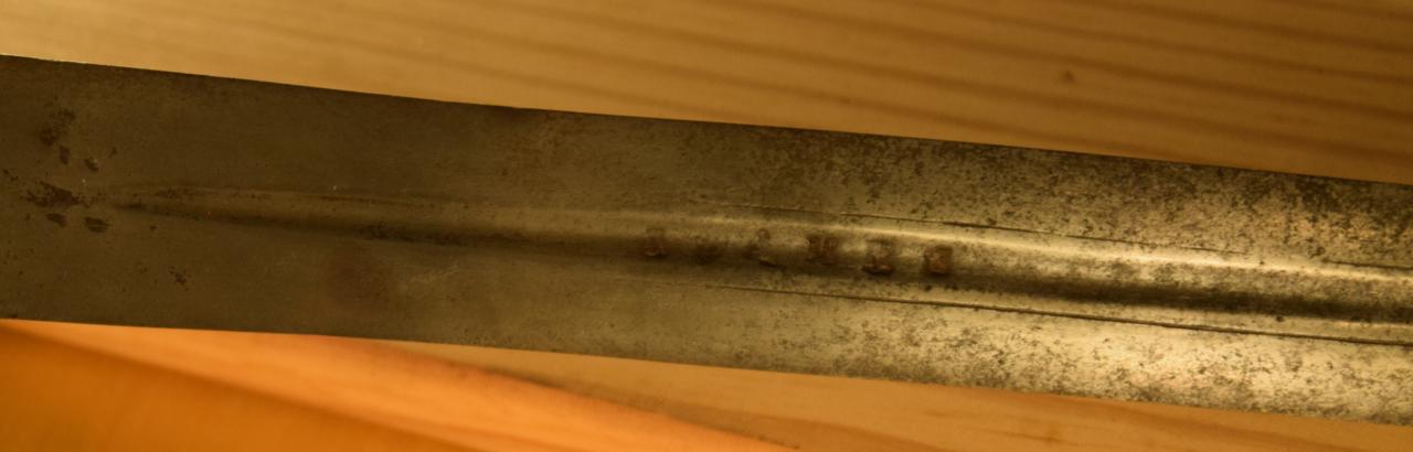

After what I consider the most hazardous shipment of a sword I have suffered, the sword from the opening post arrived. I paid for it at the end of September. The seller, from Tenerife, had to run to the La Palma island because her family properties were coming under the lava, without sending the sword, although she said she did. Problems with weapons in planes. Finally sent in December, later the sword arrived to the peninsula, but at my post office, for unknown reasons (Christmas mess) they sent it back to Tenerife... Just by chance, I paid online custom duties (they exist between the Peninsula and the Canary Islands) thinking they were for entry in the continent, but then they were for returning to the island. If I would not have paid, the sword probably would have remained in the customs warehouses until destroyed.
Anyway. The inscription, same on both sides, I have not been able to decipher, 6 characters, possibly.
I V A M E S, but the M could be a W, then B E W - A I ???
I just found there was at Seville a swordsmith JUANES who died in 1596.
Pommel is lightly carved and I believe original. Brutalistic knucklebow repair does not use brass welding.
I have made some comparisons of a Brescia hilt rapier (with a c1607 blade), in order to show the performed mutilations.
And how they bring this (fashion victim) sword in closer looks to two cavalry trooper 1728 models (bilboes) from c1730 and c1760 (Enrique Coel blade). This sword was probably in use from c1670 to c1750. I believe the twisting quillons thing started about the 1728 ordenanzas.
