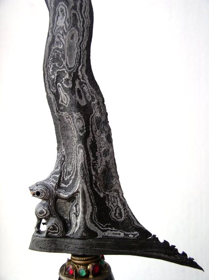

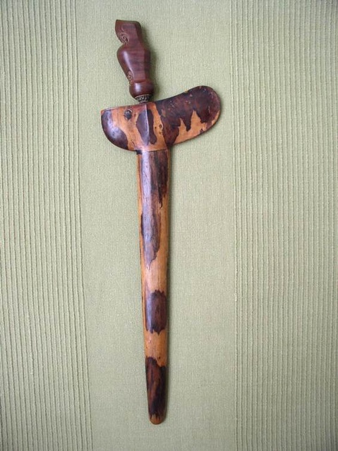

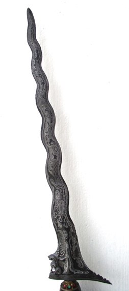

Anyone care to share comments/opinions on this singa barong please? Thanks!
Ok, the ukiran is not the original one, but I couldn't find a proper East Javanese ukiran that can fit the very long peksi (which is the longest in proportion to the blade amongst the kerises in my collection).

ESPECIALLY NICE WORK ON THE MALE TIGER THE BLADES WORKMANSHIP LOOKS TO BE VERY GOOD QUALITY. IS THE AREA BEHIND THE TIGERS BACK ONE OF THOSE FINGER PRINT HOLES OR JUST A AREA THAT IS CUT OUT? IS IT A RECENT OR A OLD BLADE AND FROM JAVA OR MADURA IN YOUR OPINION?
IS THERE A GOLD BALL IN THE TIGERS MOUTH, IF SO IS THAT CHINESE INFLUENCE?
CONGRADULATIONS I LIKE IT.

Hi Vandoo,
The area behind the singa, I presume you are referring to the picetan, is carved out as part of the perabots of the keris. It's not a thumb depression akin to those on keris picit.
There is a metal ball in the mouth, and it looks like it was painted in gold colour. Brass/copper paint probably; don't think there's any actual gold in the paint.
I think it is an old blade (>100yrs old, late 19th century) from E. Java, but I'm not sure. That's why I'm putting it up for discussion. There are signs of pitting on the sor-soran area, especially at the outer edge of the 1st luk. There are some very tiny perforations on the sraweyan area that allows light to pass through, probably due to acid cleaning over the years. The rest of the blade has better surface condition, with some nicks here and there, and a few pits.
The blade is not too heavy, which tilts the opinion towards an old blade (the result of more thorough forging). Madura muda blades, I noticed, tend to be quite heavy. However, if you notice, the singa itself has a rather smooth surface. The eyes and other features of the singa looks a bit worn smooth, so I don't know if the singa was polished recently.
Old? New? Modifed? I seek fellow forumnite's opinions please? Thanks.
But regardless, I like the piece a fair bit (not to mention the pelet wood). Just want to find out more about the piece.

Maybe this keris is Bali? Ukiran is not right for Bali, but all else looks Bali to me, and 13 luk too! Barong singa is lion, not tiger. Chinese influence on keris Malay or keris di Majapahit has never been proven, but why not could it be? Chinese merchants were here by 800 AD, maybe earlier, and all over Malaysia, and Indonesia, it is clear their influence.
Yes, a 13 luk keris barong singa is a powerful keris, so be careful. Give it lots of oil and always keep the point up, when out of its gandar, never down, and don?t sniff it. If you can smell its oil, OK, but never hold a keris like this to your nose to enjoy its smell. I think too if you change the ukiran to ukiran di Bali, it will be a happier keris!

The ukiran is not original. The ukiran that came with the keris was East Javanese, but one with a dark band burnt round it with a hot solder. The patra on that ukiran was not very nice, so I replaced it with this spare Solo ukiran I have (temporarily only). I'm just waiting for the right East Javanese ukiran to come along, but it would probably be a long wait because the peksi on this keris is very very long; all my other E. Javanese ukiran could not sit properly on the keris. This keris is most probably not from Bali, because it is too small.
May I ask as to why we should refrain from sniffing at a keris Singa Barong? Or is that for kerises in general?

The blade length is 13.85 inches (35cm)
The peksi length is 3 inches (7.6cm)
Dimensionally, I've not seen any old Balinese keris that is this small. Most Balinese kerises are around 16 - 18 inches long. The sheath is East Javanese and not Balinese. The original hilt (not shown) was also East Javanese. Even the mendak (though a cheap one with glass beads) is not the typical Balinese or Central Javanese type.
Compare the sheath to the other Balinese kerises that have been posted in the forum, or in Kampungnet (for those with decent access speed. ). You can see that they are related, but very different.
http://www.kampungnet.com.sg/modules...view_photo.php
And then, compare the greneng style on this singa barong to a Balinese/Lombok keris. Again, there is significant stylistic differences.
I am confident that this keris is not Balinese. My doubt lies only in the age of the piece, and whether it may have been modified.

It is not possible for me to say if this keris blade is old, or recent, only by looking at a photo.
However, I would comment that the rondha, and the fine detail of the kikik are remarkably perfect for a keris that displays considerable erosion to areas of the rest of the blade.The sides of the gonjo show erosion of the weld layers, but the form of the rondha is completely uneroded.
In this world, we mostly get what we pay for.
I would suggest that you consider the source and the cost of this keris and weigh that information against what you have in your hand.
Yes, the good condition of the rondha and the kikik (I suppose he does look more kikik than singa barong) compared to the corrosion of the sor-soran struck me immediately when I first saw the keris. The ganja could be a replacement, and I also thought the kikik could have been new parmor material welded onto an old blade. However, when I look at the pamor lines between the kikik and the rest of the blade, I do not see broken lines that would have suggested the welding of a separate piece to the blade. The maker could have made the keris and artificially corroded the sor-soran area, except for the kikik. Either way, it is a very interesting thing to ponder over. This keris is not too expensive, and I don't have any information on it apart from what I have observed.
However, I wouldn't completely agree with the bit about "mostly get what we pay for". There are many examples of people paying too much for a keris, and people selling some of their great pieces too cheaply.

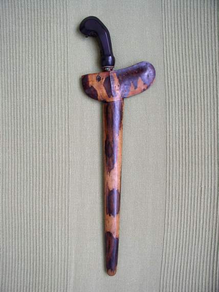

He's back with a more appropriate ukiran. And I noticed that Rick has a similar ukiran on his ladrangan Yogya.
http://www.kampungnet.com.sg/modules...view_album.php
Old 10th December 2006, 03:02 PM   #25
Posts: 6,441
Hi Kai Wee,
The work on the cecekans is extremely well done on this handle.
Semar is one of my favorite handle forms as possibly you can tell by my avatar.
The wood is just lovely.
Have you come to any conclusions about the age of this blade since you first posted?

Agreed, that is a lovely ukiran...and i also prefer your new choice of mendak.
Age is always a difficult thing to judge and they have gotten really good at different techniques of artifical aging. Regardless, i find this to be a very attractive keris, but i also understand the desire to KNOW one way or the other. I believe Kai Wee is correct that you can, from time to time, still find that excellent deal on a great old keris, and perhaps this is one of those times. As Alan suggested though, if one considers the price AND the source the answer might be implied. Either way i like it.

Pretty nice keris, however, one thing troubles me with that singo barong:- I cannot see the lines of pamor continuing from the singo barong into the blade.
I have a couple of blades where the singo barong has been welded separately to the blade. When I bought them I did not see this, and only discovered it later. These blades have been inspected by some knowledgeable people, and they didn't see it either, until it was pointed out.
Kai Wee, I suggest that you inspect very carefully the entire area around the point where the singo barong joins the body of the blade, and a little further perhaps, and see if can find definite evidence of the grain of the metal continuing unbroken from the singo barong into the body of the blade.
The second handle you have fitted is a very nice handle, but it is not appropriate for this keris.

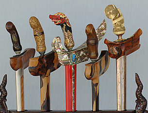

David, in this case a pic or two would be worth a thousand words, but right now I do not have time to do pics.
This handle style that Kai Wee has fitted is not an East Jawa style.Yes, it looks better than the Solo one did, but its still not right. Its just occurred to me I might have a pic on file . If I have I'll post it.
OK, here it is. Best I can do at short notice.
The handle that Kai Wee needs is one like either #2 or #4 from the left. Some others would also be suitable, but not the one on it at the moment.

Thanks Alan. I can't see the profile of #4 that well, but is it looks like it might be the same hilt form as that timoho sheathed keris i got from you from catalog #50. Not sure if you would remember.
Can you say what keris type Kai Wee's hilt would be appropriate for?
