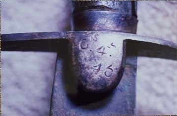

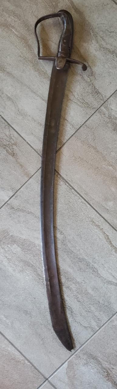

This is another of my 'mystery' swords acquired back in the 1970s. This was among piles of old swords on a table at a gun show, and pretty much simply scoffed at by those circling the table.

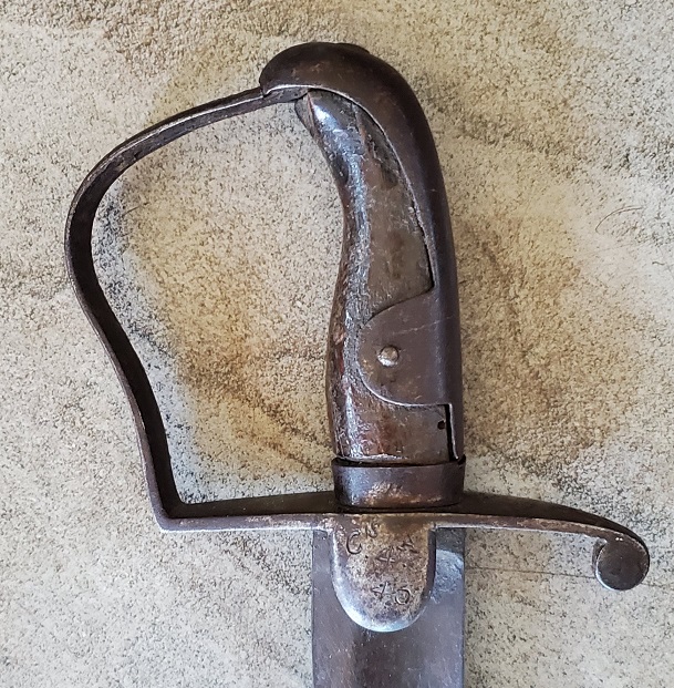

I knew of course it was a British M1796 saber, and by Thomas Bate of Birmingham, but I was intrigued by the curious markings scribed on the langet.
C s A
4
43
My thoughts naturally raced toward a Confederate connection in the Civil War, with the CSA markings, but over time, research with authorities proved that to be an optimistic assumption. Apparently aside from Virginia cavalry, hardly any Confederate swords were 'unit marked', and the CSA confined to cast hilts incorporating those letters.
My attention then turned to Spanish colonial, knowing that much of the Mexican military had British arms, and perhaps Carlos IV might be contrived in the letters. This tenuous idea was too quickly disproven.
Years later, in 2003, I was given a brilliant suggestion, that perhaps this was a sword which ended up in the Castel Sant Angelo, in the Vatican in Rome.
This ancient edifice had been a military fortress, prison, and armory, which was undoubtedly used during the campaigns of the 'risorgimento' or wars of unification 1861-1870. In addition to Swiss Guards and protection units, Pope Pius IX, maintained a Papal Army of volunteers and mercenaries.
Among these were Irish volunteers.
Interestingly among these Irish volunteers was Capt. Miles Keogh, who later would fall at the disastrous Battle of the Little Big Horn in Montana in 1876.
It appears this saber, obviously older and surplus, may have been among weapons acquired by the armory, and the CsA and numbers must be rack numbers of as yet unknown denominator.
Another curious feature of this saber is a deliberate square notch at the tip of the blade.
The armory and military use of the Castel Sant Angelo was decommissioned in 1901. Possibly this saber was of the holdings there?
While of course highly speculative, there is reasonable plausibility it would seem. These times in Italian history are very complex, but perhaps there are members out there more familiar with volunteer units who might have been in service in this period and in this Papal Army.
I would be grateful for comments.

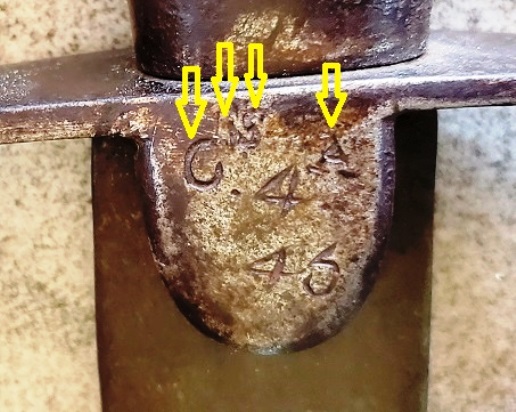

Jim, this is your sword; you sure know it better than anyone else. But, is it my cataract eyes or there are more letters than the three CSA mentioned ? .
Old 16th May 2021, 11:28 PM   #3
Posts: 10,862
More to my terrible photography, and when the opportunity comes, I will get a more efficient image.
As noted, this dilemma has been discussed and looked into by many authoritarian figures over the years, in one instance this langet and markings published in a well known arms magazine.
There is no doubt, the characters are as described:
CsA
4
43
The Cs...the s is in superscript, small letter above the line.
Castel sant Angelo
The 4 it seems is some sort of perhaps unit denomination, but in a wildly tenuous note, the armory in the Castel sant Angelo is on the 4th floor.
Admittedly probably not anything, but noted just the same.
In some research years ago, there seemed some possibility of this having to do with a segment of the units in the volunteer battalions. Again, pure speculation with research wanting.
The 43 then is most likely of course a rack number.
British military markings on swords often followed similar configurations in early 19th century.
The fact that this is what was then an obsolete pattern, these were sold off in huge numbers, as well as distributed to yeomanry units, so in either case may have ended up as sold off supply, or acquired by the volunteers who elected to go to protect the Vatican. From what I have understood, these were Catholic veterans not only from Ireland, but other countries as well.

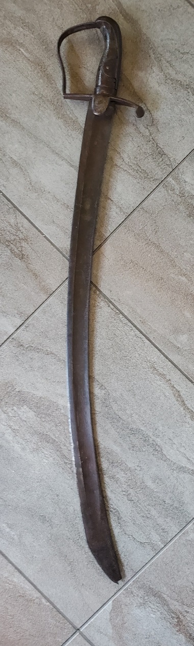

Though this saber and looking into this hypothesis clearly did not bring much attention overall, except as always the valuable input by our late Fernando (miss him)...for me these 'cold cases' never rest.

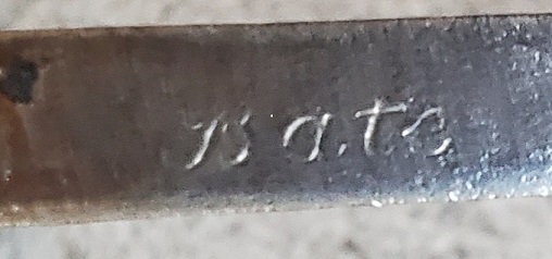

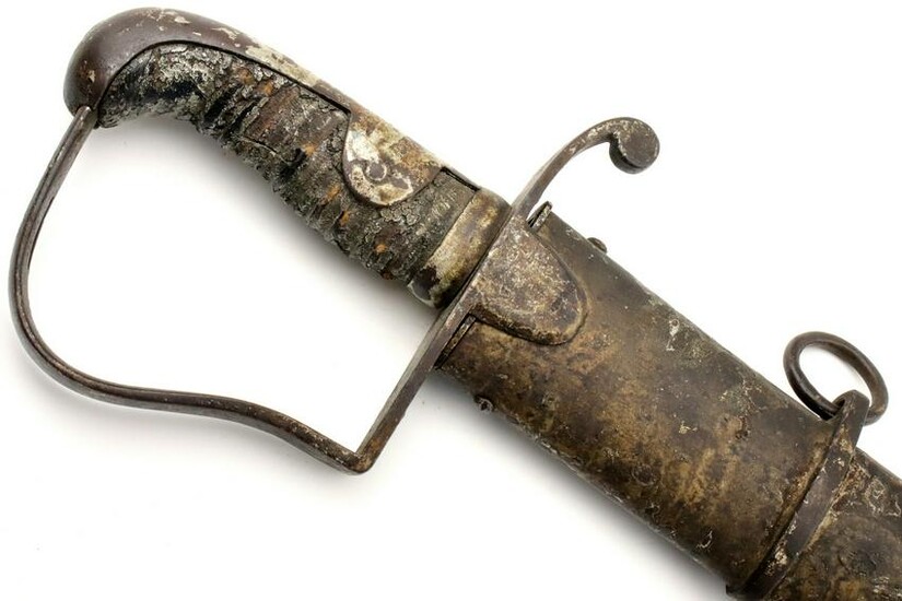

Today I came across an older auction which sold a BATE M1796 light cavalry saber for sale, and described as 'scarce'. I had never thought much on the Bate name on the spine of the blade, but looking further it seems Thomas Bate (on Aston St. in Birmingham) did not operate singly for long.
Joseph Reddell (Careys Court) in Birmingham, not far from Bate seems to have begun operation c. 1800, same as Bate. These are of course directory entries so may be approximate . Whatever the case, by 1804, the two men were partnered as REDDELL & BATE.
This partnership dissolved in 1807.
With this particular saber, the style of the hilt seems an earlier version of the M1796 in general appearance and without ribbed grip. Also, the BATE name on blade spine is cursive, rather than the block letters (as with the Reddell & Bate stamp).

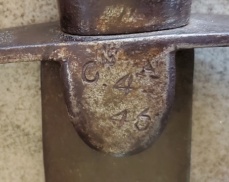

In the original investigation of this saber, which for me began in 1977! one of the key questions pertained to the odd markings on the langet. While of course the initial reaction was 'this might be CSA, Confederate!' as it was well known that many English swords were supplied to them in Civil War. The earlier noted M1796 Bate had S.C. markings on it, so there again the suggestion of Civil War came in.
All research in that area revealed that among other ranks weapons of Confederate forces, there were few, if any, such markings applied, aside from Virginia.
So, how did this early Napoleonic period British saber end up in Italy, further, in the armory of Castel sant Angelo at the Vatican? As we have noted, while Garibaldi campaigned in unifying the Italian states, the Papal states and Holy See were final holdouts. Catholic volunteers were recruited from many countries, including of course England, and these non Italian forces were termed 'zouaves'.
While it is tempting to think that these volunteers may have brought their own arms, the fact that this much earlier saber might well have been in the Castel sant Angelo armory for some time before. Perhaps it was among a number of arms acquired by the Holy See years before, and along with the volumes of obsolete weapons dispersed by Great Britain.
There seems to have potentially been some official activity by Great Britain toward the incursions of Napoleons forces into Italy , and we know of certain naval movement there may have been other British forces as well. By this, perhaps the arrival of some British arms might be accounted for much earlier than the presumed use by Papal forces in 1860s.

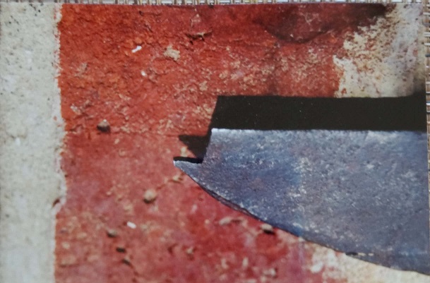

With that, there is another anomaly with this saber.....the curiously applied and deliberate 'notch' in the blade tip. As perplexing as the rest of the elements of this saber are, this one is almost bizarre!
The first picture is the auctioned Bate M1796, the rest are of the saber in discussion.
