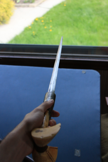

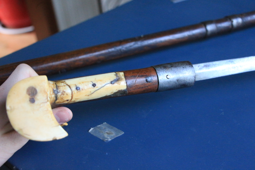

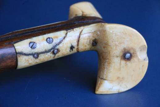

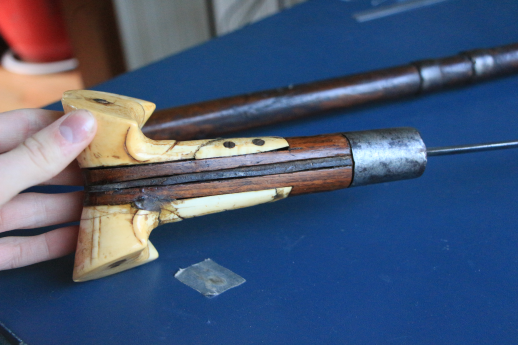

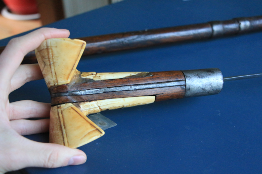

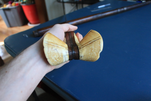

Alright sorry for the delay folks! I tried to take these pics in one go, so if they're a bit rough around the edges then my apologies. This first post will be focused around the hilt, with the next around the scabbard, fittings, and blade. Let me know what you think or if there's anything you want a specific closeup of.
Also thanks for the positive words Jim! I had a feeling you would appreciate this one

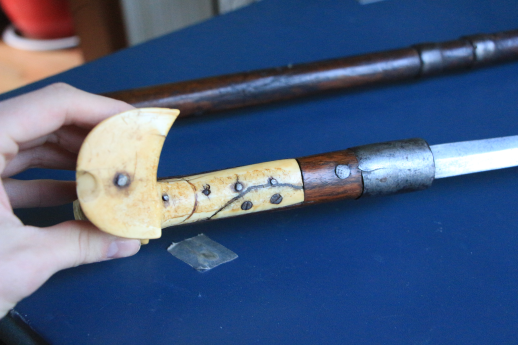

#9 |
Join Date: Feb 2018
Posts: 90

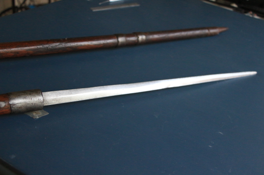

Pt.2
#10 |
Posts: 2,145
Mmmmm nice screws and nail, definitively something recent, early or mid 20thc.
The blade doesn't look European to me and the scabbard is flyssa like type... |

Posts: 1,918
The scales on the other hand, appear quite clearly to be of walrus ivory, and indeed of a more Balkan shape (albeit this attribution is quite fuzzy since skills and styles travelled and overlapped greatly within the Ottoman Empire). Question: Are the metal bands of the scabbard continuous (like metal rings) or are they metal bands surrounding the scabbard and having the ends joined together by bending (flyssa style)? PS: The metal rings/bands on the scabbard can also be a later addition. |
#12 |
Join Date: Feb 2018
Posts: 90
They're continuous! There's a barely-visible seam on each one indicating where the band was forged-welded together.
#13 | |
Join Date: Feb 2018
Posts: 90
That said, the screws themselves actually look rather roughly made, so I suppose they could be original with the piece if the whole thing was made earlier. Maybe late 19th or something like that. |

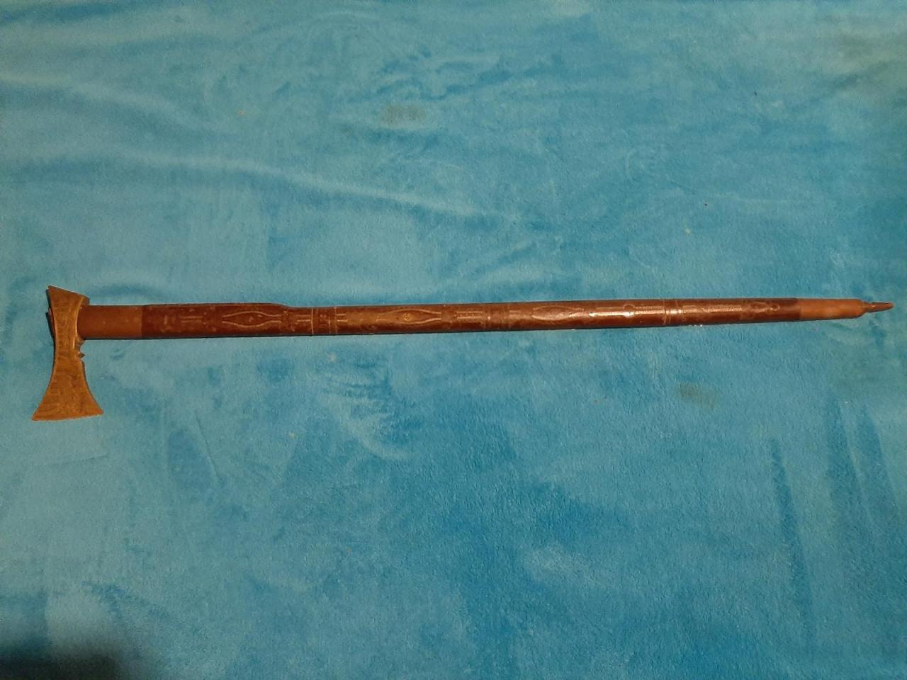

The general shape is very similar to the Carpathian shepherd's ax-staff (valaška, fokos).
They were not always with an ax on the top; there were also other forms of pommel. The authorities often tried to ban them because it was a serious weapon. Maybe valaška with a blade inside is the result of such a prohibition? Last edited by Saracen; 10th May 2021 at 08:03 PM. |
