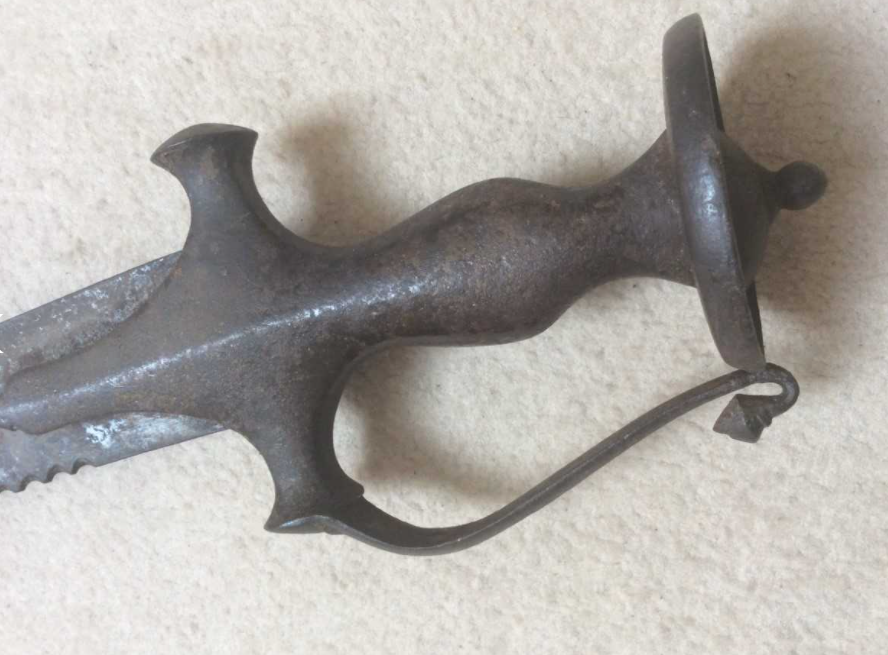

Looking at the handle and the overall sword it is pretty devoid of any decoration.

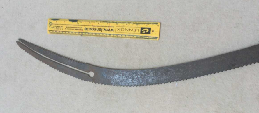

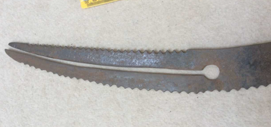

Now the sword cane to me with a lot of damage, namely the forward facing arm of the bifurcated blade was snapped at the central hole off and lost by previous owner.
I fashioned a 20 cm replacement blade part replacement from an old sword blade that was v v rusted and pitted and ground in the serrations and welded it into (place oxo acetylene)
I should have taken pictures of the process but I taught I was documenting a failure so I have no pictures of before.

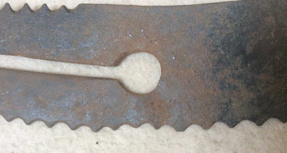

I have included a close up of the failure point, I was not able to get the serrated teeth just right here but I don't think it is too noticeable, if I ever get a TIG welder I reckon I could do a better job but I am OK at Gas welding.
I am letting the red rust age the repair and once i think it is a good match I will clean and stabilise.
