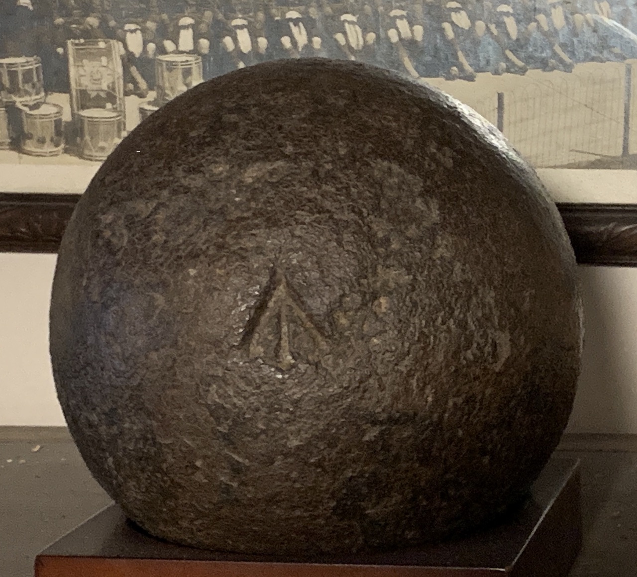

Broad arrow was also used on British cannon ball pre 1800, I'd like to think so the enemy knew who was shooting at them!
This ball dates to be fired in 1760 at Isle aux Noix fort near Montreal.

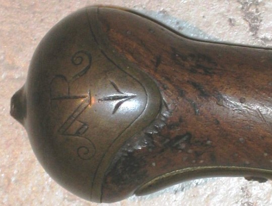

.........and here a pistol of 1747 with the boad arrow

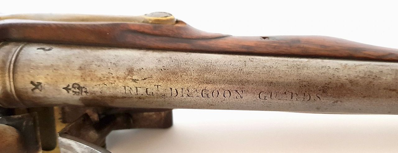

.........and here a pistol of 1747 with the boad arrow and a pistol of Dragoon Guards 1738 with the arrow on its barrel

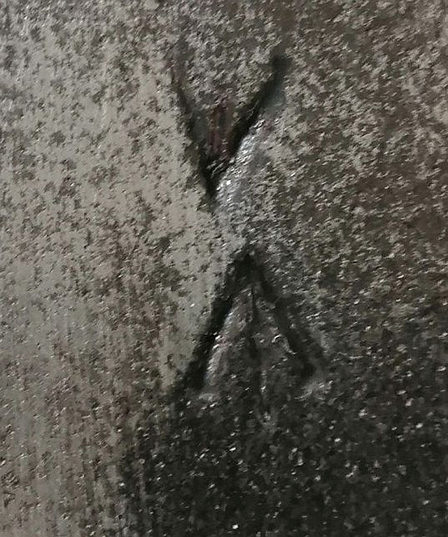

As for this mark having been used since early times as a symbol of the King's property, the most bizarre things are found with such mark; meaning that, finding it in plausible property like canteens, is nothing comparing to bizarre items like screws .

Wow Fernando! now that is bizarre, a screw??? But then I guess in those days, these were not as common as going to the hardware store buying them by the box.

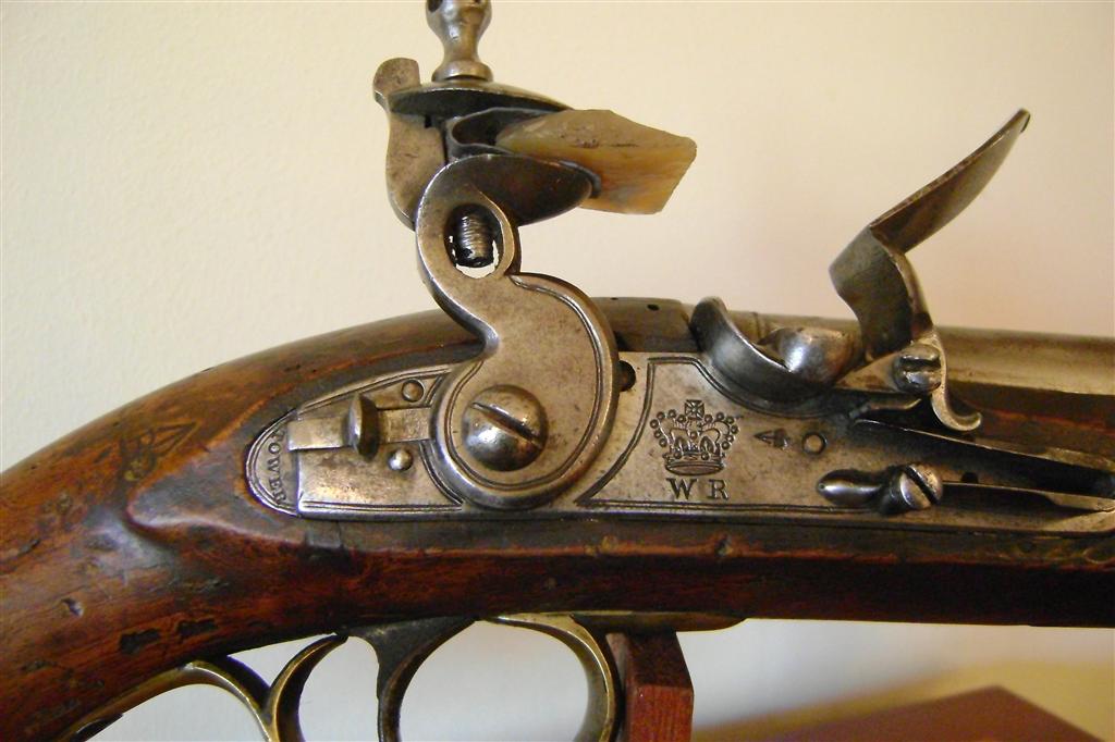

During the reign of of Queen Anne, the Rose and Crown mark was replaced by the Crown and Crossed Sceptres mark, and the Royal Cypher had a broad arrow added underneath. (Ref H.L. Blackmore, "British Military Firearms 1650-1850". p265.) So it seems accepted that the arrow appears of firearms from the very early 1700's. In "The Brown Bess" by Goldstein & Mowbray they depict a style of early crowned arrow stamp used from from 1706-11.
I have a heavily restored musket of King William's reign, it has a no arrows at all and a paper written by David Williams "The Flintlock Ordnance Muskets of William III and their Supply" includes a description of their markings (ten muskets were used for his study) and there is no mention of an arrow used to lock, stock or barrel. King William III died in 1702 & his wife Ann became queen, this supports the evidence that the arrow appears, on firearms, during Queen Ann's reign.

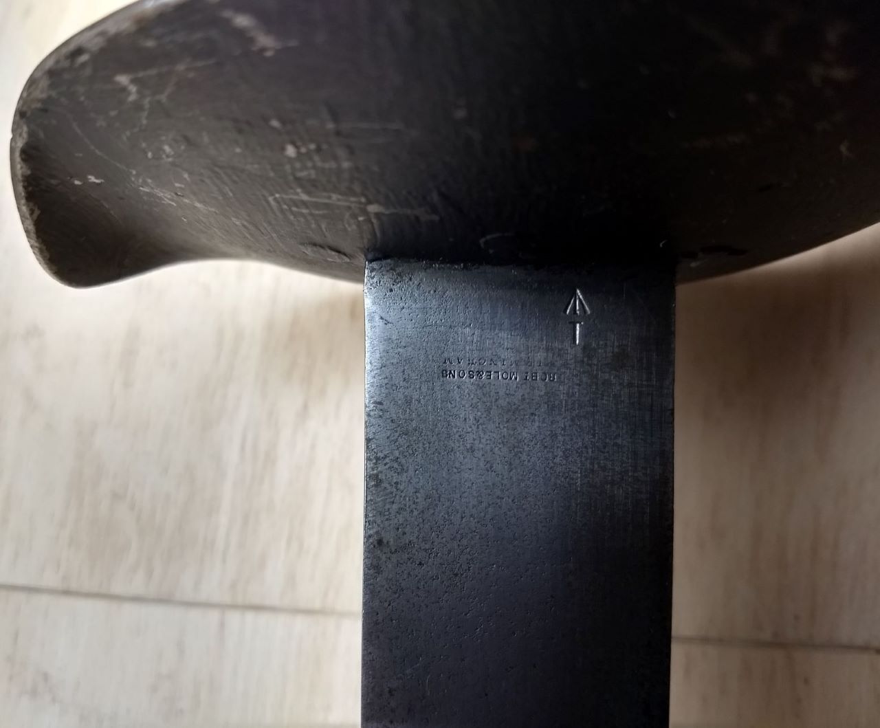

Scinde thanks for the info on the E. I. Co and I attach a picture of a Mole cutlass with the I for India mark. I guess that dates it to around the 1855.
Old 5th February 2021, 05:56 PM   #28
Originally Posted by CutlassCollector
... The arrow started appearing on cutlasses around the middle of the 19th century ...
Maybe in early 19th century. Are you considering my recent post 26#, David ? .

Old 5th February 2021, 07:07 PM   #30
The pre-1804 pattern 'Spectacle' two disk guard cutlass initially had a smooth steel grip, the 1804 pattern steel grip was 'improved' to replace the slippery smooth round grip with a circumferentially grooved one, the grip also grooved fore and aft - like mine - which I suspect was surplused in the 2nd half of the century and the two arrowheads added. - I forgot, they are actually about 4 in. from the guard, not halfway. The next model1845 had a more bowl-like guard and a circumferentially grooved grip.
