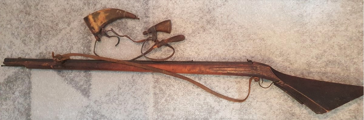

Hello!
I would like to presenta a smallbore rifle from Finland. I do believe that this type of weapons are seldome seen by most collectors.
I picked it up a few days ago in south Sweden (where I did not expect such a rifle either)
It has come by heritage to its former owner from a relative in Finland.
The looks and design makes it look really ancient almost like a 17th century rifle but it is in fact made in the 1880-s. It is made by Leander Grönfors in Högnabba Lappfors Finland. These rifles were made for hunting all kind of game, birds, rabbits, etc. They were know for very high precision over long distances.
It is 127 cm long and a heavy octagon barrel with 7 mm rifled bore. Lock is a "percussion-snap-lock" with only a few moving parts. Amazingly it seems to work perfect with distinct cocking and firing. Pictures are taken before a gentle cleanup and rust removal.
Condition is untouched and thankfully not "restored" a real sleeper so to say.
Best Regards/Ulrik Sjöberg, Sweden

Thanks, Ulrik, for sharing such a rare and unusual gun! All the more amazing that it dates from the 1880s, when the rest of Europe had moved beyond muzzle-loading into breech-loading technology using brass cartridge cases. If it were not for the percussion-cap lock, which had only recently become obsolete in the West, the piece has a very archaic look, reminiscent of the 17th cent. in Scandinavia and somewhat later in Siberia.
This gun looks quite functional and in sound condition despite patina and surface rust. Do you plan on shooting it once you've finished cleaning?
Historically, it belongs in a class with other fascinating examples of extremely conservative firearms technology such as matchlocks in the Orient, and even the same in remote corners of mid-1800s Spanish America.

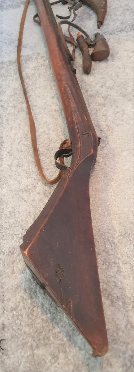

When I viewed the first photo, a thought occurred: Hmmmm.....where have I seen a similar butt stock style ? Then it hit me. See attached photo of a gun in my collection. While it is a flintlock made somewhere in the Balkans in the 19th Century, notice the general shape of the butt stock. What a coincidence. LOL

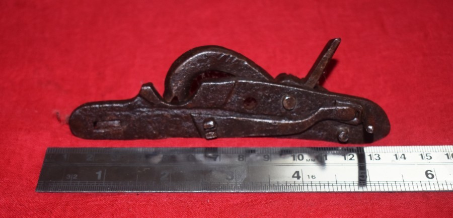

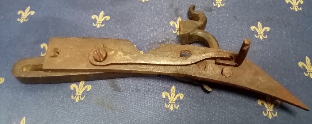

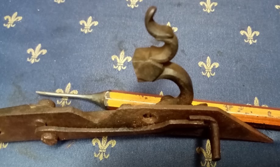

See some more pictures from inside of the lock and the trigger mechanism. Very simple yet effective.

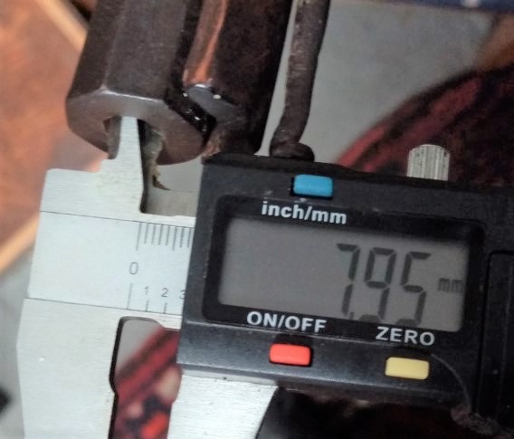

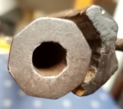

Took new measurements on the barrel and it near 8 mm in the bore.

The lock too is quite interesting in its simplicity.

That sear arrangement is incredibly Simple, but it is a Brilliant idea!
Could I ask to see a photo of the inside of the butt trap? and the inside of the lid?

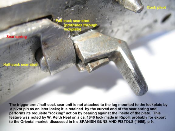

Thanks, Ulrik. The essentials of this mechanism, i.e the action of an external spring on the hammer and the means of release from cocked position, can be traced to Central Europe, possibly south Germany or Bohemia of the second half of the 15th cent. First the primitive snap matchlock later refined by the Portuguese in India and carried to the Far East and Indochina / Malay Archipelago (where used until the 19th cent.) Then adapted to the first flint snaplocks such as used in Scandinavia and Russia, later the various "miquelet" locks of the Mediterranean countries whose design was introduced to places like Algeria and Ceylon.
From what I see there does not appear to be a safety (half-cock) position on the sear (the device that releases the hammer during firing). The sear and its long leaf spring on your lock are identical to the arrangement of the full-cock (primary) sear on the Spanish miquelet lock. But this Finnish one stands out as being even more elegant in its simplicity - just two parts, no need for a pivot pin, or a mounting bracket affixed to the lockplate as is the case with the Mediterranean counterpart. Very ingenious!

The polygonal rifling is useful in a smaller bore like this. Considering the tendency for black powder combustion to foul a bore, cleaning should be a bit easier than with land-and-groove rifling which on early muzzle-loaders tends to be fairly deep and feature anywhere from 5 to 7 grooves.

Although this lock has the same horizontal sear as the locks you mention, I have never (in my sheltered life!) seen one so simply constructed!
Even on the earliest locks, like snapping tinderlocks, the sear has always been mounted using a pivot pin.
This one is really New to me.

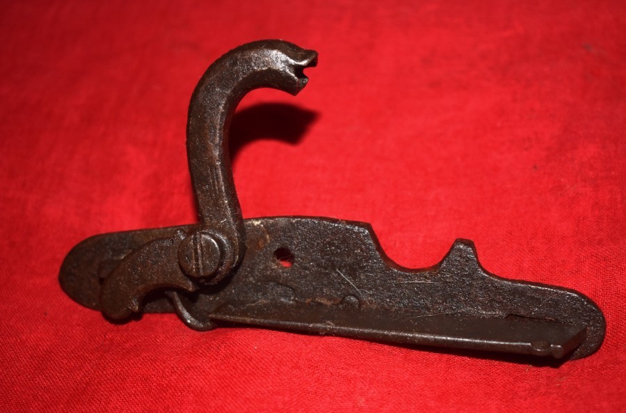

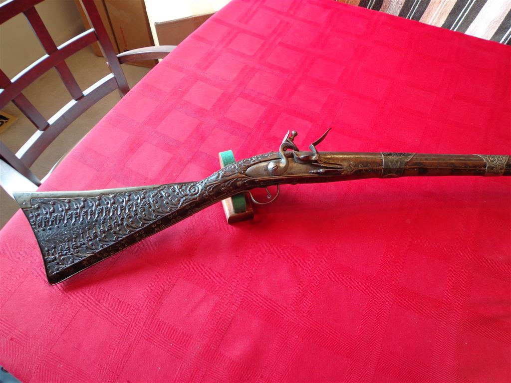

Here is an example of a very early (for a Spanish patilla-style miquelet), ca 1630, made in Brescia, Italy. It has both half- and full-cock sears but getting back to your comment, note that it is designed to work without needing a pivot pin. A stabilizing bracket on the lockplate is still necessary, though -- this is eliminated in the Finnish design.

Thank you for the photos, Philip.
Not seen that type either. It Is a simple design, and probably as good as the pinned type. As you say though, the Finnish model takes this design a step further. It is quite brilliant really.

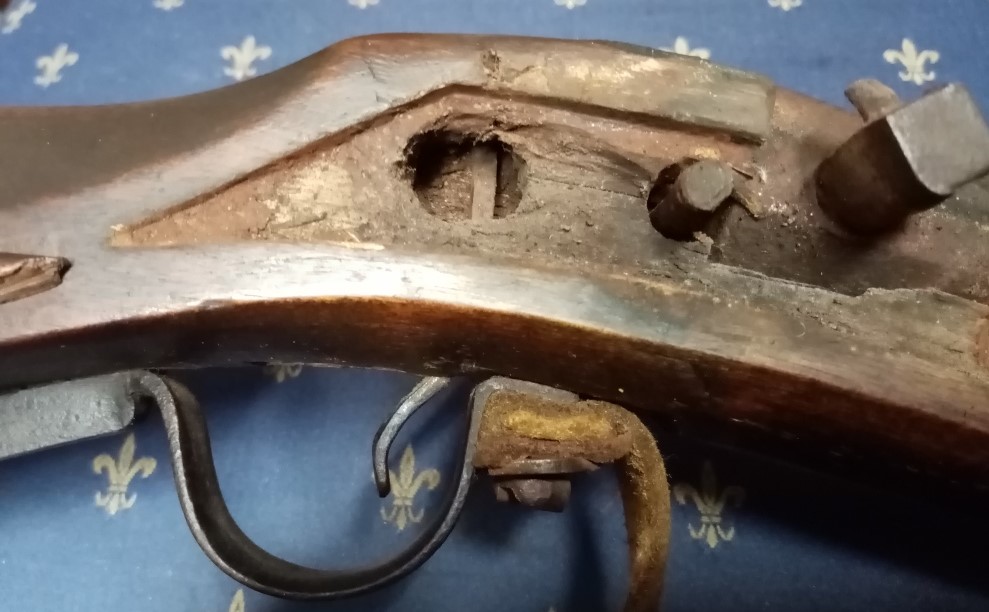

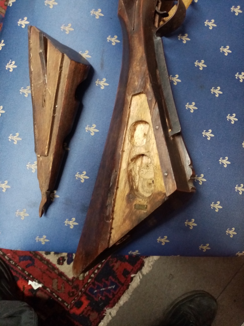

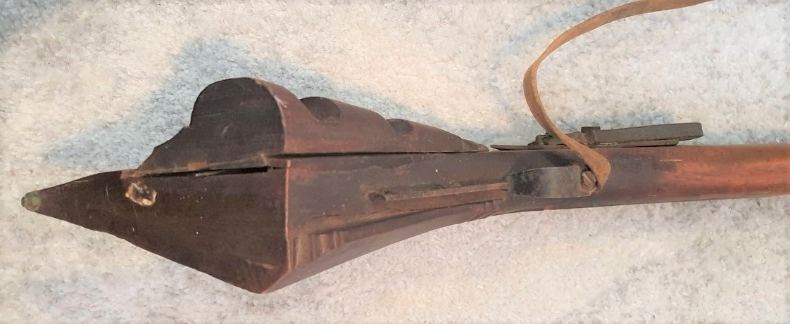

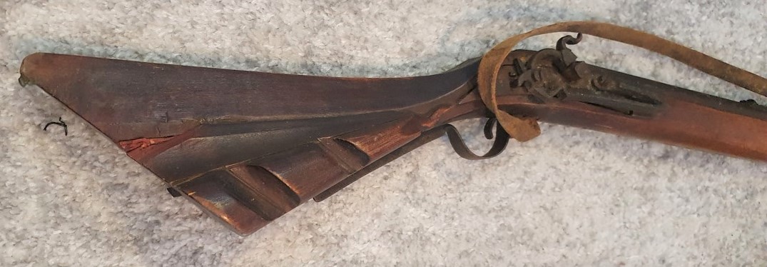

Here is the inside of the patch box.

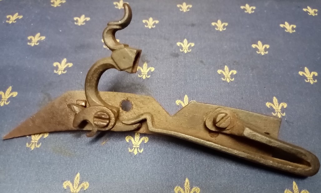

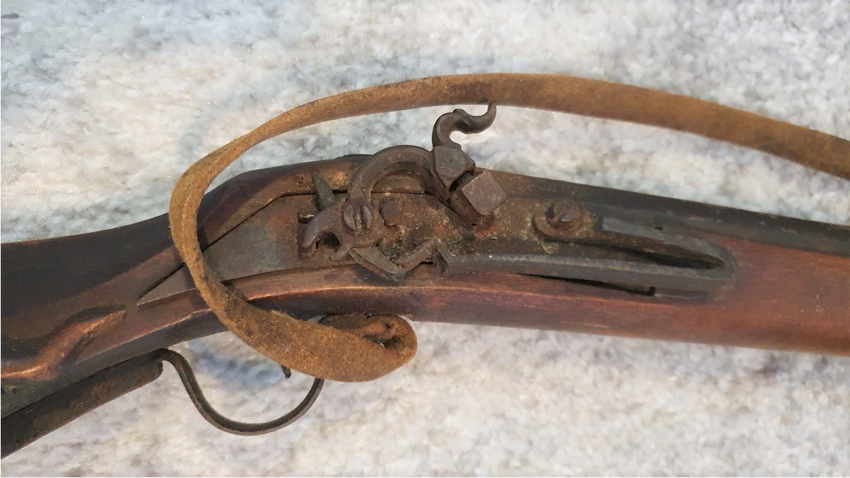

Just for the record here is another percussion lock with the same archaic sear mechanism.

Raf,
Thank you for these photos!
a few days ago I'd never seen one, now I've seen two with this simple sear !
Can you tell me where this lock is from?
Richard.

Sorry no idea. Just stumbled across it on the Net while researching snaplocks. Something about the shape of the cock makes me think Malasia

Thank you for the reply, Raf.
Yes, possibly Malasia.
It also reminds me of the snaplock serpent, seen on some of Tipu Sultan's guns.
Yes, the profile of the serpentine is reminiscent but the lockplate outline is not. The lockplate on the example you posted has a profile somewhat like a European flintlock of the 17th cent. onward. The materials are also different, here it is iron whereas virtually all Malay Archipelago snapping matchlocks are entirely of brass (like their Japanese and Korean counterparts) down to the mainspring, and not to mention having more decoration.
