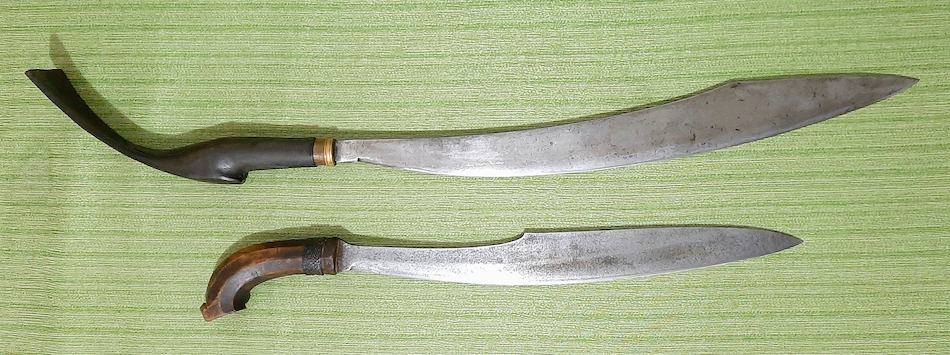

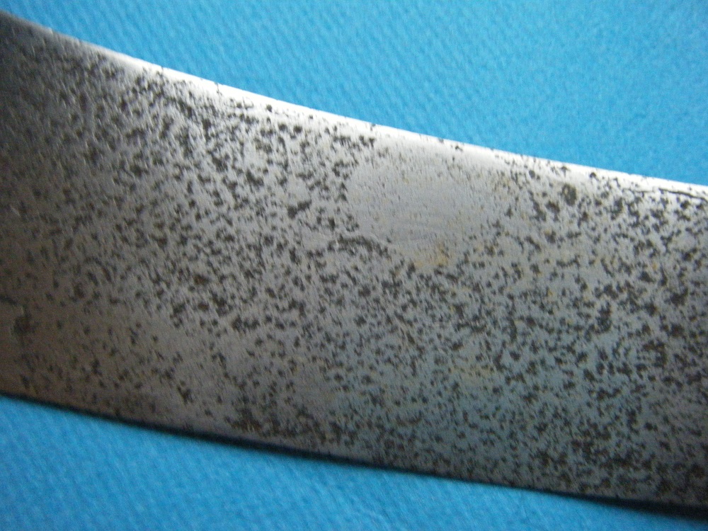

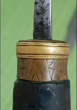

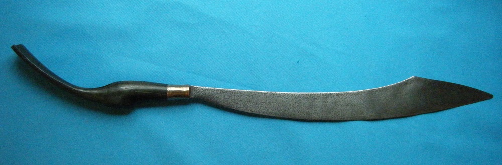

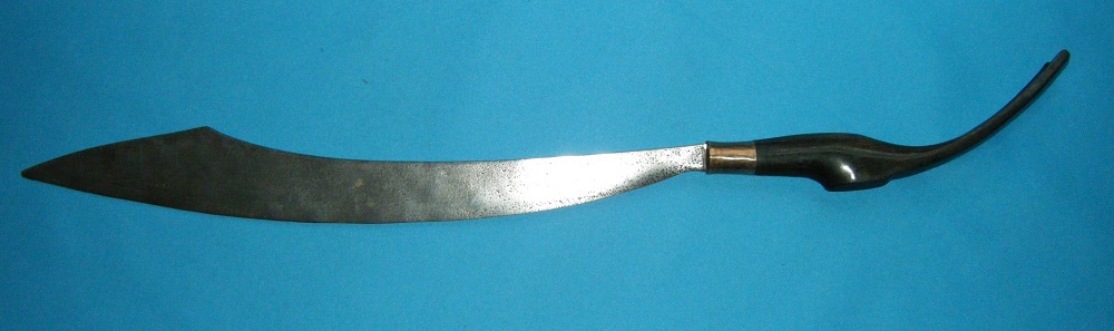

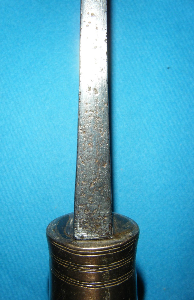

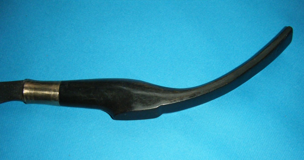

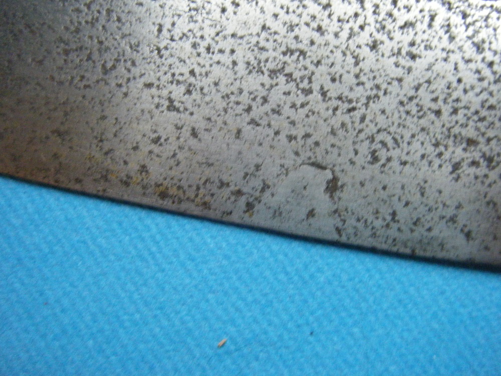

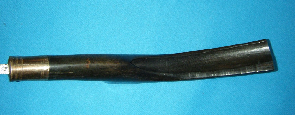

I was able to add a pira to the collection, it's a rather big sword with 79 cm overall and a blade from 50,5 cm, behind the handle is the blade 9,5 mm thick.

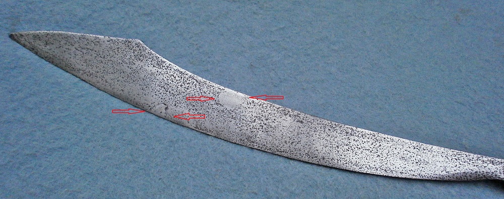

I think to see two blade repairs, see the pictures. The blade is rather pitted, sadly. Ferrule is from pinkish silver. The tip of the blade is thickened at the tip again, is this a common feature by pira blades?
Like usual, all comments are welcome!

Thank you Rick! The thickening at the blades tip is one of the reasons to let me think that the blade is very old, it would be great to know how it is by other examples.
That we don't see many of them is the reason that they are so expensive! This are rare swords, we can be happy to own such a sword!

Hi Detlef, I think we have similar pieces. Mine has a blade length of 51.5cm, and 78cm overall. The tip is also thickened at the tip. Spine thickness at the base is 0.8cm. I'm not sure what the ferrule material is, but it has engravings. Posting a pic comparing it with a younger pira.

Hi Xas, yes, they are indeed very similar, from measurements and from the appearance also. The thickened tip gives the blade an extra strengthening where it's needed. Nice blade condition, I am a little bit jealous!

Hello Detlef,
Congrats, that certainly is a nice example! I'd be very interested to see how this blade looks after etching (that will also help to analyze those 2 areas that you think may be repairs). I don't think the pitting distracts very much - it's certainly a good blade!
I have a really similar piece (with suasa ferrule) that is also thinner where the blade is wider and again thicker where narrowing towards the tip. I believe this is mainly due to forging a billet of relatively even thickness to different widths, something that can be seen with many SEA blades. I'm not convinced the thinness of the wide part has any important functional reason; one possibility would be to increase cutting ability near the sweet spot.
We certainly need more details from a wide variety of this traditional gasah/pira style. Since dating is difficult to begin with, establishing a reliable timeline might prove very tough.
Could you add more dimensions for your blade, please? Will also try this weekend.

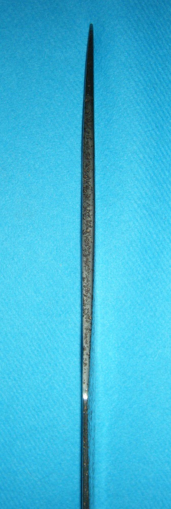

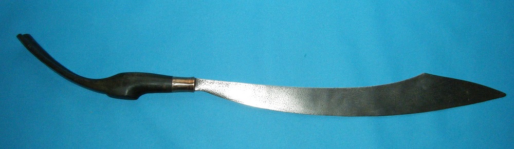

Here the picture.

Hello Kai,
Fine that we have such detailed measurements from your example but a picture or two would be very useful also!

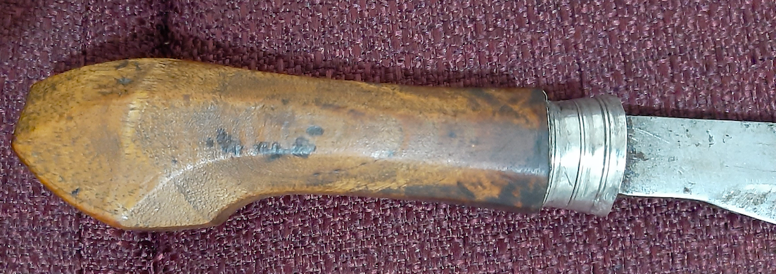

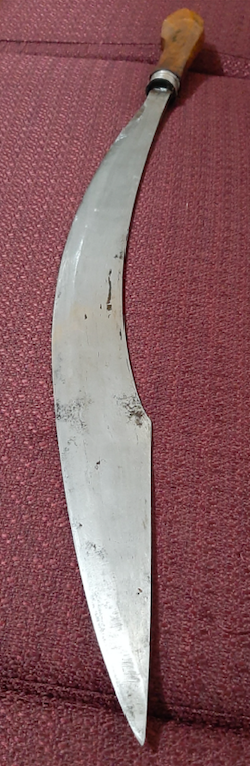

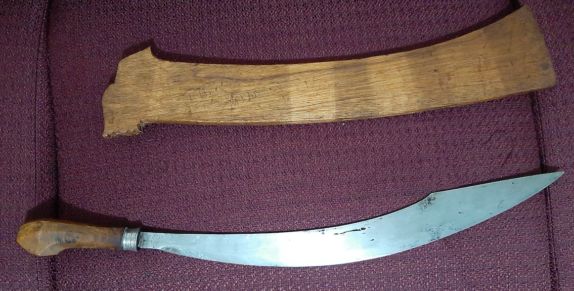

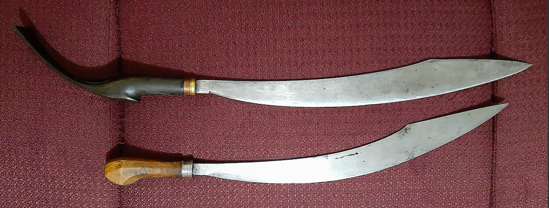

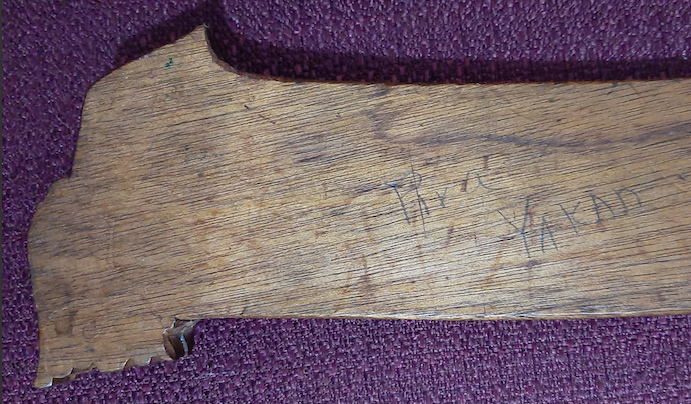

Recently got a pira off ebay. It's slightly smaller, rougher (especially the hilt) as compared to my older piece but still a great wield, very light and manueverable, probably the forerunner of the modern pira. Hilt is 5.25in, blade is 19.25in.

Hello Xas,
Thanks for reminding me...
I believe this is a genuine antique blade that got redressed some time during the 20th century: the ferrule might be original, the hilt and scabbard are definitely younger.
Very unusual example Xas! Special the strong curve of the blade is very unusual. Hilt and scabbard could very well original I guess.
Hi Detlef! Thanks for this opinion...one of my mentors also believes it's all-original, and a younger time period than our pommel-extended samples. It's got a thinner spine as well, with the base at only 0.6cm, and a much lighter wield than my pommel-extended pira, or other old pira that I've held. The blade has a very slasher feel to it; when it botches up a cut, the blade flexes (much like how Maguindanao kampilan tips behave) but it's easy to straighten out again.
