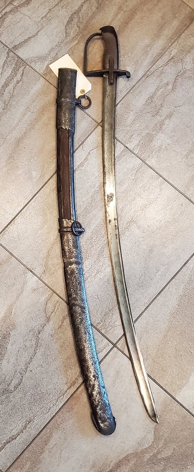

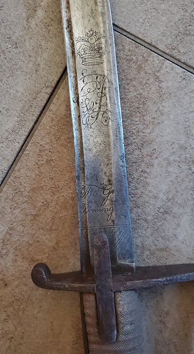

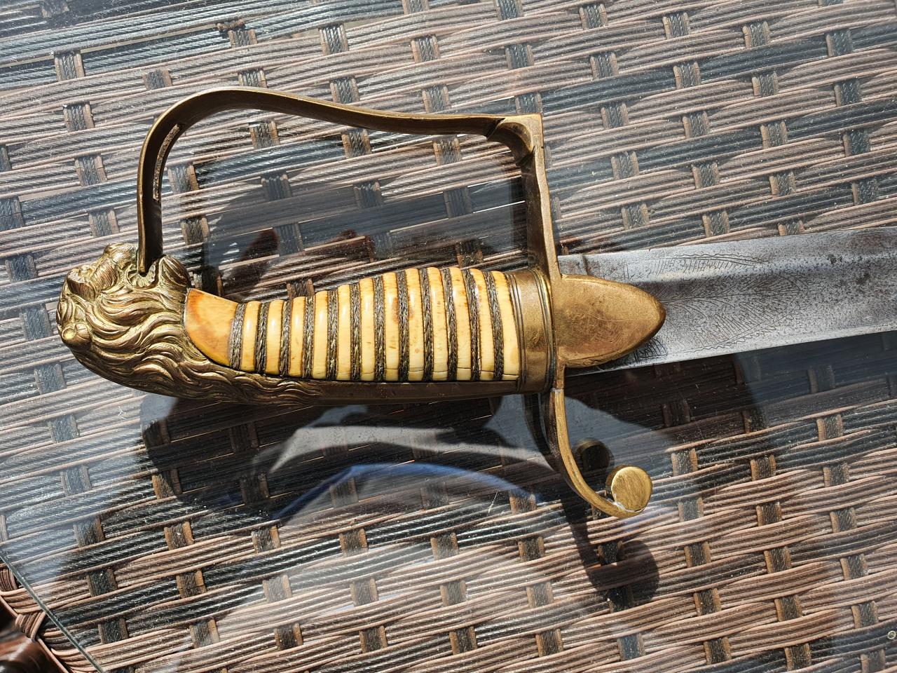

Hello!

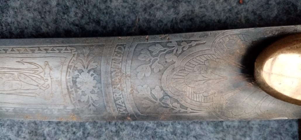

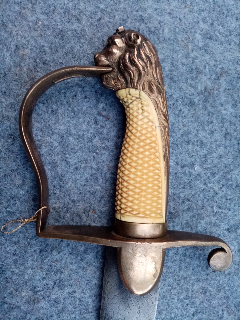

I am curious about the depicted sabre. Unfortunately no scabbard..Grip seems to be of ivory and the stongly curved blade is etched with British coat of arms and "Warranted".
What exactly was under the warranty? Blade of course, but in what aspects?
Hilt has traces of guilding and also the blade.
Any other information about this is highly appreciated.
Best regards/Ulrik Sjöberg, Sweden.

Interesting Georgian saber probably c. 1804, the lionhead resembles the M1803 British infantry and flank company officers sabers but without the pierced knuckleguard w/ cypher.
The grip reminds me of naval officers swords of this period.
The 'warranted' was of course to the blade, and arose with the 'sword scandals ' of the late1780s where Thomas Gill of Birmingham challenged the German imported blades which were dominating the contracts for East India Co.
There were tests on the blades and he was joined by Henry Osborn and James Wooley. These makers took to marking the blades 'warranted' (Gill used 'Warranted Never to Fail").
It seems Osborn often used the warranted word alone, not sure on Wooley.

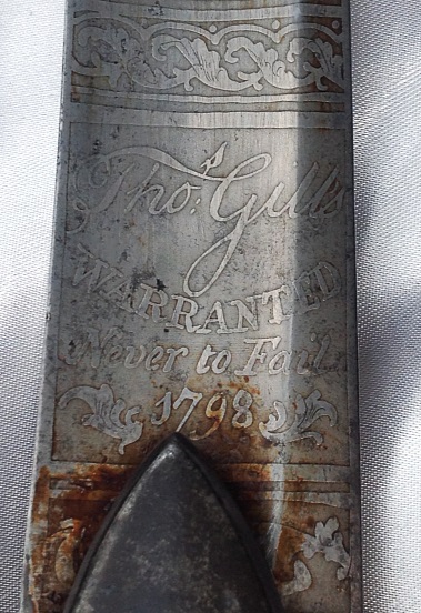

G'day Ulrik,

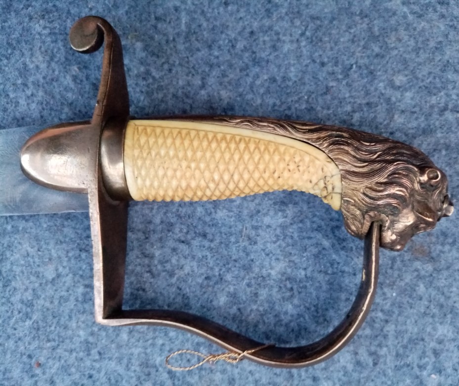

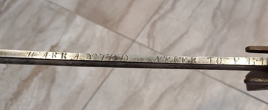

To add to what Jim has posted, most of these stirrup-hilted lion head swords predate the 1803 pattern infantry officer sword. I have one with a horn grip which is dated 1799. Ivory gripped examples like yours were favoured by militia and volunteer regiment officers whose swords tended to be a little fancier than their regular army cousins.
Below is a photo of Thomas Gill's full warranted spiel on a 1796 light cavalry officer's sabre.

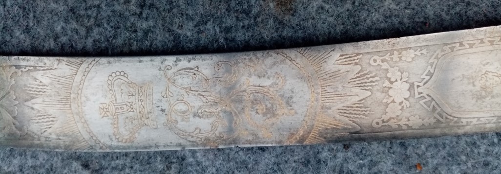

Here is an image of the Osborn's Warranted logo on an officers 1796 L.C. sabre manufactured between 1796 and 1801.
Norman.

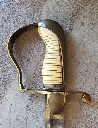

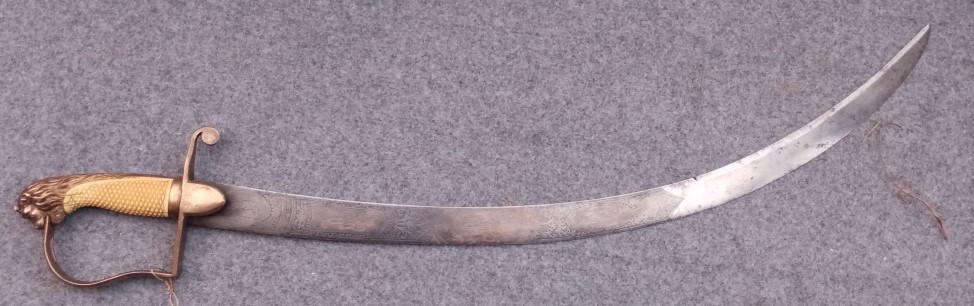

First three pics are a Thomas Gill M1788 cavalry saber, warranted on blade back.
The ivory hilt saber is M1796 yeomanry officer with curious saber knot bar near cross guard. These yeomanry officers had even more latitude than regular regiments officers so the individuality was notable.
These examples are not in great condition but just illustrations of the forms.

Daggpil,
Can you share a photo of the figure above the warranted line? I think I see an anchor behind his feet which could signify this sword was for a navy officer.

Posts: 165

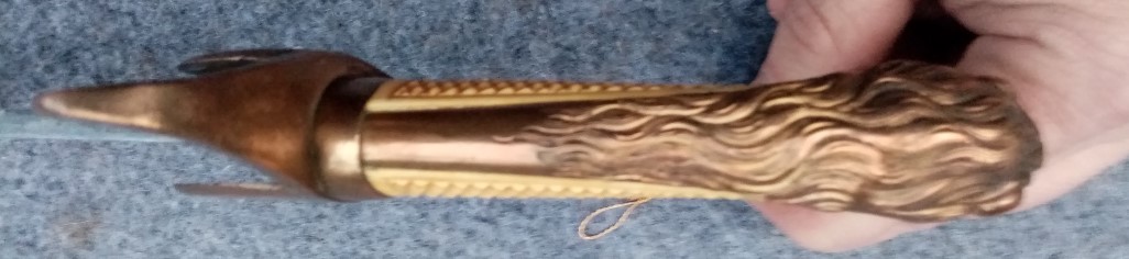

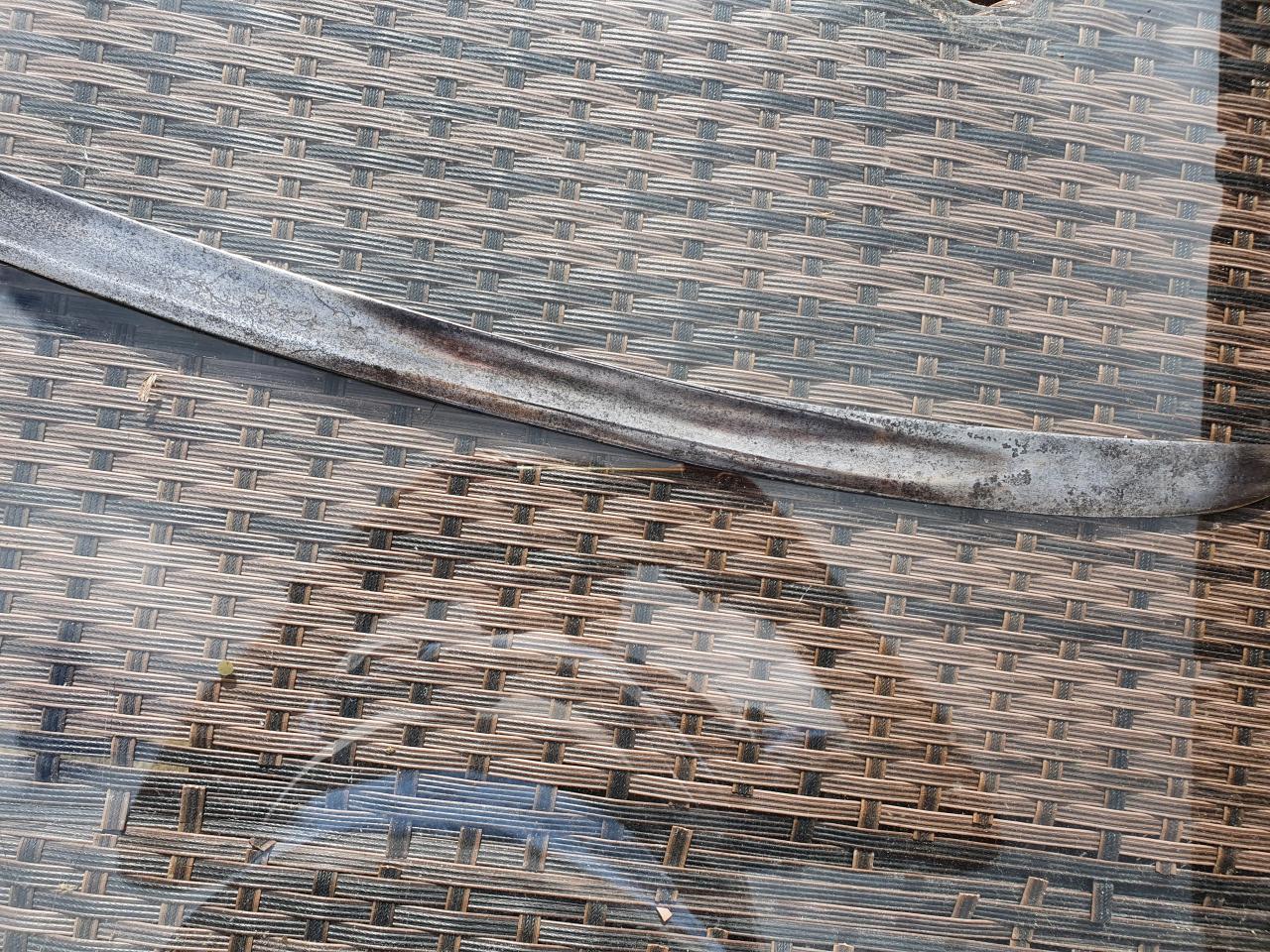

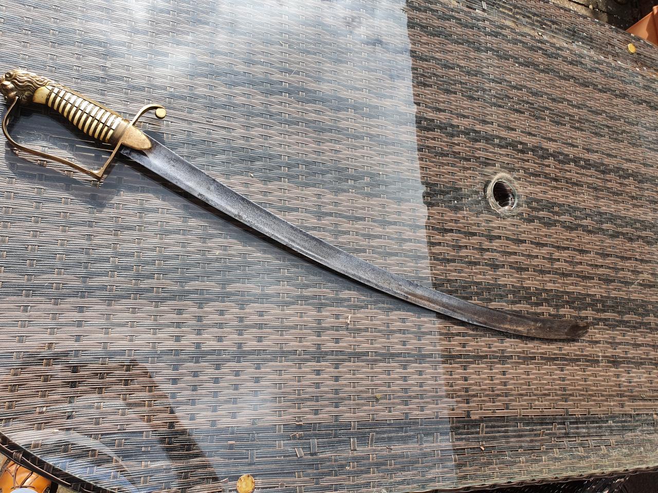

I had one not unlike this (attached). It was either non-regulation or possibly a militia officers sword. I have one with a chequered ivory grip and lions head, but the hilt has acanthus leaves on the ferrule and knuckle guard.
The fuller goes pretty close to the point on the former.
