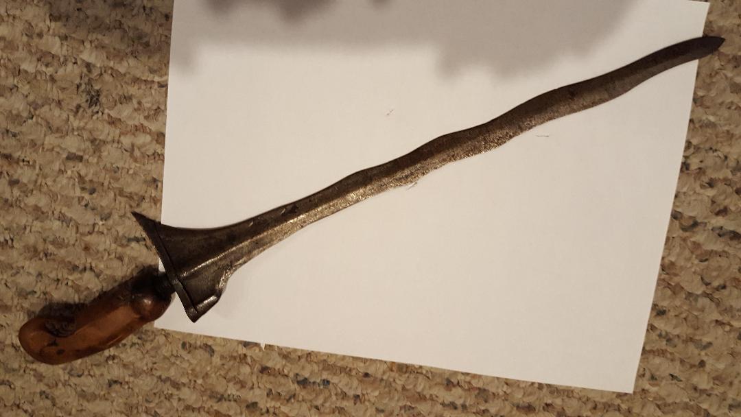

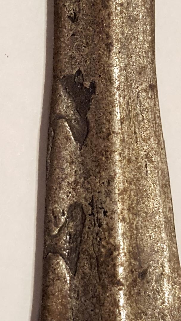

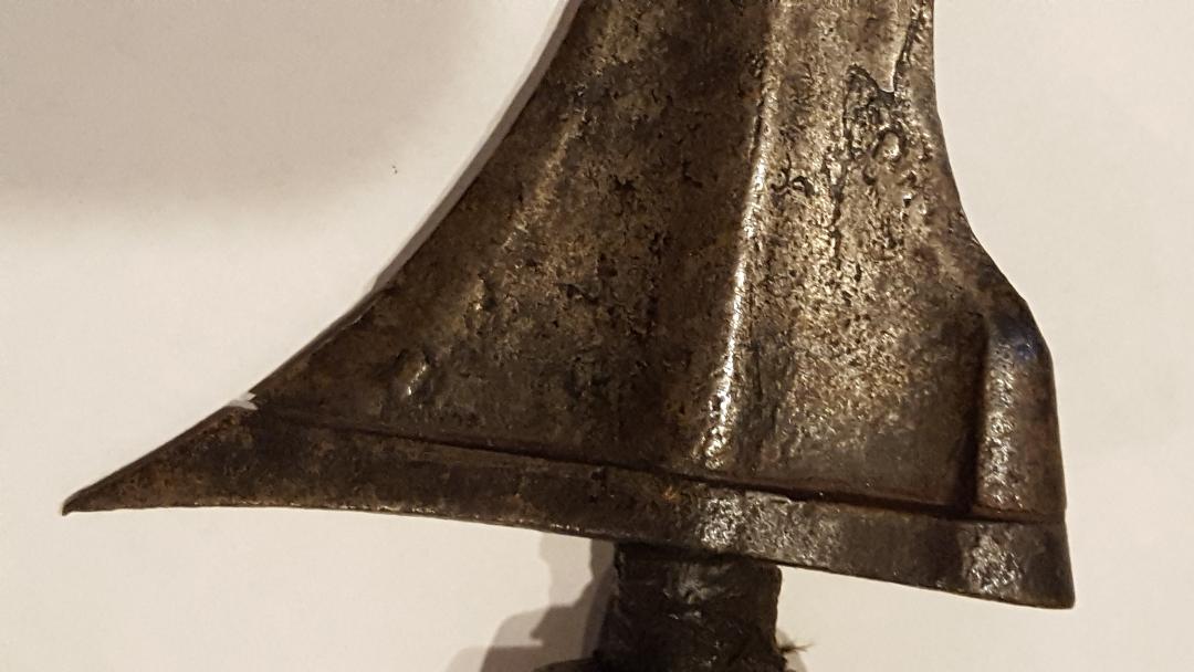

Hey all, found this while looking for Barbie's for my wife in an antique shop. Price was to good to pass on. Although it took me a bit to talk myself into it. It looks pretty worn, does seem to have some age. Can't tell if it's meteor iron or not. First look does not appear to be. Definite forging flaws. So what do you all think?
Old 1st November 2020, 08:19 AM   #2
Hello Mike,
There is no way of knowing if this keris was forged with meteor iron unless you start full-blown (and partly destructive) scientific material testing which most likely will yield negative or inconclusive results though. From statistics alone, chances for use of meteor iron are slim to none, anyway.
This blade started out as a straight blade and, unfortunately, someone tried to grind the waves into the blade by stock removal; certainly not a traditional approach, sorry.

Looks grind and good keris does not come cheap, at least a few hundred USD. Meteorite iron? Most likely not so.
Kai, that makes sense on the luk's. Would explain why they looked a bit off, which was one of the reasons I vacillated on it. I had not thought of a latter modification to a forged blade, good eye. As to meteor iron, it depends on how it was forged. I have seen blades where the Weidmann pattern is still visible. It is not easy to do you can't forge too hot, but I have seen it. I would have to clean it up and give it a ferric bath, might be worthwhile.

Whether the luk were ground or forged later, the blade totally lacks harmony.

I simply mean that the luks are not evenly spaced and forged, and that the blade has poor proportions.
Personally I am not fully sure that the luks were ground from a straight blade (please draw a line from the middle of the base of the blade to the tip with a ruler on the screen), they may have been forged later by an amateur smith?

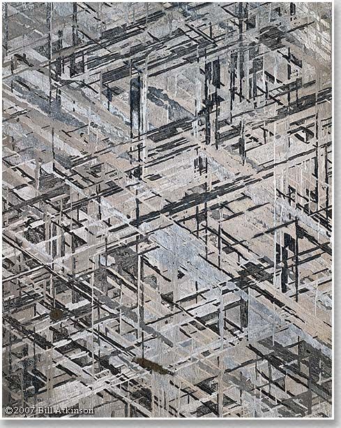

Thanks for digging up those pics from Blade Magazine. Honestly that doesn't really look like a Widmanstätten pattern to me, but i suppose that might possibly be what happens when you hammer a thin layer on and the pattern distorts. I would expect more intersecting lines and angles though. This looks more like a fancy pamor manipulation. If you have any links to the actual article in the magazine i would love to read what they said about this beautiful blade.

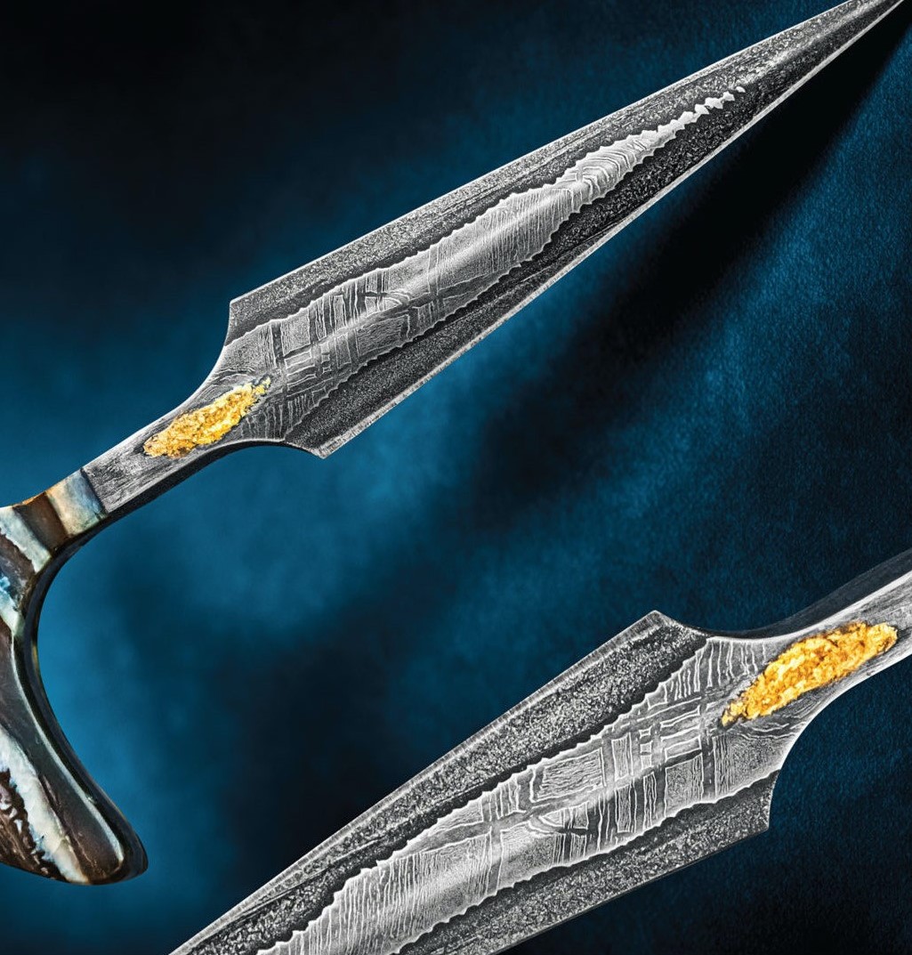

here's the page from Blade Magazine October 2020

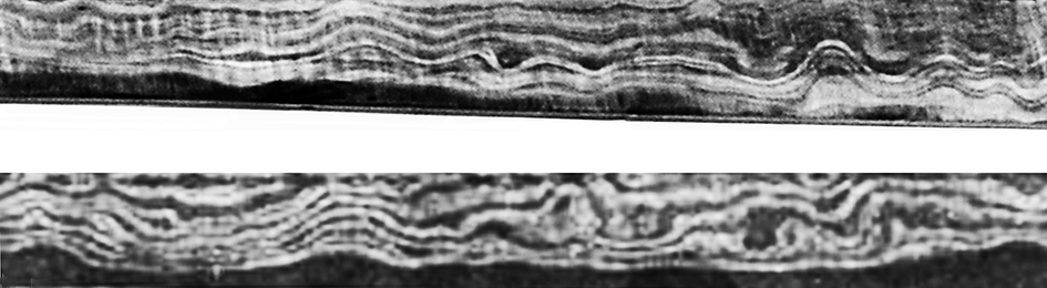

The Empu Karja di Kromo forged five Kerisblades in 1904. The forging of these blades is described by Dr. Groneman. His articles are published in the Internationales Archiv fur Ethnographie in 1910 and 1913.
I made a replica of the first blade Karja di Kromo forged. I tried to make the pamor material just as it was executed by the kraton of Surakarta. I used Campo del Cielo meteoriet and adjusted the quantities a bit to approach the properties of the Prambanan meteorite.
From each stage in the forging process I kept material samples.
By modern spectrometric analyzing methods the meteorite could be detected from the beginning of the forging process till the completed blade and during all the stages.
Below a picture with a part of the photo of the original keris published in the IAfE, showing the original pamor of Keris number I, forged by Karja di Krama and below that, the pamor in the replica forged by me. I think I am getting close.
So these days it is possible to trace meteorite in Keris, probably as long as the quantities are not extremely low.
(As example, Djeno Harumbrodjo mentioned, he used one gram of meteorite starting the forging of a Keris (on two kgs or more of iron and steel?).

Thanks for the article. What there is of it. Frankly it is not at all in depth and everything in it is prefaced with "according to Tristan". Far be it from me to doubt the word of a 17 yr. old boy, but i can't help but be just a little bit suspicious of his claims. That said, it is still beautiful blade, but if that is indeed the original Widmanstätten pattern and he didn't heat it beyond the temperatures that would eliminate such patterns, did he indeed make a structurally sound weapon, or simply a beautiful art object? Did he mix his meteorite with iron and a steel core or is his blade 100% meteorite that was heated, beaten a bit and than shaped? There are no answers to be found in this article unfortunately.
Regardless, my original point was that you will never find such a pattern in an Indonesian keris that could serve as proof of meteoric content. Though, of course, one should never say never when it comes to keris i have learned.

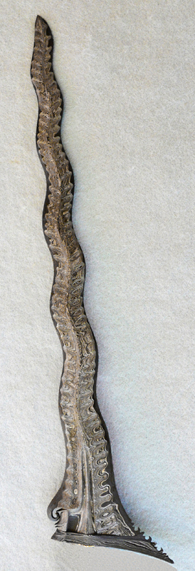

Seerp, I think what David is looking for is that unique Widmanstätten pattern, and what I used to be looking for was concrete evidence that the contrasting material in a blade did indeed come from a meteor.
In your photos I can see contrasting material, but how do we know that this came from a meteor unless we saw it included in the forging when the material was still in the forge?
That is problem. We cannot pick up something that we have no previous knowledge of and carry out any testing that will definitely confirm that the item contains meteor.
During the 1980's and 1990's I made a lot of pamor and nickel damascus. I made pamor using several different types of nickelous material, including pure nickel and Arizona meteorite. I made a lot of damascus using pure nickel, and few pieces of damascus using meteorite.
If you presented me with a mix of various pieces of pamor, polished, etched & stained, I doubt that I could tell what material had been used to create the pamor. If I had a piece of meteoritic material in my hand, that is pure meteorite, nothing else, that had been folded and welded 8 or 10 times, then polished, etched, stained, I could not tell if it was meteorite or not.
If I use the traditional "touch test" on a blade that contains meteorite, I can detect a very tiny, almost imperceptible difference between the meteorite blade and a blade that has used commercial nickel, or some nickel alloy.
But then this might just be my imagination, because the blades that I do this sort of test with are only blades that it might be expected could contain meteorite.
The point is this:- we cannot confirm the presence of meteoritic material in a blade after that material has been through the forge welding process.
Actually, I don't consider meteoritic material to be anything special, the cleaning process requires great care and a delicate touch if you wish the resultant billet to be pure meteorite, but once you get to using it as a component part of a blade it is no more nor less difficult than any other nickelous material, and when the blade is finished --- well, I've already commented on that.

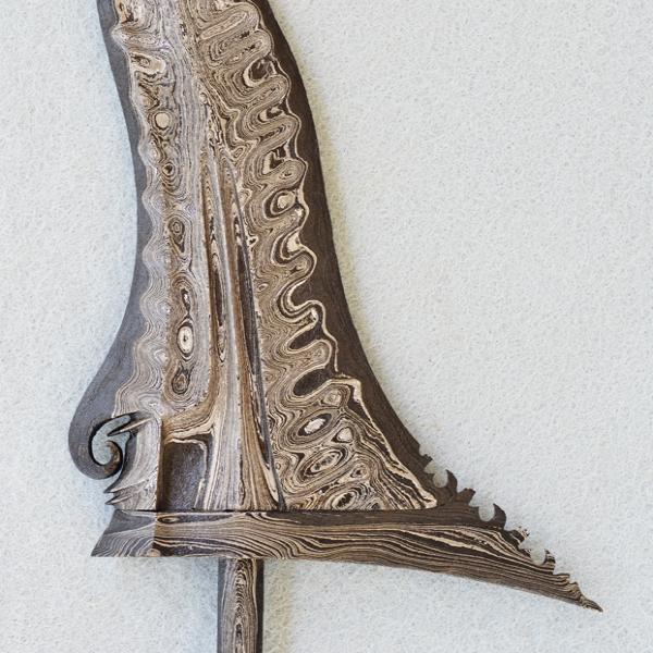

The photos are of a keris that I commissioned from a maker in Solo, I will not name him as he is a very private man and I do not have his permission to use his name, enough to say that I considered him to be very talented. He retired from keris work some years ago.
This blade definitely does contain meteor. I made a billet of pure Arizona meteorite that I gave to this maker and it was used in this blade.
This is the only keris that I know of that unquestionably contains meteoritic material.

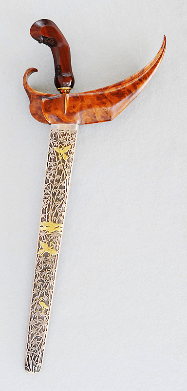

Thanks Anthony, yes, at his best --- which was most definitely not always --- I consider this man to have been the best exponent of his generation of the classic Surakarta keris.
Here it is in full dress.

Spot on Seerp. Jerzy said pretty much the same thing about ID of meteorite after the forge weld process.
It is a really pretty keris David, in fact much better than the photo shows, that photo was done more than ten years ago, my equipment and understanding has improved a bit during the last 10 or 12 years.
As for our young wouldbe blade smith, I'd just as soon not comment, let other people teach him what's right & what's wrong.
I am lost for word. Even the dress is awesome.

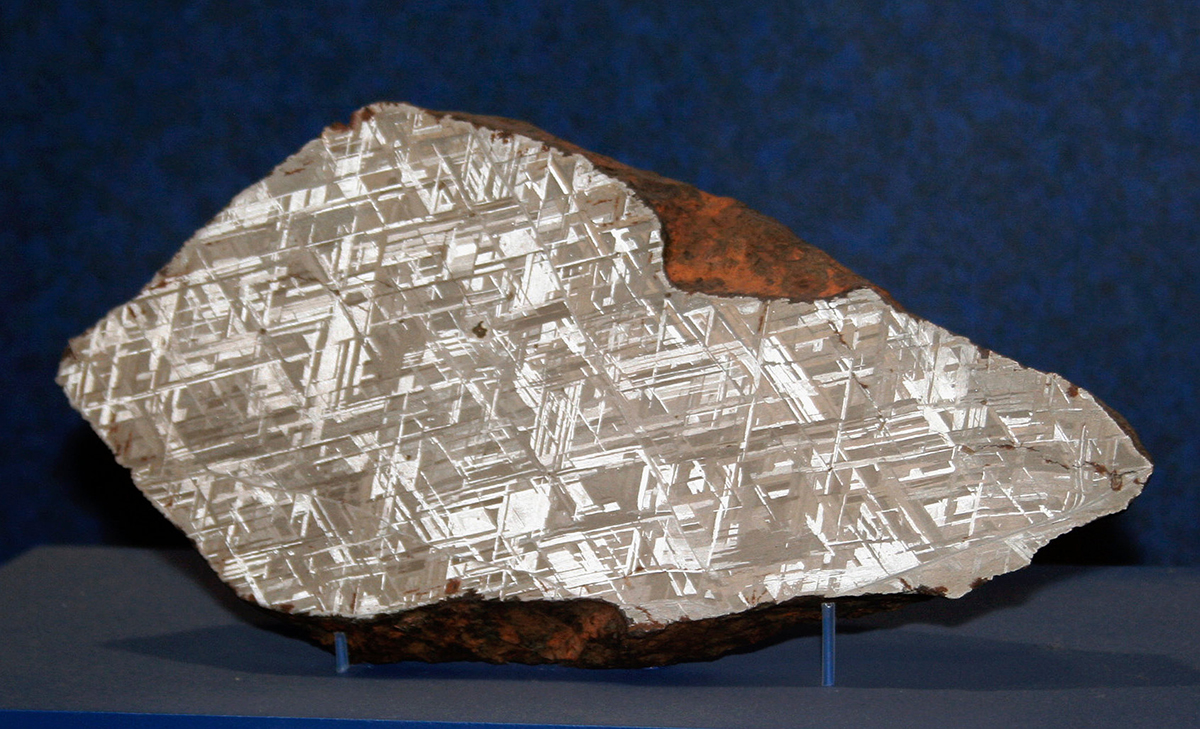

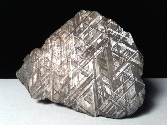

In A. Weihrauch's thesis there is a dokumentation of an experiment - they made a weld sample with different ferric materials, and one of them was an iron meteorite.
Even after forging and welding the Widmanstätten pattern is still recognisable in enlargement 500:1.
There is a remark "after a longer glow they (the W-patterns) disappear completely.".
Old 16th March 2021, 09:39 PM   #30
Posts: 7,228
That is very interesting information Gustav.
I assume that Weihrauch was talking about welding in the forge?
It is interesting, but also confusing.
The weld temperature of iron is + 2500F (1400C) at and above this temperature the surface of the iron is beginning to show white, it is sticky and on the point of liquification
The weld temperature of most steels is + 1700F (900C) and it is into high orange in colour, the surface is sticky but not liquifying.
Nickel has a lower weld temperature than the steels, I'm not sure what the actual temperature is, but I'd guess +/- 200F lower, say around 1400F - 1600F.
So when we weld a piece of material like meteoritic material, that has nickel running through it we are welding the iron at more than 2500F and the nickel is also going to be at +2500F, however, the melting temperature of nickel is between 1600F & 1700F, so when the weld is taken, that nickel is already well past its melting point.
To take the weld, hammer blows on the surfaces of the material are required, initially only light, but increasing in force.
The colour of the iron when first hit will be close to white and it will be beginning to liquify.
Weihrauch has stated:- "after a longer glow they (the W-patterns) disappear completely."
To my mind it is truly miraculous that any Widmanstatten pattern remained in the material, even before it was hit with a hammer. If, of course, Weihrauch was talking about forge welding, not gas welds, nor electric welds.
To use meteoritic material in a blade it needs to be cleaned, this is achieved by folding and welding the billet of meteoritic material. In my experience it usually takes at least 7 welds before the meteoritic material is clean enough to use. So 7 or more welds, combined with quite heavy forging. Then more welding to attach the meteoritic material to the steel core.
I think I'll continue to back Prof. Piaskowski's opinion.
