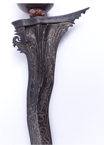

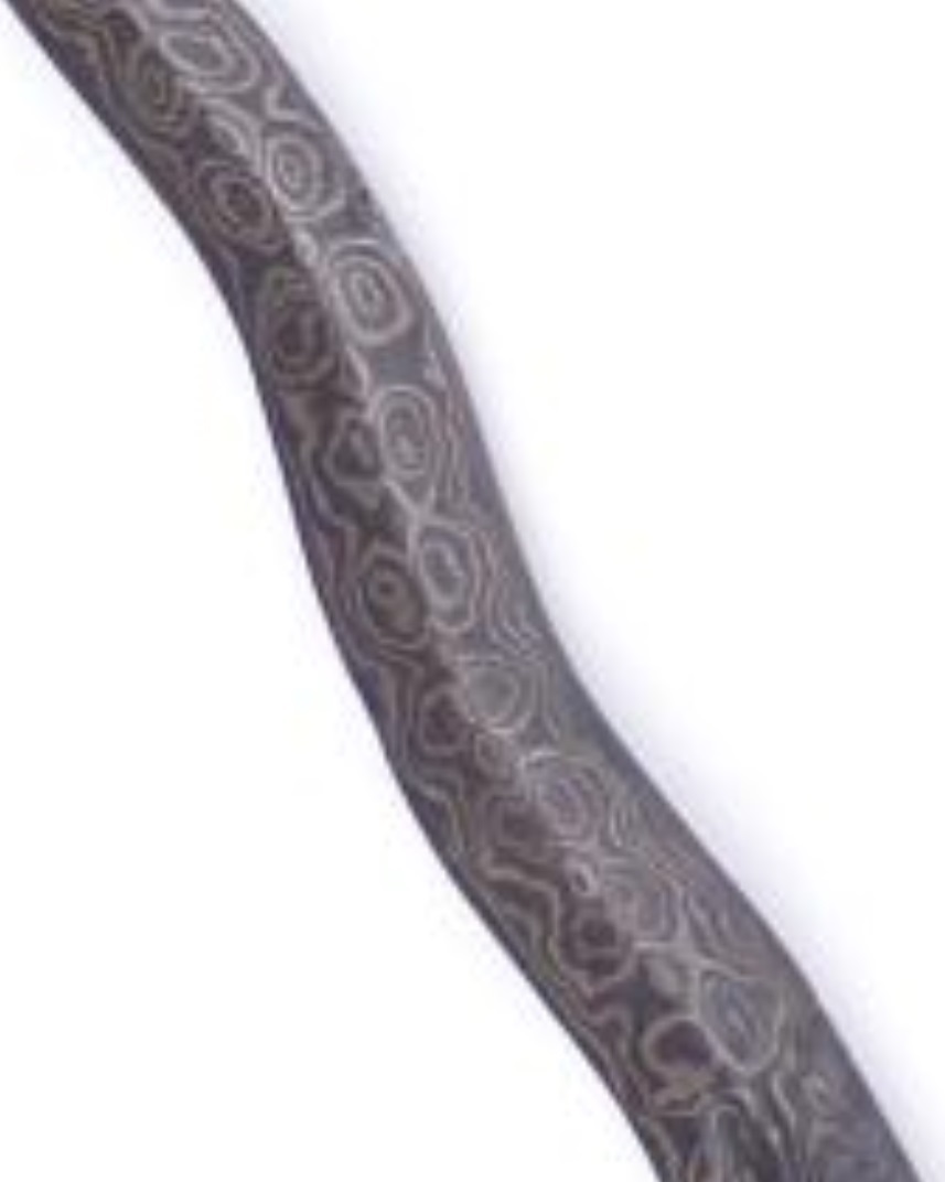

Please help to identify the pamor of this Balinese bilah. Thank you.

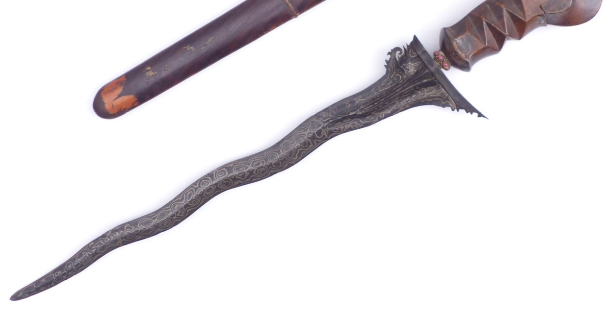

Balinese?? Please show us the full blade.
Old 5th September 2020, 05:07 PM   #3
Anthony G.
Join Date: Mar 2018
Posts: 470
Attached as requested.

IMO: sumsum buron

Thank you Antony and the blade looks in Balinese or Lombok style indeed and to have some age.
Sumsum Buron is a rare Javanese pamor pattern and it does not look very similar to this one (it has 2 versions) but I can't identify it better, may be pamor Srante but only a Balinese expert could confirm it with some certainty.

No Jean, I could not confirm too much from the photos. Yes, it certainly looks like Bali, that I can confirm, but whether Bali or Lombok or Madura, sorry no idea, and frankly, even if i had it my hand I'd only be guessing.
Bali blades from Madura are not something that is only recent, as far as I know Bali was getting work done in Madura long, long ago, and still is.
Current Balinese makers will work together with both Jawa makers and Madura makers.
When a blade is already complete and particularly if it has a bit of age and what appears to be original dress, it is probably impossible to know exactly where something was made.

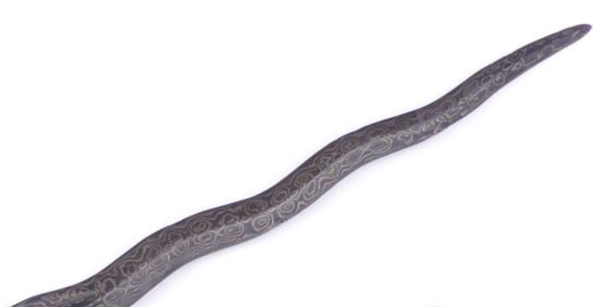

Obviously I cannot tell either, I just observe that the surface finish and the pamor pattern do not look typical of old Balinese blades.
