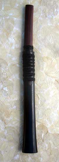

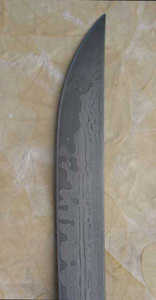

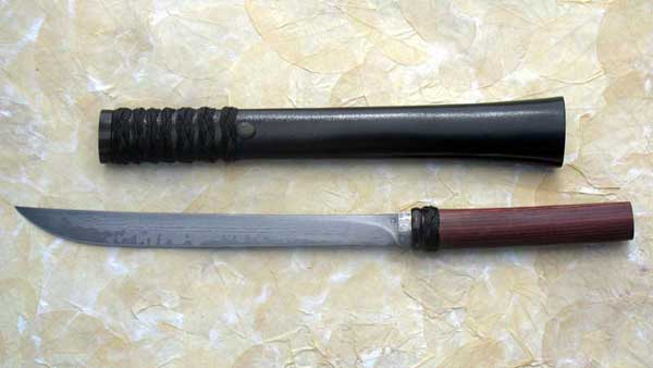

Here is an dha inspired short sword I completed. It is of 300 layer damascus in a san mai construction, 13 1/2 inches long, 20 inches of total length. I've mixed in a little japanese in there with the addition of a small habaki, but with a european construction ( there is a ricasso!)
I would be happy to receive your comment on this piece, to have your impressions on this experiment.

That is a handsome rendition of a dha. Many of the older dha/darb show evidence of some lamination, but are not as prominently laminated as the piece you produced. Pamor is not a feature of Burmese, Thai, Cambodian or Lao blades.
Did you do the scabbard also? Nice ensemble.

WELCOME TO THE FORUM WE CAN ALWAYS USE THE KNOWLEGE OF SOMEONE WHO CAN MAKE SUCH A BEAUTIFUL KNIFE . I ESPECIALLY LIKE THE TEMPER LINE IT IS SORT OF LIKE THE JAPANESE CLOUD TYPE BUT MORE DISTINT AND DIFFERENT. IF YOU LOOK AT IT ONE WAY IT COULD BE DRIPPING WATER OR THE LARGE SPOT COULD BE A DRAGON OR FOO DOG RUNNING. A VERY INTERESTING ITEM ,I HOPE YOU CAN FIND LOTS OF INSPIRATION HERE ON THE FORUM AS WELL AS KNOWLEGE AND FUN. I WILL LOOK FORWARD TO SEEING MORE OF YOUR WORK IN THE FUTURE.

The pattern is bold on the blade because I etched it in feric chloride, an acid that brings a lot of contrast. Ancient smith were using vinegar or other mild acidic solution (in the west I heard about urine as well...) that doesn't bring out such contrast. Even a careful polishing will alow to see the pattern in a very nice subtle way, in japanese blade for exemple, I think the chinese also.
Vandoo, it is not a temper line but a piece of steel sandwiched between damascus. The wavy lines and dots were created by drilling holes trough the damascus until the bottom of it touches the steel core. Forging the edge brings the core "up".
It is very organic.I wanted to have this blade a river flowing look. There is a river pebble on the scabbard to "attached" it to the blade ( yes made the scabbard too, it is lacquered maple).

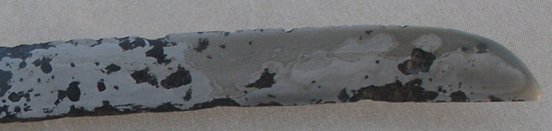

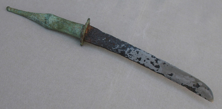

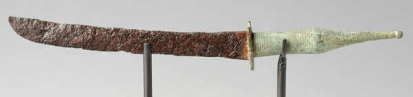

As for pamor, pattern welding just does not seem to have caught on in most parts of continental southeast Asia. Laminated (sanmei) is fairly common, though, both sandwiched steel and inserted edge. I have come across a literature reference to an interesting "jacketing" method used in Burma around the turn of the 20th century. An iron blade core would be headed, and a thin sheet of steel hammered over and welded to it. The jacket could be renewed periodically as it wore out.
I have a small dha (the blade is about 6 inches long) that is possibly from Cambodia (though I am not 100% certain). It is rather corroded from having been in the ground, but was polished and etched on one side just before I bought it. It either shows very complex lamination, or perhaps is the result on a few "rejacketing" cycles.

A nice dah and the pattern looks very interesting. The bronze handle is quite nice too, is the handle/guard cast in one piece?

Nice forging and Dha interpretation In deed, old blades do use fold steel. In the old day,though ,forge folding do not show any pattern, its main purpose are slag reduction and surface carburizing. I just finish electroclean a blade which has a sign of fold steel. Will post a pic in our previous fold steel thread.
Typical Dha blades do not have prominent ricasso. Their tang 's forced into the ferrule-encased hilt. I do like the integral ricasso like this as long as the integral part 's not so heavy that its balance point move too much backward. A little bigger (thicker and longer) ricasso would be nice for its appearance could be similar to typical ferrule (Dama pattern is a plus ).
Traditional Dha 's flat or slightly convex ground with little or no bevel. Your one looks fine (with a bit westernized feel ).
It would be nice to have the hilt upward (Lanna style) or downward (Burman style). A hardwood hilt on this kind of blade usually has (profiled) round butt rather than Tanto style cut-off butt . You can also visit Mark's page and study his sample. He has a superb collection of Burman knives and Dha(s).

Though now fused by oxidation, the grip and guard originally were separate.
