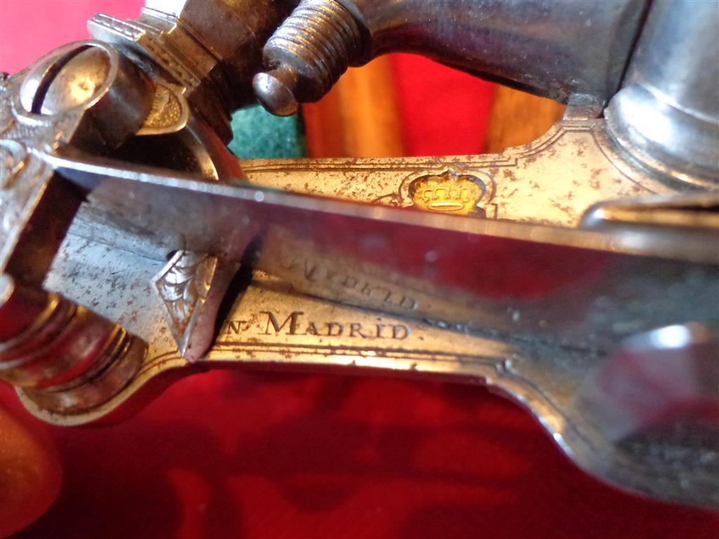

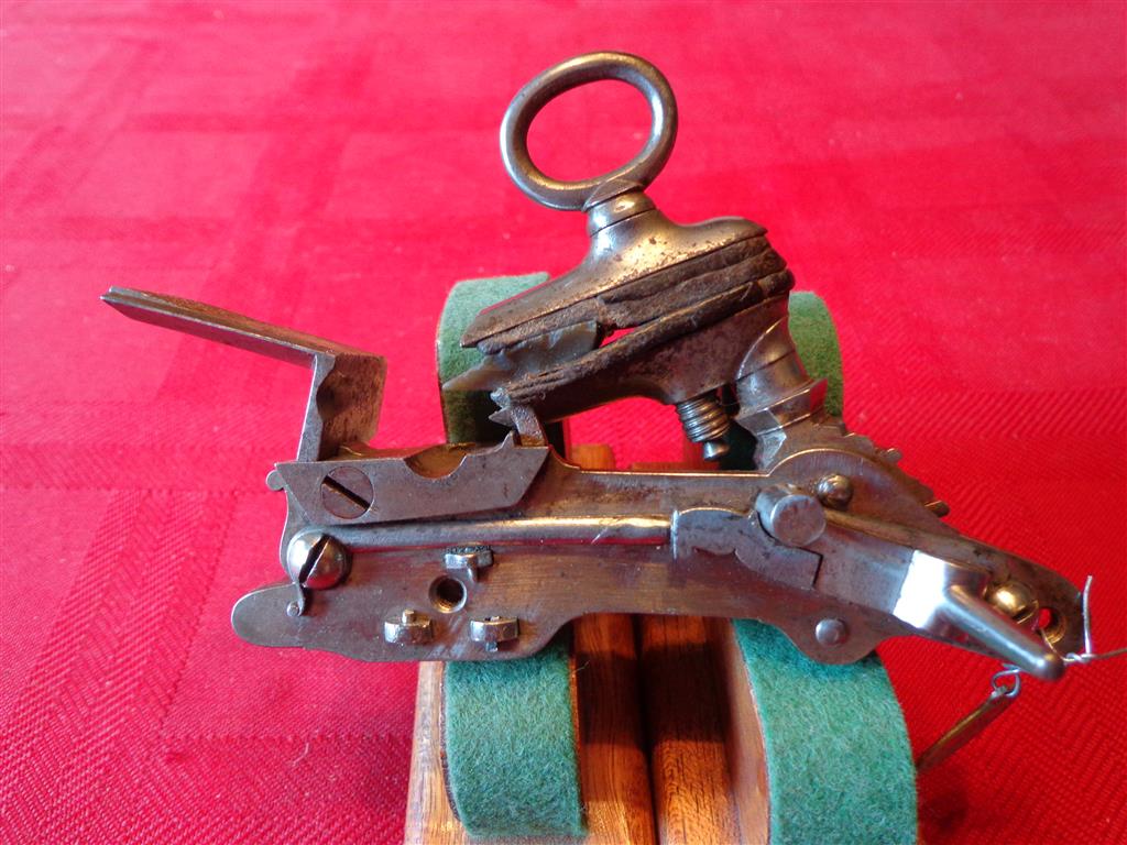

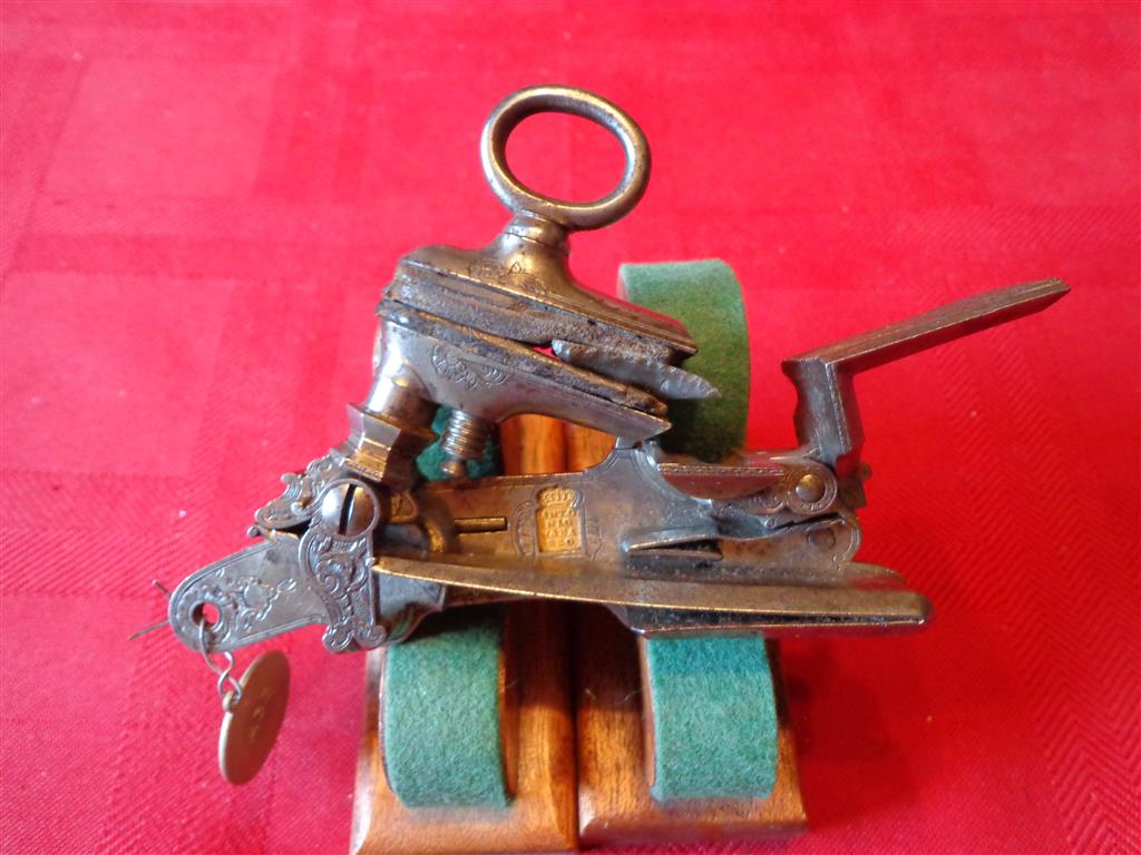

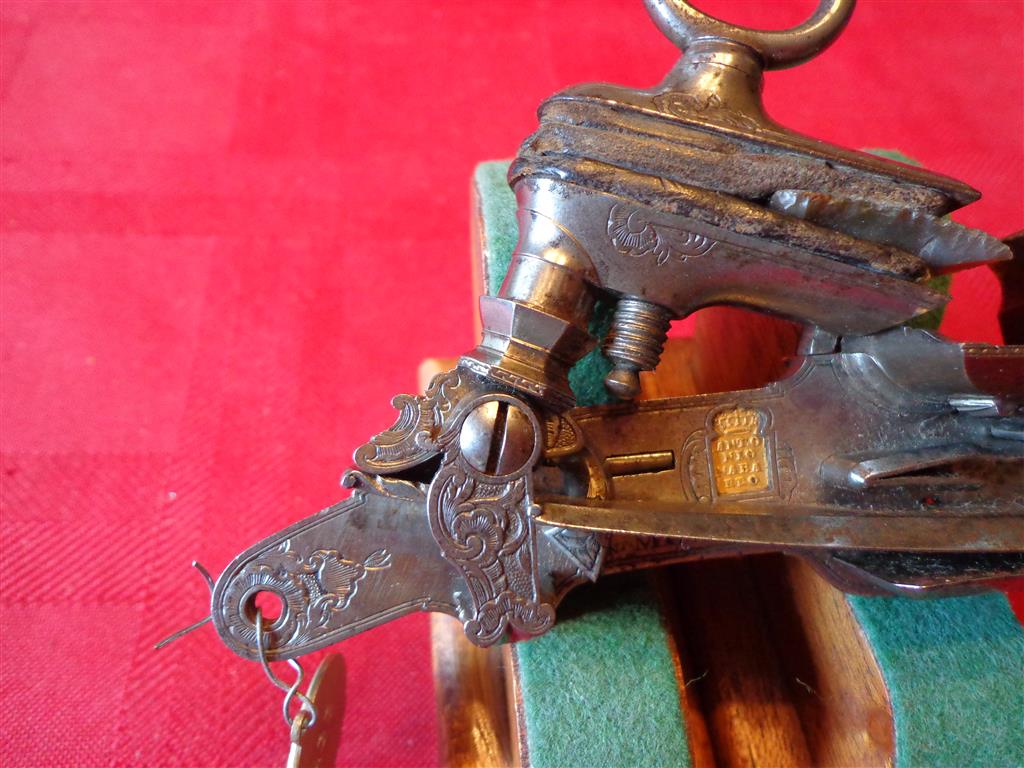

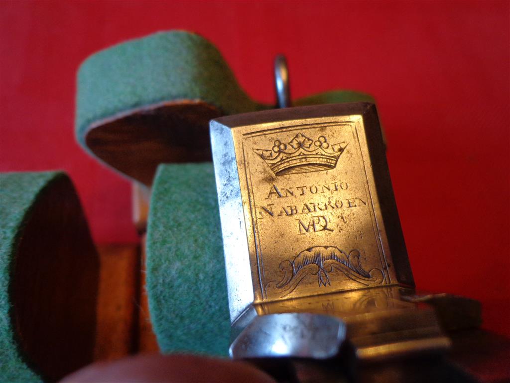

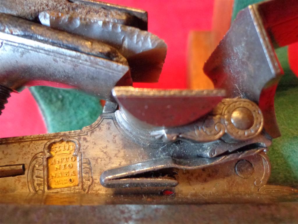

Hello again.

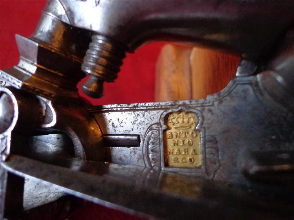

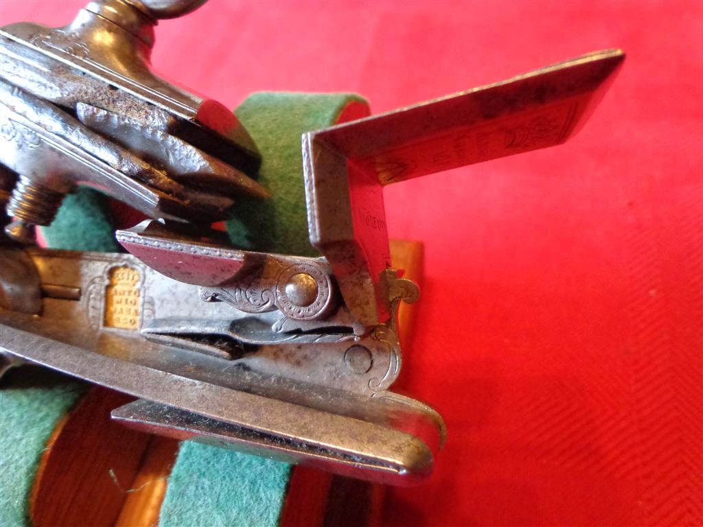

Here is another lock to add to my collection. Nice, large lock for an 18th Century Spanish fowler. Here is the original auction description:
The lockplate engraved along the edges with floral decoration, a gold-inlaid crowned maker's mark "ANTONIO NAVARRO", and marked "EN MADRID" under the cock spring. The cock moderately decorated, the rear of the frizzen with repeated signature and marked "1779". A well maintained lock with intact mechanics. Length of lock plate 12.2 cm. Provenance: Christie's London, The W. Keith Neal Collection.
A visual inspection shows the auction description to be accurate. The lock is very well made and functions flawlessly, and shows very little usage. The decoration is done well but not over-done. Very happy with this one. Comments appreciated, and thanks for looking.

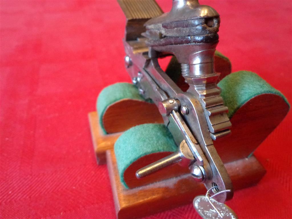

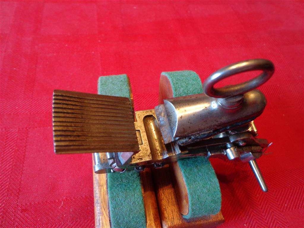

MORE PICS.......

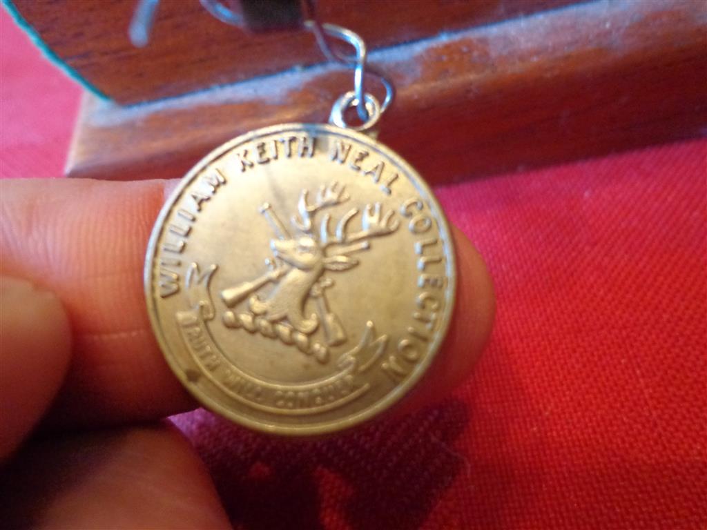

Beautiful lock, congratulations. Impressive provenance as well.
W. Keith Neal was one of the best antique gun collectors of the 20th century:
https://en.wikipedia.org/wiki/William_Keith_Neal
Old 26th July 2020, 07:39 PM   #4
Great lock, great lock smith ... and great ex-owner.
Congratulations, Rick .

Provenance: W Keith Neal is the author of Spanish Guns and Pistols (1955), a pioneering reference on the subject in English and unsurpassed until James D Lavin's A History of Spanish Firearms a decade later.
The maker: Antonio Navarro (Nabarro in the spelling of the era) flourished in the 1790s and started out as a student of court gunsmith Miguel de Zegarra. On barrels, his countermark is a sailing ship, below the punzón seen on the plate of your lock
The lock: very good design and craftsmanship, worthy of Navarro's status on the short list of esteemed Madrid gunsmiths compiled by Isidro Soler, who along with Nicolás Bis who had quasi-legendary status in the trade.
What I find distinctive about your lock is the shape of the plate, specifically its "tail". Downward-canted and with a rounded terminus. This shape is typical on patilla locks of this type seen on Portuguese guns; it seems to be a stylistic carry-over from the the lockplates of an earlier type of flint mechanism originating in that country, called fecho de molinhas. Compare with the forms of "tail" encountered on Spanish-made locks -- straight with rounded end, or pointed in the French style are the most common (German versions of miquelet locks often have squared off tails; the lock had something of a following among sportsmen there at the turn of the 18th cent.)
Perhaps this lock was made with the Portuguese market in mind. The profile of the cock with its long tapering jaws is also consistent with Lusitanian taste of the time, when prevailing Spanish (and Neapolitan) style tended to shorter jaws.

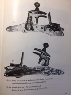

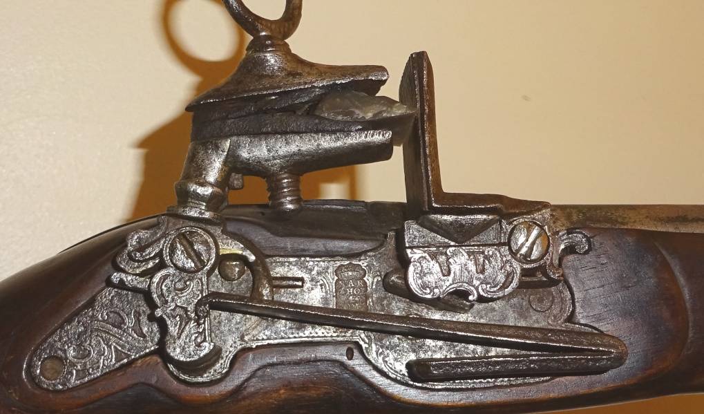

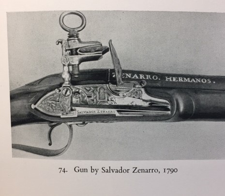

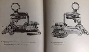

Yes, I did notice that. But I attach two images of this feature on separate locks, one Spanish, the other Portuguese. The Spanish gun is by Salvador Zenarro, 1790 (image from W K Neal, op cit plate 74. Note that the lockplate has a strong French influence on its shape, its tail is in line with the rest of the profile and does not point downward as on Rick's example.
The image with exterior and interior views is of a lock by a Portuguese gunsmith, dated 1780, from R Daehnhardt's translation and annotation of Espingarda Perfeyta , figs. 29, 30. Same arrangement the calzo de seguranza engaging the crook of the cock's foot, as above. But this lockplate has the downward angled tail as on Rick's lock.
The point I am trying to make is that the same mechanical setup can be accomplished using lockplates of quite different form. These examples should demonstrate that there is no functional connection between lockplate shape and the use of this sear particular arrangement.
Forum readers may be interested in an excerpt from Lavin's History of Spanish Firearms (1965) concerning this mechanical variation (p 164, fig. 17):
"An infrequent variation of this system was that in which the half-cock sear was mounted behind, rather than below, the full-cock. In this position, it encountered not the foot of the cock, but the curve of its arm... This construction seems to have been confined mainly to the eighteenth century."
As an additional note, I would like to point out that use of this sear arrangement persisted in Portugal until the ultimate demise of the flintlock patilla by the end of the first third of the 19th century, this late production exemplified by an exceptional signed and dated example sold at a major auction last year, which I may comment on in a separate post. As a NB, the Portuguese term for this lock is fecho de patilha de invenção.

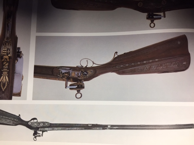

Here are images of a beautiful Portuguese gun made by court gunsmith José Malaquias da Costa in Lisbon in 1820, formerly in the Clay Bedford Collection, published by Wallace Gusler and James Lavin in their book, Decorated Firearms 1540-1870, (Williamsburg 1977) from which the photo came, the gun sold at auction in the US last summer but I'll withhold name of venue without Moderators approval.
The lock has the long slender jaws and downward-canted tail of Rick's piece, it's a gorgeous thing with a large anti-friction roller on the mainspring (seen on many higher-grade guns from Lisbon as well as Eibar (Spain). Notice that the upper contour of the lockplate tail closely matches the downward cant of the top of the gunstock's wrist. A straight tail, or a French-style plate as on the Zenarro gun posted previously, would not harmonize so well with the stock's wrist orientation.
Mr Lavin, in the writeup of this gun in the book, has this to say about the stock:
"The general form of this gun conforms closely to that of mid-eighteenth-century Portuguese arms, while the decorative details are quite modern. Typical of the former is the straight tang [of the barrel, addition mine] with its surrounding areas well above the level of the small. This results in a boxiness of the lock mortise accentuating the thinness of the wrist that contrasts with the broad "Spanish" buttstock."
By "small", the author is referring to the wrist of the stock (area behind the lock and trigger).
Based on this, it would appear reasonable to point out the Portuguese manner of gunstock design, as opposed to the position of half-cock and full-cock sear studs, as a functional basis for the lockplate profile under discussion.

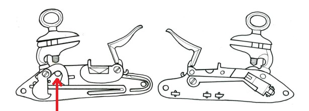

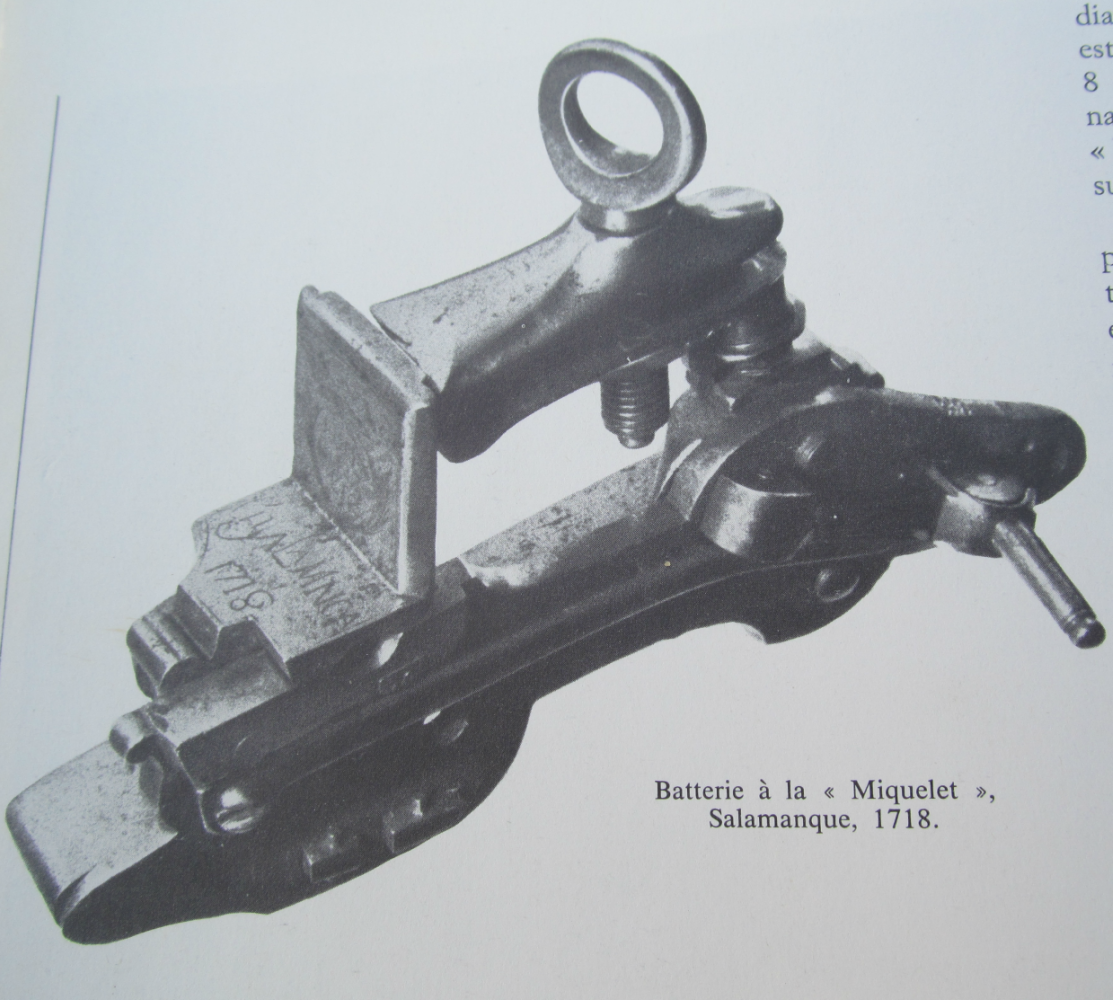

Finally, when I said that the shape of the plate is down, it is determined because it takes less place when making the wooden frame, and then, the firing mechanism is horizontal, but slightly inclined. This makes the safety or half mount c act l on the curve of the p a t i l l a.
Attached is the image of a lock produced in Salamanca, in 1718, a drawing by Calvo of the lock of a Spanish pistol, and a Portuguese lock.
Affectionately
Old 27th July 2020, 11:00 PM   #13
Fernando K
Join Date: Apr 2010
Posts: 672
Salamanca, 1718
