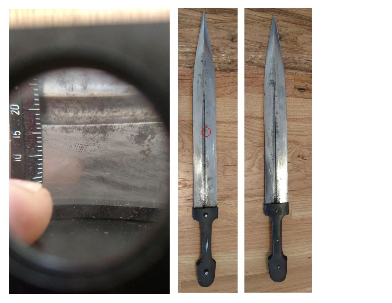

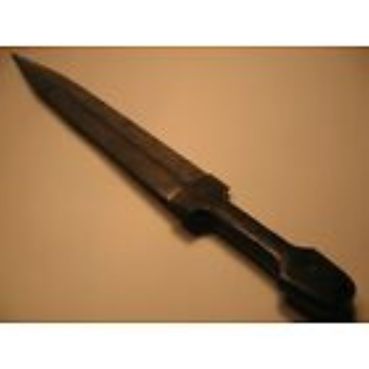

In December 2019 I had a question about a kindjal. http://www.vikingsword.com/vb/showthread.php?t=25463. The answers were inconclusive, but it was a great learning experience. I am sure in time I will find what I was looking for. Thanks to everyone for their help. Ariel in post #8 wrote, "Also, Caucasian often used a technique of differential tempering, deliberately hardening edges and leaving the body soft. Kind of like nihonto. This can be seen after a good polish, and definitely after acid etching." Honestly I hadn't considered the possibility of a differential temper. The idea knocked around in the back of my head for a few months then Covid happened and as I work in tourism I have had a bit of time on my hands. I knew a good deal about polishing from working in my grandad's gun shop as a kid (that doubled as a knife shop for the grandkids. I ground and tempered my first blades at 12), but I never did the bluing, other than touch-ups with cold blue and acid etches I knew about in theory but we had never used them. So I studied up. There is a huge amount of information hidden in this forum and the keris warung kopi forum. I did some test etches with lime, vinegar, and coffee respectively on a few blades to see what would happen. The coffee technique I'm still working on. I polished the kindjal to 2000 grit using the method Jim Hrisoulas laid out in his chapter on Japanese Heat-treating and Polishing in his first book with the variation of a 4 /12" x 8" bench mounted sanding block for efficiency and safety. The blade was finished using three vinegar etches from the same chapter. The blade was polished using cerium oxide following each etch. Before each etching bath the blade was washed with soap and water, dried, and then cleaned with acetone. I found if I kept the vinegar moving by brushing the surface with a clean tooth brush I got a more even coloration. After each etch I neutralized the acid with a baking soda slurry. The slurry darkened the blade considerably. Sorry for the long winded introduction here are the results, followed by a question. The pictures begin with a sellers picture of the before condition. I wish I had taken my own, lesson learned. Then an intermediate picture from December. Next are two full length views of the finished product showing the differential temper, Ariel was right. Finally are two detail pictures of the blade.
Opps. The intermediate picture (its a horizontal view) seems to be the next to last in order proceeded by a vertical finished view. Sorry for the confusion with the pictures. I guess the order can't be controlled after all.
Last edited by Interested Party; 28th May 2020 at 05:58 PM. Reason: clairification

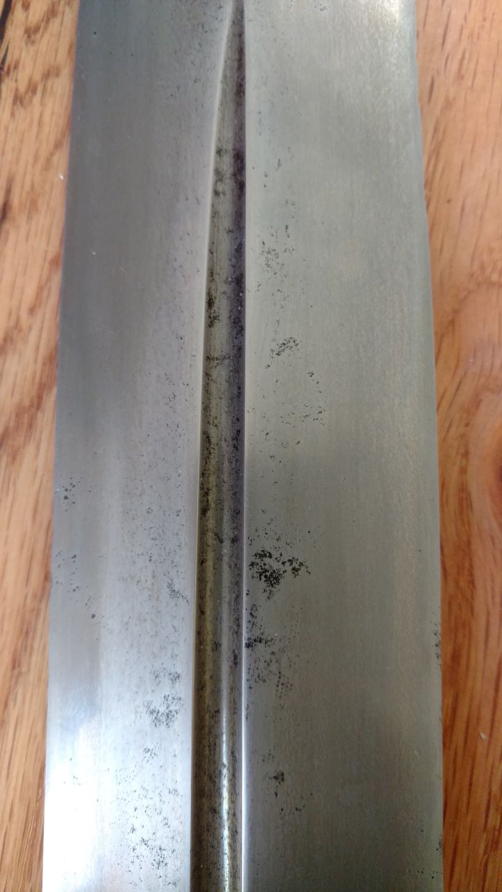

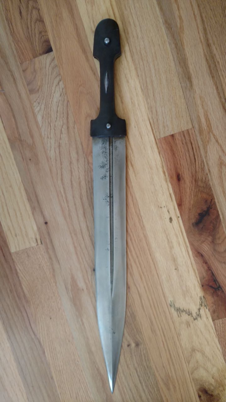

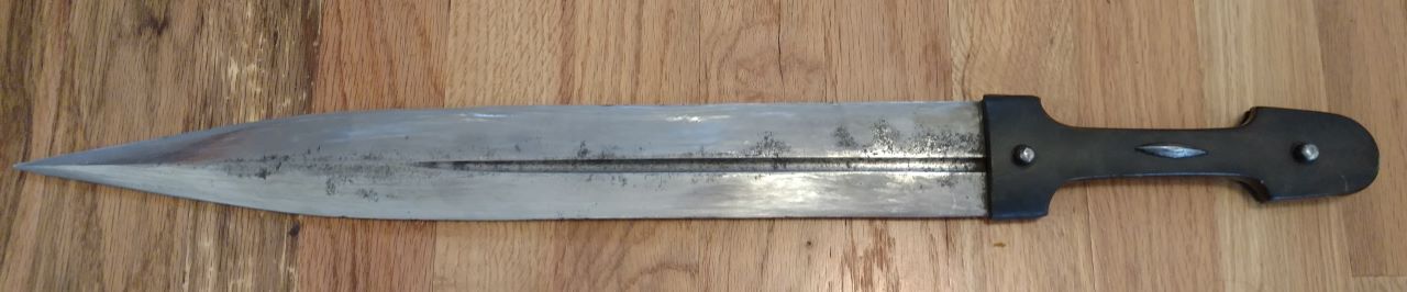

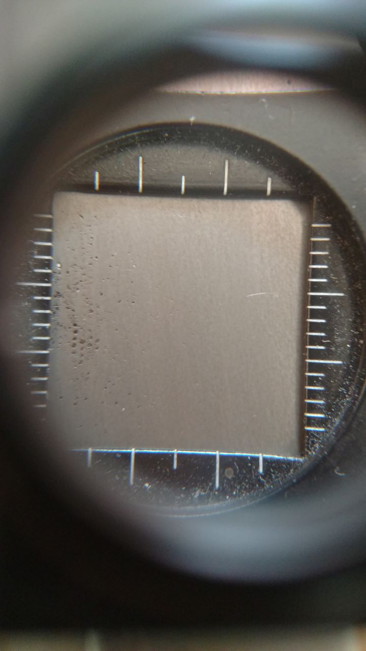

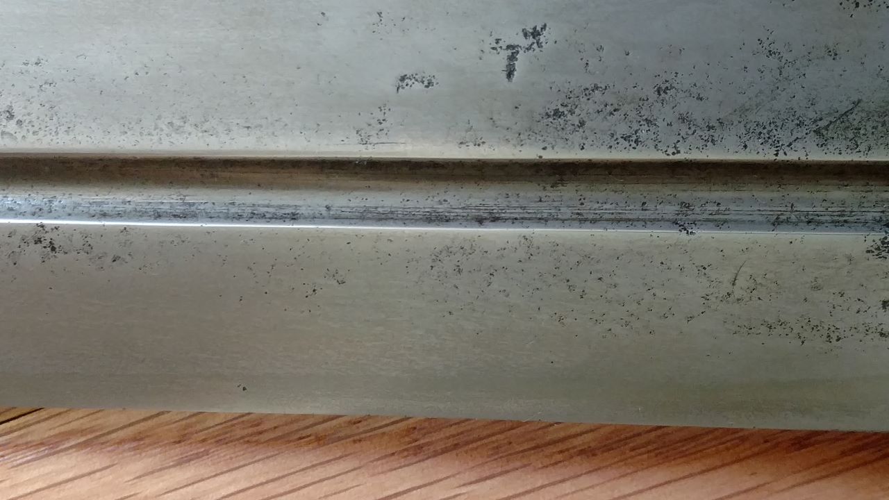

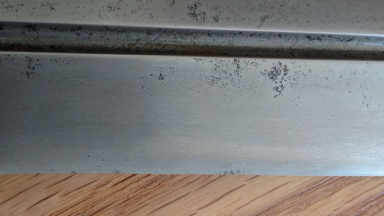

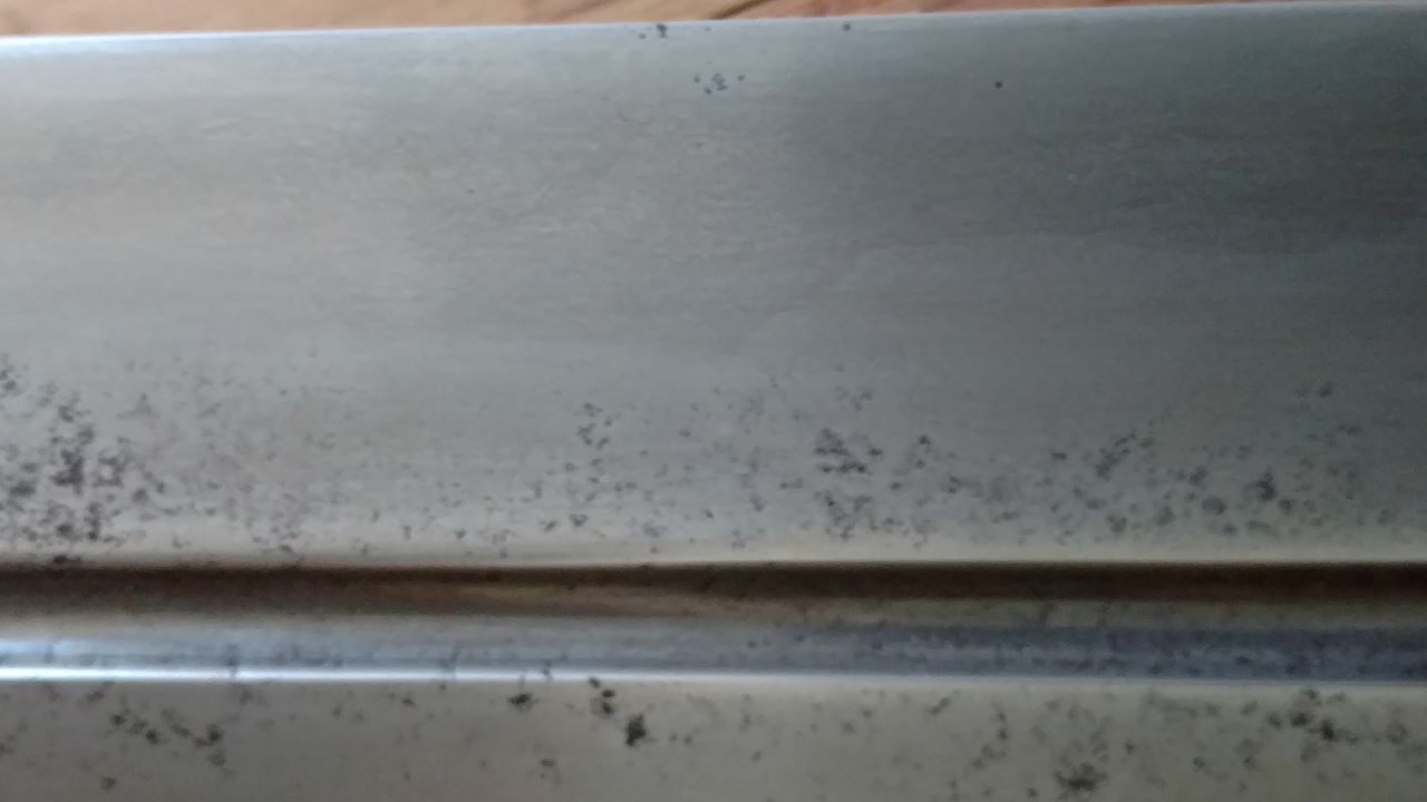

These pictures begin with a December photo of the first clean up then 3 details of the same area after the etching process. The magnification is 10x.
Now the question. Does anyone else see pattern in the blade? Is this watering or did I make a mistake in the degreasing of the blade. I did in some of the test runs I wrote about in the previous post which is why I was very meticulous in the preparation for final vinegar baths. Is the pattern shown a flaw in my technique, a "wild" mechanical damascus, or something else?
A subsequent question is if this isn't a flaw in my technique should I try a stronger etchant? Natal? I have a friend who is a local chemistry teacher, so I should be able to produce it. My main worries are about its possible volatility in storage as it gets quite hot here in summer over 105f (40C).

Could be vice jaws marks (seems regular ...)... Actually, it would be nice to etch it with ferrochloric acid, it seems to have a nice blade structure.

Vice jaws, that's a good hypothesis. Those regular marks were the subject of the thread linked above. They also coincided with minute traces of gold visible under magnification before cleaning and to the places that encrustation, to use Miller's terminology, would have traditionally occurred. I left the bigger, visible, traces on the tang.
What I was specifically asking the group about in this thread is the structure. Is it created by a flaw in my cleaning process, a naturally occurring dendritic formation, a wild mechanical damascus, or even a sham pattern?
I have read that ferric chloride is messy and its hard to control corrosion on the freshly etched surface during cleaning. JBG have you had any problems with it?

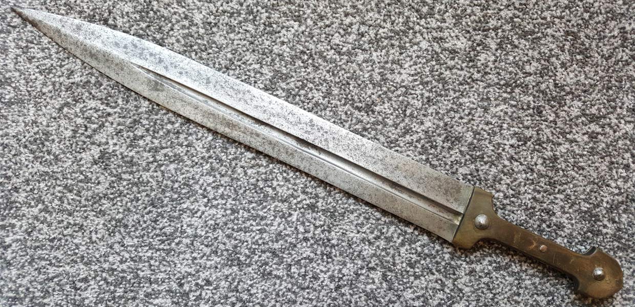

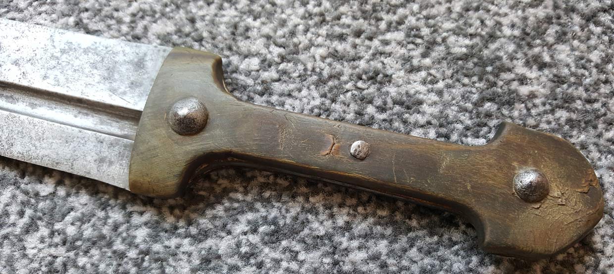

I happened to own a very similar piece and still have not made my mind up whether this is Circassian kindjal or Persian qama.
I would love to think this Caucasian kindjal but, unfortunately, there are no marks whatsoever to make such an assertion.
Any opinions are welcome.

From all I can see in the photos, the blade seems to have some watering structure like some 19th century wootz. Regarding the dotted markings, I also believe they are most likely from tightening the blade in a vice.
The shape of the blade looks like a Persian Qama but the shape of the hilt is more Caucasian. The example posted by Conduit has a more "Persian-looking" hilt.
However, let us remember that until 19th century much of the Caucasus area was part of Persia, so many times there is very difficult to distinguish between regions and styles in the area.
Also let us not forget that Qama and Kindjal are different names for the same weapon. More exactly, the very same weapon that is called "KINDJAL" in Russia and Daghestan, is called "QAMA" in Iran and Georgia.
For etching, Nital 4% is probably the best choice. It gives higher contrast than Ferric Chloride, is less messy (as it does not stain yellow everything that comes into contact with) and is less prone to rusting.
However, Ferric Chloride is not that bad and it can be successfully used instead of Nital. I used both.
