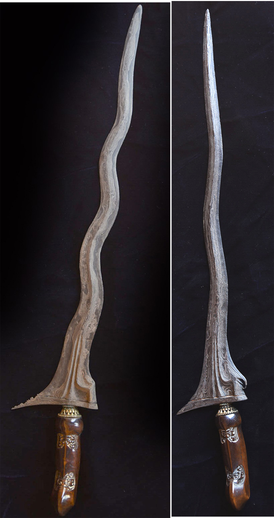

These 2 blades (in Djogjakarta dress) are coming my way. Pics from seller.
Attracted by the elegant blades and wonder what dapur we see.
It is a 7 luk and a 3 luk (usually called Jangkung). The last strech of the 7 luk is quite straight (I know this feature is present in a Megantara blade but there is no further similarity).
Pamor is standard Beras wutah of Ngulit semangka?
Hope anybody will enlight me.

layers pamor (from pic) seems Beras Wutah

5 luks and not 3? This dapur could be identified as Balebang according to the EK.

Yes you are right Jean ...also I see 5 luks.... but dapur is not Urap Urap?

Somehow it troubles me to count the faint luk.
Left is 7 luk (or 6 but then luk 7 is worn?).
Right one 3 luk?
Which is the Balebang then Jean?

Paul, i see a 7 luk keris on the left and a 5 luk keris on the right. A faint luk is still a luk and keris always have an odd number of luk even if time has worn its obvious completion away.

i tend to doubt that either of your keris are dhapur Balebang.

I agree with David. According to the EK there is a dapur Balebang type with 5 luks incuding a kembang kacang, lambe gajah, pejetan, tikel alis, twin sogokan, and sraweyan, but it is not mentioned in the books Dhapur and Keris Jawa. Both blades do not exactly meet any of the Surakarta standard dhapur types.

If I may contribute my two cents worth: in my unlearned and inexperienced opinion, my first impression of the keris in the middle photo is that the luk all have a certain "straightness and angularity"; there is no smoothly flowing, graceful curvature, to my eye. I haven't yet had a look at the ricikan, but if and/or when I do so, I suspect they will either confirm or not confirm a hypothesis I've formed about the "angular straightness" of the luk. Until then, it might be best not to "put my foot in it" any deeper than I already have, or to go out any further on an untried limb.

At my PC modem there is no 'middle' picture (we have had this discussion before). So you mean the 5 luk kris.
Luk kemba (so faint flowing) yes, but angular ?? I would not call 'm that way.

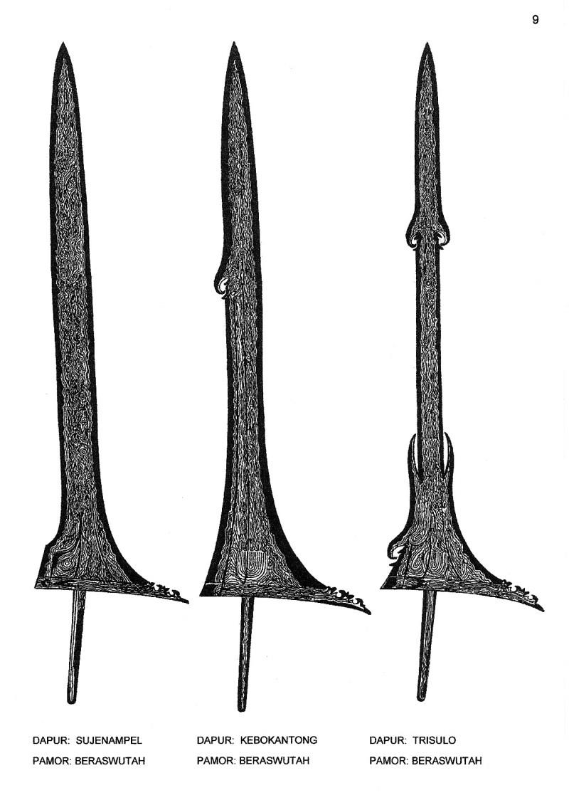

Mickey, the keris you describe that was sold as a Bali dhapur Balebang sounds a bit like Kebo Giri/Mahesa Kanthong. If so it is very much a dhapur that can be found in books and pakem. If this is not the dhapur then perhaps you could post some photos and maybe someone here could help you identify it.
BTW, i too would be skeptical of anyone claiming that a keris they were selling was once owned by "a senior abdi dalem of the Solokarta Court", mostly because there is no court i know of called "Solokarta". It is either "Surakarta" or "Solo".
See the dhapur in the middle of this illustration. It might match your mystery dhapur.
