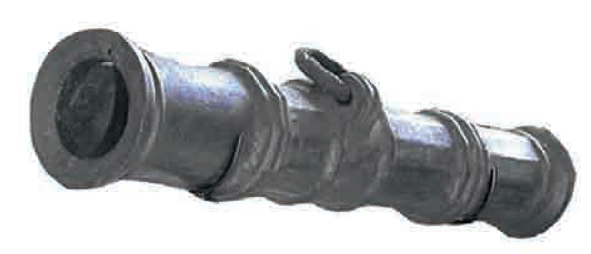

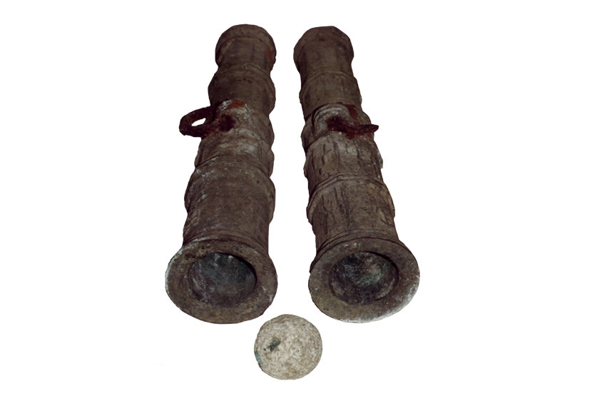

In 1999, during the archaeological investigations, carried out inside the Orheiul Vechi citadel, two pieces of artillery were discovered during the reign of Stephen the Great - unique objects for Central and South-East Europe: for the Republic of Moldova it represents the oldest pieces of fire artillery ever discovered (Sheet no. 1, 2). These bronze cannons were found in the soil filling of a destroyed dwelling (no. 52), in the southwest corner of the medieval citadel (Plate 4, 5). The cannons were in the central part of the destroyed complex, at a depth of 1.80 m, in a layer of soil and ash. The artillery pieces were placed at the same level, with the adjacent rings, being oriented with the mouth to the east. Inside a cannon, a stone peg was discovered.
Bronze cannon, Orheiul VechiTunul no.1 (Sheet no. 3/1) represents a piece made of bronze by the method of casting. The tube of the cannon is provided with a single hole in the front. The inside of the pipe represents a channel in the form of a threshold, towards the mouth being wider and allowing the placement of the window, and towards a narrower bottom, favoring the loading of dust. Loads of dust and spoons were made through the mouth of the cannon. The surface of the cannon is embossed, which is, in our opinion, due to the imitation by the founders of the body of the cannons made of flat iron rods and fastened with rings.
On the surface of the cannon, in the region of the mouth, is represented a coat of arms, made up of a shield on the surface of which there is a heraldic emblem highlighted. The shield is rectangular, with a sharp base. The heraldic sign has the form of an anchor, provided with two bars at the top (which form a kind of "roof" of the "anchor") and two bars in the field on the left.
Dimensions of the cannon: length - 62.8 cm, diameter of the mouth of the cannon on the outside - 13.5 cm, diameter of the cannon in the middle - 10.5 cm, outer diameter of the pipe on the sole - 11.15 cm, size of the cannon (diameter of the mouth) - 8.0 cm, diameter of the combustion chamber - 4.0 cm. The thickness of the walls: in the placement room of the window - 1.40-2.25 cm, and in the combustion chamber - 3.20 cm; bottom thickness - 3.70 cm. Cannon weight - 26.60 kg.
In the central part, the cannon is provided with a special ear, in which an iron ring is attached. The diameter of the ring is 8.0 cm, and the thickness - 1.30 cm.
The hole for the ignition of the dust is at the bottom of the cannon, within a quadrilateral sector, specially arranged, with the raised edges. The dimensions of the quadrilateral sector - 2.0x1.8 cm, the diameter of the hole - 0.4 cm. By its form, the cannon is specific to the years 1460-1480.

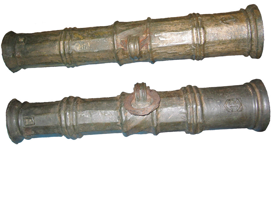

Bronze cannon, Orheiul VechiTunul no.2 (Plate 3/2) in material and shape, this cannon is analogous to cannon no.1. It was made of bronze, using the casting method. Compared to the cannon no.1, it is worked in an archaic manner, it has a coarser surface, worked negligently, with a heraldic sign analogous to the coat of arms of the previous cannon, but executed in a non-skillful way. Unlike the first, the second gun, has the embossed surface in sector two. Inside the cannon there was kept a gill of limestone, with traces of bronze oxide. The spiral has a circular shape, with a diameter of 7.5 cm.
On the surface of the cannon, near the mouth, is printed a relief sign, similar to the shape of the sign in the central part of the first cannon. Unlike the first, on the surface of the second cannon the shield is missing, and the represented sign retains the same shape: anchor with roof and two side bars on the left.
Dimensions of the cannon: length - 62.25 cm, diameter of the mouth of the cannon on the outside - 13.7 cm, diameter of the mouth of the cannon in the middle - 11.0 cm, outer diameter of the pipe on the sole - 9.80 cm, size of the cannon (diameter of the mouth) - 7.5 cm, diameter of the combustion chamber of dust - 4.5 cm, thickness of the walls: in the placement room of the shell - 1.30-1.70 cm, and in the combustion chamber - 3.0 cm, the thickness of the bottom –1.70-2.40 cm. Cannon weight - 31.05 kg.
In the central part; the cannon is provided with a special ear, in which an iron ring is attached. The diameter of the ring is 8.0 cm and the thickness in section - 1.30 cm.
The hole for the ignition of the dust is at the bottom of the cannon, within a quadrilateral sector, specially arranged with the raised edges. Dimensions of the quadrilateral sector - 1.8x1.8 cm, hole diameter - 0.4 cm.

Currently in the Historical museum in Chişinǎu, Moldavia.
