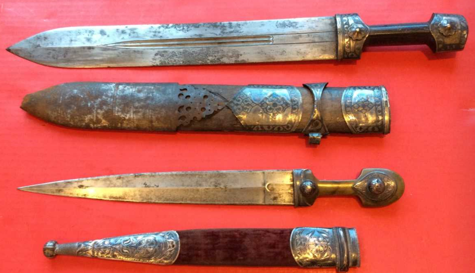

But here the differences start:
The upper one: Gurian kindlal is massive, wide, and has pretty rounded tip. Its blade is hollow-ground. It is a slashing weapon.
The lower one, Megrelian is rather small, narrow, having a very sharp tip, flat panel at the ricasso and a central rib for strengthening the blade : a stabber.
These features imply major differences in their actual use.
Their decorations are also very different: Gurian has scabbard with monstrous iron chapee and square pommel; Megrelian has elegant silver decorations.
These differences were preserved for as long as we know these weapons; these are firm tradition peculiar to the same people occupying the area size of Long Island.

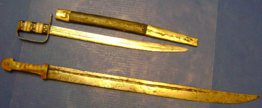

"In that part of the world wars were an uninterrupted chain of events. Weapons were consumed rapidly, and there was no sufficient capacity to renew their supply. People had to rely on "re-purposing" broken parts, blades in particular.
The upper one is Khevsurian Dashna. Pay attention to the blade: typical Khevsurian low quality job, and pretty old and worn to boot. The word "dashna" was mentioned in the Georgian dictionary of Sulhan Saba Orbeliani in the 17th century.
Classical examples had kindjal-like handles and plenty of brass on the handle and the scabbard.
The one I show is a much later example, mid 20 century: D-guard, handle materials.
Believe it or not, those were in active use even then, despite all the restrictions imposed by the Soviet regime. Khevsurs never paid much attention to any government:-)
The second one ( quaddara-like) is even more interesting.
I got information about it from Vakhtang Kiziria, a Georgian researcher, who wrote several articles about these short improvised weapons.
He consulted with 2 more Georgian weapons researchers and...
This is a weapon that originated in Eastern Georgia, Kakheti, and is locally known as Sabarkali.They were known there since the end of the 18th century till ~ 1820 ( when the Russians came). After that , beginning ~1850 they penetrated to the neighboring Armenia and Azerbaijan, where they were called Quaddara and widely used in the religious ceremonies of Ashura. Azeris expanded its presence to Persia.
My example has a village-made Georgian palash blade of unexpectedly high quality: no caverns at all and in more than 20 years since I got it, I did not oil it even once, and there is not a trace of rust, just thin beautiful patina. Ian was astute: the fuller goes ~2.5 inches inside the handle, indicating that the current blade is just a remainder of a broken old one. Taking into account chronology of Sabarkali ( beginning of 19th century at the latest), the blade must be even older."

The first difference between the usages of the two qama/kindjals should be examined within the geography, as you have just mentioned. Generally, one would assume that the "peoples of the mountains" should carry larger weapons, and those on the coastal areas would have weapons of some more "regular" size. However, this is the very opposite when we consider Gurians and Megrelians. As far as I know, Guria was (nearly always) a part of the Ottoman Empire, or, the Georgian Kingdom, situated near the important trading centers of the Black Sea coast, and in close interaction with the local Greek population of Anatolia (Gurian kindjals are still being called as Greek Qamas in Anatolia). However, the Megrelians, especially after being pushed to the mountainous zone, had interaction with the tribes of the north-western Caucasus, mountain Circassians and Apkhazians. This would have effected the cultural process. Secondly, the "primary weapon" is an other issue. Guria was under permanent control of various centralized imperial powers, and was relatively a part of the "civilized" world. It is much more likely for them to have a single beast as a "daily" and "main" weapon, for it was probably not allowed - or not necessary - for any Gurian "commoner" to have other weapons of war, such as swords or fire ones. But I think this is not the case with the Megrelians, for they were in a relatively far geographical position to the central powers, and -through their interaction and/or quarrels with the independent tribes of the Caucasus- kindjal/qama was probably a secondary weapon for them in the "daily life": a stabbing instrument in the absence of the other ones. Is it not the case also for the Circassians? If the kindjal/qama was the primary weapon, so were are they? The archaeological record exhibit a series of war instruments from the northern part of the Caucasus, but kindjal or qama have a very little percentage among them.
This would lead us to the older kindjal/qama question, which rare people know or think over anymore: what is a "Shapsugh" kindjal, and what is the "Kabardian" one? We know nothing but the first one was broad and hefty, and the other one was narrow and elegant. But we also know that the Shapsugh live on the coastal areas, but the Kabardians inside.
Just wanted to share my mind , thanks again for the topic, waiting for more contributions.
BTW: Ariel, forgive me if I missed a point, but why do you think the second one is Megrelian, for I would bet it is a Circassian one, according to the decoration, of course, "as far as I can see"
kamachate is offline   Reply With Quote
Old 5th February 2020, 06:50 PM   #14
Yes, the motives of decoration are Circassian but this is expected: Meghrelians belonged to the Circassian “group” in the esthetic sense. Please see Rivkin’s book with multiple examples of it. The distinctive feature of Meghrelian blades is the flat panel at the base of it.
I see your point re. “ flatlanders” vs. “ mountaineers”. But at least 2 independent papers ( one by a Georgian arms researcher Vakhtang Kiziria, another by a Russian museum worker from the staff of the Hermitage museum, if I am nor mistaken) carefully discuss the ethical dimensions: slashing or cutting wounds were not life-threatening whereas a stabbing one was. The use of the latter was frowned upon in the majority of Caucasian traditions and was limited against animals but was used very grudgingly against humans and only in extreme circumstances ( mortal enemies, horse thieves etc.)
Why were Meghrelians so very liberal with stabbing ? I do not understand it and could not find any decent explanation.
