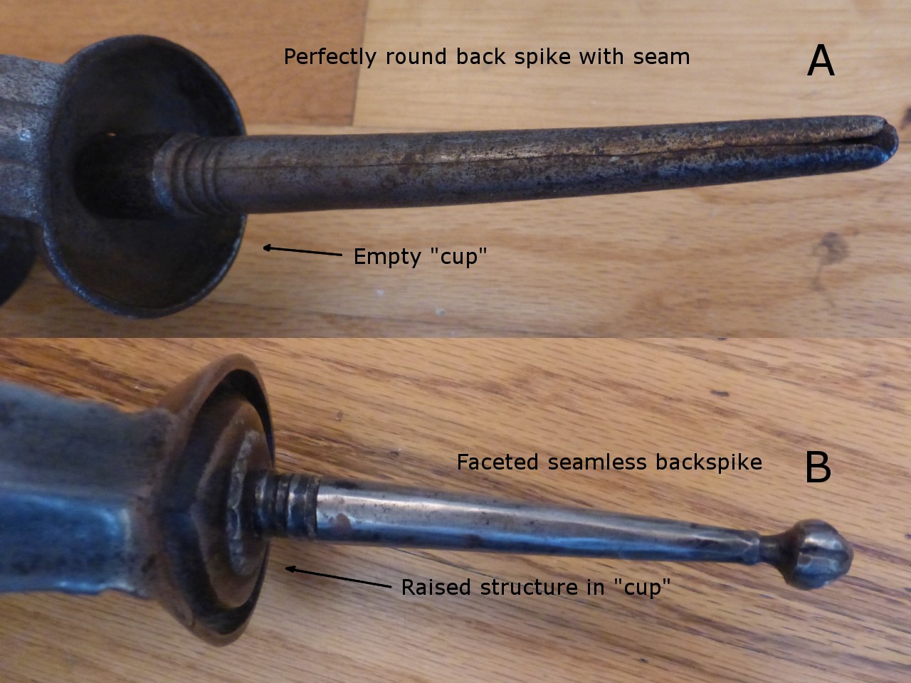

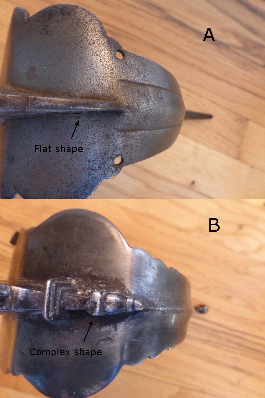

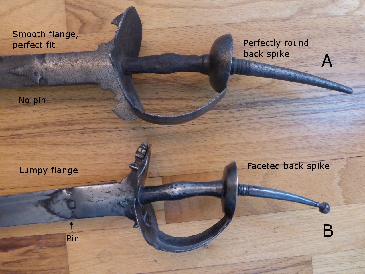

Here's a firanghi I've had for some time. I'm a little suspicious of its authenticity.
The features that give me pause:
The reinforcements that fit over the blade fit perfectly, as if they're made for each other, which isn't really how the whole "foreign-bladed" thing typically goes.
There's no pin going through the reinforcement and the blade. I can't imagine a swordsmith trusting their welds so much that they want to skip the pin.
The bottom of the hilt's "cup" is perfectly rounded, and also empty inside, unlike a typical firangi.
The backspike is very round, and I don't really like its seam, though I can't say exactly why those bother me.
It's Firanghi 'A' in the photos, alongside another that I'm reasonably confident about.
What do you think? Definitely modern? Anything else that gives it away?

Should I assume that I'm entirely correct that this is a fake, for exactly the reasons I mentioned?
Are there any other tell-tale signs I should be aware of in the future?

Others will weigh in here, but I think you have a late period example, rather than a "fake." They were a high status item and survived as "processional" pieces long after they were "battle field" weapons.

Well, according to Elgood (Rajput arms & armour, vol 1, p475) it could be contradictory: The plain one could be folder, as those with shorter spike and more complex crossbar are clearly marked as nineteent-century .
