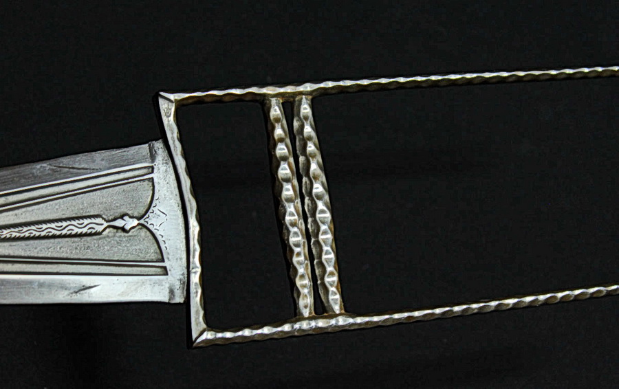

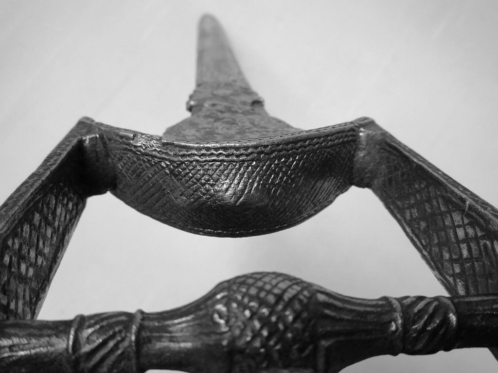

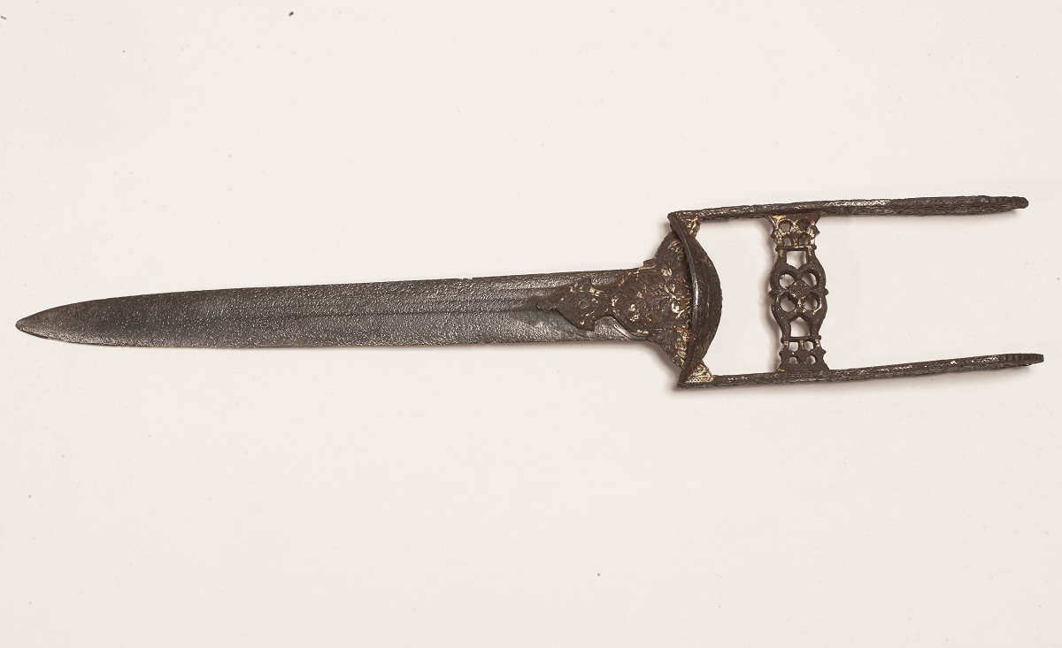

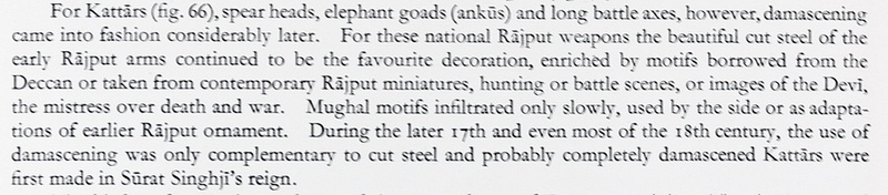

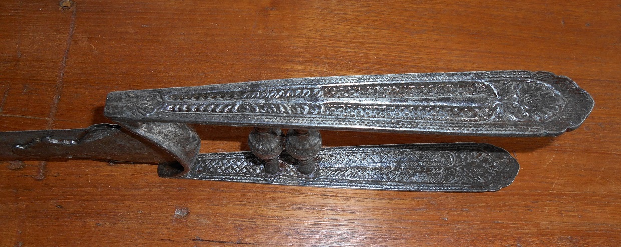

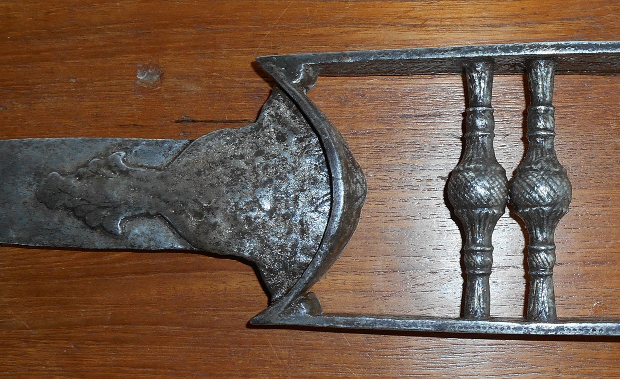

It s seldom writers comment on the decoration of the Indian weapons, but Hermann Goetz did in his book The Art and Architecture of Bikaner State, p. 125, 1950.
Cut steel decoration was far more popular than most think, and lasted quite long, before inlay and koftgari took over. Here is a quote from Goetz' book.
The katar shown is an example of cut steel decoration. In this case the katar is 17th century, but with a Bikaner dot inscription.
Surat Singhji (r. 1787-1828). Ji is a honorific suffix.
Old 28th October 2019, 01:46 AM   #2
It’s a high class one: reserved, elegant and beautiful. Unlike many overdecorated one, it has simple clean lines with limited decorations. And the wootz inner panels are perfect.For some reasons it looks to me like a ballet dancer.
I love it.
A question: I can understand the way S. Indian katars were assembled. But this one puzzles me: how was the blade securely attached to the handle? Was the lower horizontal piece of the handle originally en bloc with the blade?
Old 28th October 2019, 10:36 AM   #3
Jens Nordlunde
Jens Nordlunde's Avatar
Location: Europe
Posts: 2,718
Yes Ariel, the hilt base and the blade is one piece of steel, so the whole katar was made in one piece.
These steel cut pieces are fantastic, and when you think of the tools they had at the time it is even more fantastic.

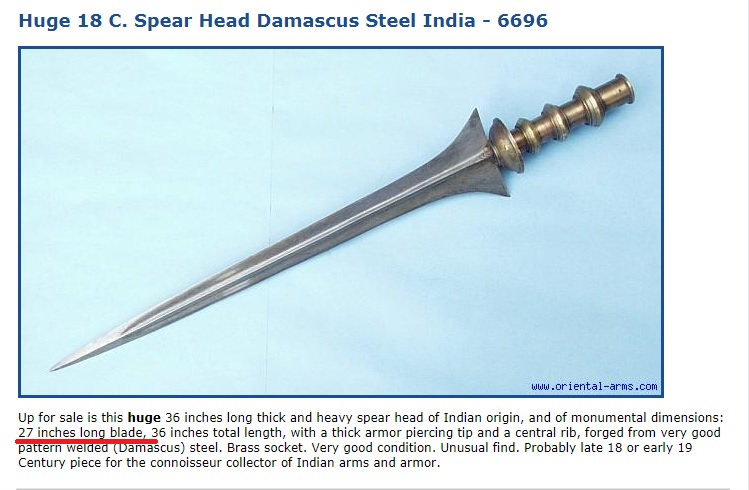

Old 28th October 2019, 11:40 AM   #4
Kubur
Kubur's Avatar

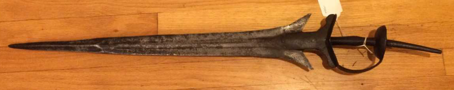

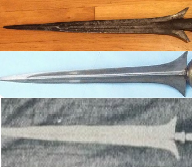

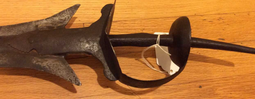

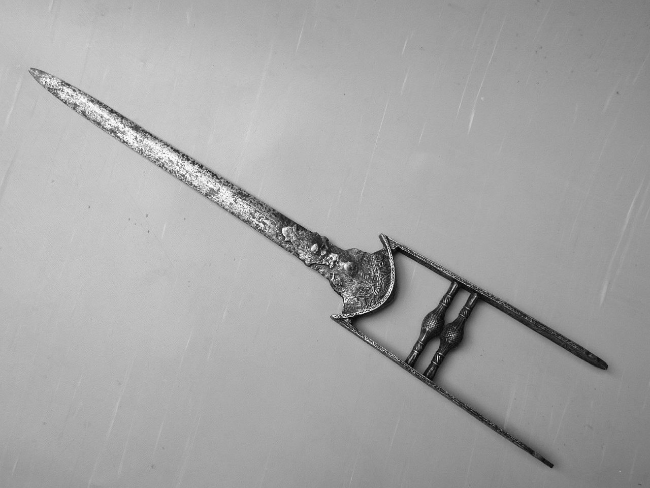

My katar has a blade carrier section with a rapier blade tip inserted and riveted. the carrier section was tabbed and inserted into corresponding square holes in the curved crossbar, they appear to have either been shrink fitted and peened or forge welded together. Very hard to see as it has cut steel decorations and cross hatching, but there appear to be 5 tabs you can make out, less noticeable in the photos tho.

Like you write soldering cant have been a very good solution, so some other method must have been used.
Kronckew, you have a nice south Indian katar, and maybe the south Indians, now and again, changed the blader of their katars - I dont know.

An attractive and quite interesting catter, kronkew! Looks like a recycled European blade, or the tip end thereof? Interesting that laminations are visible which are in keeping with pre-industrial manufacture.
Yup, I like it a lot, broken off tip of a euro blade I think. the carrier was a bit more decorative once, but is well worn and a bit pitted, but the blade is still tight and functional, wish it were a bit wider tho, can only hold it with 4 fingers.

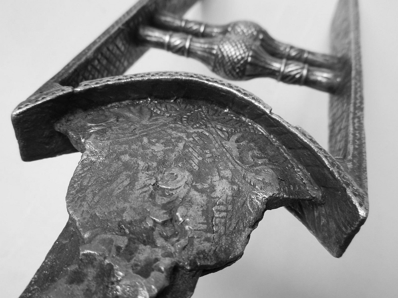

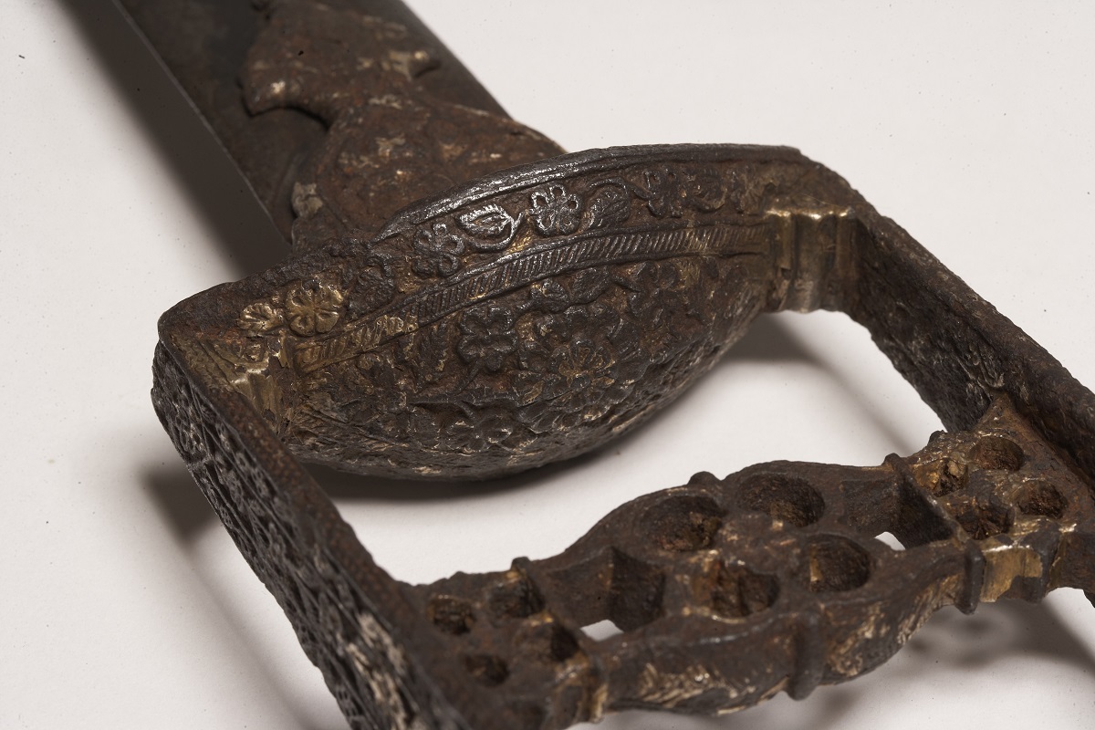

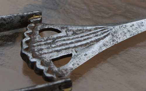

I have the little sister
And here is what i think... (who wants to be a millionaire)
All these katars had originaly 3 rivets but as you said the blade was not securely fitted. So the owners have to do some basic soldering to reinforce the thing.
Most of these katars have the same problem: disgusting and ugly soldering and it cannot be the armorer who did this lovely katar...

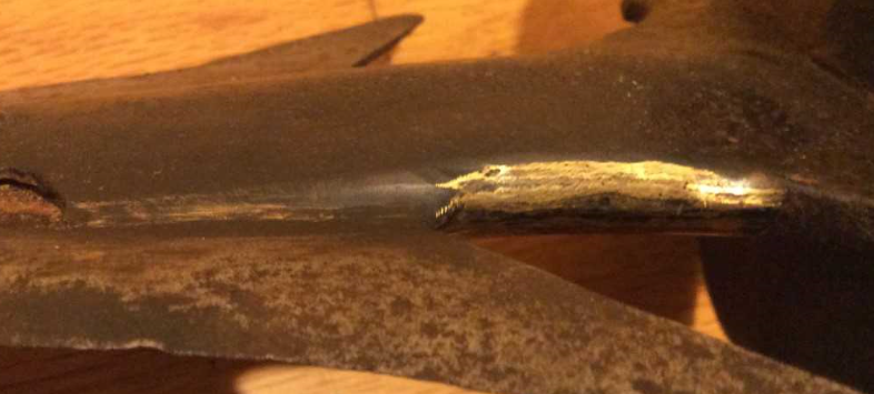

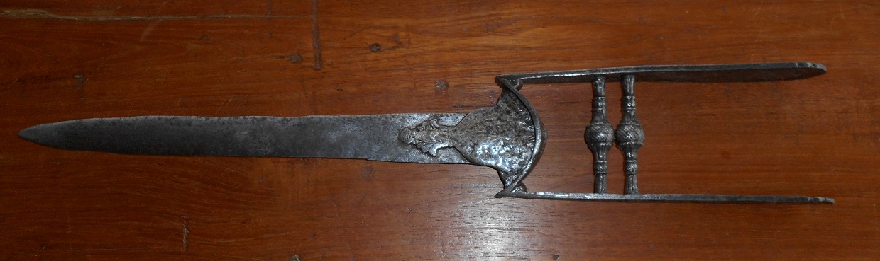

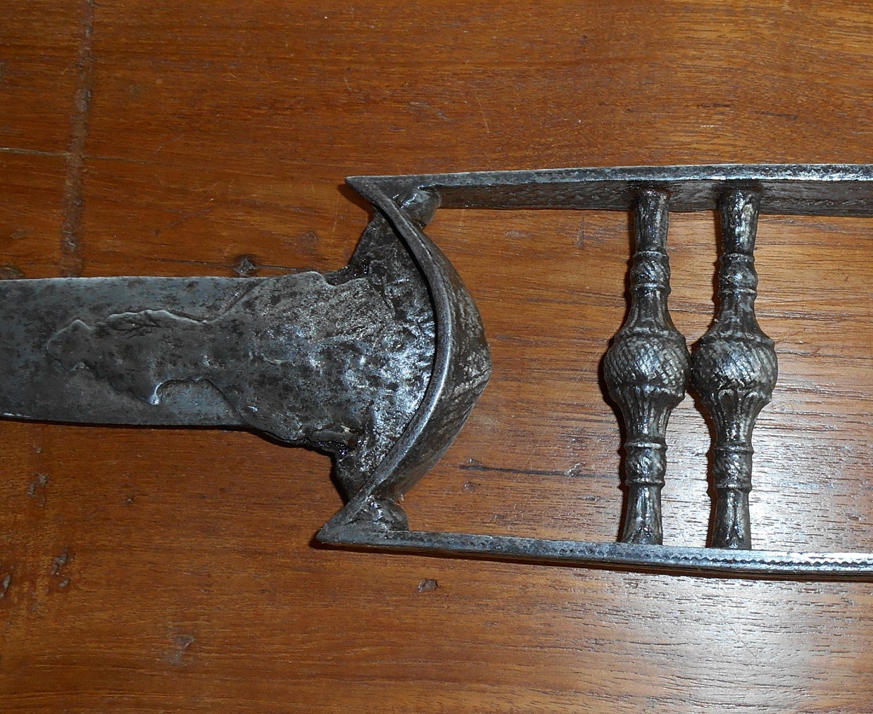

Just to add to the examples here, one of my katars appears to have had the blade taken off its original hilt and then brazed onto its current one. Also kind of surprised no ones mentioned copper soldering yet. I have a tulwar hilt that appears to have had liberal amounts of copper involved with its construction (most easily seen on the pommel disk - pic included), and actually the same katar that had its blade remounted also has its crossbars copper soldered to the sidebars. I might be remembering this incorrectly, but I'm pretty sure I've also seen a number of examples of bara jamdadus (hooded katars) that have the balls in the middle of the crossbars soldered together with copper.
Edit: Reuploaded the tulwar pic so the soldering is more visible.

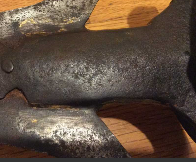

I have several Indian swords/daggers with riveted blades and the assemblage is very strong and reliable.
Earlier, I have mentioned a composite Indian sword I have: S. Indian blade of a very ancient pattern and a " newer" ( 16-19 cen.) pattern basket handle.
Here we are not talking about a repair of a weak assembly: this is an obvious case of a composite sword.
Blades of that construction had a very short tang and a very tight handle; there was very poor, if any, protection for the hand. Thus, it is not a miracle that the later owner decided to modernize the sword by attaching the blade to a solid basket handle. He retained riveting, but further strengthened the assembly with very extensive brazing. One can see large areas of brazing as well as smaller blisters of brass around the entire connection.
Also interesting, that although Western travelers repeatedly mentioned absence of stabbing function in the old swordplay arsenal of Indian warriors, this one has massive change of geometry of the tip of the blade ( ~ 8" long) resulting in a " zirah bouk" type tip. Old Indians did stab, a stabbed hard.
I am inviting your opinions re. potential dating of the components and the final product.

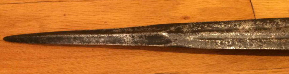

The blade is almost 27”; I have several Tulwar/pulwars with blades of such length and shorter.

Unfortunately, our desires and reality do not always coincide.
It was not by chance that I asked about the size of the blade ... If we look at the spear tip from the site of Artzi Yarom, which I posted in the subject, and read its description, we will see that the dimensions of the spear tip blade coincide perfectly with the blade of Ariel's "unique sword":
http://www.oriental-arms.com/item.php?id=246
"Old rivets" is a very serious argument. That is why I said that this "unique sword" could be assembled in the first half of the 20th century, and not the day before yesterday.
It’s not very correct to link to some books, but do not post illustrations from these books. Perhaps not everyone who reads this topic has the books of Rawson’s, Elgood, and Pant. And these people will not be able to find out that you are a little distorting reality. I have books that you have named. Unfortunately, in none of the books you have mentioned is there an Indian sword with a blade like that on your “unique sword”.
You can continue to fantasize about the "uniqueness" of your "sword". But you can once again analyze provided by information about spear heads from India and remember that in India dealers of antique weapons for the "white sahibs" have been selling "unique rarities" since the end of the 19th century.

This one, in comparison to many of them, looks eminently practical: it can stab easily and slash without problems. Moreover, switching fro the original " old Indian" handle to the " basket" one provided good hand protection. The length of the blade is entirely within the range of the " very practical" tulwars/pulwars. So, we just cannot exclude the possibility that it was created with a perfectly fighting purpose in mind. Or, if we are " criticisers", that it is a souvenir one. Go figure...
On top of that, many of the " non-practical" ones had hidden religious meanings that we just do not understand.
I honestly have no idea how old this one is: it can date from early 18th century or from the end of 19th. The unnerving thing is that we just do not have any objective parameters except for the physical conditions of the blade and the handle. Brazing could have been done at any time within this period. Handles were replaced left and right. Gut feelings can, and far too often are, deceptive and prejudiced one way or another.
Whether we like it or not, we have to accept it as it is.

Dear Ariel, I understand that it is very unpleasant to be disappointed in a item that you considered "rare" and "unique." But obviously, That this is a “unique” souvenir. May be he is combined the early 20th century, maybe even the late 19th century. Nevertheless, this a souvenir.
And do not try to come up for this souvenir "practicality" or "religious meaning". Otherwise, you can run to extremes and start looking for the "sacred" and "combat" meaning of the forks or spoons ... After all, we understand that a plug can be stuck in the eye and kill a person.
