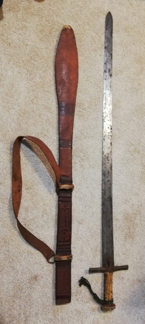

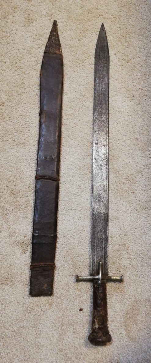

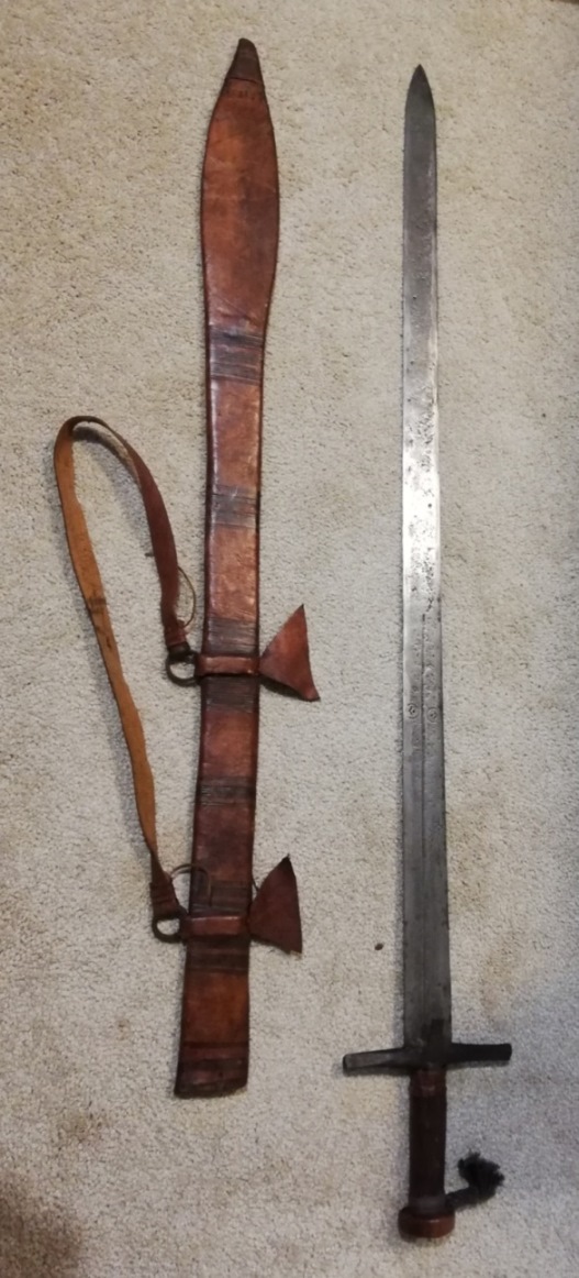

Hi all,
I have puddled around with the idea of collecting kaskara for a couple of years and since my interest has not diminished, I decided to purchase a third sword recently.
I'm under no illusions that these were produced by masters of the craft, but I like them so that's what matters.
I'm hoping the very knowledgeable base here may be able to assist me with some beginner questions:
- What is the best method of preserving the leather scabbards and crocodile skin used in construction?
- Are there any books dedicated to kaskara's? (I like to read)
- What should you look out for when collecting? (good or bad)
I like the indigenous blades and 'arsenal' quality kaskara just as much as the examples displaying fine craftsmanship. I'd like a diverse collection ultimately; whatever tickles me each time.

Your third sword is Thuluth decorated and with a characteristic cross-guard. Lots of info is available via Forum threads.
