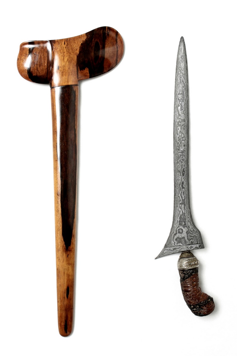

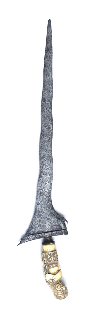

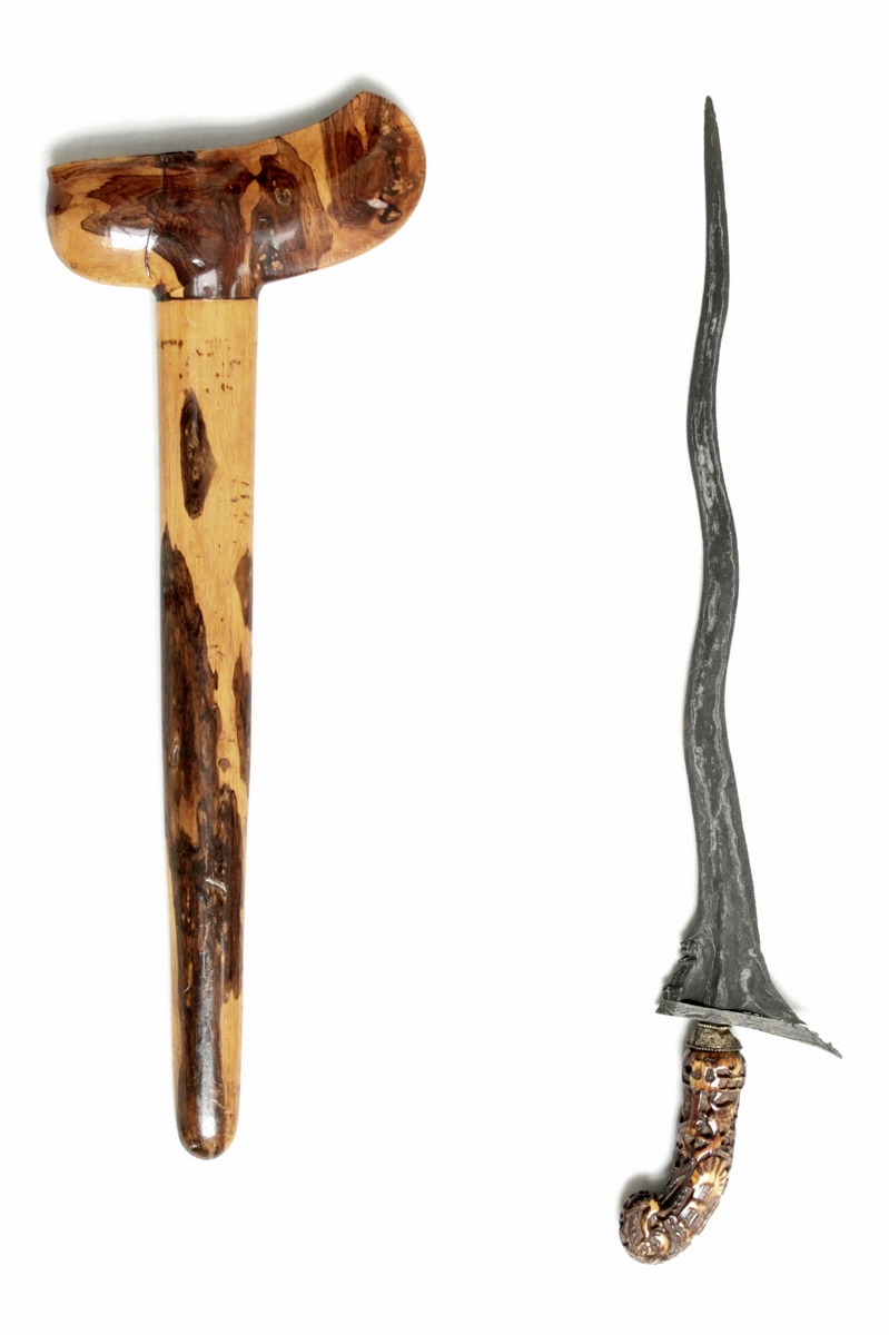

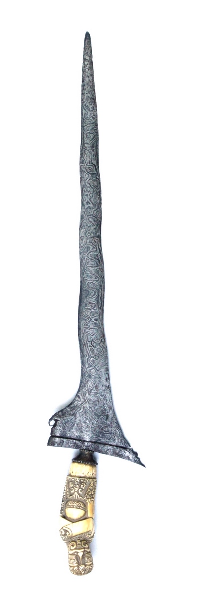

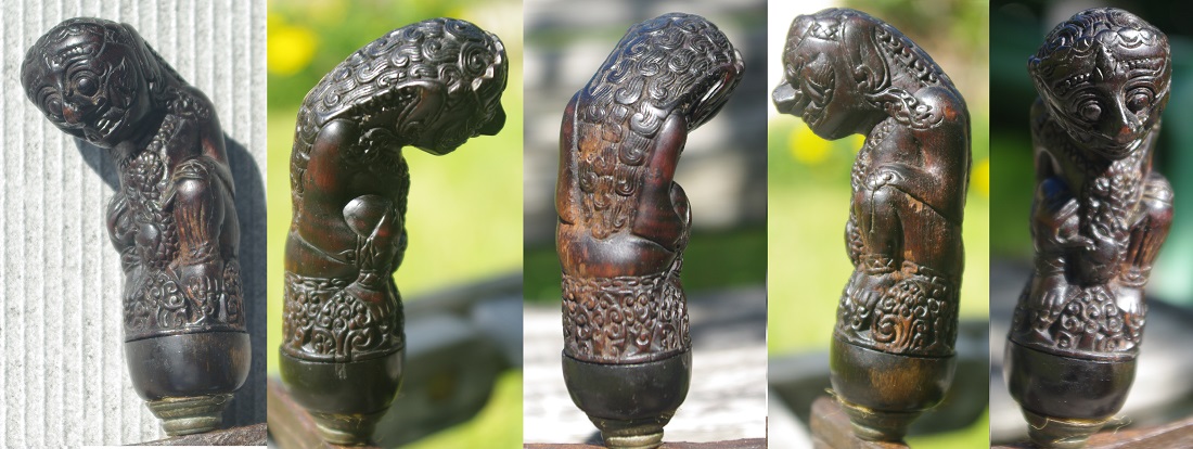

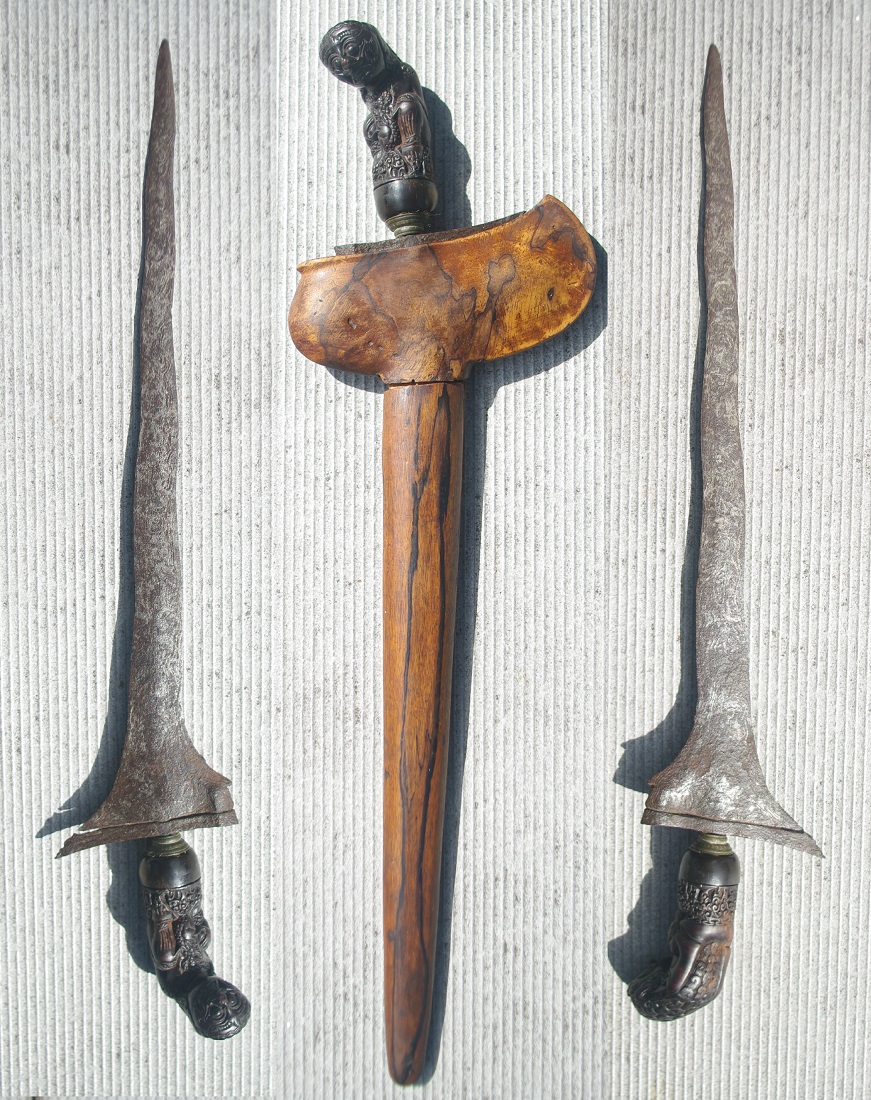

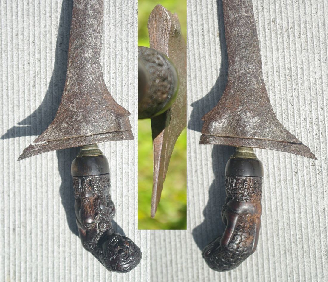

Pics of my similar blade in Segaluh style, also similar to Patje's blade in another recent thread. The nice ivory hilt is in alternative style from West Java/ North Coast/ East Java.

From my observations and references the scabbard from Séverin is typical of the gayaman style from East Java/ Madura (see another typical specimen shown on my first pic).

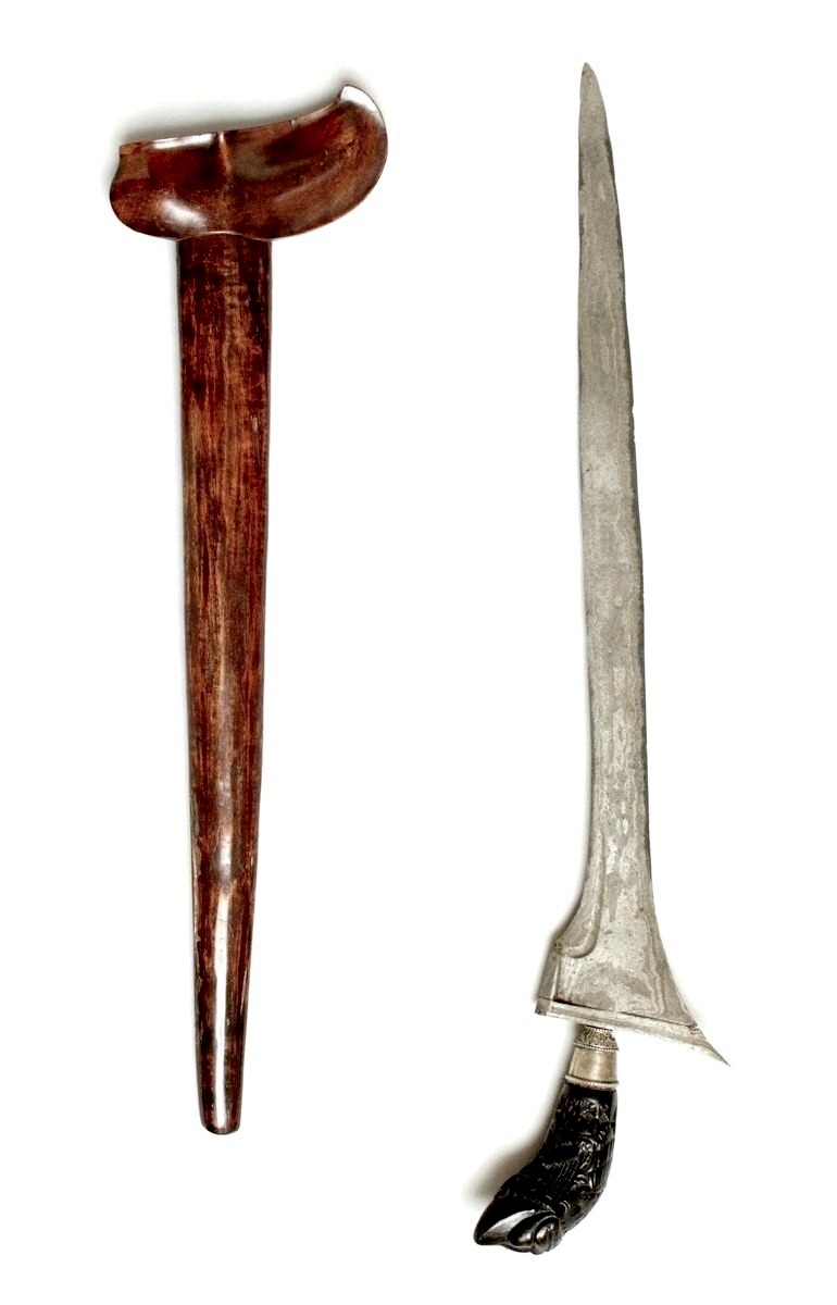

Another typical gayaman scabbard from East Java/ Madura.

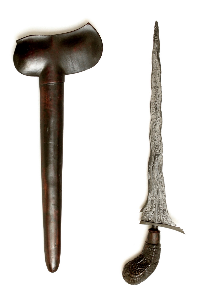

You are fully correct David, it seems as if the pics order has been changed but from memory it was correct when I posted them?
My supposed first pic shows the scabbard made from timoho pelet (last one on my screen now), the second one is the large scabbard made from medium dark wood, and the third one (on top on my screen now) is the dark scabbard with a thick gambar. Sorry for the inconvenience!
