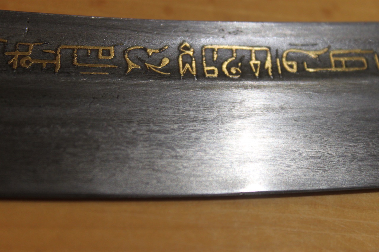

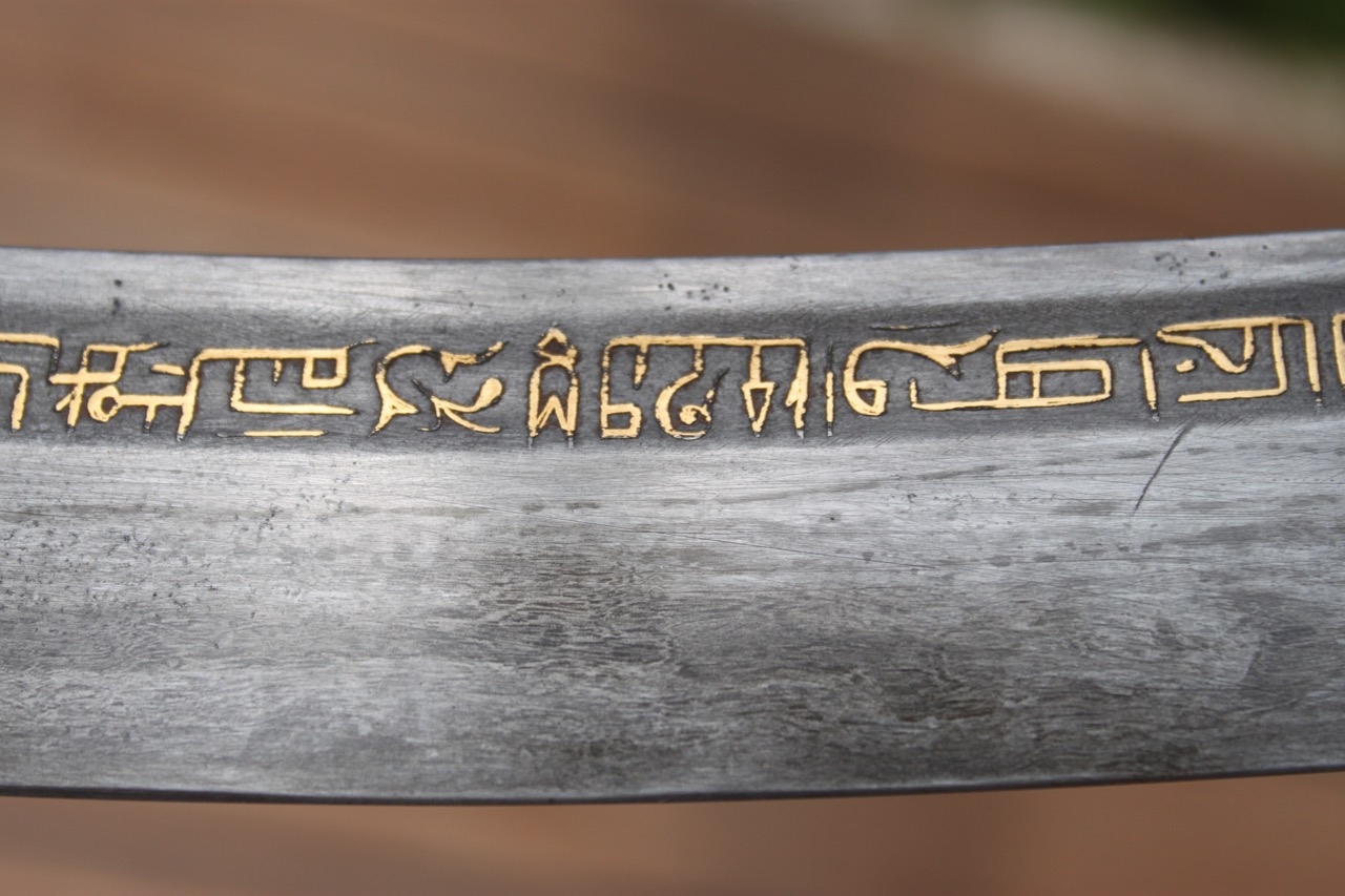

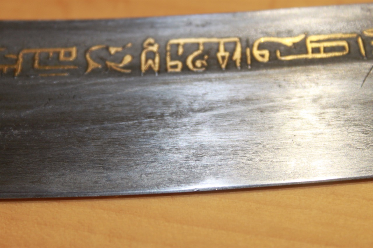

Here the golden calligraphy,
can anybody translate ?
( If possible )

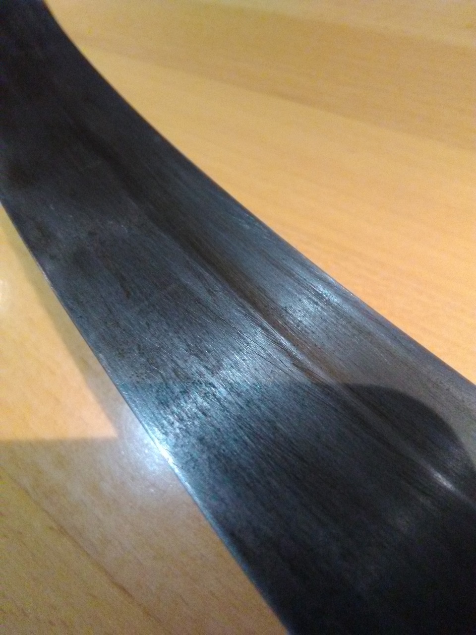

Here some closest pics,
Not to easy to do...
First I found just this kind of stripes on the blade
( + lot of scratches ... )

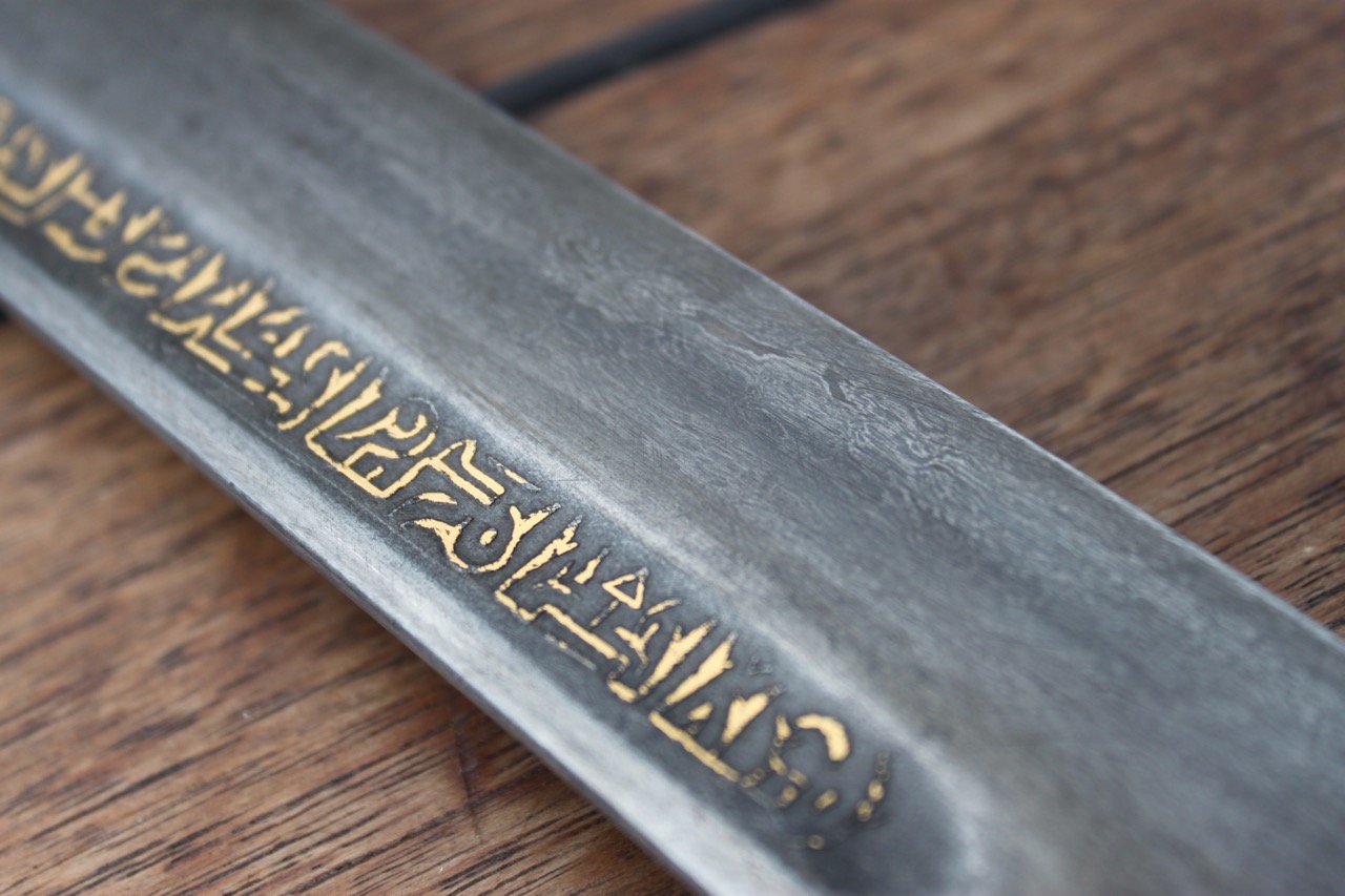

In a few places,
I found I guess a pattern...
What do you think ?

Gold looks a lot better than the modern stuff so I am not sure. Polish a small area and etch?

Last image looks like wootz, not scratches. But worth working on it!

So, the blade,
polished and etched a little.
Not that bad for a scrap tourist blade isn't it !?!!!
Can someone help for exact origin and age,
would be fair !
Kind regards

Well done! could etch even better. Pattern looks Persian? I am no expert in identifying patterns but definitely well made. Inscriptions are odd. If you can send better photos I will try to read. Email them to me (check private messages)
