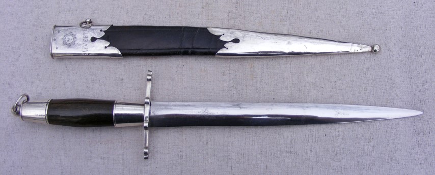

Originally posted by xasterix.
I point out that the Katipunan pieces are highly prized and, I think, of a quality level that at least equals that of the Mindanao
I totally agree, here is one of those "inferior" Luzon blades where I would say the quality of both workmanship and materials used is equal to or better than any Moro pieces I have ever owned or so far seen.
Robert
