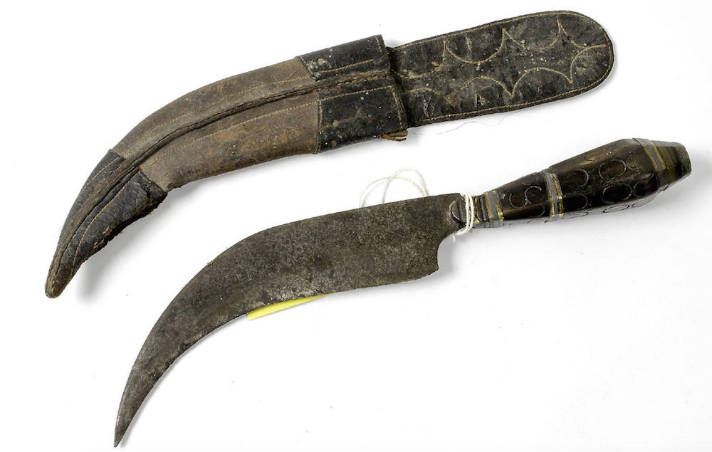

Just to throw some shades of gray onto the choil-notch thing, here is a 19th C. corvo that appears to have a choil, or is it a notch? What would you call it?

Thanks Detlef. Those are pretty odd looking choppers. Does the narrow section on some of these between the blade and the hilt qualify as a ricasso (even though it is much narrower than the blade itself)?. Some of them obviously have finger notches (not the typical Spanish Notch however)--do they also have a choil?

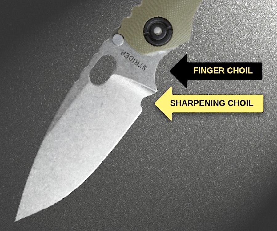

Something else to consider, Alan. Modern blade makers have added a further term to confuse the issue--a "finger choil"--set behind the "sharpening choil."
Old 17th July 2018, 08:16 AM   #7
Posts: 7,257
Well Ian, that's a new one for me, but logically appropriate.
I would describe it as finger notch, after the finger notch is a ver small section what you can describe as ricasso, I am unsure if you can describe this area as choil. When my time it allows I will take some close-ups.

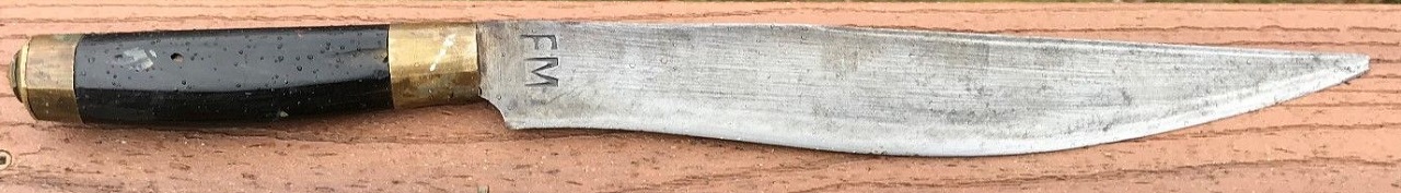

Could we think of this as a "Finger notch" on this Luzon (Tinguian?) knife?
Thanks,
Leif
Old 19th July 2018, 08:23 PM   #13
Posts: 4,749
Leif:
Thanks for posting this interesting knife. It was great to meet with you last night and handle this piece. I would say it is likely Tinguian in origin, based on that choil/notch. After handling it, I think it is probably of approximate WWII vintage, maybe a little earlier or later. It is actually an unusual Filipino knife based on that blade feature. Congrats on a good find.
Ian.
