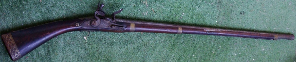

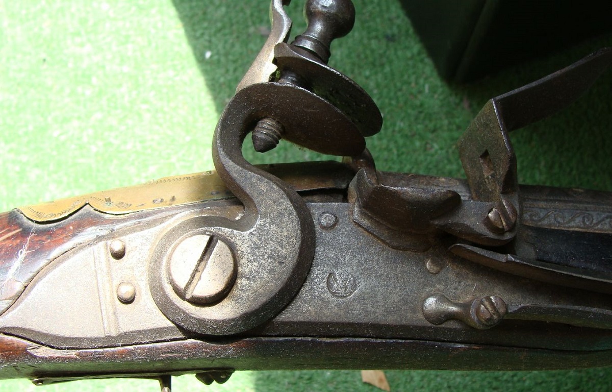

Hello, I recently bought this musket.
Elgood describes a similar as "Dalmatian" / page180 /
The form is identical to ,,Džeferdar "
There is the best barrel I've ever seen.
What is your opinion ?
Thank you.

I like the butt but I LOVE the barrel! Congratulations!

I think the eagle mark on the lockplate could be the sign of the Moskau Arsenal ca. 1770

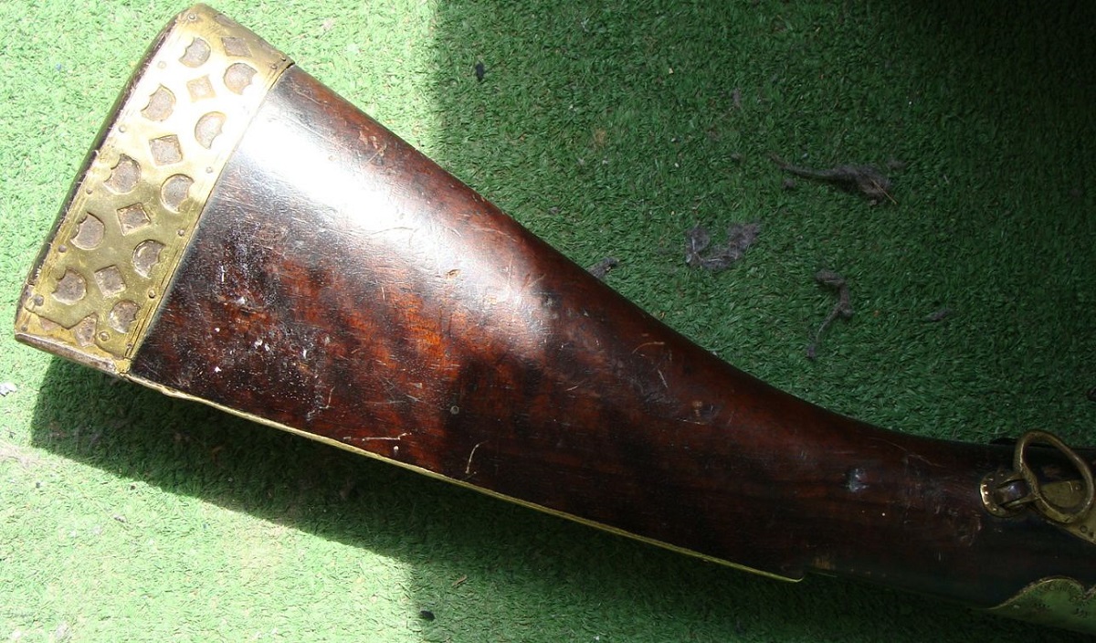

A very interesting musket. Would like to see more pics if you have a chance. Butt plate, left side of gun, wrist area, etc.
Yes, the butt stock is exactly like the so called Dzeferdar style muskets made at the many gun shops in the Balkans. The style of butt stock actually derives from Italian style long guns from the late 17th to early 18th Century. The lock has that Germanic style that was popular during the third and fourth quarters of the 18th Century, and appears to be a European export lock. Does not look like a locally made copy. And the barrel is really cool !!! Appears engraved/chiseled it's entire length.

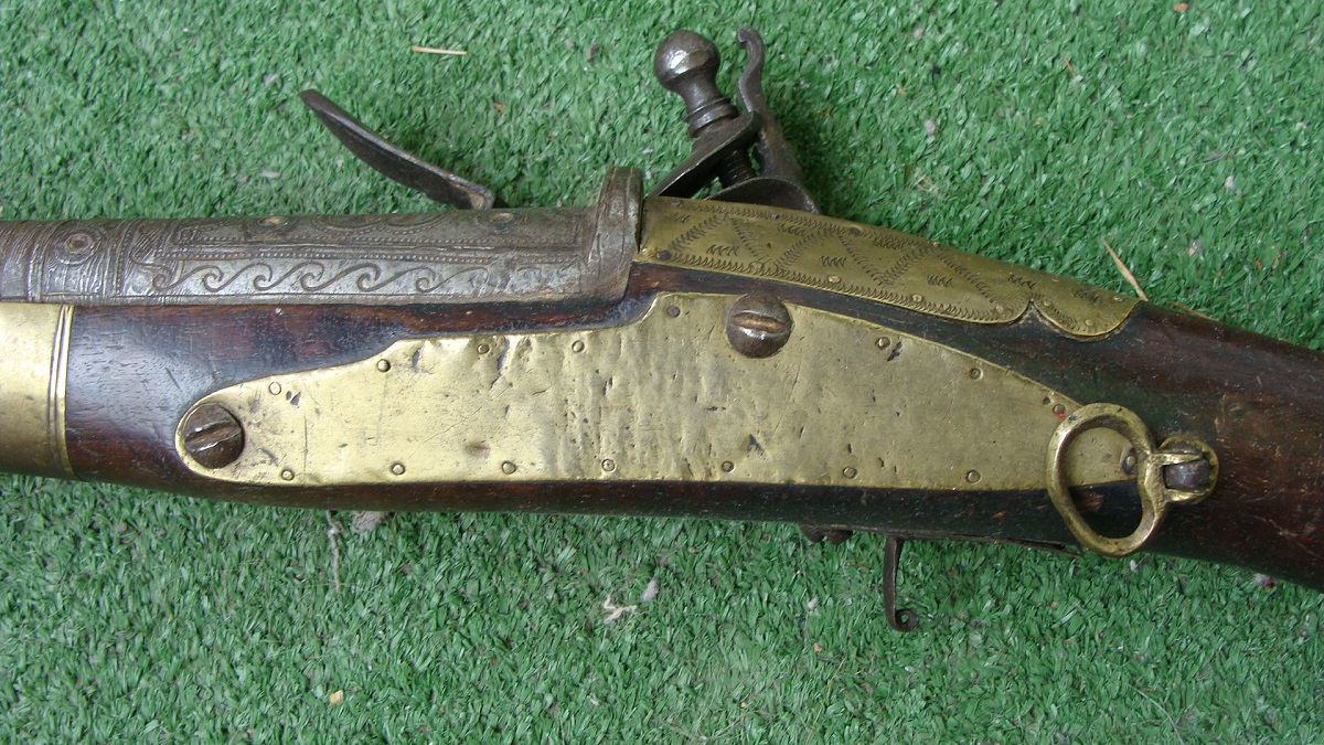

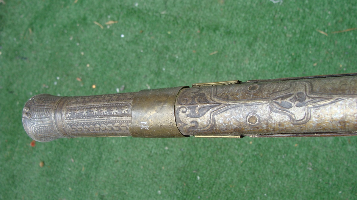

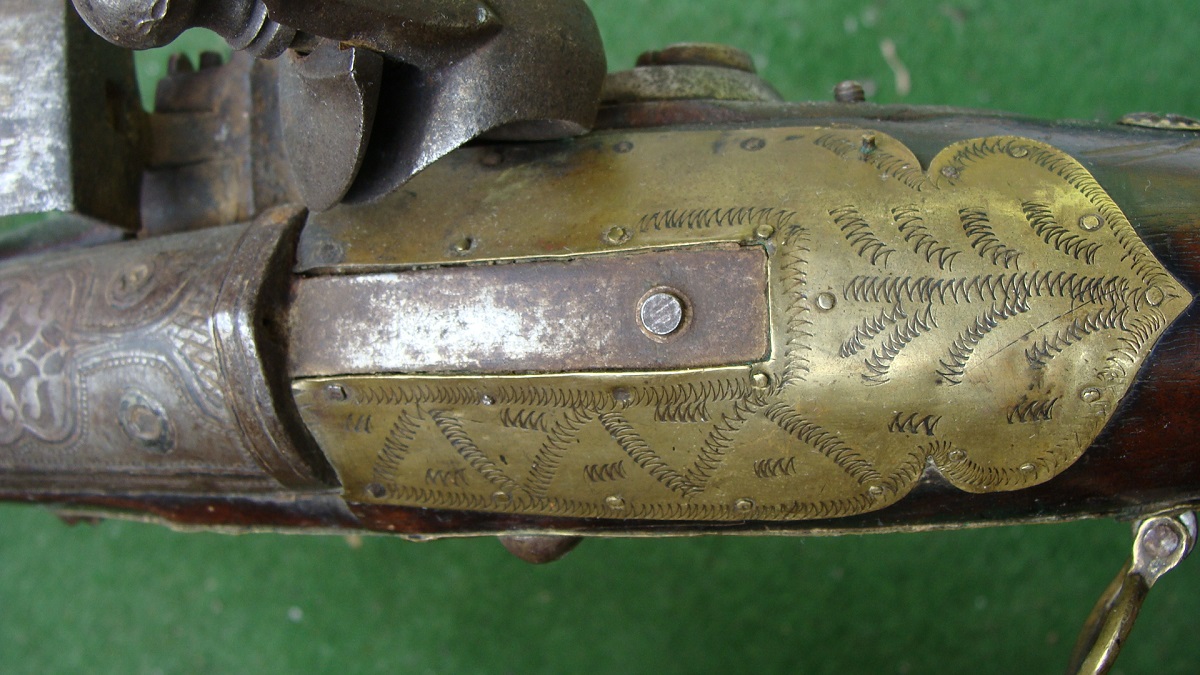

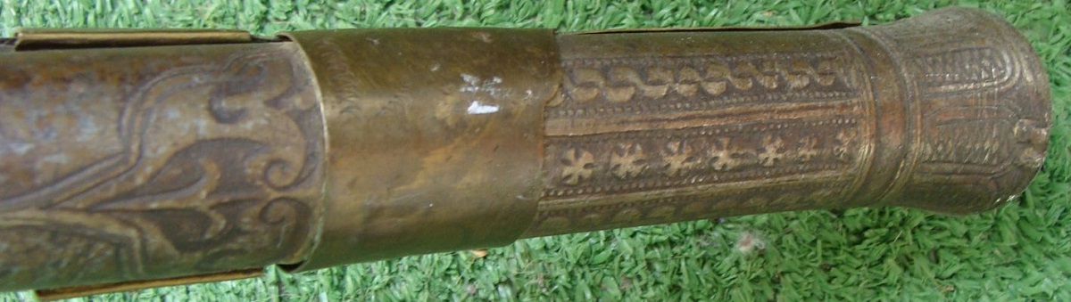

The decorative brass piece surrounding the breach plug tank was a common feature on many Ottoman long guns. And the zig-zag type engraving is very similar to many brass, ottoman barrel bands I've seen. So the gun could have been made for an Ottoman customer (?)

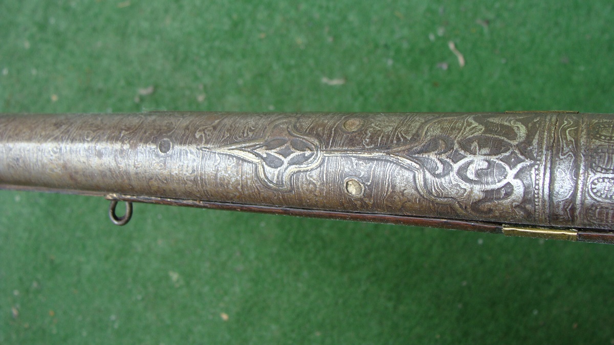

The engraving on the barrel looks fairly generic. So I don't really notice any paticular origin. However, the double bead from sight was a common feature on earlier Persian made barrels. So the barrel could be older than the rest of the gun.

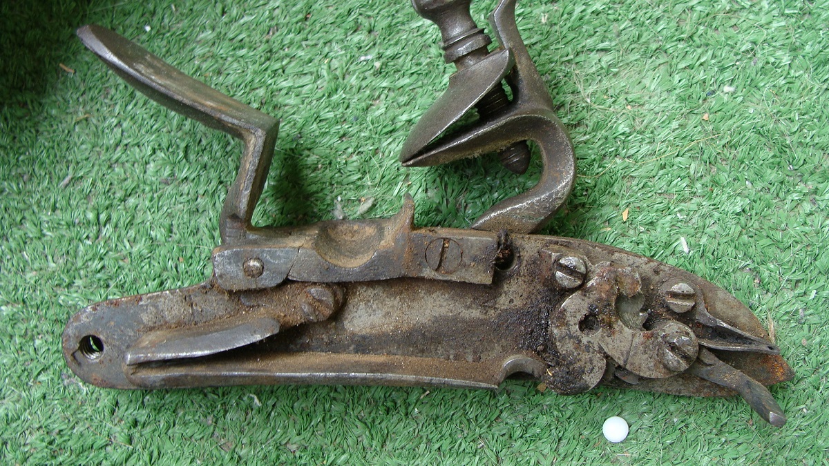

The lock id definately of European origin. The tumbler and cover, and the overall build quality show this to me.

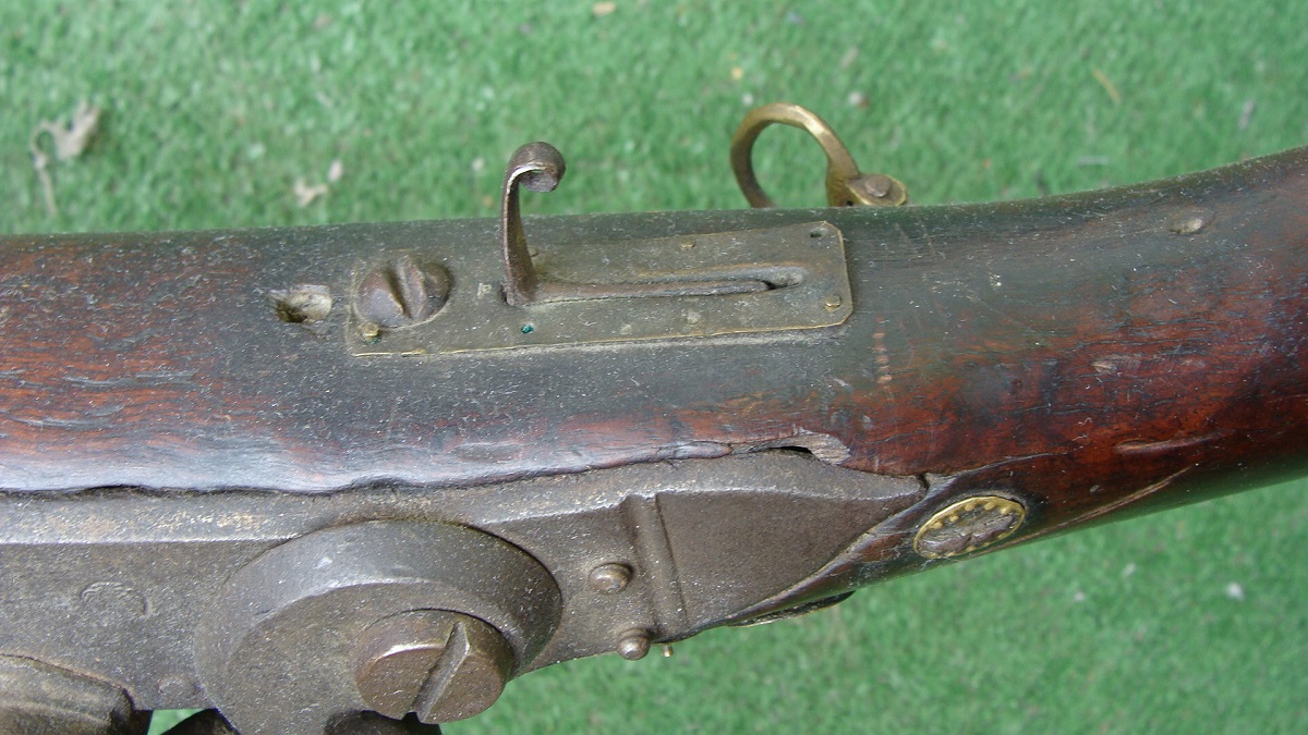

I see a couple of small holes, but it otherwise appears to have been made without a trigger guard. Or does it look like it is missing ?

I think it was trigger guard, but she was missing a long time ago.
Besides the two holes is left no trace ....

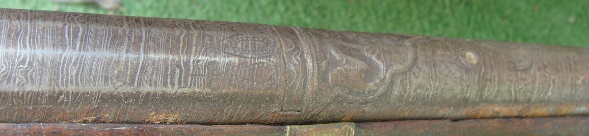

A beautiful gun Ivo. I can only echo the comments already placed here, but what about those indentations on the barrel surface? This type of indentation has been discussed elswhere in relation to Rick's Tanchika http://www.vikingsword.com/vb/showthread.php?t=23838
The suggestion is that at some stage these held stones/corals as decoration. There appears to be residue in the indentations on your gun, so what do Members think as to this being some sort of glue which originally held stones in place?

That's what I noticed in the photo. With the exception of the two holes, there doesn't seem to be any other evidence there was ever a trigger guard. Curious. At least the one larger hole looks to have had a threaded screw (?)
Usually the trigger guards on these Eastern guns were simply nailed to the stocks instead of being fastened with screws. On the other hand, the size of the trigger plate is large enough to suggest the possibility the gun was made without a guard. Many "Eastern" style guns were made without trigger guards. But I can't think of any other reason for the two holes in that location of the stock.

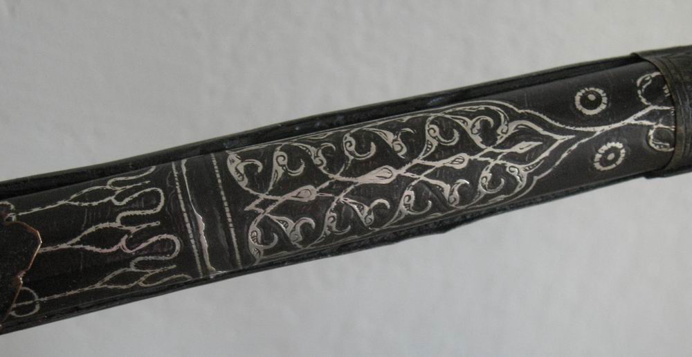

After another look, it does appear the barrel has a small trace of silver wire inlay. That would be very common for this quality of barrel. And I can imagine other decoration. I'm pretty sure the barrel is either Ottoman or Persion. The "raised" round holes from the chiseling do seem to suggest stones of some type. If so, you can imagine what this barrel looked like when new.

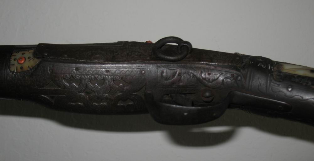

Congratulations Ivo, dzeferdars are not easy to find at least in my experience, and this is a really nice gun with a superb, older barrel. You may have seen the one I posted some years ago in the Traditsia Bulgarian forum, with a somewhat similar barrel. Here are some close ups of the silver wire inlay on the barrel and also one photo of the trigger guard. From your photos I cannot tell if the silver inlay on yours was lost or just tarnished to the point where it blends with the steel of the barrel - cleaning it with a product for silver may bring it back out. I also suspect that the little round holes on your barrel once held corals.
Teodor

That last photo showing the trigger guard style looks like it would fit the two holes in Ivo's gun exactly LOL. Notice the front post of the guard is threaded into the stock. So this may confirm that Ivo's gun is missing it's trigger guard.
