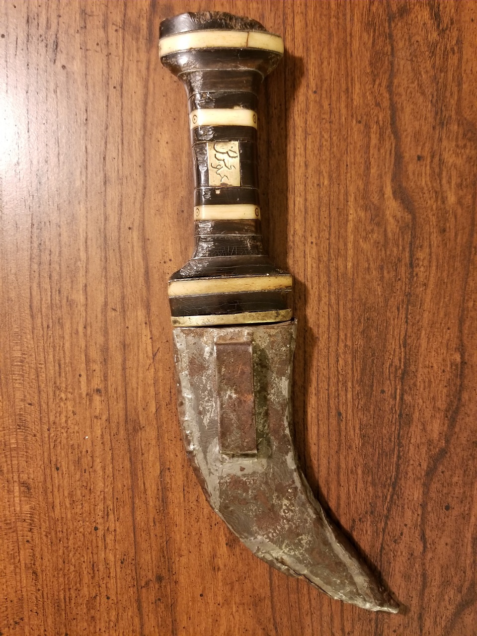

Default Seeking another translation for another Majdali dagger
This one was purchased a few weeks ago and I am seeking a translation for another Majdali dagger. It is a bit rough with some losses and damage but nevertheless a good early example. Size is as...
Overall Length w/ sheath: 9 ½” (24.1cm)
Hilt & Blade Length: 9 ¼” (23.5cm)
Blade Length: 4 ¾” (12.1cm)
The blade is plain and strongly curved. I am unsure about the sheath. It seems to be a later replacement as it is metal with "100% PURE" and "495/44" on the back and may have been painted on the front at one point with most now missing. Any help with translations would be appreciated. Thanks in advance
Geoff

Old 18th May 2019, 11:00 AM   #7
motan
Join Date: Apr 2016
Location: Jerusalem
Posts: 274
Hi Geoffrey,
You are right. This is a better and early example, because it is authentic and not made for the bazaar. The dog-leg shape of the blade, the brass plates on the hilt and the lead or tin stars are typical for daggers made around 1900, give or take 15 years. They are not uncommon because they were widely used in Southern Syria. I will ask a friend for the translation. The 2nd hand sheet of the scabbard is a common phenomenon, mostly from between the wars. It could well be a replacement because most had scabbard of thin brass sheet over wooden core, and these don't last.

Old 18th May 2019, 02:55 PM   #8
motan
Join Date: Apr 2016
Location: Jerusalem
Posts: 274
Hi again,
The writing on the hilt says A'mal A'waad = the work of A'waad = made by..
A'waad is a quite common name.
