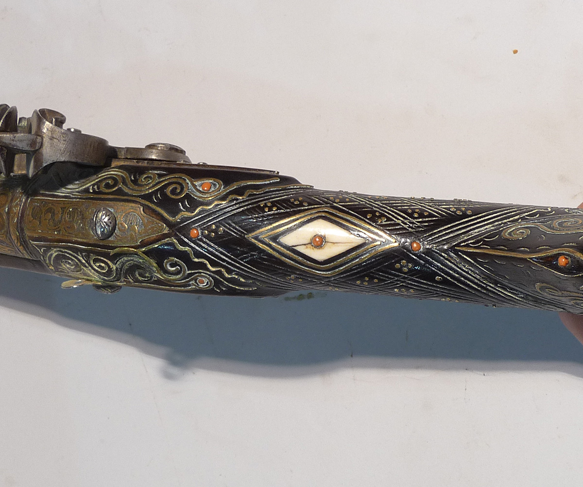

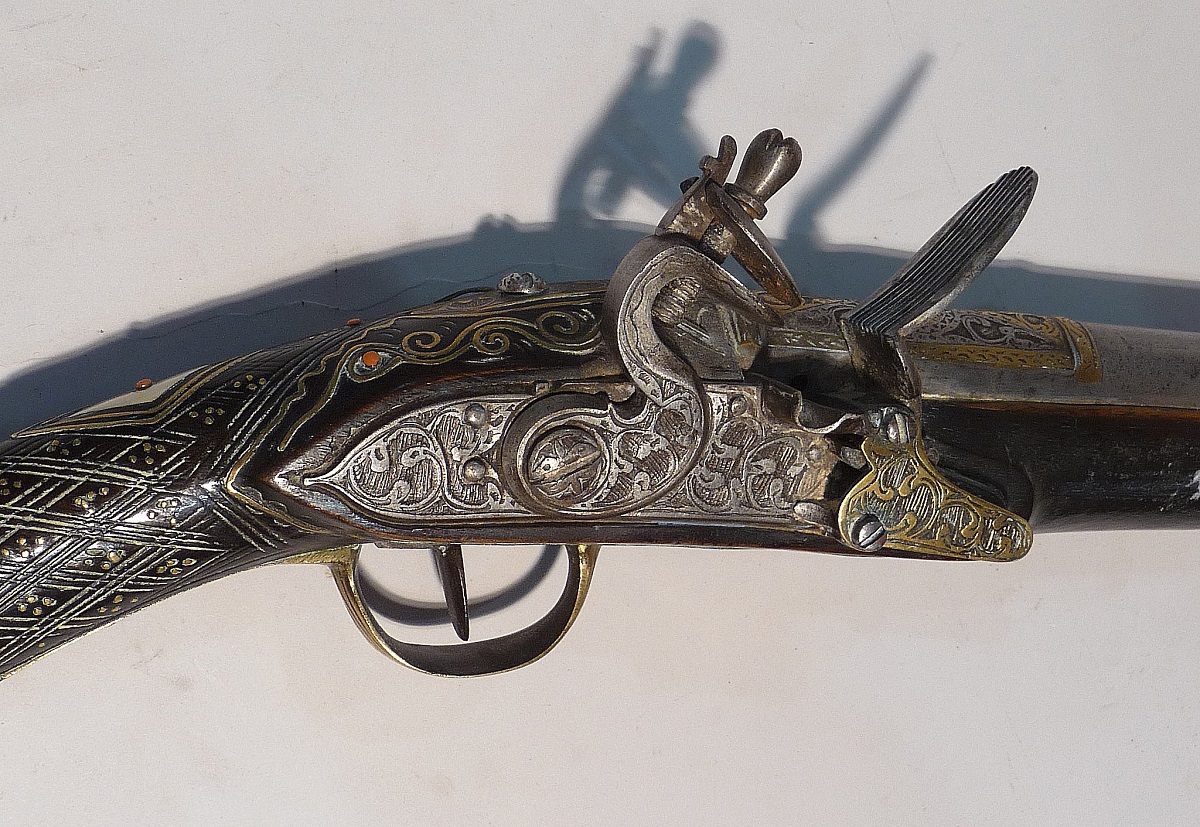

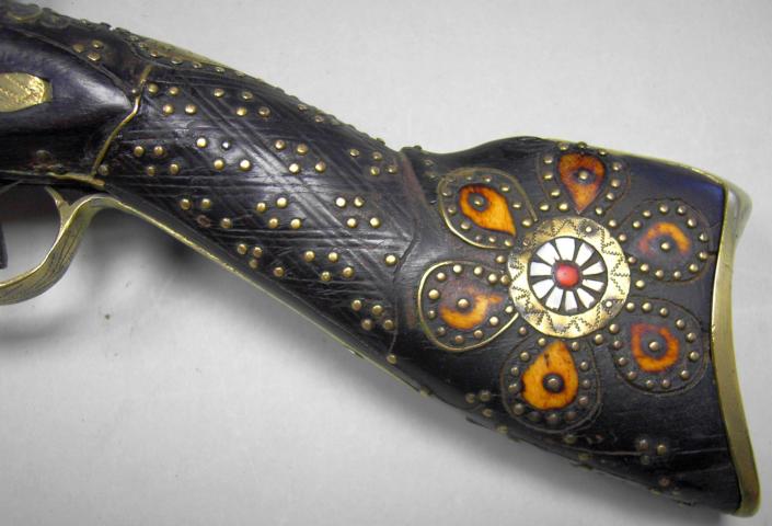

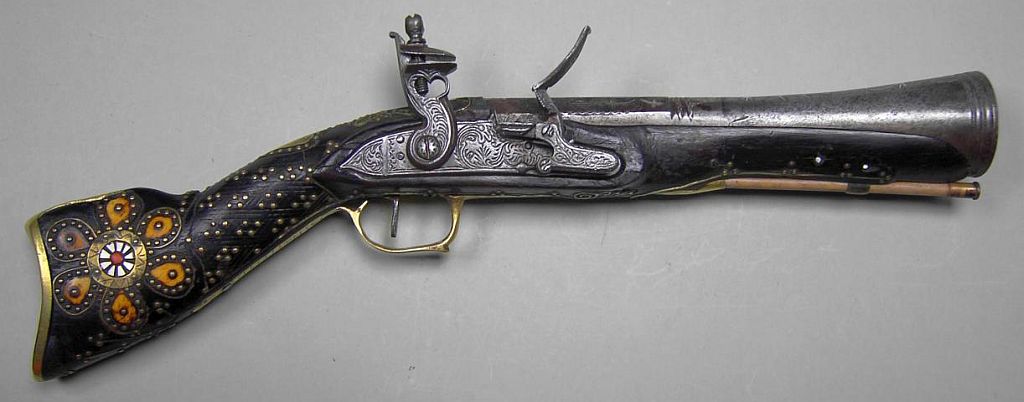

Today I got this not too bad Osmanic pistol. The whole stock is nicely decorated with brass nails and cut lines, its butt shows at both sides a pleasing ornament. The lock is engraved with a floral decoration as is the cover of the battery spring. The nut is without a tumbler. There is no mark or signature and the sideplate could eventually be a later replacement but has the same decoration as all other brass items. The barrel has nice silver inlays in form of swords, stars etc.
Total lenght is 450 mm, barrel length 230mm, cal. 45mm
Hope you like it as I do

Hi fernando
i love it!
I can tell your precisely your pistol came from: Tunisia.
Look on our forum, you'll find the same lock, and design on the butt with bone and coral).
I think that just the ramrod is a replacement.

kahnjar1's Avatar
Posts: 2,832
VERY NICE!! I agree with Kubur that the rammer is a likely replacement. The rest of the gun looks nice and original.

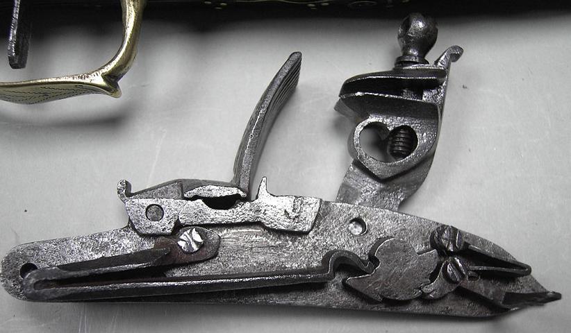

Mmmm ..... I have my doubts. Despite the lush decoration, it seems a piece for tourists. The engraving seems to me that it has been imitated in the foundry. I would like to see some picture of the inside of the key .....
Affectionately. Fernando K

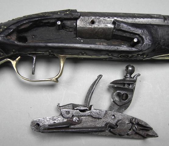

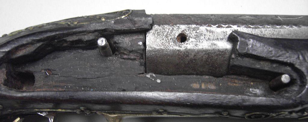

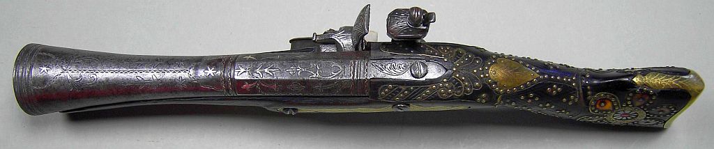

Here are some more Fotos
corrado26

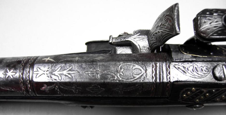

Hello
Definitely, it seems to me a lock armed with castings, instead of being forged. I have not seen any indication that has been filed in any part, not even in the springs. The surfaces show a granulate, compatible with casting
The decoration in the barrel in the shape of a zig-zag show a rounded edge, incompatible with the chiseling or chiseled.
A test would be to mount a stone in the foot of the cat (cock or hammer) and shoot, to see if the frizzen produces sparks. If, as I suspect it is false, it would not produce sparks.
is what I think, just by looking at the pictures.

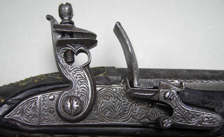

Hello
Here I upload an image of a lock of the same origin. As you can see the decoration is in fine lines, achieved with a hand chisel or burin chisel. In the disputed lock, the decoration is rude, because fine lines can not be reproduced in the mold
Fernando K

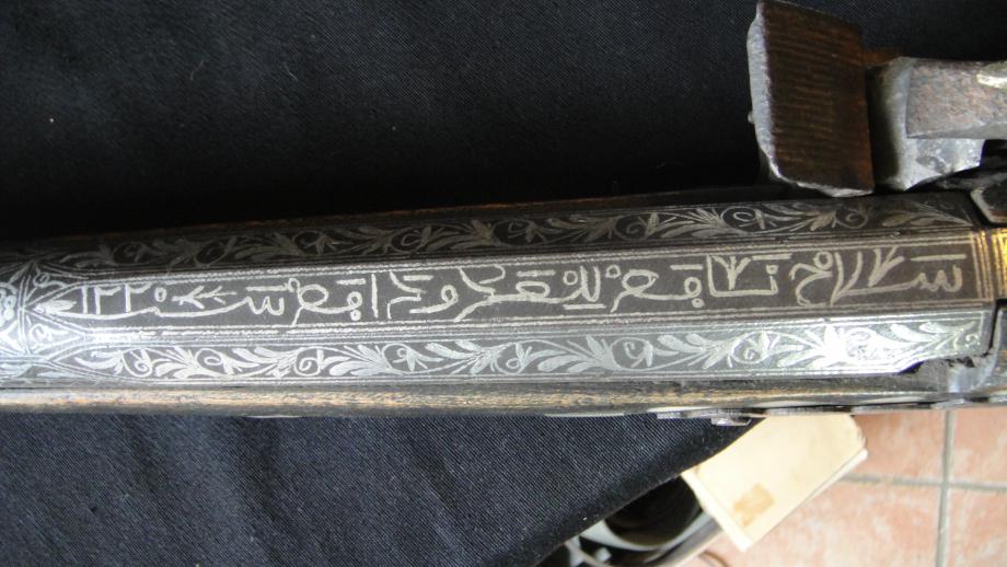

Kubur
For example, in post number 8 you can see the upper part of the barrel, with an inscription that seems to be Arabic. They are arabesques, but looking at an Arabic alphabet, I can not find any similar letters, except one
Fernando K

Originally Posted by Fernando K
Kubur
Fernando K
Hi Fernando
I don't understand.
But to me the decorations are engraved and not moulded!

http://www.vikingsword.com/vb/showt...tunisian+pistol
Kubur
I do not understand. I refer to the post number 8, where you see an inscription that for me is false, in something that resembles the Arabic language, and you have answered something else.
affectionately. Fernando K
