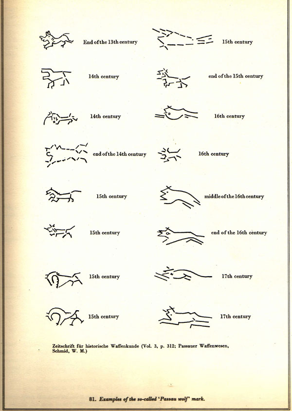

I am hoping we can focus for example on the 'running wolf' of Passau, which evolved into forms stamped in the blades of Styria, Solingen and eventually in the Hounslow blades and Shotley Bridge blades of German makers in England.
There is an especially interesting chart on the chronological development of this mark in Wagner ("Cut and Thrust Weapons") ...could anyone with this book please post? Also there is I believe a note on the marking in Oakeshott ("Archaeology of Weapons"). ...also please post anyone?

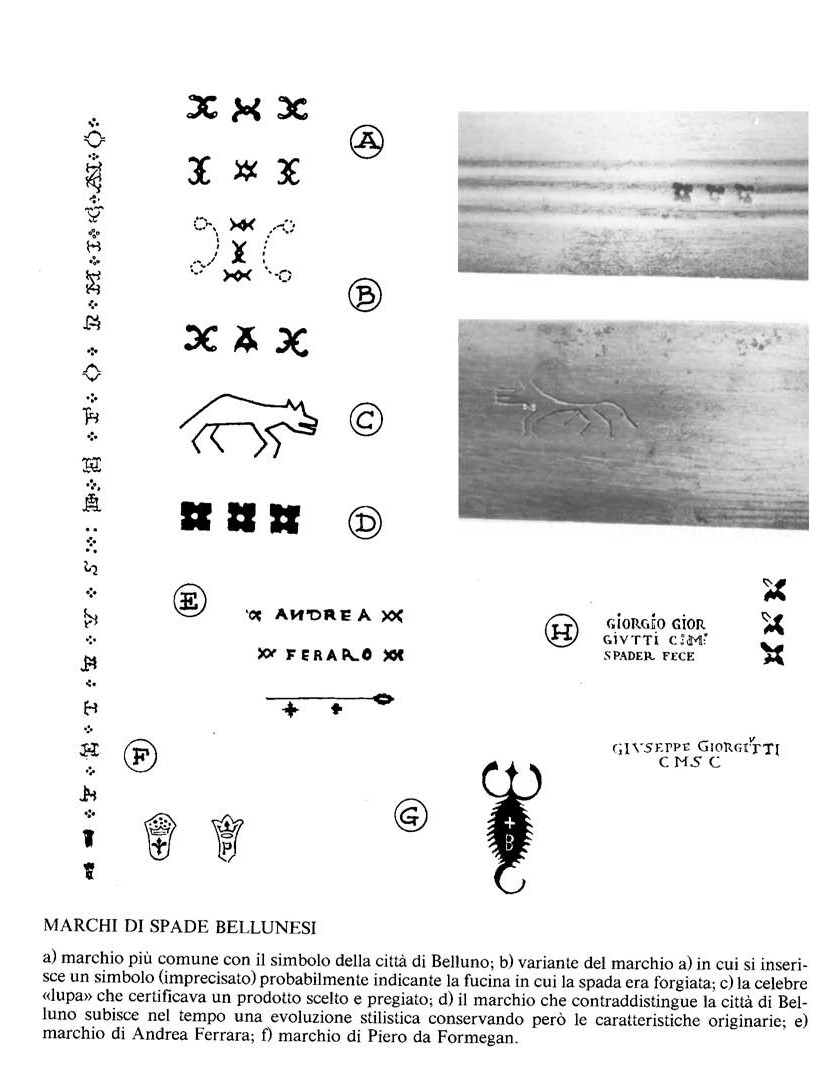

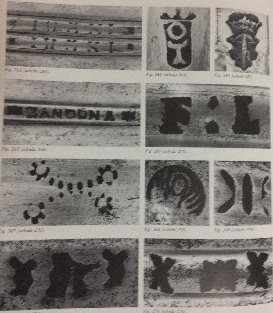

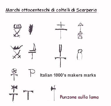

Here are some early Italian makers marks.
Rich S

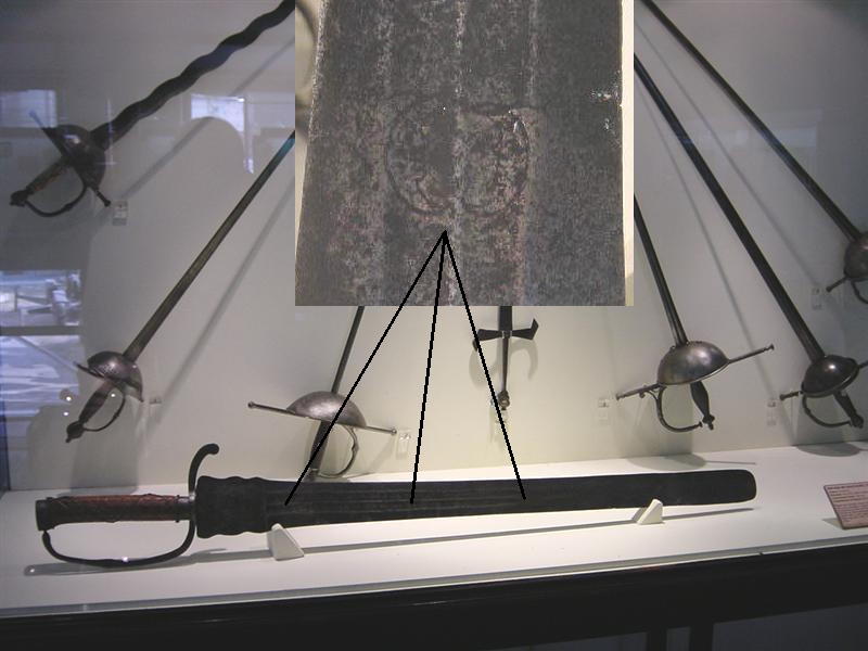

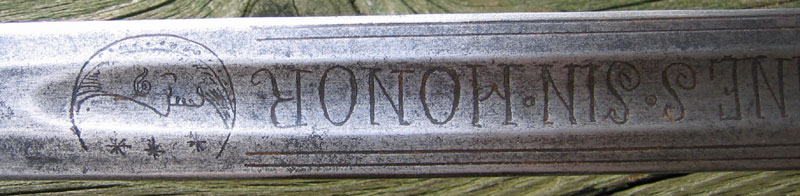

'The Spanish Motto', do not draw me without reason, nor sheath me without honor. This occurs in about mid 18th century, and while associated with Spanish blades of the period, it turns out these blades, typically Spanish dragoon blades c. 1769 were actually produced in Solingen.[/QUOTE]
Hi Jim
This Motto is much older than that.
In the collection of the Portuguese Viscount of Pindela, published in 1946, swords #35 and #39 bear this Motto. These sords are dated XVI century.
This is a very serious (rare) publication (which i luckily have), sponsored by the State. The collection was kept in the family's Mannor house, where it was catalogued, and was later sold to the State, due to the family's financial situation. It is now in exhibition in one of the National Palaces.
Hpe this is usefull.
Fernando

Thanks so much Rich and Fernando for getting things rolling!!!
The Italian marks are great Rich.....I had a copy of the huge volume "Armi Bianchi Italiene" which I wish I had access to....these Italian marks are very important as the Italians were quite prominant traders that diffused immense numbers of blades.
Thank you for the input on that motto Fernando....I knew it was older than the popularly applied examples on those dragoon blades but did not know where or how early. The transliterated versions appeared also on French and Italian blades as well during the 18th century, and in the case of the Italian examples probably much earlier due to contact with the Portuguese I would imagine.

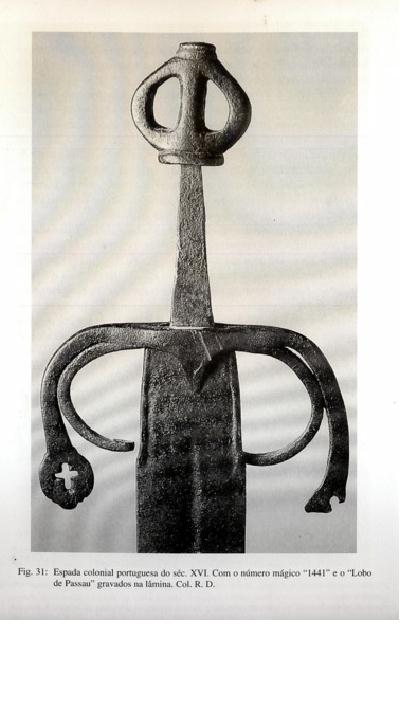

Hi again,
The running wolf ( Lobo de Passau ) is quoted to be engraved, together with the number 1441 ( one of the various combinations of magic number 7 ) in a XVI century Portuguese Colonial ( crab ) sword, depicted in page 64 of "Homens Espadas e Tomates, a book you also have. It appears that these trade blades were supplied at the time to Portugal and ( if i remember reading ) also Spain.
If needed, some evolution on the magic number seven can be posted.
Fernando

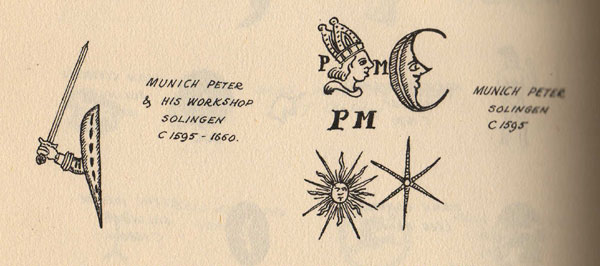

Here is Pg. 109 of Wagner's Cut and Thrust Weapons .

Ya always come in like the cavalry!!!!! Those are exactly the images I was looking for, thank you so much!

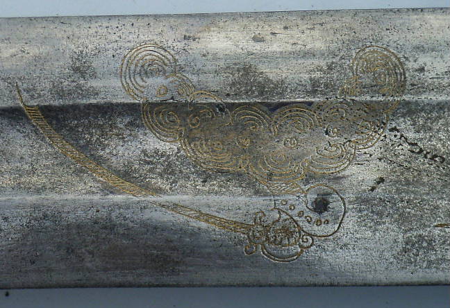

Here is a cloud with a sword. One is from an English cavalry sword, the other, a Yemeni sword and the coat of arms is for the town of Valka, Latvia. A very small town in Latvia from where my wife's family fled during WWII. This part of Lativa was a German principality for most of the the middle ages.

Beautiful examples Michael! and most intriguing history with the coat of arms shown. It seems I have seen similar arms in Polish heraldry, and that the arm coming from the cloud device was most likely adopted by Solingen makers in the 17th to 18th centuries as can be seen in the talismanic context.
I have seen this marking in books on this topic such as 1000 Makers Marks (Lenciewicz ?) and another whose title escapes me (Jeff I think you have these). I apologize for not having better recollection on these, I do not have access to books presently so must rely on what there is of my memory!!
It is interesting to see the religious allegory associated with these talismanic devices in motif, in this case the arm holding a sabre represents the arm of God and the sword extending from Heaven. We did have some discussion on the appearance of the Virgin Mary on Polish swords along with astral symbols not too long ago, and it seems that the arm in the cloud is shown illustrated in a Russian reference on this topic indicating the use from 17th to 18th century.
The English cavalry blade looks like an early 19th century sabre blade, and the Yemeni blade appears to be a broadsword as seen on kattara in Oman..both with Solingen blades,can you show the full examples?

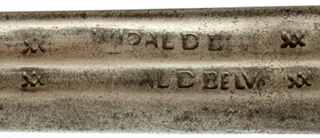

I have only one blade, on a firangi, which could be a trade blade. As far as I can read it, it says XX WIDALDBELV XX, I don�t know what it means, but I have noticed that the text is not in the middle of the four �X�s so there may have been more than what can be seen to day. What can be seen is fairly deep, and this �worries� me a bit. The �X�s can be seen at both ends, but some of the letters are missing, without any trace of that they have been there, and this I find strange, it is btw the same on both sides of the blade. Could it be, that blades like this, with a sloppy marking, are not trade blades, although they are supposed to look so, but local made blades? We must not forget, that although several countries did what they could, to fill the market in other countries with trade blades, a lot of the so called trade blades we see to day have been locally made. How do we know which is a trade blade and which is a locally made one?

Hi Jens,
Excellent point, very often it becomes hard to determine which are the trade blades and which are locally made. In many cases the locally made blades become quite good, and as trade blades were made sometimes rather indiscriminately, the very quality the markings presumed to declare was in fact not present. I think in many instances the manner in which certain markings were applied and the locations on the blade sometimes gave clues. For example, in the Sahara, the dual opposed crescent moons seen on the takouba blades are clearly an imitation of the larger crescent moon on the European talismanic blades. Applied doubly must have been thier idea of somehow strengthening or emphasizing the application.
In another case, the eyelash type markings appear on a blade in the Caucusus ( also on an Indian blade I have seen) rather than singly, applied in linear repitition, in the manner of motif. This multiplied use of what was originally a single trademark suggests the folk interpretation of increasing the quality or power imbued in the blade.
It seems that the X stamps typically enclosed either names, mottos or inscriptions on 17th century European blades, possibly some earlier. I am not certain of the purpose of these x markings but to enclose these inscriptions, and possibly since they often occur in multiple, numerological symbolism may be involved.
All the best,

The images in Zygmunt Lenkiewicz and Dudley Gyngell's books are the same and as you know attributed to Peter Munich (I will post the images in Gyngell below). Not quite the cloud and sword as on Michael's beautiful blade. I think these images are often mistakenly attributed to Peter Munich but infact date to Solingern from the mid 18th to mid 19th century. The Munich images are much more detailed. The exact images seen on Michael's blade are seen often on British 1788 blades from the Runkel factory. They are less often but not atypically seen on British 1796's, and trade blades to Eastern Europe, Caucasus and Africa (oddly I haven't found any exported to America?). Similar images are copied in these areas, but appear more crude.
The arm with sword protruding from a cloud is thought to represent the sword of God or God's justice. It is seen in herarldry from Poland, Scandinavia, and Ireland to name a few. It has been mentioned that there at least was a Protestant connection. It is interesting to note that often in heraldry and in the blade image the sword is a "scimitar" not the more typically European saber as in Michaels coat of arms?

Thank you for posting the reference on the Peter Munich blade markings, and I think you are right in these appearing in kind, much later into the 18th and 19th century and the astral figures do appear often on British officers sabres as you have noted. I have always thought that these figures on these blades in these later times not only had to do with quality symbolism, but likely even more to do with Masonic lore. In those times officers were of course also well established gentry and often nobility, and were of course also often quite active in Freemasonry, where much of this symbolism remained well in place.
Very good point about the trade blades from Solingen, or for that matter Runkle who was situated in England, and their wide distribution. I think that in America these blades did get there in some degree of course via British presence. Best source for examples here would probably be Neumann, "Swords and Blades of the American Revolution".
Interesting note that you bring up on the sword held by the arm in the cloud being a 'scimitar' as described in heraldry. It seems that these sabres and for that matter the 'Oriental' fashion deeply influenced many European forces in warfare in Eastern Europe against Turkish forces, and in many cases the 'exotic' imagery was adopted in degree. One interesting case is with a few of the Scottish mercenaries who adopted the curved sabre blades in their basket hilts, terming these hybrids 'turcael', if I recall.
With the mention of the Scottish blades, it brings to mind that it seems invariably that the basket hilt blades were German, and presumably mostly from Solingen. Needless to say, that brings us to the Andrea Ferrara myth!!

Thanks for mentioning the Scottish blades as that reminded me about another observation. Often these 'trade marks' are doubled. ie. eyelashes & Ferrara marks, Or as in this Scottish basket hilt stars and moon with the Spanish motto etc.
Jeff

Regarding the scimitar in the cloud image. I always wondered if it represented that the Eastern powers were seen as God's punishment, you know, not enough faith and all that...
More things to ponder.

This is a rough translation of the paragraphs concerning the so called magic numbers, referring to the sword i have mentioned before, contained in the book already quoted.
I hope this makes some sense and is usefull to the thread topic. If not, it's you who asked for it
I myself allways doubt the efectiveness of isoteric stuff ( is this how you call it? )
" It became easy to distinguish European examples from Colonials, as the quality of their fabrication and its artistic level were highly superior to those made in the Colonies. Not so easy, however,was to distinguish examples in the Colonies that were made by Portuguese smiths, engaged by the Overseas Arsenals, from simple copies manufactured in Native anvils.
Both versions had imported blades. The wide blades with the mark �Lobo de Passau ( a running wolf ), and with the magic numbers 1414 or 1441, are the oldest examples, which origin is attributed to Portuguese Colonial Arsenals and the realms of Dom Manuel ( 1495-1521 ) untill Dom Sebasti�o ( 1557-1578). It is worthy to mention that the numbers 1414 and 1441 were not the date of production ( under which very often they were classified ) but uniquely the application of a number considered �magic�. The study of numerology, a fashion of the period, attributed to figure �7�, as to its multiples and combinations, a Divine value. While the Arab cried Allah il Allah, the Christian would engrave the number 7 or, more often the 14 ( this being two times 7 ), or 1414 ( this being two times 7 plus another two times 7 ) or 1441 ( being 14 and the palidrome of another 14) on his blade, wishing to express this way his cry for Divine help in all four directions, as from the moment he unsheathed his sword. Number 1414 is also a reference to the Bible; Job, chapter 14, paragrapgh 14: Man dying, will he live again? Every days of my combat i would wait, untill my change arrived (in the Catholic version). Luther, much considered in Germany in the XVI century, has translated the Greek original, offering in simple language,the following interpretation to this Biblic quotation: When a man dyes, he will live again. So i will continue fighting until my moment comes."
All the best

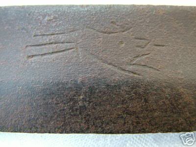

interesting, i had noted this one on a sword for sale on ebay (now ended). looks like a hunting sword.
it did not want to come live with me tho........
it did not want to come live with me tho........ Quote.
Hi Kronckew You beat me to it .....I was surprised at the final price....have to agree that its a hunting hanger ...but think it was re-hilted ...the blade shape seems a little unusual for a hunting sword though, and I suspect that the blade has been shortened and the tip re-profiled.
Regards David

does look very hangerish.
most of the naval officers, while having a proper fancy sword for dress, would actually carry a hanger into battle as shipboard space tended to be a bit tight, they if i recall would sometimes have similar simple grips and guards....
in the u.s. navy they ultimately barred officers from carrying hangers as they were all different & too functional, not gentlemanly. of course, the officers at the sharp end took no notice and continued using them (and/or 'enlisted' cutlass) up till they stopped boarding enemy vessels....the war dept. eventually outlawed swords entirely & made officers turn them in for scrap, but wisdom prevailed and they were reinstated. i carried mine around for 5 years active duty & only got to wear it once in a parade, then once or twice in my active reserve days. the naval officers sword has degenerated into a pretty sliver of non-functional unsharpened polished & etched steel; i'd rather have a hanger.
it'd be interesting to know if this was a 17c. passau sabre captured & converted to a hanger for use by an english naval or infantry officer.

Hi Jim,
I feel deeply frustrated
I have deliberatily gone back to the Oporto Military Museum, in order to improve the pictures of this situation, but i couldn't manage better than the last time i was there. It is rather dificult to picture determined positions through the glass windows.
This is labelled as an end XVI century German beheading sword, of unusual quality, where the double human half moons face each other, etched three times along the visible side of the blade ... probably also on the other side.
I had sort of convinced the Directing Colonel to open the window for better pictures ( he owed me one ) but he went on a meeting and didn't show up untill i gave up.
I hope this is usefull the way it is.
Fernando

While I can see the moons, were there other marks on the blade? Quote.
No Jim, the only marks are the crescent (and decrescent ) moons. Three pairs of them, at least on the showing side.
Just a little note. This sword is labelled as German by the Museum, but this is not necessarily a fact. I once showed a full set of pictures to Philip Tom and he sugested it could be Hungarian, quicker than German. This just in case someone finds its quoted origin passive of doubt.
