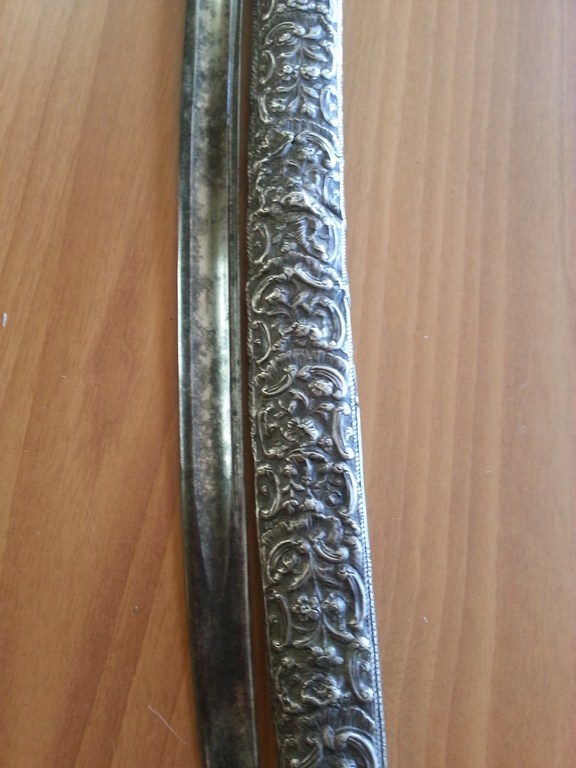

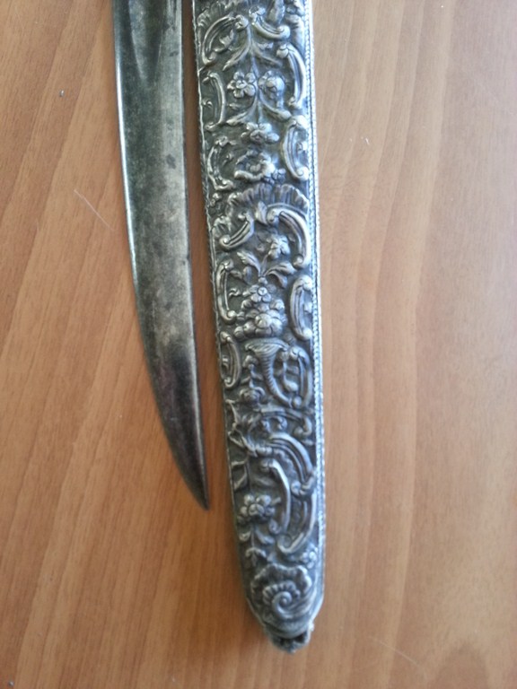

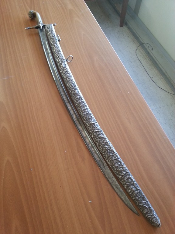

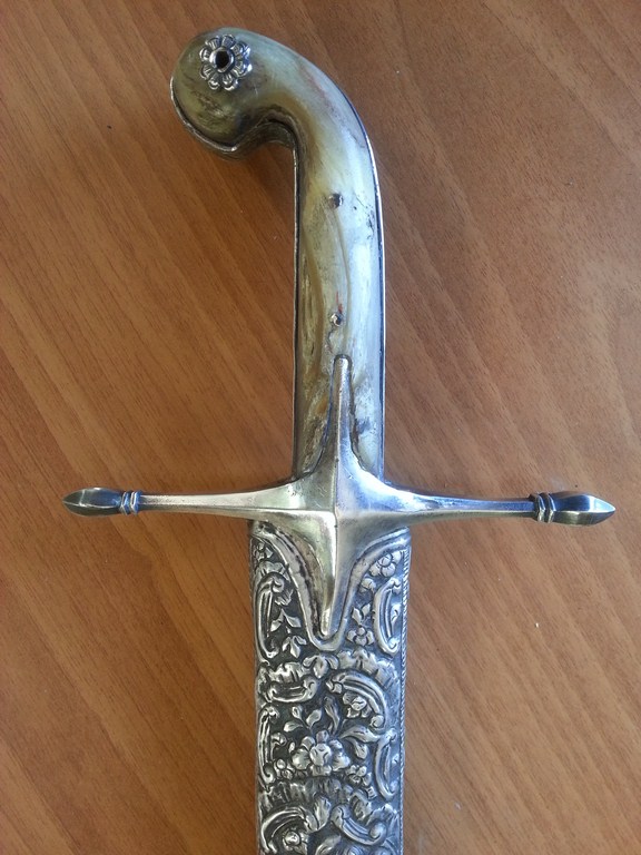

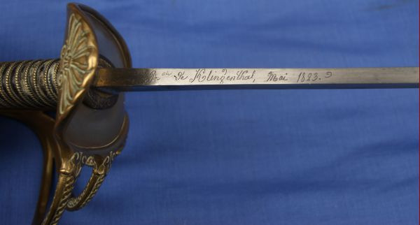

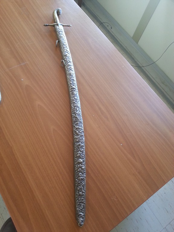

Hello, thiw extremely long sword with an ottoman silver repousse scabbard, has a european blade which looks like a French blade of the Napoleonic date. On the back of the blade there is a date which look to me like 1823. MAybe is 1843?
Do you know what is the type and origin of the blade?
Old 17th October 2017, 01:49 PM   #2
Norman McCormick
Norman McCormick's Avatar
Posts: 1,657
Hi Eftihis,

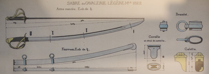

Blade profile looks to me like the French 1822 Pattern Light Cavalry Sabre for Troopers/Officers. I see the date as 1823. There probably should be more script before the date giving the armoury where the blade was manufactured and possibly inspectors stamps at or near the ricasso.
Norman.

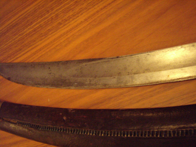

Eftihi,

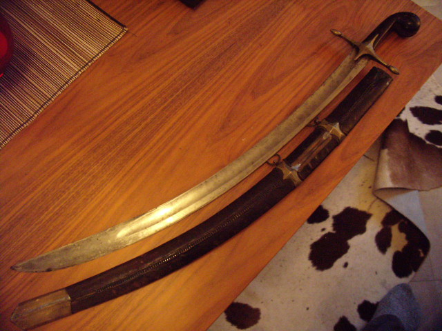

I have a Ottoman shamshir with the identical blade. I'll try to post pictures later. Different scabbard though.
