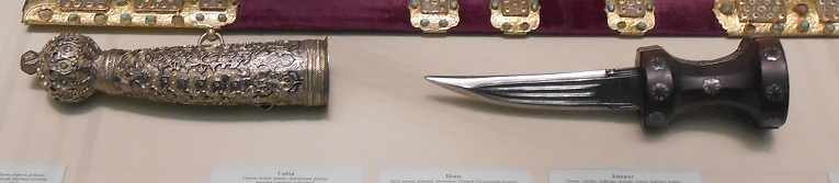

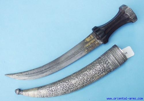

Hi Guys,
I'm very interested by old Ottoman daggers.
In particular this kind of dagger.
http://www.oriental-arms.com/item.php?id=133
Oriental arms said 18th or earlier and the one in the Hermitage collection is from the 16th c.
Any ideas, other examples or comments?
More than the grip, I'm interested by the blade...
Thanks
Kubur

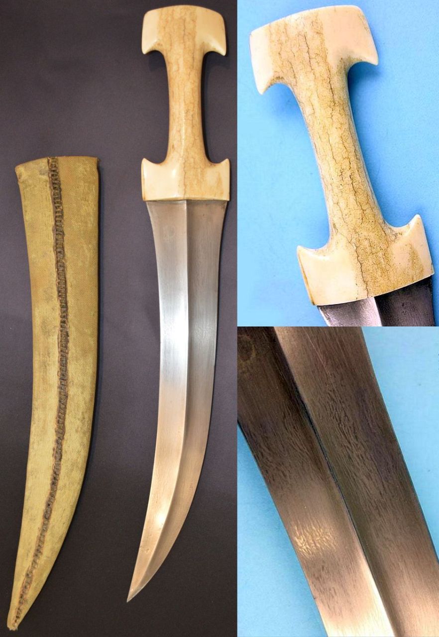

I do not trust the Hermitage collections descriptions, wonder how they dated it?

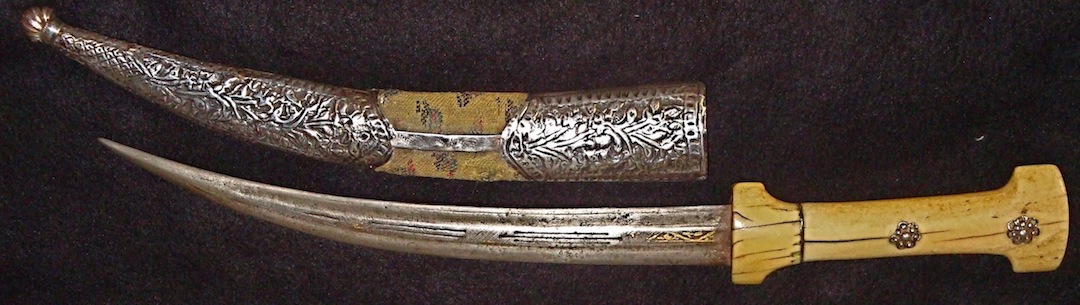

Here is a jambiya I got from Artzi, this type are said to be Ottoman Albanian, walrus hilt, wootz blade, 20 inches (in scabbard), blade 12 inches.

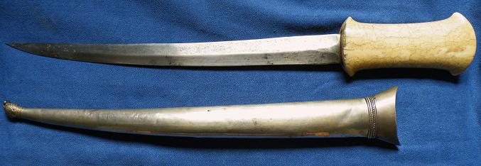

Hi Kubur ,
Here is a dagger from my collection.
Total length 32 cm.
Blade length19 cm
Weight 400 grams.
Handle horn.
Blade of steel
Think 16 century.
Kurt

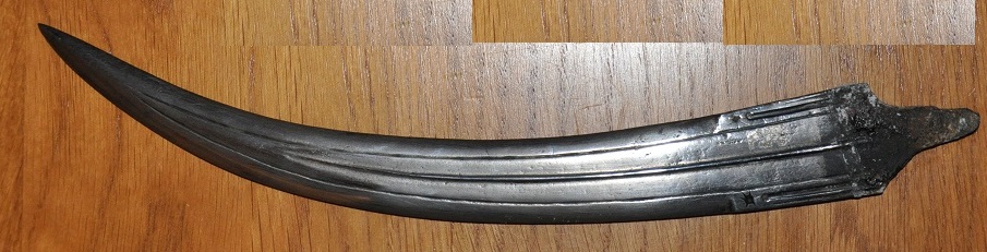

Thank you Kurt, it's exactly what I was looking for!!
I might be wrong but I have the feeling that I have a 16th century blade or at least a pre 19th c. blade...
Kubur

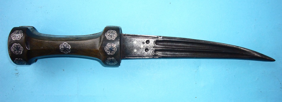

Look at this one too

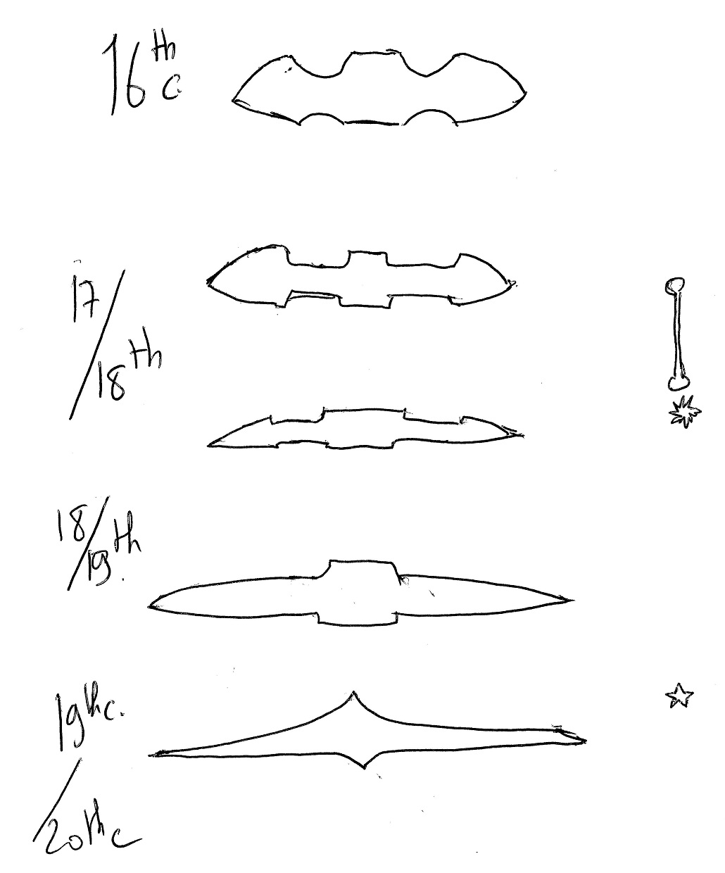

Here is a small drawing with blades sections.
You can see that the older blades were very thick with groves or panelled inside.
Even if these blades were sharp, their main function was to stab.
You can see that later the recessed panels disappeared for a single raised panel who finally disappeared for a single central ridge as you can see on the 20th c. jambiya.
IMHO

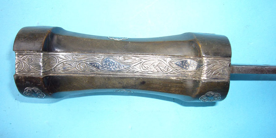

Hi Kubur,
Is the tang supposed to look like that or was it broken off? Would be interesting to know if Ottoman daggers were constructed without proper tangs.
Old 25th August 2017, 07:01 PM   #12
Kubur
Kubur's Avatar
Posts: 2,145
Originally Posted by Victrix
Hi Kubur,
Not cut, not broken, yes it's interesting.
For me it's a proof of the stabbing function.
You can ask to Kurt if he wants to remove his blade just to check but
I doubt that he will agree...
