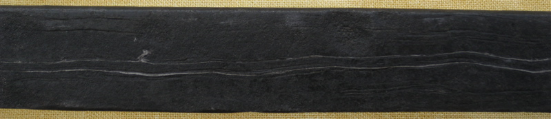

It's a shame that Edward Frey and many others do not show the blades of many published keris.
I'd guess at eastern Sumatra or Riau (coastal Malay) origin. That's quite a bit of pamor/features!

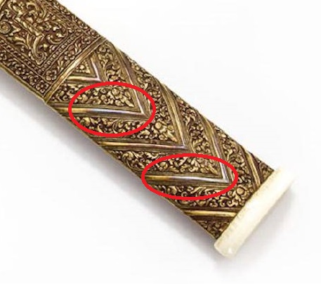

I have doubts on several things about this keris. One of it is the "rainbow" effect on the pendok (circled red in the pic below), I think only seen on gilded silver.
Something does not seem right about this keris. Please correct me if I am wrong.

What is certain is that photos can be misleading, but if I were to judge it by the photo, I would agree that it certainly doesn't look like gold but like gilded silver. Even low karat gold (9 karat) from all what I know doesn't display this kind of patina.
PS: After carefully examining more photos, I noticed the "rainbow" patina doesn't show on all of them so it might just be a photo glitch.

I can clear some of this up. The "rainbow" look is not the photography but is real - actual patina. In person it is the same look to the metal.

I have yet to know any auction house that guarantees any item descriptions. I guess they just went with Frey's collection notes without any scrutinizing.
Considering the patination on the front side, I also believe this is gilded silver; I'd also be extremely surprised if the selut were solid gold (usually these are fire-gilded at best). Why the wear is on the front side while the back side seems still intact is anybody's guess...

But it is that blade i find really interesting. As has been noted, i can't think of any picit blades outside of Jawa. Perhaps a few. Anybody? This blade had been in Frey's collection at least since the early 80s and probably longer. But it does not appear to be a Javanese blade to my eyes. I know nothing about the resurgence of keris production in Malaysia, only that it had been practically dead in Jawa post WWII until the 1970s when it got a kick start through the encouragement of people like Dietrich Drescher so i am inclined to think that this must be a pre-WWII blade at the very least. I would be interested in hearing if someone has a different interpretation, but i would not think that a blade like this would have been made between the time the war and the 1980s perhaps anywhere in Indonesia. I would be very interested to know if anyone is aware of a tradition of picit blades outside of Jawa.
Old 30th March 2017, 01:33 AM   #20
Hello David,
Yes, I was going to concentrate on the blade, too.
Yes, there is. I have seen several of these shorter and stout blades from other areas of the archipelago - some have picit, too.
While it may be tough to verify whether these all really originated from outside of the land of Jawa, I'd at least suggest that the pamor motifs here are not typical and also the ricikan and gandik features suggest different influences.
I've also had an antique alameng sword with several picit "thumb prints" on an otherwise typical Bugis blade.
