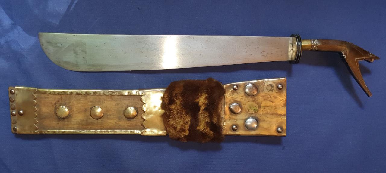

Hello dear members,
since a few minutes I am the new owner of this rare Negrito dipalata, maybe not the oldest example but authentic IMVHO. it is 23" high. All comments are welcome. The pictures are from the seller. The sword was once sold by a Philippine "antique" shop.

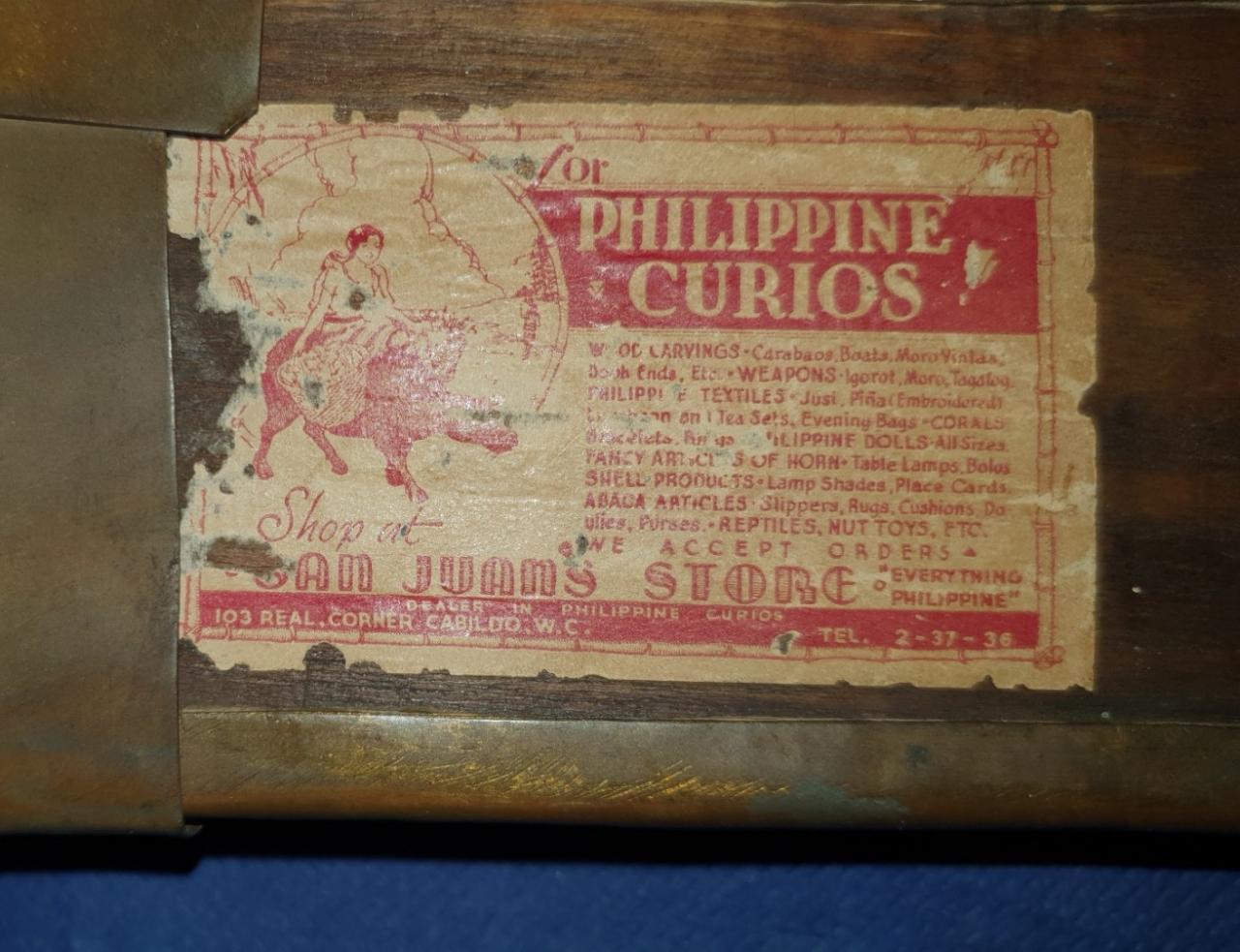

Very nice! I like that old tag, I wonder when it was sold from that shop.
The ferrule looks like a shotgun shell casing. What's with the fur around the scabbard?

Nice provenance! I simply love the tag.

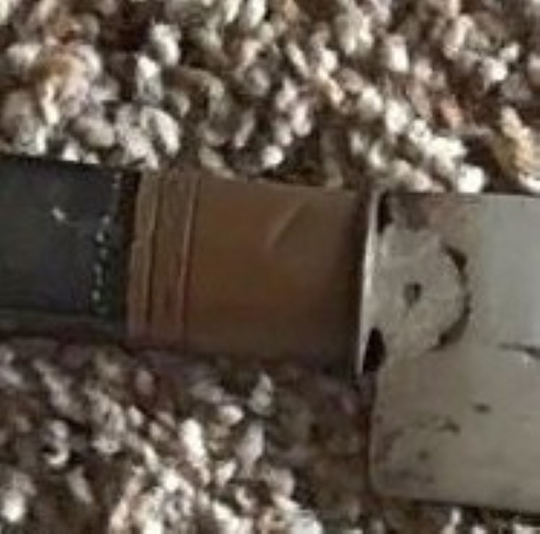

The tang looks welded to the blade, can you confirm Sajen?

Hello Albert,
thank you for comment! Yes, the old tag is a nice bonus, like you I would like to know at which time it was sold. Who know, maybe someone here will be able to add informations.
And a very interesting suggestion about the ferrule, I will look for this. Can't say something about the fur, also for this point I hope for the help from other members. Since I just before bought it I haven't had any chance to examine it in person.

Here is another reference to the label:
http://flyandflea.blogspot.com.au/20...h-history.html
So it seem that the 1930s are a good assumption.

Another great catch Detlef. The fur looks to be that from a young Philippine warty pig, and the ferrule as Kino has mentioned looks to be made from a Remington shotgun shell casing. I cannot be positive, but to me the material on the blade next to the ferrule look like a solder repair made to help keep the ferrule in place. If you look closely (photo below) you can see on one side where it looks like it has been soldered and the solder has been run up and onto the brass ferrule itself. This is not something that you will see when welding. Brass will flow onto steel, but steel will not flow onto brass in the way shown in the photo. As far as age, I think that I will wait to see better photos before commenting in that area. My only other comment is to say that I wish that I had seen this first.

Thank you very much for your educated comment and special for the enlargements Robert. Also the pig suggestion seems to be a very good one. And I hope that you are correct with the soldering theory, the picture seems to confirm this. We will know more when it arrives at it's destination.

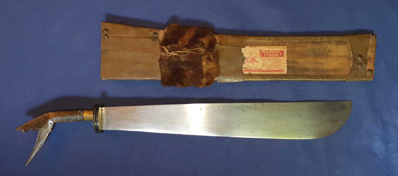

, yes I know! Who you think is the new owner? Normally I want to post pictures when the handle and guard is reset and straightened. I think that this one is much older as the first one, sadly is the handle elongation broken and missing but this swords are so rare that I think that it was worth the paid price and even with the handle damage it's a very interesting piece of great ethnographic worth. I think that this piece is from the middle of the 19th century.
Old 3rd April 2017, 11:11 AM   #24
Most interesting is the old collecting tag on the handle, a sign of the great age from this piece.

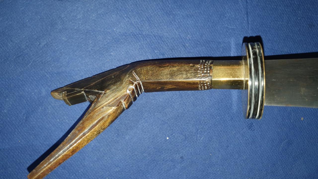

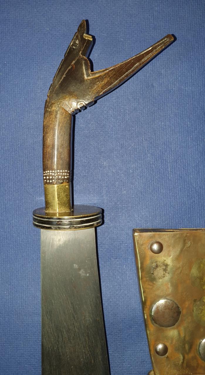

Old 26th April 2026, 01:51 PM   #27

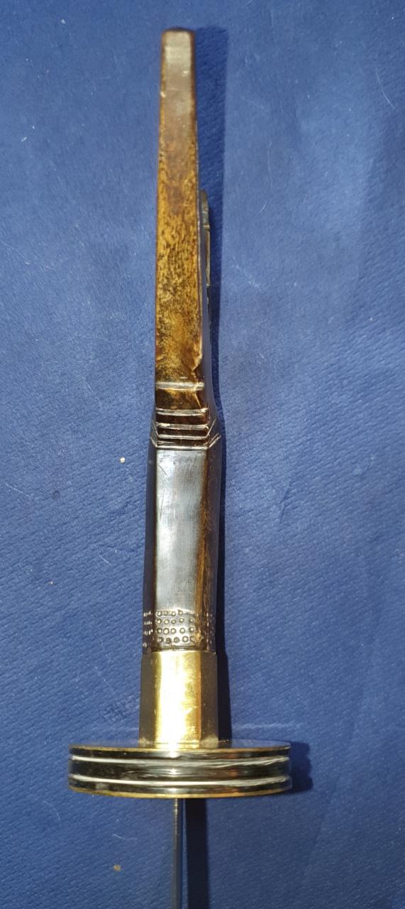

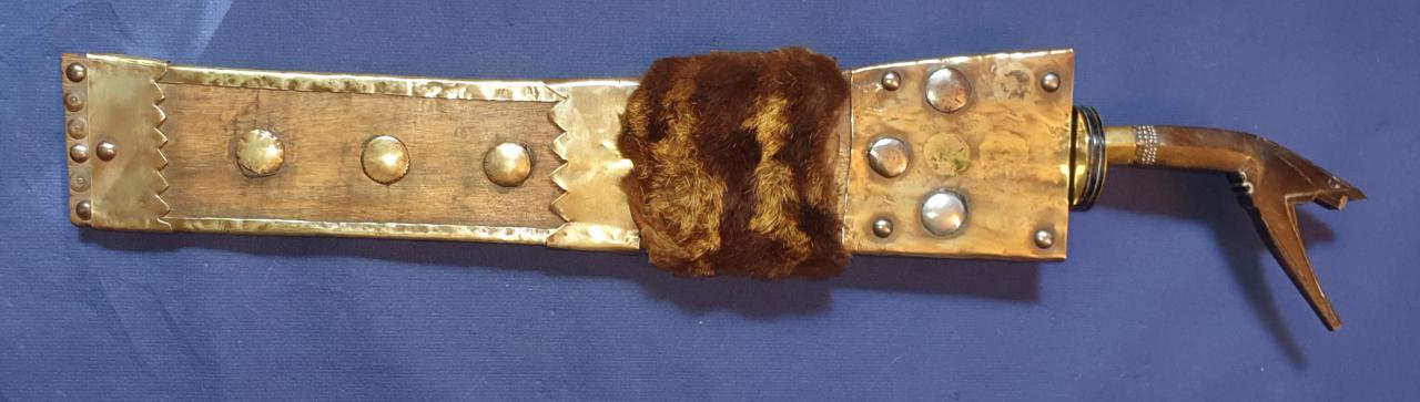

Here the sword after the hilt restoration and a little bit TLC!
Old 26th April 2026, 02:14 PM   #28
Posts: 4,749
Hi Detlef,
Nice example with pristine blade--presumably never used. I'm not sure about the scabbard being from the original culture.
Regards, Ian.
Old 26th April 2026, 02:34 PM   #29
Hi Ian,
The blade received a polish from my deceased friend Robert since the tang was broken and Robert welded the break. See the attached pic. And I am pretty sure that it is the original scabbard, the fit is perfect but I polished the brass mounts a little bit up in front recently. See the pics in post #1 from the seller also.
