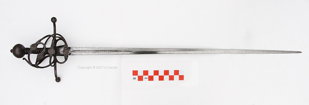

Default A Spanish rapier Early 17TH century

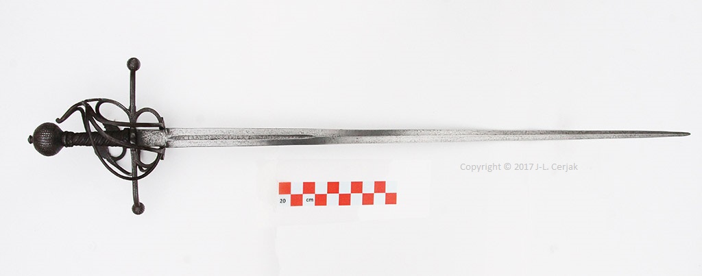

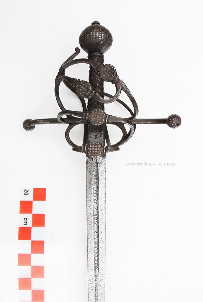

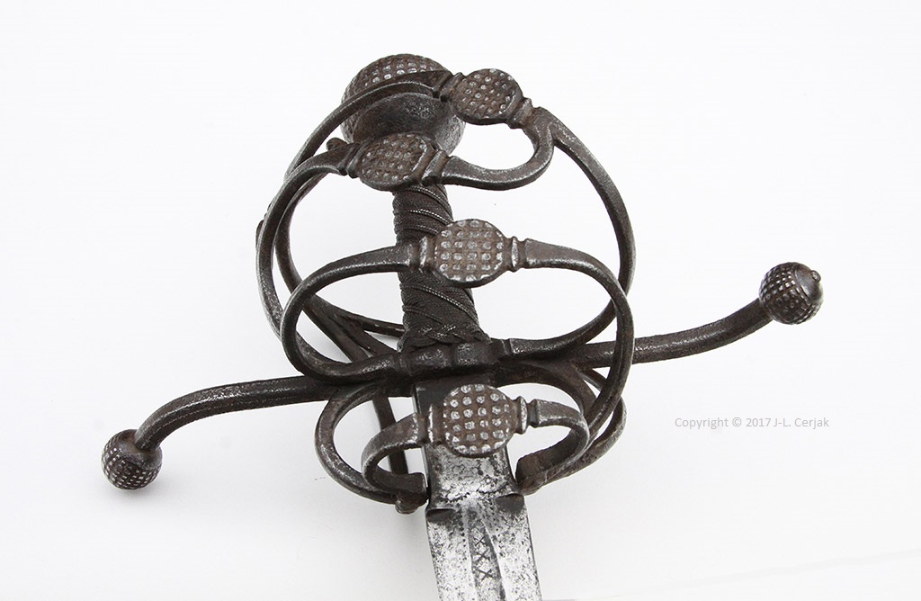

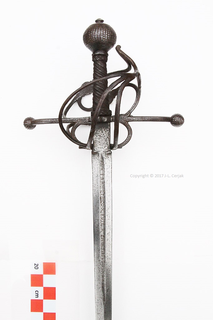

O.L. 115.8 cm ; blade L. 101 cm.

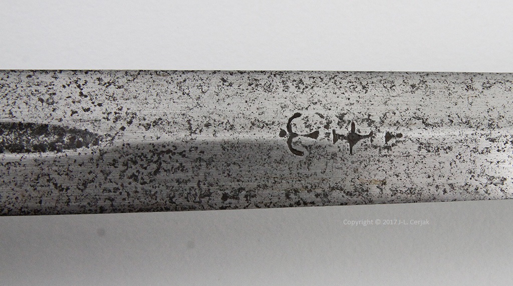

Blade marks: Francisco Ruiz Toledo
Any comment on it would be welcome.

Very nice rapier, Jean-Luc.

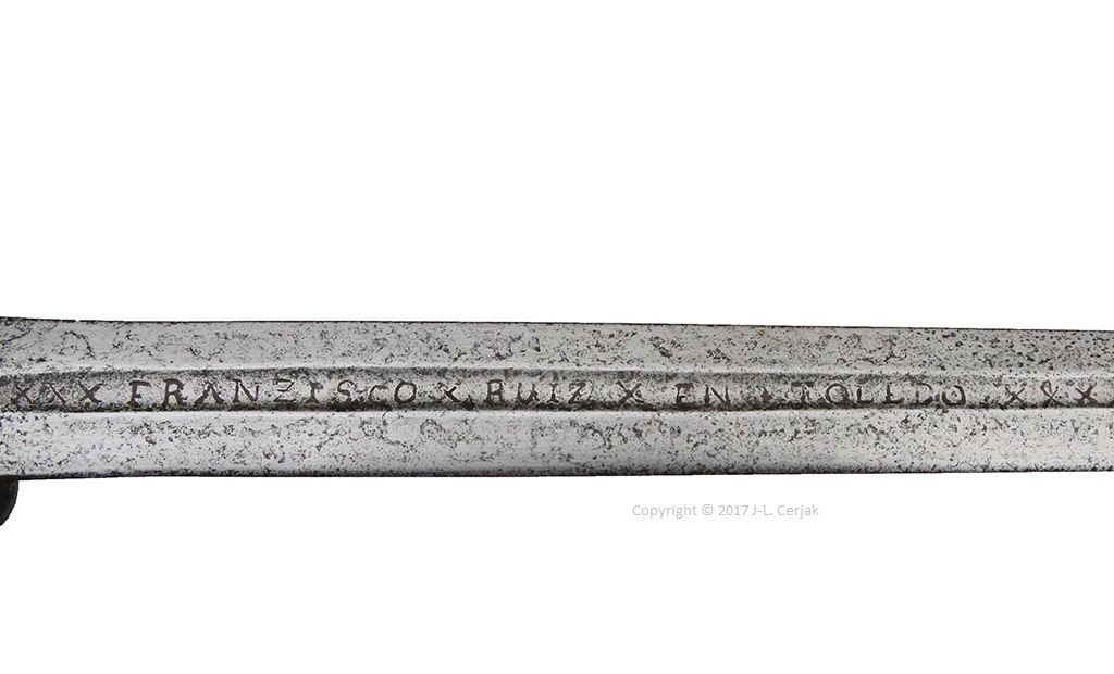

I wonder why there are no blade marks pertaining to the smith Master, of either one or the other of the two brothers with the same name.
Did you check that ?
Also the spelling of the name is worthy of note.

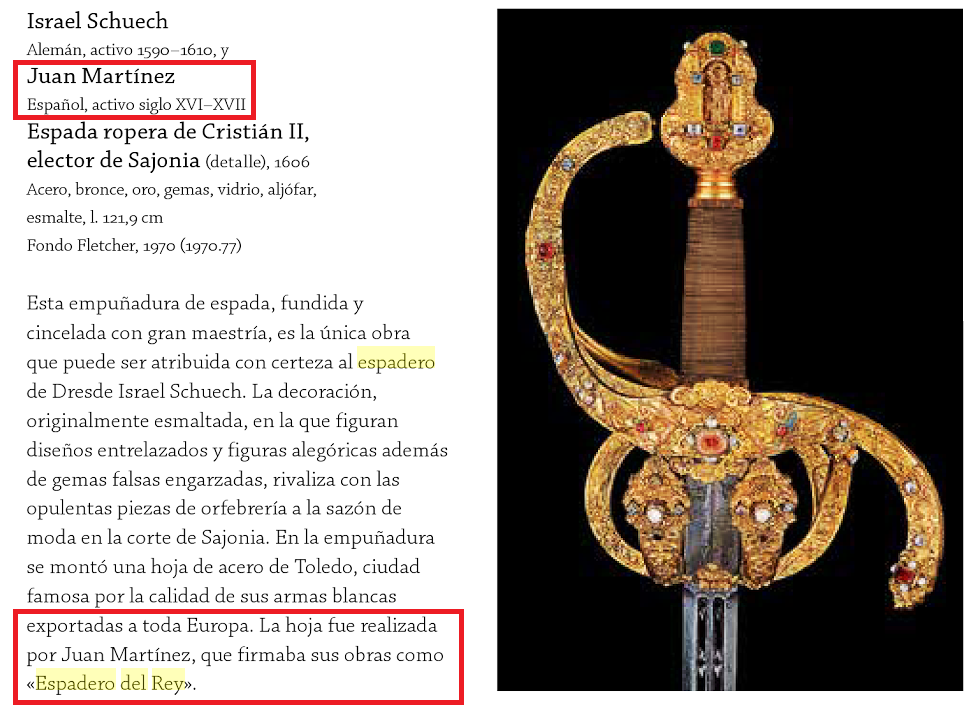

In one example shown at the Ministery of Culture, we can read:
En el primer cuarto de la hoja, Grabado
´DE FRANCISCO´
´RVIS EN TOLEDO´
Datación 1601=1700

A Spanish rapier Early 17TH century ?

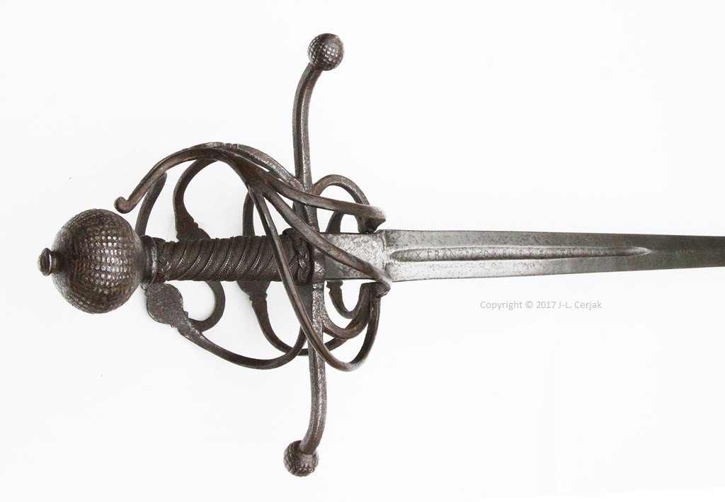

No, I think it's a German or Dutch rapier from the last quarter of the 16th century, globular pommels are very simple in form but very rare , pommels of this type occurred in Netherlands on some 16thC paintings.
fe in a paining The Company of Captain Rosecrans by Cornelis Ketel, 1588
best,
Jasper

Thank you Jasper,
I particularly appreciate your knowledge of the masters of painting in the sixteenth century. Their faithful representation in art of sword fashion is certainly the most reliable dating method.
Again a sword who could be from your country...
best
Jean-Luc

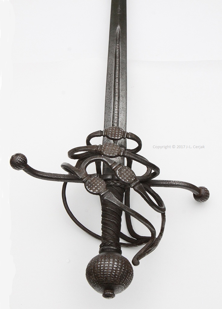

I am intrigued by the unusual motif in this rapier hilt, and tried to find something comparable but my resources seem disturbingly limited and nothing close.

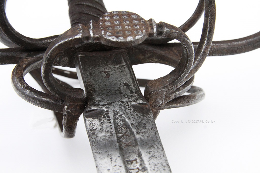

I am curious on the inscription in the blade, and it seems the Francisco Ruiz name was not only well established, but so much so that like Tomas Ayala, it was often used spuriously on German blades. Perhaps that has also lent to the use of this renowned name on a number of more modern productions.
What seems notable is the uneven character of the letters in the inscription and the curious use of the letter Z in Francisco, which seems atypical.
As Fernando notes, it would seem that in an early blade, by either Francisco Ruiz the elder, or the younger for that matter, would have the appropriate punzone at the forte.
What is there instead, is a crescent, of a form more in character with such stamps in pommel or hilt elements, but I presume this is to allude to the use of the crescent by Spanish makers Del Rey.
It would not seem unusual to find a Spanish blade in the Netherlands and in a German style hilt as this was of course a Spanish province from the late 16th into 18th c. Going back to the inscription, I have been under the impression that in Solingen stamped lettering was 'racked', thus in groups so as to ensure more evenly and uniform lettering. That is why this one seems so unusual and unevenly applied. If this sword was a German product of 17th century, it seems the inscription and a punzone (even if not correct as was the case with the Stantlers in Munich in their use) .

thanks for the compliments but I must disappoint you, I am for the time being still a student in arms.

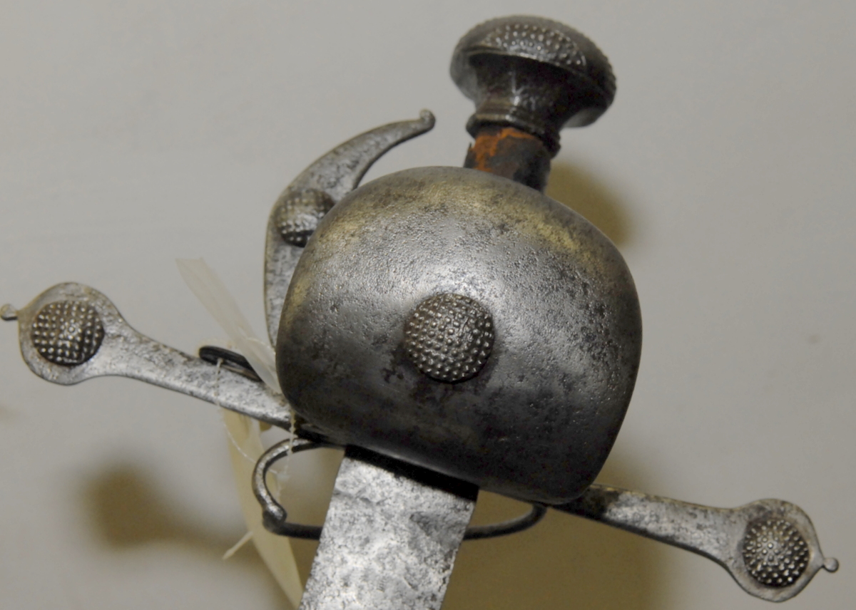

The hilt is a combination of norman type 74 and 77.
The globular pommel characterizes Dutch rapiers.
The grid pattern was found on several arms and armour around 1570-1580, see for example the pommels and round finals of different dussages.
best,
jasper

Grid is exactly the term I was looking for and I see what you mean on its occurrence on dusagges and now recall seeing that.

Default Spherical pommels / grid filework

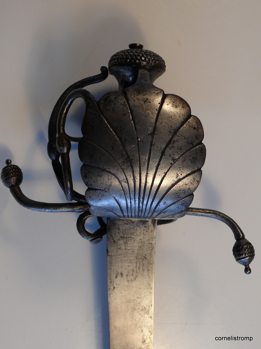

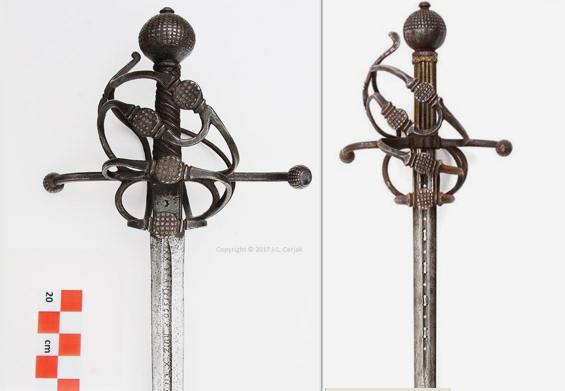

Globular or spherical pommels per se weren't restricted to the Netherlands. Note a north Italian example, inv. no. 1776, Museo Poldi Pezzoli (Milano), publ. Boccia/Coelho 1975, #485. The swept hilt is cataloged as 1580-90, from Belluno; earlier riding-swords and backswords from this area which are practically identical to Styrian counterparts also share this feature (Coll. Luigi Marzoli, Brescia, inv. no. G 21 and G 23). A faceted version of the sphere can be seen on a somewhat simpler swept hilt on a rapier identified by Capwell as possibly Italian, 1570-80, Wallace Collection inv. no. A576, publ. Norman 1986, p 134.
Grid filework is also seen on a few Italian rapier hilts, q.v. inv. no. 2575, Museo Poldi Pezzoli, with an example depicted in art, "Portrait of a Gentleman" by Bartolomeo Passarotti 1571, Museo Bardini (Firenze), both publ Boccia/Coelho 1975, # 465, 466-67. It must be said, however, that these Italian examples are a bit more elegantly proportioned than the hilt on the sword discussed here.

Anybody out there have any thoughts or ideas on the rather crudely incised lettering and unusual spelling in the FRAN'Z'ISCO RUIZ ??? the curious 'crescent' (?) at the forte? The absence of the Ruiz punzone?
Old 16th February 2017, 02:30 PM   #12
There is no punzon, as there is no FranZisco Ruiz. How many spurious spellings of great Masters like Ayala, for one, do you know, Jim ?
You are left to crack the riddle of the crescent presence .
Old 16th February 2017, 05:59 PM   #13
Posts: 10,857
OK Fernando, that was the point, it is a spurious use of the name, so obviously the punzone (or is it punSone? ) is absent.
With the erratic letters in the inscription which are almost crudely executed I fear this is even beyond the usual Solingen placement, and with the number of rapier examples that have been in circulation using the Francisco Ruiz name (a number are less than authentic) I wonder on this.
Could it be a Solingen blade with poorly applied letters but of the period by a maker without the usual rack system?
The apparent crescent is a conundrum in itself, is this an equally inept attempt at the 'espadero del rey' mark?
I do not like negatively questioning a weapon, which is otherwise a most attractive and interesting piece, but these factors must be considered.

...so obviously the punzone (or is it punSone? ) is absent.
Actualy spelt punzón, plural punzones .
...is this an equally inept attempt at the 'espadero del rey' mark? ...
Is there a mark for espaderos del rey, Jim ? can you expand on that ?
Old 19th February 2017, 02:37 AM   #15
Posts: 10,857
Thanks for the spell check Nando, that was a shameless pun on my part
On the mark of the 'Espaderos del Rey', from Wallace Collection (Sir James Mann, 1962):
A545 (p.279), a rapier c.1620, "...the incongruous combination of a Toledo mark and the half moon of an Espadero del Rey with the name of the Italian bladesmith Andrea Ferara suggest this is a product of Solingen".
A652 (p.331), a cup hilt rapier Spanish c1635; blade German (?)
"...the ricasso, inside the cup stamped on each side with a makers mark and the half moon of an Espadero del Rey. "
Further noted the the mark ST is said to be for Tomas de Ayala and that the Stantlers of Munich also used the letters ST (a crowned ST) along with the name Sebastian Hernandez. The four sided blade on this example is noted to not be usually found on cup hilt rapiers.
It would appear that the half moons (which typically look like Tarot card characters with man in the moon face), were somehow often used along with makers punzon in Spain, for Espaderos del Rey (the Kings artisans).
However it is unclear whether this was a broadly used designation or strictly for select makers. The only maker noted as such by Palomares was of course Julian del Rey (with the perillo, or little dog, rampant) but no note I am aware of) with a half moon. If there is such instance you are aware of I would be grateful to know.
Clearly, the half moon mark became part of the Solingen repertoire of symbols and devices used by Solingen smiths along with other spurious Spanish names and punzones, and eventually became part of the astral groupings inscribed in Solingen blades.
This simple mark, looking in Rorschach test parlance, like a crescent (but facing the wrong direction) seems possibly an incongruent attempt to allude to the Spanish theme inscribed in the fuller with Ruiz' name.
Old 19th February 2017, 05:09 PM   #16
Alright Jim,
I have checked both examples at the Wallace and went into a search for the half moon mark in Spanish sites.
The only citation i found is that, Master Juan Martin used a half moon punzon as his personal mark (#39 in Palomares nomina).
"MUY BONITAS Y DIGNAS DE CONOCERSE SON LAS DE JUAN MARTIN QUE USÓ UNA MEDIALUNA EN CUARTO CRECIENTE"
On the other hand i often read that the statute of being a Espadero del Rey is represented with the Royal crown above the master's personal mark escutcheon.
"REMATADA EM CORONA REAL POR POSEER EL TITULO DE ESPADERO DEL REY"
But if you give it a different reading of the Wallace descriptions, they mention the half moon of "an" espadero del rey and not of "the" espaderos del rey, meaning to say that, they may be referring to a "determined" espadero and not the espaderos "in general"; which brings us to consider that of the said Juan Martin ... or a spurious use of such Master.

Good work Fernando! and interesting note on the interpretation of the Wallace entries. The half moon mark of 'AN' Espadero del Rey would suggest that all of the makers in Toledo were then makers for the crown, and we presume that the half moon mark was used in this case by one of them.
As you point out in the Palomares nomina (1772) only one of the 99 entries uses a half moon mark , Juan Martin (#39).
While the Palomares chart lists just the names and little detail, with none of these makers specified as an Espadero del Rey, even Julian del Rey who of course has the name so specified. This must be the 'younger' as the Julian del Rey originally credited with the noted mark of the 'perillo' was a Moor converted to Christianity and maker to Boabdil 1484-1498.
In looking into "Small Arms Makers" (Gardner, 1963) which lists names of 'foreign swordsmiths' with certain key note details in varying degree, I found that of virtually all of the smiths represented in Palomares, only one was listed with the title, Espadero del Rey.....that was Antonio Ruiz of Toledo, 1566-1570 (p.365). In checking Palomares, this Ruiz is #13, and has a shield with an 'o' over a 'T' in a shield......no crown.
In the reference noted regarding Espaderos de Rey, you note the statute designating these makers as such is the royal crown over the makers personal mark. Looking at Palomares nomina, there are only a select number, perhaps half, with such crowns included in the punzon. Of these, none are those specifically noted as Espaderos del Rey. Neither Juan Martin (half moon #39); nor Antonio Ruiz (#13, o over T) have crowns nor #59, the perillo of Julian del Rey.
It would appear that the half moon mark was seemingly associated with Espaderos del Rey as in Wallace (Mann, 1962) A582, on a rapier there is the half moon mark along with the O, T mark (Antonio Ruiz) and in this case, it is crowned. Again, this smith was the only one specified as Espadero del Rey....and here is his mark OT and crowned, along with the half moon !
The suggestion seems to be that the half moon, in cases where the makers mark was present, and the marks congruently applied, may have been to makers who had the particular statute afforded them .
Apparantly the Kings of Castile granted privileges of different kinds or there were varying degrees of statute possibly represented in the recorded punzon listings which were no longer available when Palomares collected these at the Ayuntamiento in Toledo.
I am afraid this brings us no closer to resolving the curious mark at the forte on this blade, but an interesting foray into Spanish markings just the same.

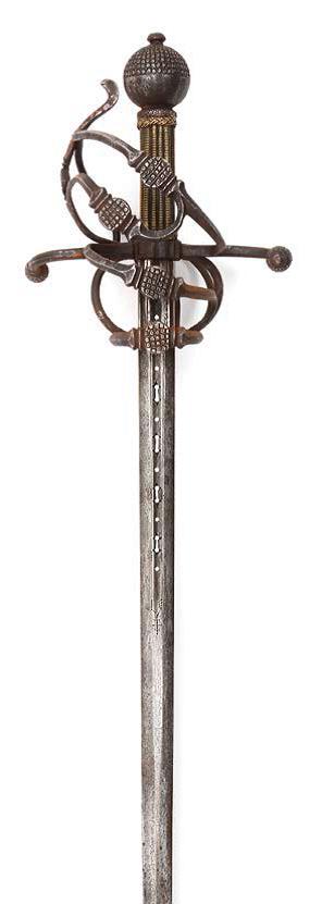

Sorry for barging in, as it is not my area of interest and expertise, but I think more of Italy or Styria rather than Spain.
https://www.pinterest.com/pin/366550857155039469/
That would explain the spelling.
No matter where from, it is a very good one.
I am not going to suggest "adopting" it, but for rapier lovers it is a nice catch.

Not at all Ariel, no matter on area of interest or expertise (I have no idea what mine really is! ) its good to have you enter in. I think the spelling conundrum may be as much with levels of literacy and language variation in Solingen along with workers skills. However the centers in Styria and Italy are a valid suggestion as they adopted these Toledo names spuriously as well .
While I have had my doubts on this one, must say it is growing on me! and it really is an attractive weapon. The grid patterns suggested earlier to me are compelling for Italian weapons as Philip has pointed out.
Thank you for joining in and the links!

spherical pommels can be found in all ages in all countries, even in the Middle Ages.
However, at the time of the rapier of Jean Luc late 16th century early 17th century, this pommel was very fashionable in the Netherlands on Rapiers in Art. This in contrast to Italy where the heydays had already passed. (in the early - mid 16th century)
F/M the inscription is of low quality (btw the blade is not) and Francisco is spelled in the German language (phonetically) with a Z. (Franz is a German name)
for this reason my contention is that this inscription is probably done a bit later and has not been done by the blade maker.
perhaps on a export-blade from a marketing perspective.
The grid pattern was popular in the last quarter of the 16th century and probably originated from Styria. see dussages of post #7
for comparison, an Attachement of the same type of rapier.
best,
jasper

Jasper,
I am very glad to have you back on this, and thank you so much for the elucidation on the issues we are observing and discussing here. I clearly very much agree on the blade and inscription, which has been one of my primary concerns since the outset. The blade as you note is of good quality and age, and the inscription was as you suggest probably added in German context using this much favored makers name to enhance value in trade.
Unfortunately the inscriber, though carefully following the standard conventions of wording spaced by the 'x's, was not very proficient in lettering and their placement. It would seem that a style or fashion hilt would still appeal to the extremely traditional Spaniard, who generally held stubbornly to the venerable forms of earlier times. Perhaps this may account for an older hilt or blade or both filtering through trade entrepots destined for Spanish Netherlands and the German application of the famed name of Francisco Ruiz?
It seems that the observation placed by Ariel was most astutely placed, as in all honesty, I had not even thought of Styria. Your illustration clearly shows this grid pattern compellingly in that context .
Can you offer thoughts on the curious mark at the forte , which looks like a crescent?
All best regards

Whoa!
Jasper this picture is very important for me, Thank you for the gift!
How many peoples assist you in your research department?
What I could say is, that both hilts have been made by same hands.
Could you tell me from where you found this sword ?
Thank you very much!
Jean-Luc
All best regards
the half-moon (crescent) single or double appeared frequently on the ricasso or on the middle of the blade, at blades from Toledo in the 16thC and 17thC.
Also Spanish marks like this were copied in production centers such as Solingen.
In the late 16th century there was largely and lively trade in weapon parts, such as blades. It is impossible to say whether this is a Toledo export blade or a German blade.Also it is difficult to determine where the rapier is put together.
It is, however, with probability, to say that the inscription is applied later on
given the poor Quality of it.
best,
jasper

I have been in contact with Germán Dueñas Beraiz, head curator of the arms section of the Army Museum of Toledo, author of several books on early weaponry.
Here is what he says about the smiths marks, the crowns and the half moon:
... La única marca para reconocer a un espadero del rey era la inscripción que colocaban en los cantos del recazo ESPADERO/ DELREY.
Las coronas en los punzones de espaderos toledanos son muy comunes, y en principio no hemos documentado que tengan ningún significado especial.
Por otra parte Palomares es una fuente muy interesante pero poco fiable a la hora de atribuir marcas, lugares de fabricación o nombres de espaderos, tal y como señalo en un artículo escrito por mi hace unos años dedicado a Palomares en la revista Gladius.
La media luna aparece en algunas hojas españolas, pero sin vinculación con marcas de espadero ni de ciudad.
De hecho Juan Martín no existió como espadero, refiriéndose Palomares a otro espadero cuya firma interpreta erróneamente, concrétamente a Juan Martínez, que por cierto si fue espadero del rey ...
And in case you won't bother translating, here is a lousy version:
The only mark to identify an espadero del rey was the inscription they applied in the edges of the ricasso ESPADERO/DEL REY.
The crowns in the marks of Toledan sword smiths are rather common and in principle we have no evidence of those having a special meaning.
On the other had, Palomares is a very interesting source but not so reliable, in what touches marks, production places or sord smiths names, as i point out in a article published a few years go in the Gladius review.
The haf moon appears in some Spanish blades, but with no direct relation with smiths marks or cities.
In fact Juan Martin has not existed as a sword smith, Palomares referring to another smith whose name he wrongly interpreter, in concrete to Juan Martinez, whom has indeed been an espadero del rey.

If you care for some examples ... the first at the Metropolitan, the second in the Real Armeria.

... You have also brought up a most salient point which I had completely forgotten, that of taxation, which would be a most inducing reason for makers to seek such a title or honorific. In markings it is most difficult to determine which were indeed makers punzones; which may have been guild marks for compliances ...
There were ordinance, brotherhood, guild ... and marks.
Some ordinance inspectors visited the smith and submitted to him to a number of sword (and accouterment) making operations, against some fees (12 reales), to recognise him as espadero. The brotherhood submitted him to a secret vote, with the practice of 'habas' (small balls), white for yes and black for no. This was a well organized system, with clerks and all, but not well seen by the Crown. The guild was somehow connected to the brotherhood, but subject to Municipality, that cared for smiths protection and industry evolution.
Then there were the marks, made with anagrams of their names and also that of Toledo. There were smiths who opted by only aplying their own anagram, those that used both of their name and that of Toledo and others, feeling fundamentaly Toledan, opted by ony applying the city To symbol. It was the author i am roughly quoting (Esperanza Pedraza Ruiz) who pretended that the crown over the anagram meant the smith was espadero del rey, but i tend to give credit to Dueñas Beraiz in that this had no such meaning.
