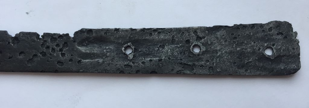

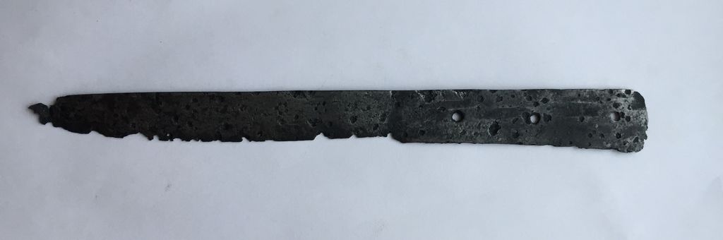

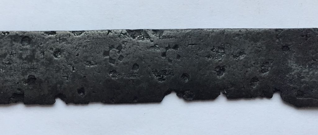

Gents,
I need your help to ID this knife. It was found in the western part of Russia.
Knife lenght is 21 cm.
I was told that markings on the blade could be relevant to Styria.
Regrds,
Evgeny

Hi Evegny,
You may find that this kind of marks/symbols falls within a wide range of similar shapes, as for exmple:
http://www.vikingsword.com/vb/showpo...7&postcount=16.
Let's hope some member familiar with this area comes up with a precise ID.
Old 9th January 2017, 11:27 PM   #4
Posts: 10,838
In the link provided by Fernando, a halberd with similar marks is shown as Swiss, latter 15th c. In Wallace Collection a dagger again with similar marks is shown as Swiss 16th c.
In a reference on medieval cutlery , "Knives and Daggers" (Cowgill; DeNeergaard; and Griffiths, 1987), these kinds of knives are apparently termed 'scale tang' knives (grips are mounted directly to tang sides by rivets) and seem to date to around mid 14th century. It is noted that marks began to be consistently applied around end of 14th in about 50% of examples. This reference is confined mostly to excavated examples in mostly London.
As London was of course considerably metropolitan, many continental wares and trade items from the Continent were present. It seems that these knives were of course common throughout, so isolating them to any particular location for origin seems pretty unlikely. There is an example of this type marking on several examples of both knives and shears.
By the same token, these kinds of marks are found on sword blades mostly in Germany and in Italy but are typically difficult to assign to any maker and stand mostly as quality associated symbols. They are commonly referred to as 'mill rinds' or 'cogwheels' by various writers, and often as using the heraldic term 'mullet'.
Such marks may have had significance to certain makers locally in the time of original production, but such specific records are not usually known, or sparsely detailed let alone accurate. Some '...records suggest that the mark belonged to the Master of the Workshop, but sheds no light on whether he used one, or a number of marks"..("Knives and Scabbards", p.33).
It would be equally possible for this knife to have come from Styria, who often spuriously used both Italian and German markings. Its appearance in Russian strata would be consistant with trade and normal diffusion.

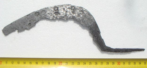

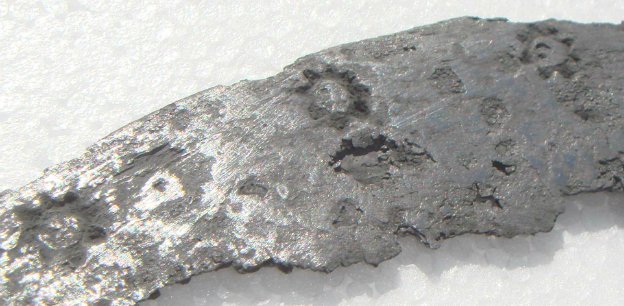

Punchmarks = indicators of quality looks quite convincing
Look at this sickle of the same period and from the same region - it bears three similar marks:
Evgeny_K is offline   Reply With Quote

Evgeny, the same conclusion about these marks was reached by several collectors of similar items that were discovered in Austria, which Styria was/is part of. It is hard to judge the quality of relic blades, but some correlation between number of marks, quality and/or complexity of production or construction can be noticed, so the theory remains plausible.
